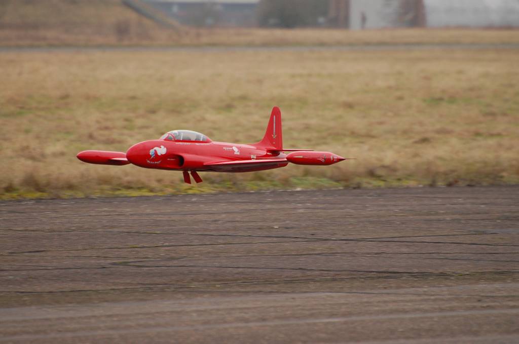

Default RE: BVM T-33 Build
Old converted DF model now with P60
Did you add flaps to your T-33? I have a F-80 EVF that I ordered the flap kit for. I haven't started the kit yet but I was reading through the manual and the flap installation instructions. It's sorta straight forward and sorta not lol. Any pictures would help.
Old 01-03-2010 | 01:19 PM
Joined: Jun 2002
Posts: 13,266
Received 793 Likes on 576 Posts
From: Watford, UNITED KINGDOM
Bob
Yes, though I didn't build the airframe, I bought it converted on the flaps. I don't have any shots available but could get any done you need, by the new owner
Dave

Hi Dave,
I'm doing a df/turbine conversion right now. Power will be an MW54 Mk3. What was your final weight and how did it handle at slow speeds?
Thanks and regards
Joseph
Old 01-03-2010 | 04:40 PM
Joined: Jun 2002
Posts: 13,266
Joseph
It's not been weighed, but it's 2k painted and uses a P60. Slow speed is fine, it even had a flame out on the first flight and landing was fine
Dave

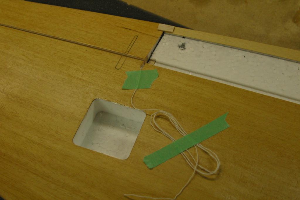

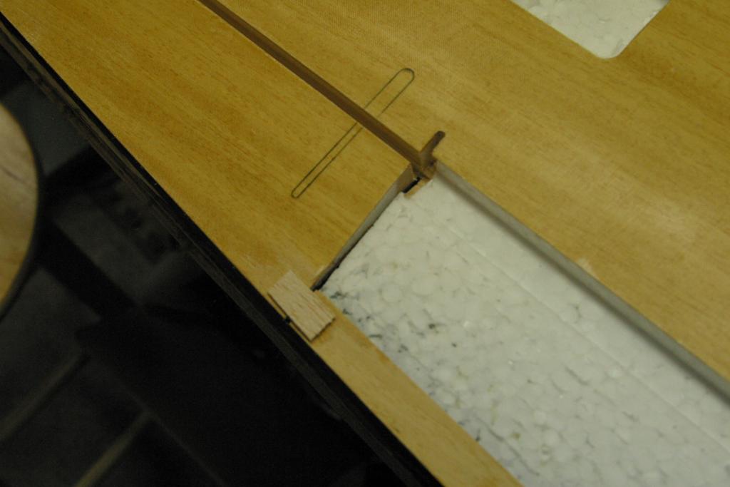

Well, progress is being made. I now have the wings glassed with &frac34; ounce cloth, and ZPoxy finishing resin. Because of the live hinge, you have to make sure that the resin does not fill the groove during the process. I have seen a few threads on alternate ways to ensure that the resin does not get in, but I used the BVM method as described in the manual, and it could not be simpler or more effective. They recommend putting a cotton string in the slot before applying the glass, and then pulling it out once the resin was applied. I thought that I should do a dry run before trying this process, and this turned out to be a good thing. The string must be much smaller than the groove, or the friction would be too strong to be able to pull it out. My cotton string had 3 strands, so I pulled 2 out and just used the 1 small one. I also found that it was much easier to pull from the tip. The process worked perfectly, and there was no tendency to pull the glass cloth out of place. As you can see, after one coat of resin, the live hinge is perfectly void of resin. I also found that by tacking a small piece of balsa on the opposite side, it held the aileron in position while glassing. This was easily removed after the resin dried.

Dave,
I'm familiar with live hinges on composite airplanes but how is it done on this one ?
