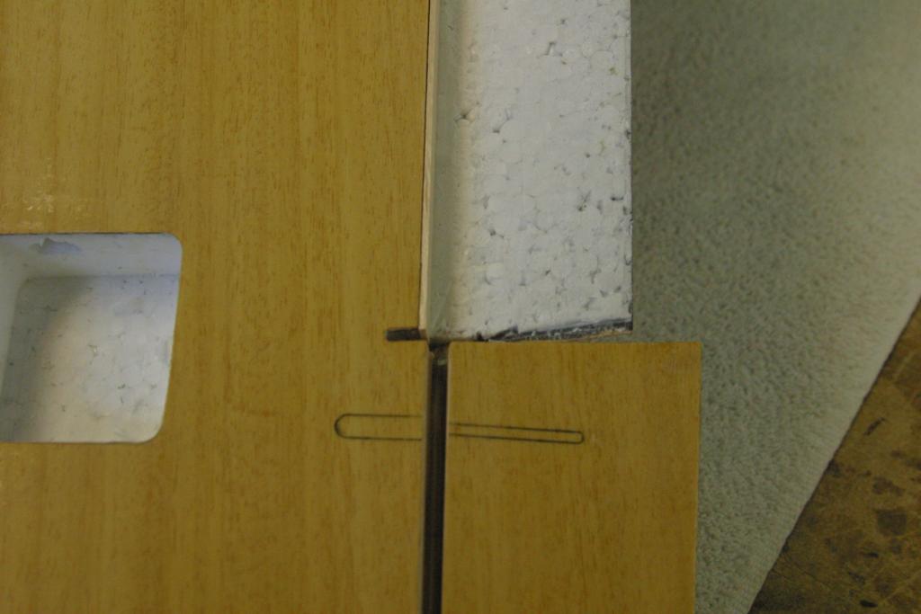

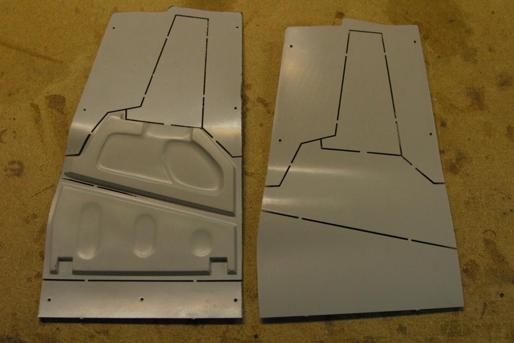

Old 02-27-2010, 04:05 PM
  #35
f6hlct
f6hlct's Avatar
Join Date: May 2002
Location: kanata, ON, CANADA
Posts: 138
Default RE: BVM T-33 Build
I have a question regarding the flap portion of the build. I have read the instructions and looked at the plans a hundred times, but something is just not adding up. As you can see from the photos, the hinge line of the flap is recessed 1/16” compared to the aileron to accommodate the vertical filler strip, and this concurs with what the plans show. The problem is that with the wing in place, this should all line up with the panel line on the fuse wing stub, but it does not. The 1/16 strip is just sitting there for now as I do not want to make any rash decisions until everything looks right. Logic says that I should cut on the panel line which also concurs with the glass / CF flap bottom sheet. My other question is regarding WF-1 which is the hinge point out at the aileron edge. In the photo, I have it lined up per the instructions where they suggest that the foam be cut away. It seems to be sitting way to high. I would love to see some photos and descriptions to clarify what is going wrong here.

Old 02-27-2010, 04:43 PM
  #36
BobH
Join Date: Mar 2003
Location: Springfield, VA,
Posts: 8,049
Received 21 Likes on 21 Posts
Doesn't the bottom of the wing stub get cut away so that the flap is one piece? Perhaps this will result in the matching up of the lines etc. I have the BVM F-80 and it's the same wing. I havent started building it yet but i seem to recall seeing this section in the plans.
Hopefully some will come along with all the right answers

Old 03-07-2010, 02:53 PM
  #38
f6hlct
f6hlct's Avatar
Join Date: May 2002
Posts: 138
Well the flap install problem appears to be that the aileron / flap hinge line was miss cut at the factory. You can even see in one of the photos, that the hinge lines are not even parallel. To salvage this, I ignored the fuselage panel lines and the wing hinge line, using the carbon fiber flap bottom as a template and made a new flap hinge line into the wing and fuselage stub where everything seemed to fit. The final spot, move the hinge line up about 1/8”, but the trailing edge and radius on the fuselage looks good now. My happiness was short lived though, as there were a number of parts missing from the flap assembly bag. The assembly bags are well packed and sealed, but when all the parts are not in the bag, the seal doesn’t help much. With this minor setback, I decided to proceed with the aileron install while I was waiting for BVM to send the missing parts, but low and behold the aileron assembly package was missing as well. They say when you first get the kit, to check that you received everything, but they do not give you a check list of what is in the box. That would seem to be a simple improvement to the kit. Unfortunately, you won’t know that anything is missing until you get to that page in the book. I guess mine was made on the Friday of a long weekend.
In order to keep on working I am going to move on to the stab and rudder assembly, and hopefully have better success.

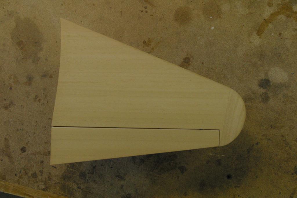

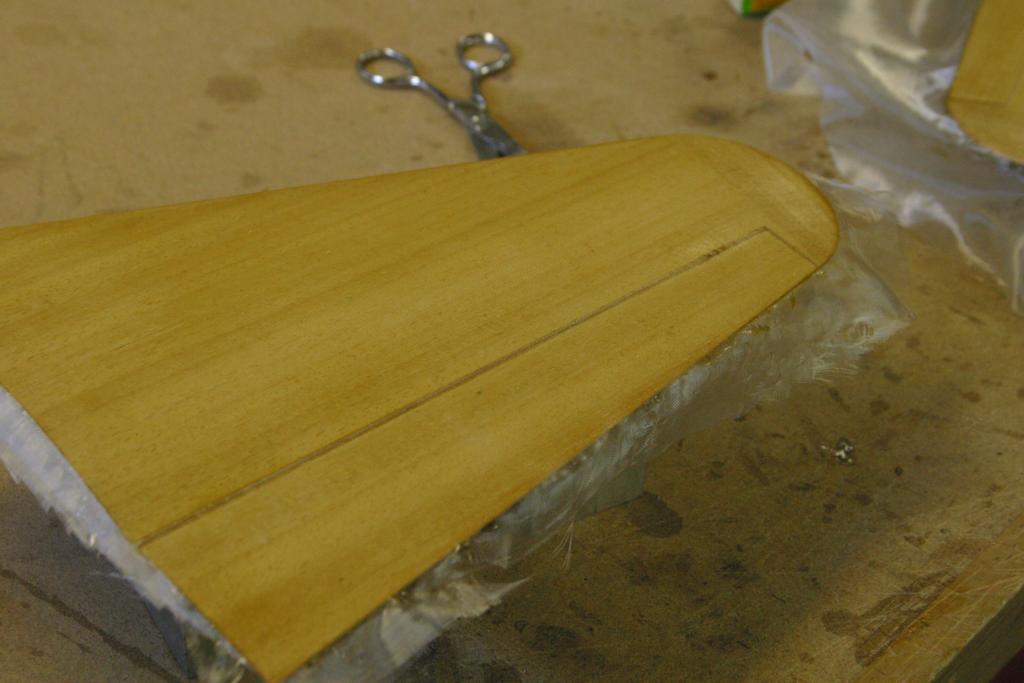

Old 03-20-2010, 09:37 AM
  #43
f6hlct
f6hlct's Avatar
Join Date: May 2002
Posts: 138
Well I started on the tail section, and the process is very much the same as I did on the wing when it comes to glassing. As Bob describes in the instructions, the string method of keeping the live hinge free of epoxy works like a charm. I also like putting a patch of balsa on the opposite side to keep the controls rigid. It’s very easy to remove after you have finished glassing, and makes the task easier.
One of my biggest complaints with BVM since the beginning of this build was that they could use some work on customer communication. I have addressed this issue with Bob, but some things just never seem to change. It has been a few weeks now since I both emailed and had a conversation with them about the missing parts, and the inlet fence diverter, but I still do not get any update on whether the parts are being made, sent, or what the status is. It takes very little effort to send an email, and it shows the customer that you have not been forgotten.
I should have the 2 coats of resin completed soon on the tail surfaces as things on the here seem to be going well.
