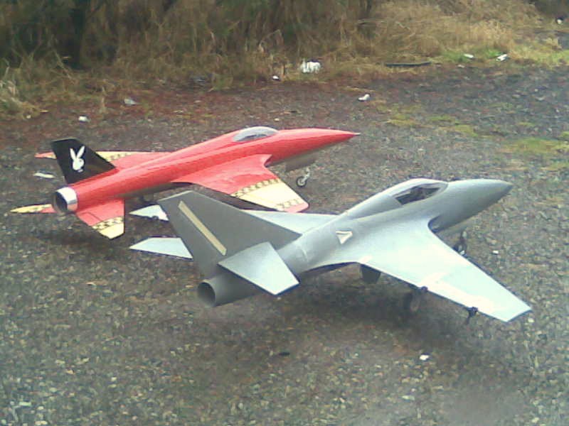

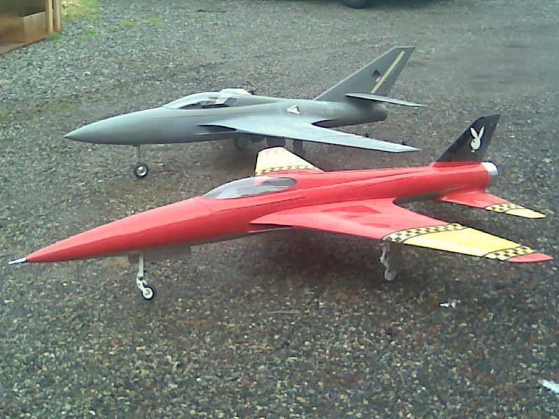

Actually, to see a Liberty and a Firebird side by side, they don't look as similar as one thinks.

The Liberty seems to be half Firebird and half Bandit....
