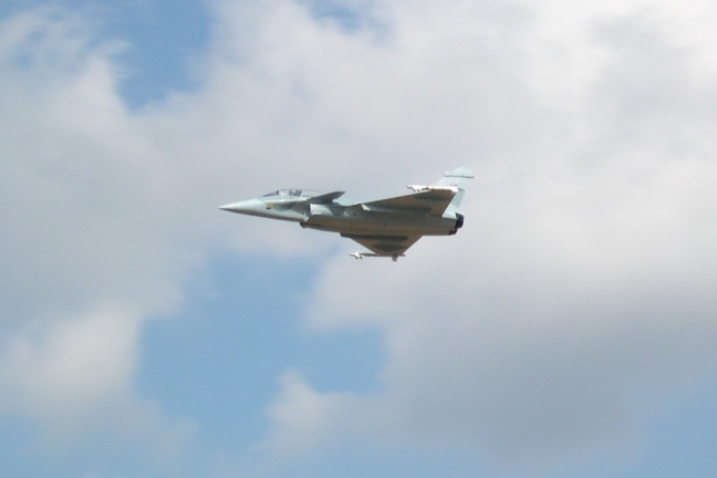

Neelesh,
I have been flying my BVM Rafale single with a JR 1221 rx without any problems. All things considered, the larger Weatronic rx would be preferable but fitting it in the Rafale could be a chalange. The Micro would probably be fine although you will probably need a matchbox or two...I need one even with a 12X transmitter.
FYI, if you want to be able to do high-alpha stuff with your Rafale (which it does great), you might want to consider using the ail/elev on each wing as an elvon (i.e. they both move in unison on each wing). The mixing is a little complicated but it can be done with a 10X or 12X and with Futaba radios I'm sure.
Either way the Rafale is a great flying jet.
Craig

Sounds like a good plan. I will be glad to answer any questions you may have. FYI, I've got an AMT USA AT-450 (olympus) in mine.
Craig
Sure is a beauty. Thanks for sharing the pictures. Always very helpful to see pictures of the install.
