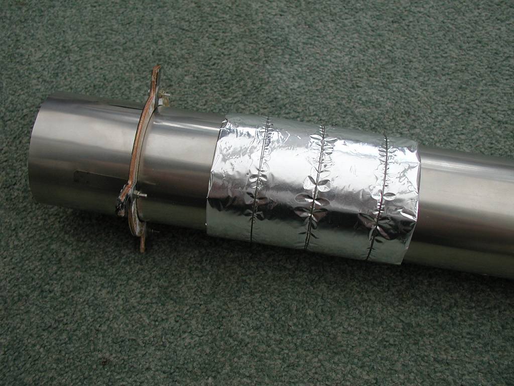

Hello Gents
...on one of my new toys i was thinking to cover my pipe with Ceramic Blanket http://dreamworksrc.com/catalog/prod...roducts_id=443
just to keep the rear fuse heat low..anyone fly with a setup like that?
since this blanket is fragile how you keep it in place?
maybe carbon kevlar or fiberglass cloth over it ?
thanx in advance for any reply[8D]

Hi George. On my trusty Avonds F15. I covered the blanket with thick aluminium foil & secured the lot with tie wire. It lasted years.

I did the same as Jascat100 on my Avonds F-104...here's a pic...
Cheers,
Dick

Jim the way i see it its easyer to try hold it on the pipe rather against the fuse..
Dick thanx for the photo mate!

The blancket is wrapped around the pipe and secured with a few dots of high temp ceramic adhesive from Cotronics:
http://www.cotronics.com/WEB%20SHEETS/940HT.pdf
The lap over area is sealed with a 1" high temperature aluminium tape:
http://www.mcmaster.com/#7594a8/=5l7ie1
That is bullet proof.
