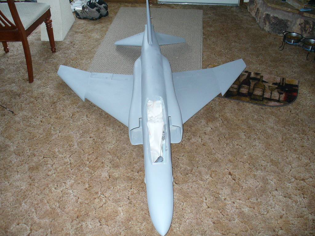

Yeah I know I may get flamed by all you turbine drivers but ehhh here are a few pics of my pusher prop F-4 I am building. 85" long and almost done.

That's some damn nice work.. I'm ALWAYS impressed by someone who takes the time to build these days.. You read the forums around here and you see people calling assembly of ARF's as build threads..

looks like a great candidate for edf conversion, to me.

You can't get flamed for building like that!
Way too impressive.
Do you have any build pics?

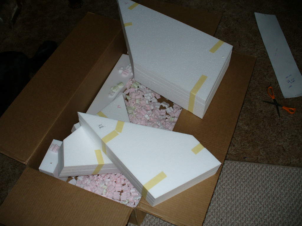

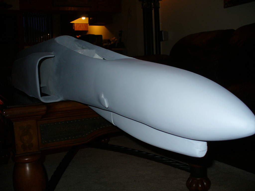

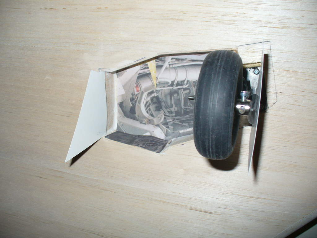

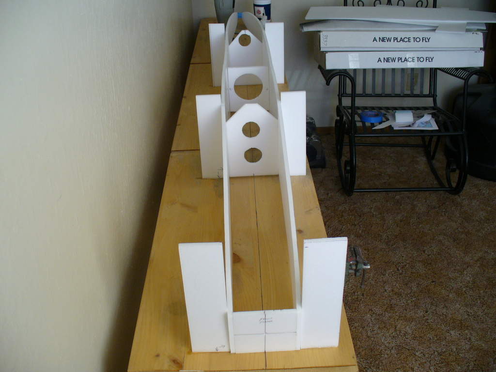

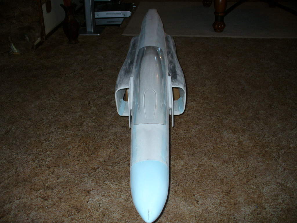

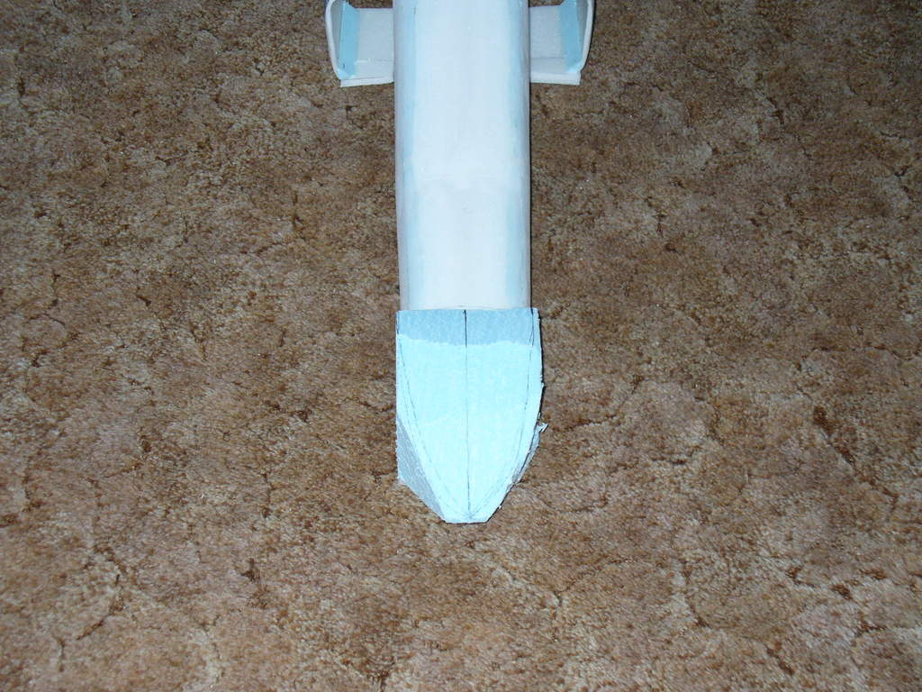

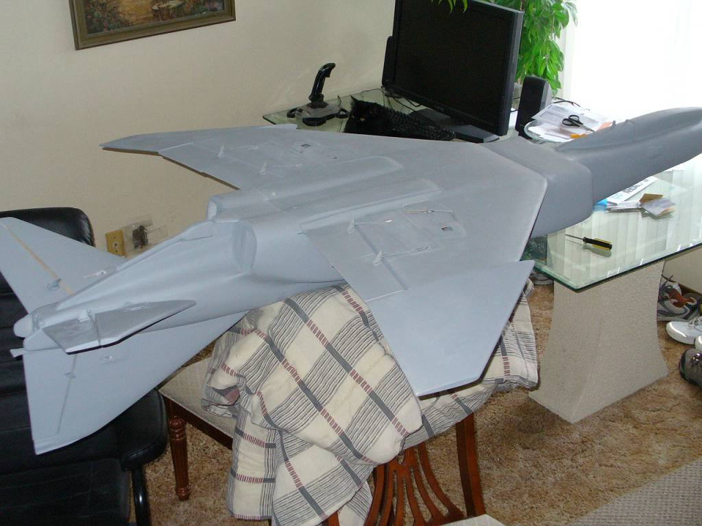

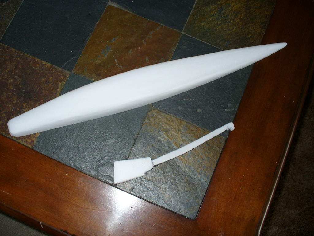

Wow thanks guys for all the kind words. here are a few build pics. I have the tail hook working and put burner lights on it as well.
Yes electric powered, pusher prop. 12X6 prop 14,000 rpm..13 pounds thrust..AUW 13.5 lbs. 57" wing span, 85" long

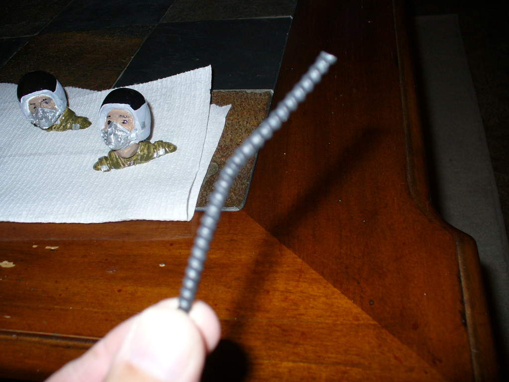

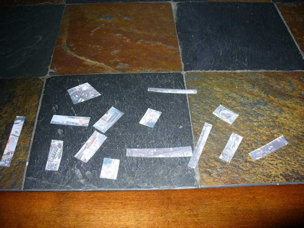

Here are a few more build pics. Made the ejection seat handels out of 4-40 rod and just bent it to shape. Cockpit pics are pics of an F-4 cockpit and shrunk down on the computer and printed then cut out and glued to the tray. I hand made the seats with 9mm depron foam.

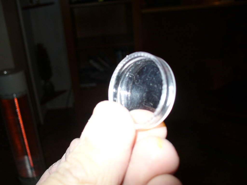

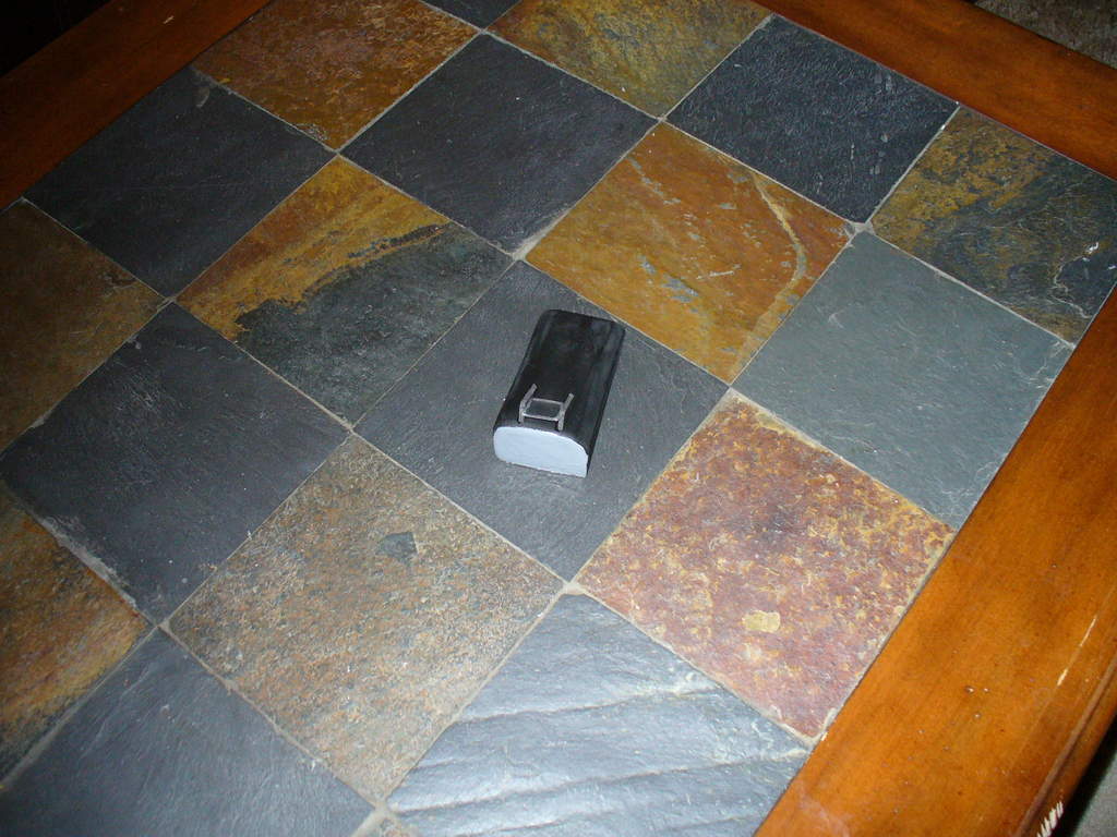

And a few more build pics. I made the HUD out of a plasitc magnet case and grinded it down flat. I will line the gear bays with photos of an actual F-4 gear bay. Ahh the pic of the box with the foam cores ariving in the mail..I sent the patterns to foamfatory.com and he cut the cores for me. Canopy is from a BVM F-4, I hand made the tray.

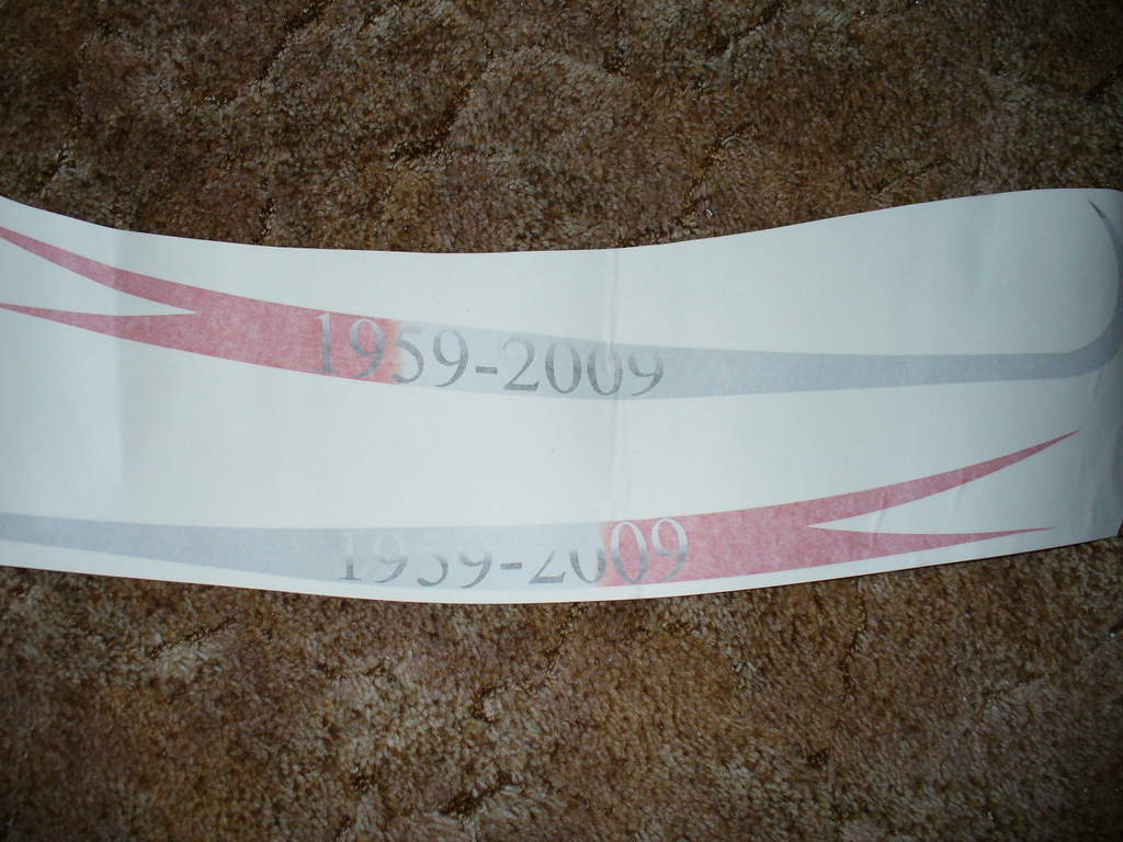

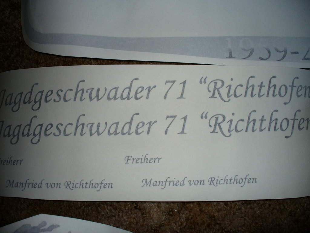

Going with an odd paint scheem on this one. A german Red Baron scheem celabrating 50 years of "Pabulous Phantoms" I sent a bunch of picturs to Callie graphics and she made up some vinal graphics for me..looks like she did great job on them. The pics of the graphics of course still have the paper cover on them but it is see through enough to kind of see the graphic under it.

Cool scheme,I am suprised this is the first time I have seen it.
