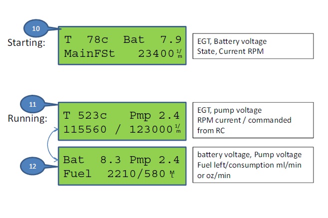

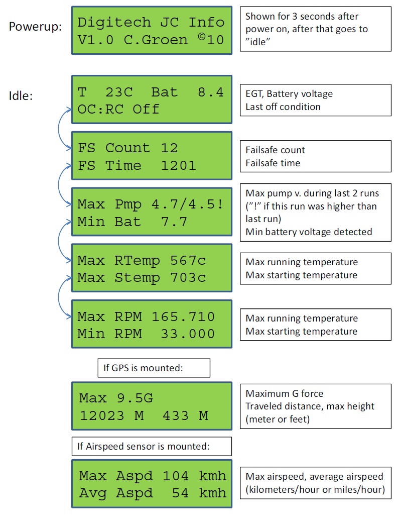

Hi Guy's,
thanks for all the input so far, it's nice to get feedback [8D]
I have changed the screens a little, it is correct that there is a lot of info to display, but my feeling is that so long as it is in idle mode, it doesn't hurt that much ?!
Anyway, this is what I have come up with so far, I hope that Sandor can have one of the prototypes with him to Florida Jets, but it all depends on how fast the post is between Denmark and the Netherlands
PS: The GPS and airsensor screens are TBD, I need to connect the equipment to one of my planes and have a flight to see the actual data, and how it behaves...

ORIGINAL: cgroen
I see 2 options for helping keep people happy if there are many screens to cycle through.
1) Allow user to configure which of the many screens they want to have displayed. Sandor's comments about the unit being programmable suggest this could be done.
2) Looks like you have a mini pushbutton on the unit, just like the LED IO board has. If so, maybe set it up that the user can just press this button to change from one screen to another - that way he can go through the screens as quickly or as slowly as he wants.
Gordon

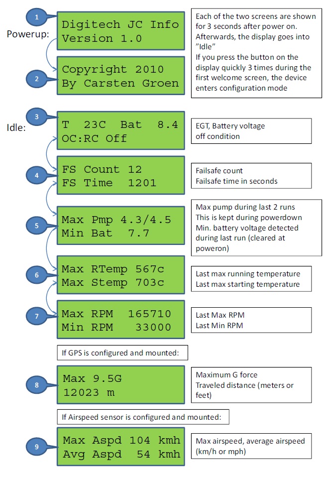

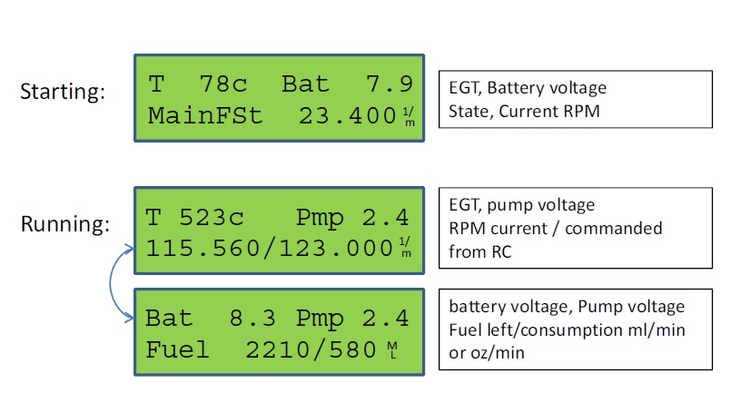

Hi Carsten,
The screen is changing a bit too fast in idle mode. Could you make each screen stay for 1/2 a second longer, this to be able to take note of the data ?
Could you have two screen options available ?
One with auto screen loop as seen on the video
One with manual screen change (when activating the small push button on the control board) ?
That way, people who don't want all the detailed data just get the main screens but still have the possibility to browse through the screens by pushing the small button.
Also, in idle mode could you have the turbine state displayed on the lower left corner?
This way people could have all the information available on the I/O board and get rid of it. ( in case programming would be required, we could disconnect the data cable from the control board and plug the GSU in )
The idle display would look like this:
Temp......Bat
State.......Off cond
and the start display like this:
Temp.....Bat
State.....Current RPM
So you'd have only one data changing between the two sequences.

Oliver, I changed the time between the screens in idle, you were right, that was too fast.
The idea with the button is also a nice one, I'll consider making that user-selectable
However, I don't quite follow the idea having the state shown in idle mode, it is always the same (slowdown), so not much use ?
And the off-condition can be pretty long text (f.ex "AcclTimeOut"), and there would only be 7 chars left for that one
