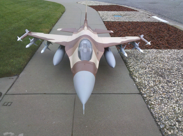

This is a very timely thread. I will be flying my F-16 with a full load for the first time this weekend. I plan on checking the balance since I am adding some additional electronics in addition to the stores.
Craig

Craig,
You know how much I love the F-16 1/6 scale! I was considering adding a Gyro since I was getting some pretty good tail wagging. But decided to wait till after I added the rails and missiles...glad I did. It "evened" the plane out completely, actually flew more stable and better with the full missile load (not the center tank or large stores).
I did check the CG after installing the ordinance and it was no difference at all.

ORIGINAL: dubd
