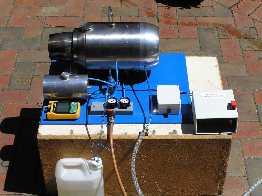

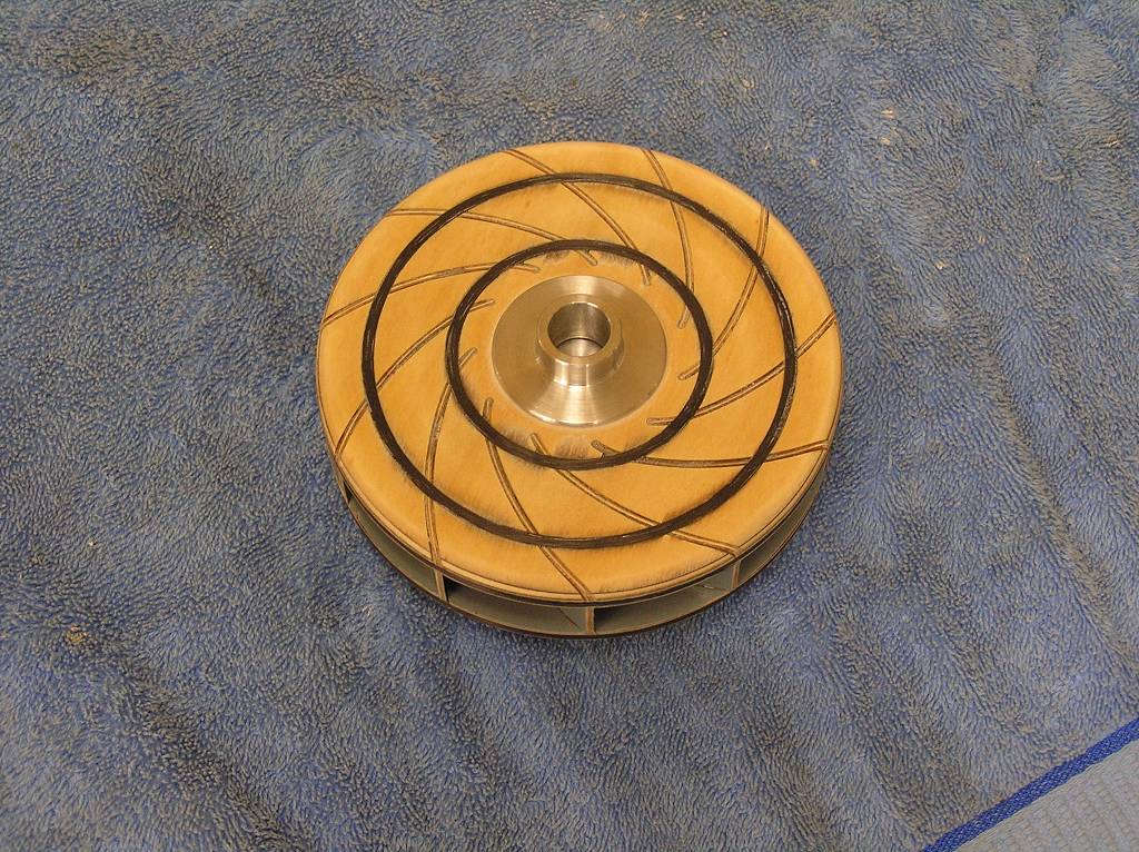

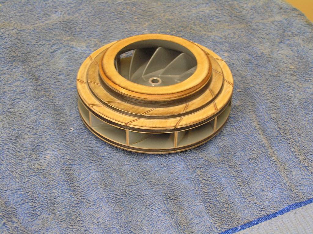

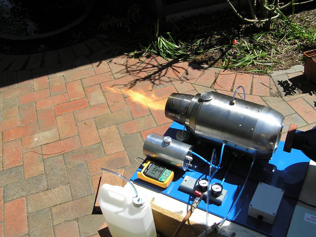

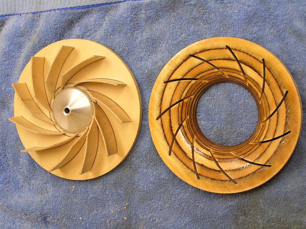

These Pic's are off my 100% enlarged Schrekling. A lot of fun but a bit scary[X(]
No ECU !!!
Cheers,
Paul
