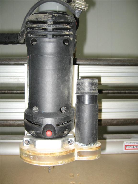

I have a home made unit, they are fairly easy to build. Currently run it on Mach 3 and use Bobcad to translate the files to G-Code. Quick, easy and within .002.

lov2flyrc
What are you using for your rails that the gantry moves on
Old 05-05-2010 | 12:32 PM
ianober's Avatar
My Feedback: (12)
Joined: Aug 2002
Posts: 4,462
From: Scottsdale, AZ
Default RE: CNC Machine
Looks like Todd is using pipe or drill rod like many other designs. Roller bearings in a "V" configuration, not a bad setup Todd.

My Machine is built from extruded aluminum box rails with aluminum plates for the gantry and steel tubing for the slide rails. Aluminum angle and roller bearings where used to create the slides. Although this system works perfectly, If I where to build another I would probably go with linear slides for the gantry just to add additional precision. I can cut 1/4" ply at about 20-25in/min, balsa can be cut as fast as I desire. I have cut aluminum with this machine but it is hard on the router.

Todd, upgrade that rotozip to something a little more manly!!
Old 05-05-2010 | 04:24 PM
lov2flyrc's Avatar
My Feedback: (24)
Posts: 6,102
From: Daytona Beach
ORIGINAL: ianober
LOL.... Well, I would if I needed too; but that rotozip has cut literally thousands of parts and cuts just fine for my needs. If I was cutting some real heavy material I would change it out to a router with more grunt but the cheapo rotozip does just fine for me
