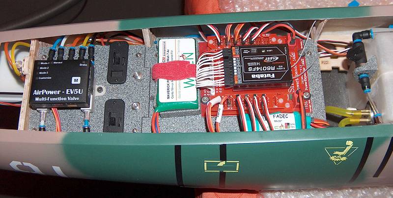

Mine is first generation (over two years old). The plane is 10.5kg with full tanks. Engine is wren supersport.
Flies great, glides well at that weight. After all the mods I made, it's a really good plane.
Yann

ORIGINAL: Yann
Yann
Yann,Really nice install you did...Clean.

Thanks. Very effective and convenient for maintenance.
The only issue I found with this brand is they sell their products as ARFs... while they are not !

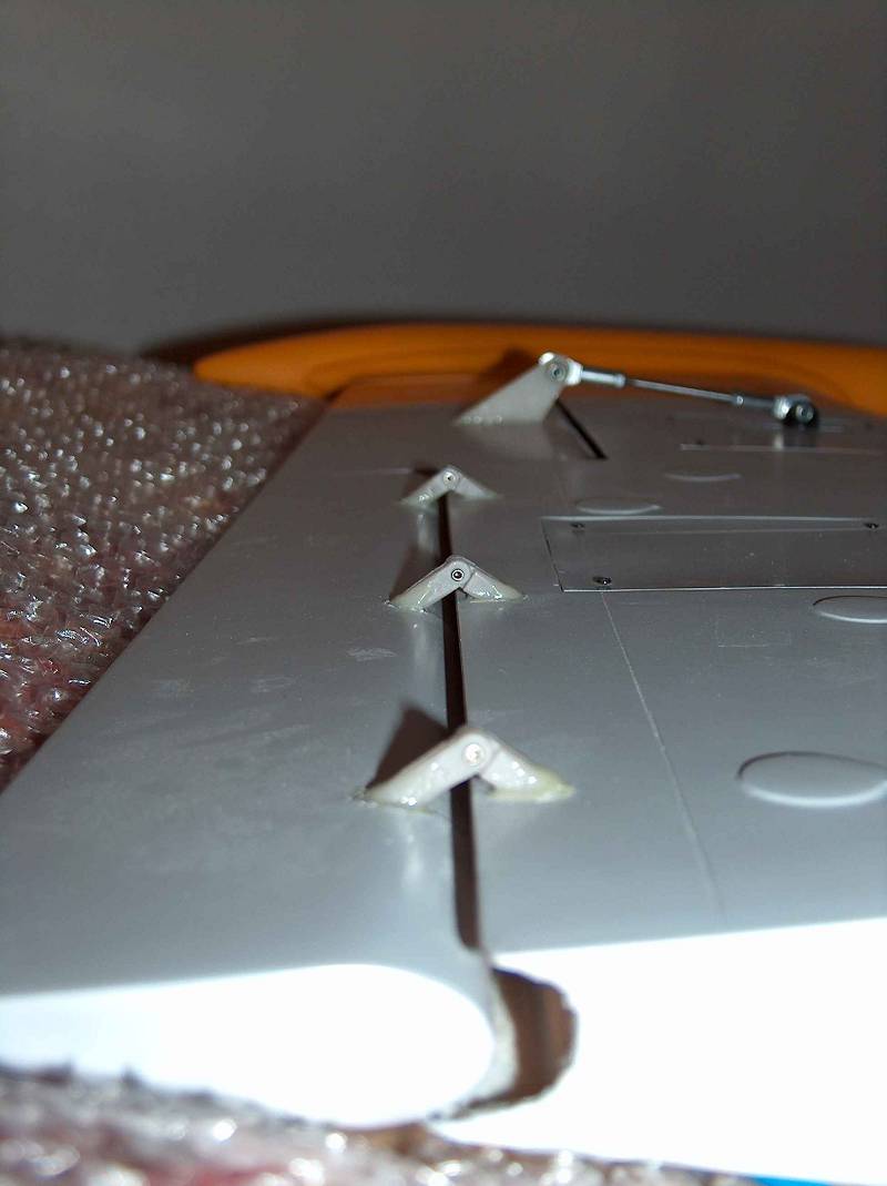

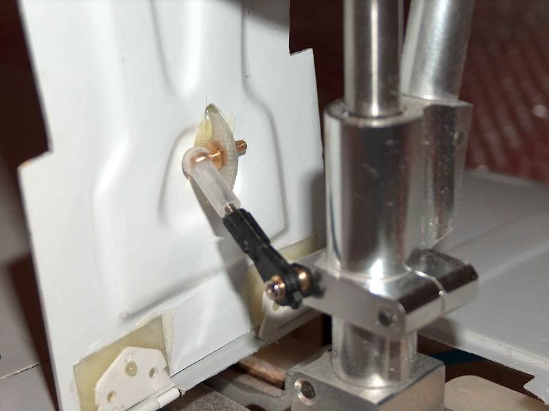

Old 06-28-2011 | 07:36 AM
Joined: Mar 2004
Posts: 1,297
From: Aix en Provence, FRANCE
Default RE: FEJ L39 1/7TH
Oh god !!! that was the question I didn't want you to ask...
On the fuse: Changed the rudder setup.
Changed the thrust pipe for a wren pipe.
Removed (easily) most of the formers, to change them. plywood was not up to my standards.
Changed the turbine beams to suit the small footprint of my wren.

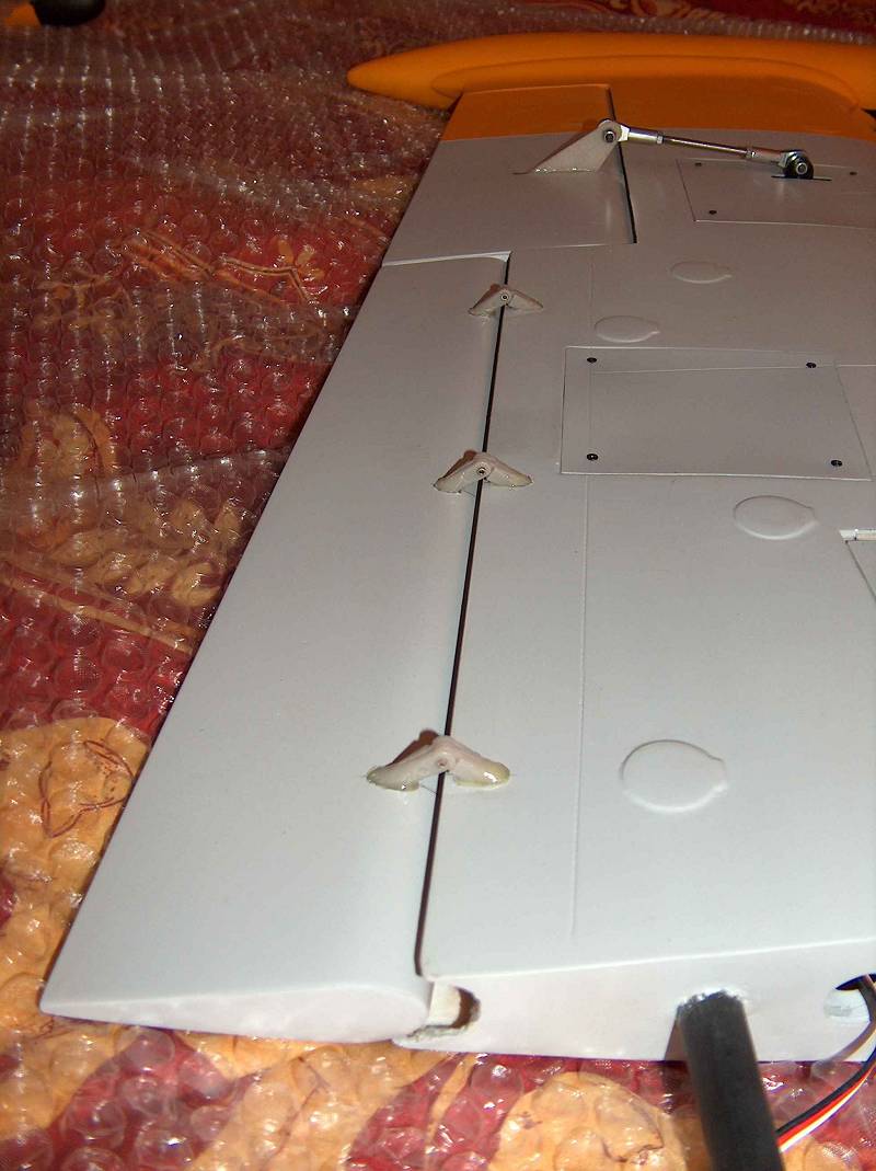

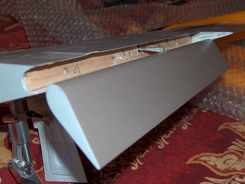

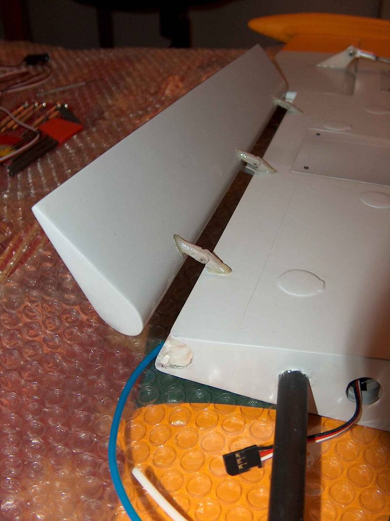

Wings: Custom made new springs for oleos (absolutely necessary)
Changed O-ring brakes for regular rim brakes. I could not brake evenly with stock ones.

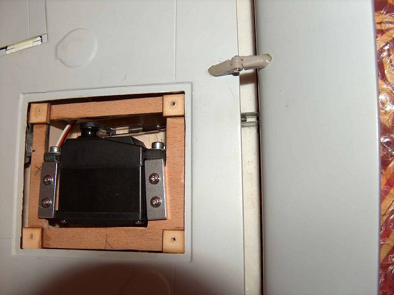

Changed most of the servo pockets as some of those parts were missing from my kit. So I dit it all over, my way.
Modified flaps setup as well, to allow more deflection.
Modified main gear doors my own way. Still don't understand how FEJ wanted me to do it.
That's it for the most important parts. There is more, but that was more on the cosmetic side...

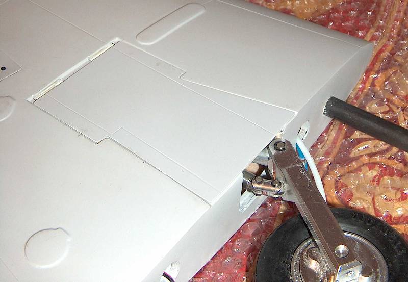

Old 06-28-2011 | 07:40 AM
Joined: Mar 2004
Posts: 1,297
You see how the plane stands higher off the ground with custom springs?
Few more shots of flap setup.

Also main retract bay has been heavily reinforced with carbon fiber after the first fight (after the pics were taken). The stock wood is far from perfect and cannot be removed.

OK, so you're good with the formers. Yes, I might be able to provide you with a set of spring the stock springs are way too weak.
FEJ, at the time I asked, was not able to provide different stiffness of springs.
The flap mod is very important too. It lets you come in much slower. A friend of mine had the same plane without the mods.
He was coming in mch faster.
