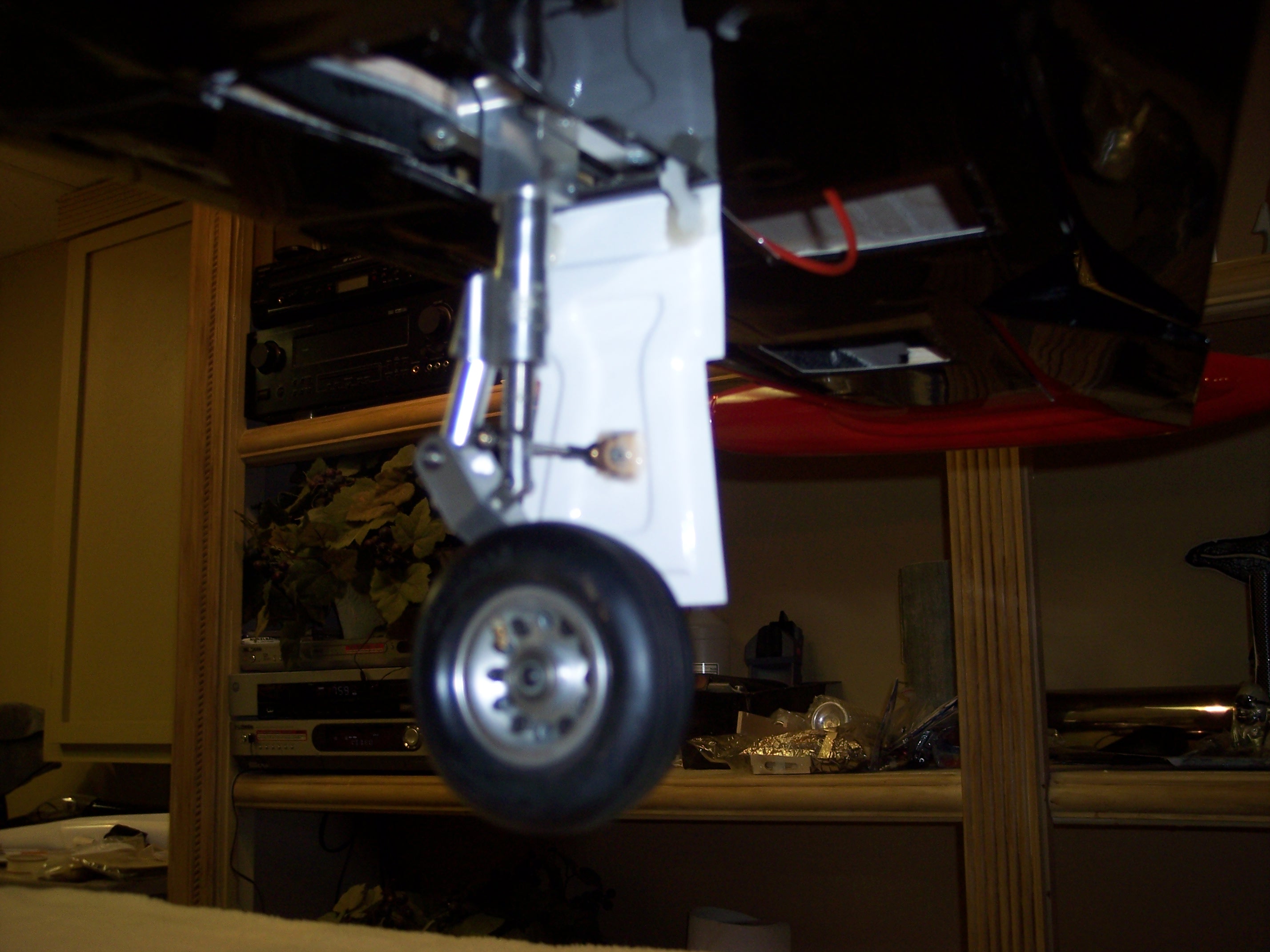

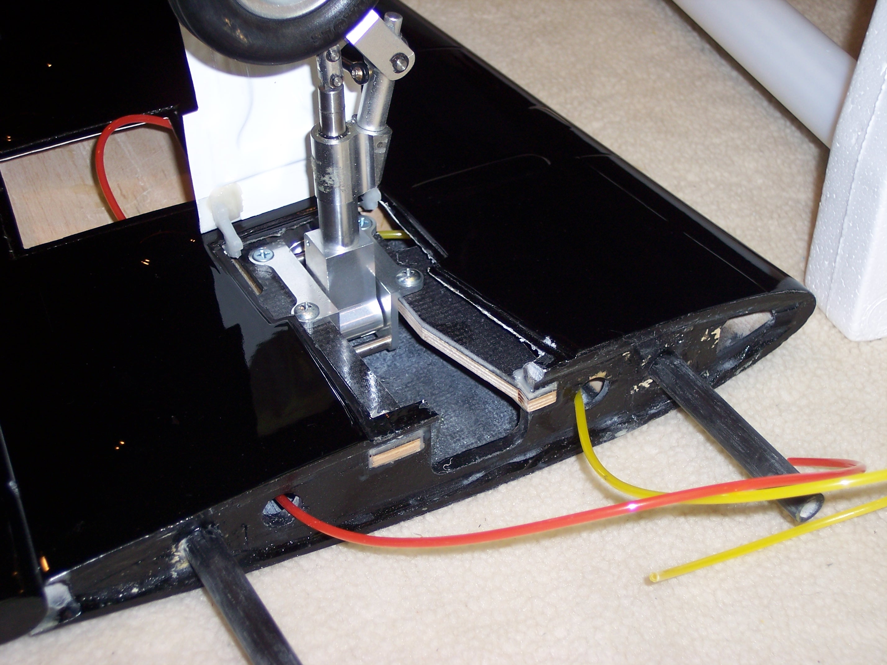

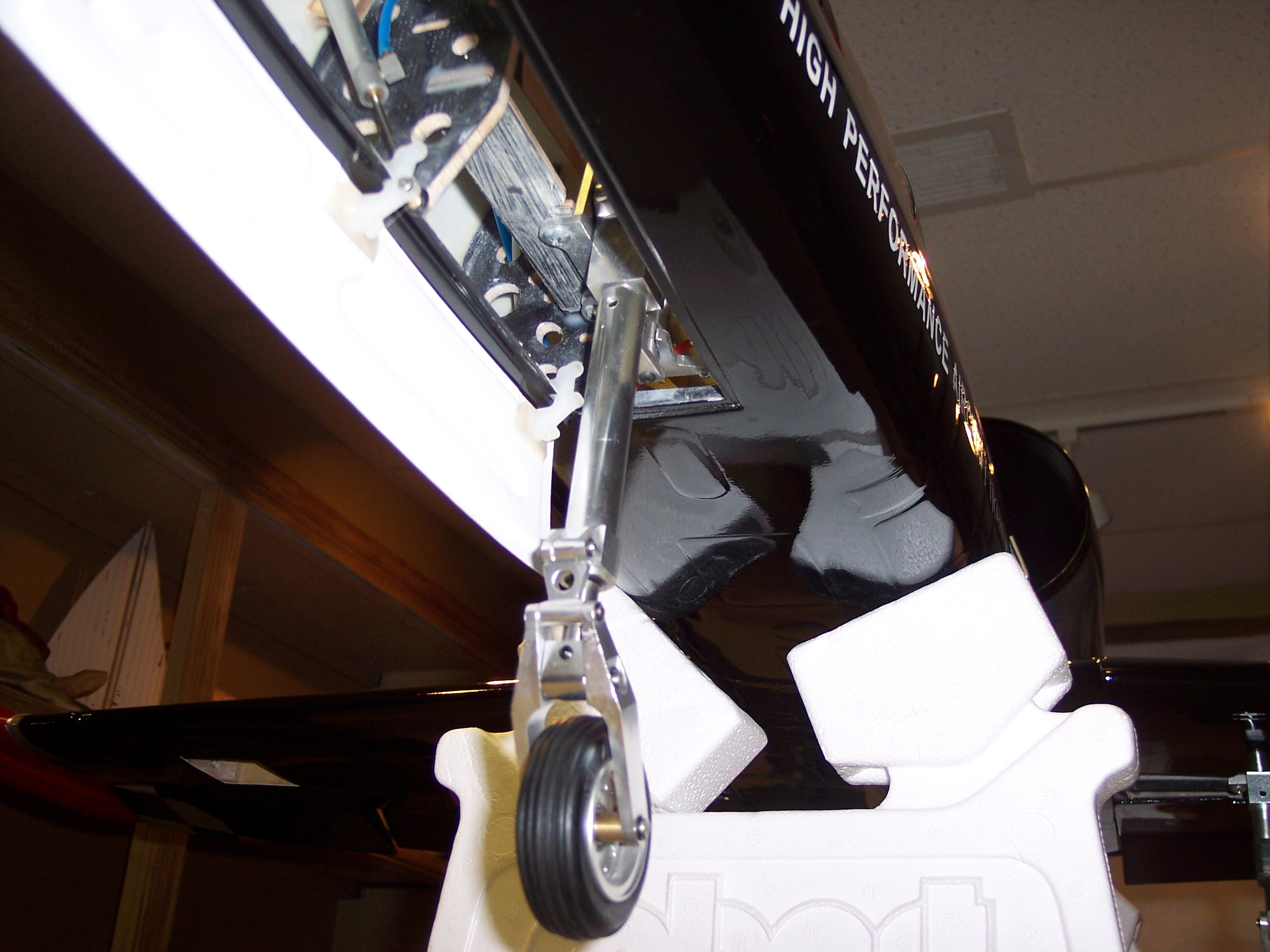

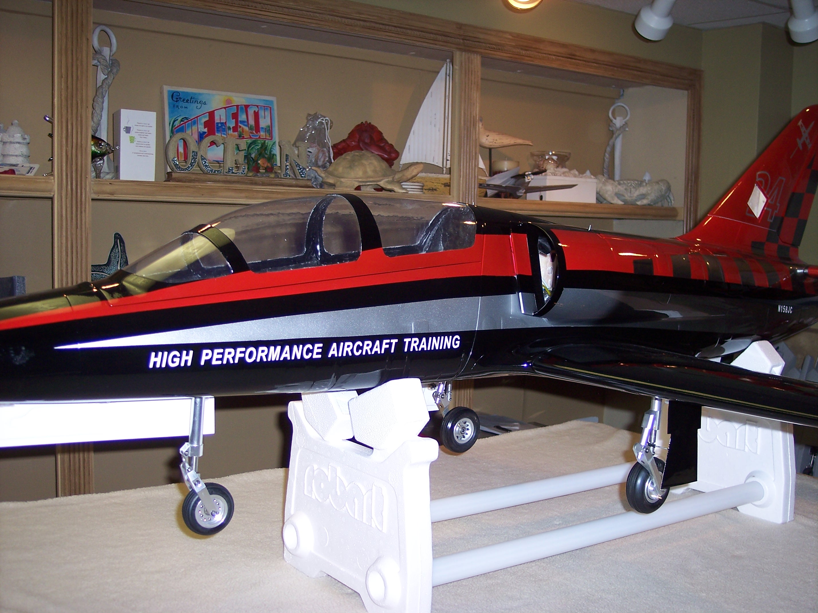

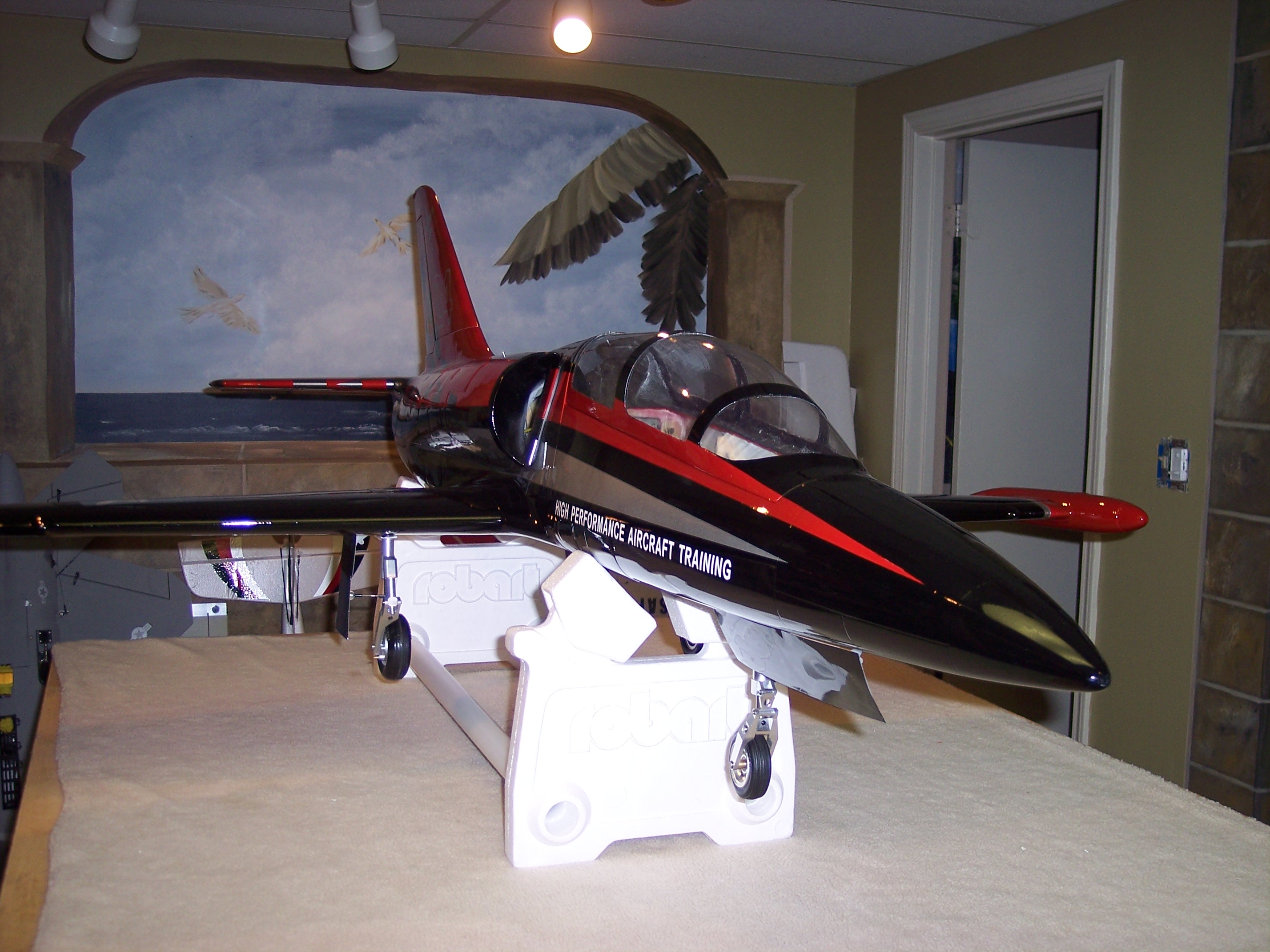

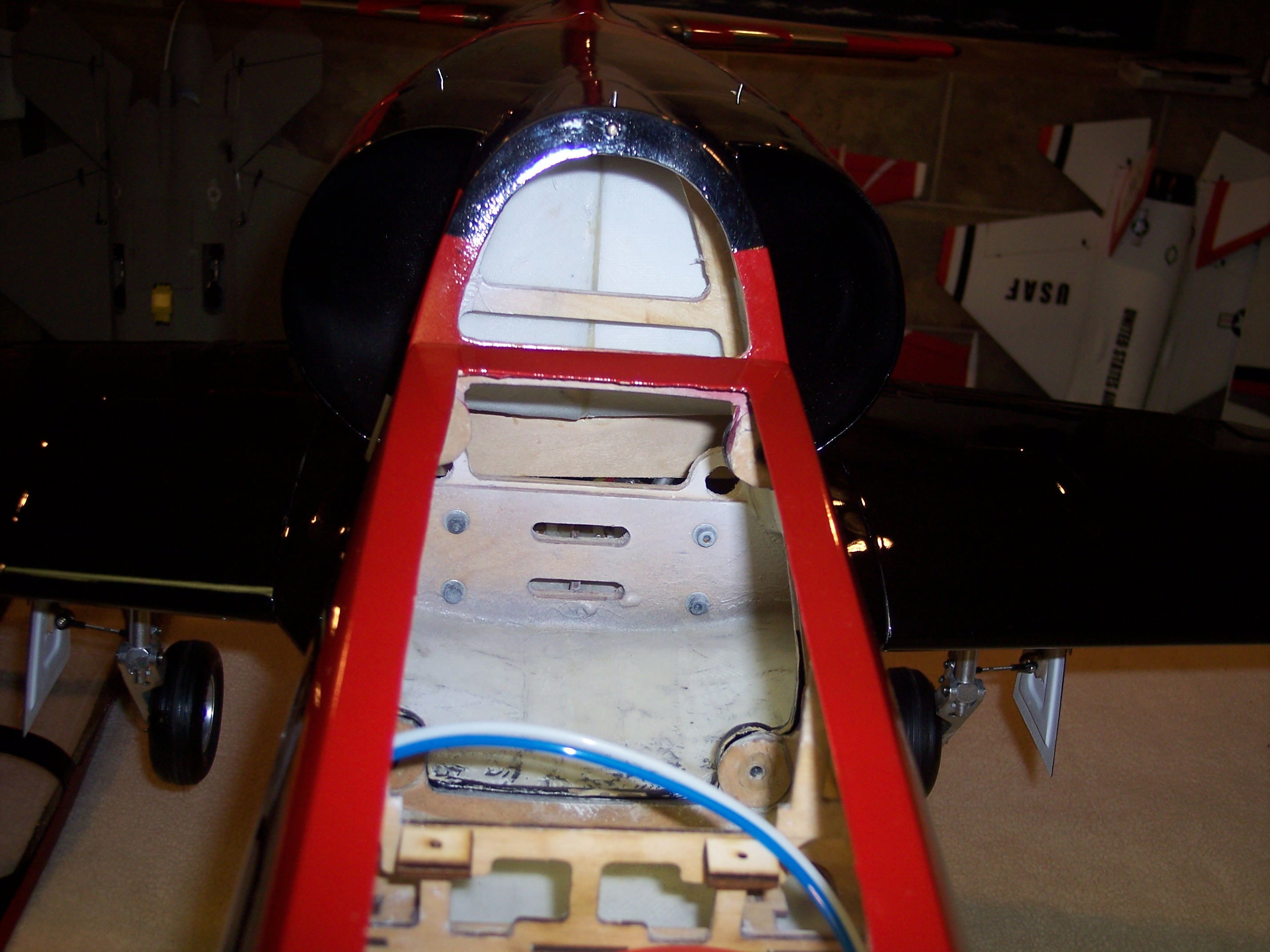

Hi gents ,Here are my L39 pic's

Nice... They seem to have improved a lot. support beams for retracts, balsa/carbon sandwich formers, overall extensive use of carbon fiber...
Mine was far from that when I opened the box.
Hope you also bought the now available kevlartank option. Mine split open twice right on the seam line... no was to fix that up.
All solved with a kevlar tank.
I'm sure it was no more pain for FEJ to make it right strait. doing it all over has been a really painful for me.
