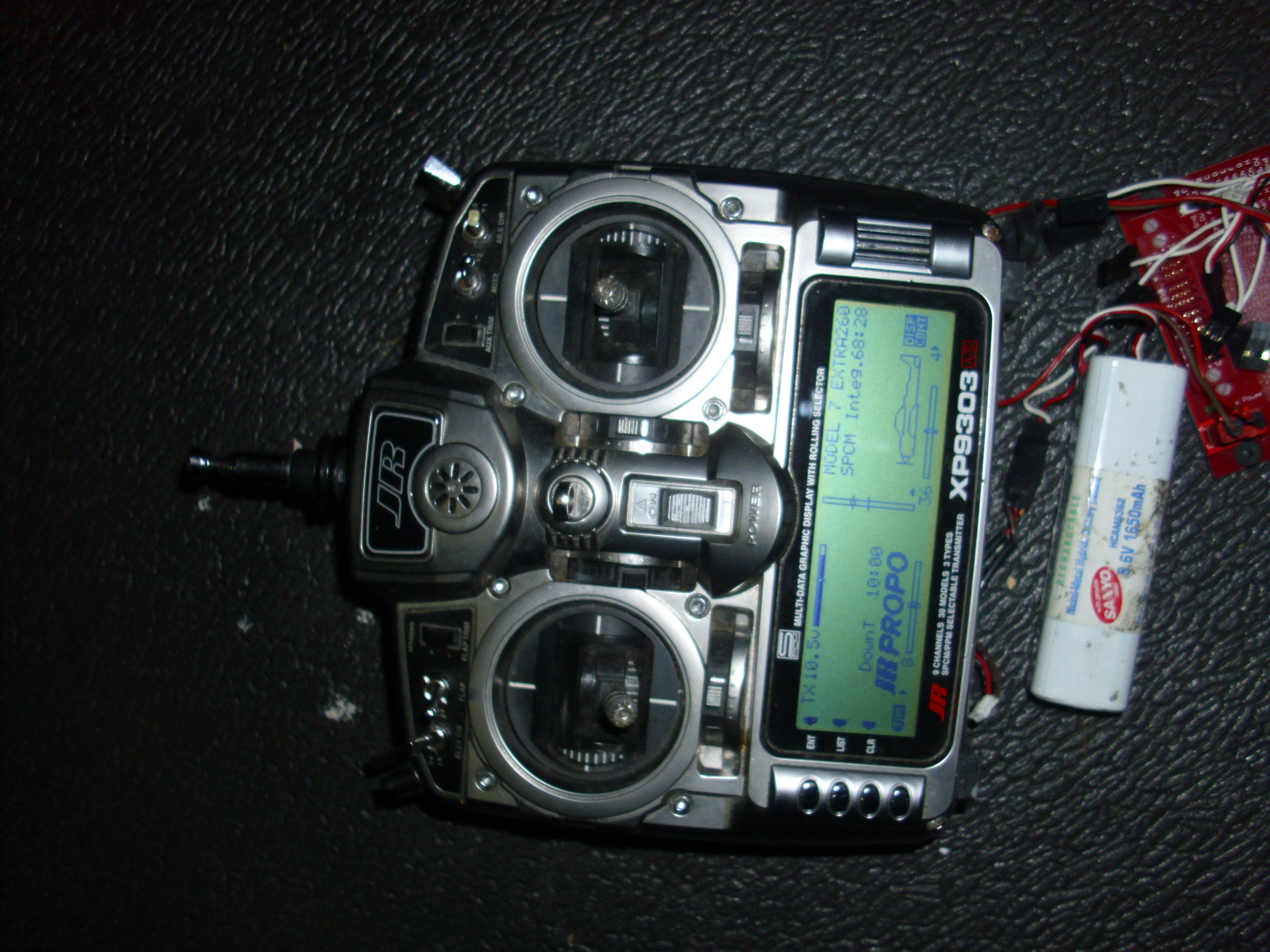

My jr9303 radio was on for 7 month [X(] All i did was replace the battery [8D].
