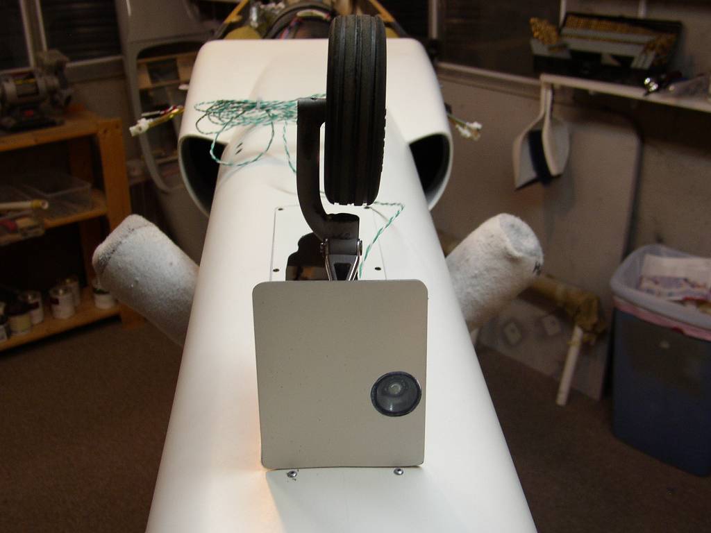

Next, I needed a reflector lense for the landing light. I took a little cheap-o $2 flashlight apart and used the reflector. I have a tight install in the nose gear bay, so I cut the reflector to the size I needed and held the Luxeon in with a few drops of CA. Next I added a clear lens cover made out of clear plastic packaging everything comes in now.

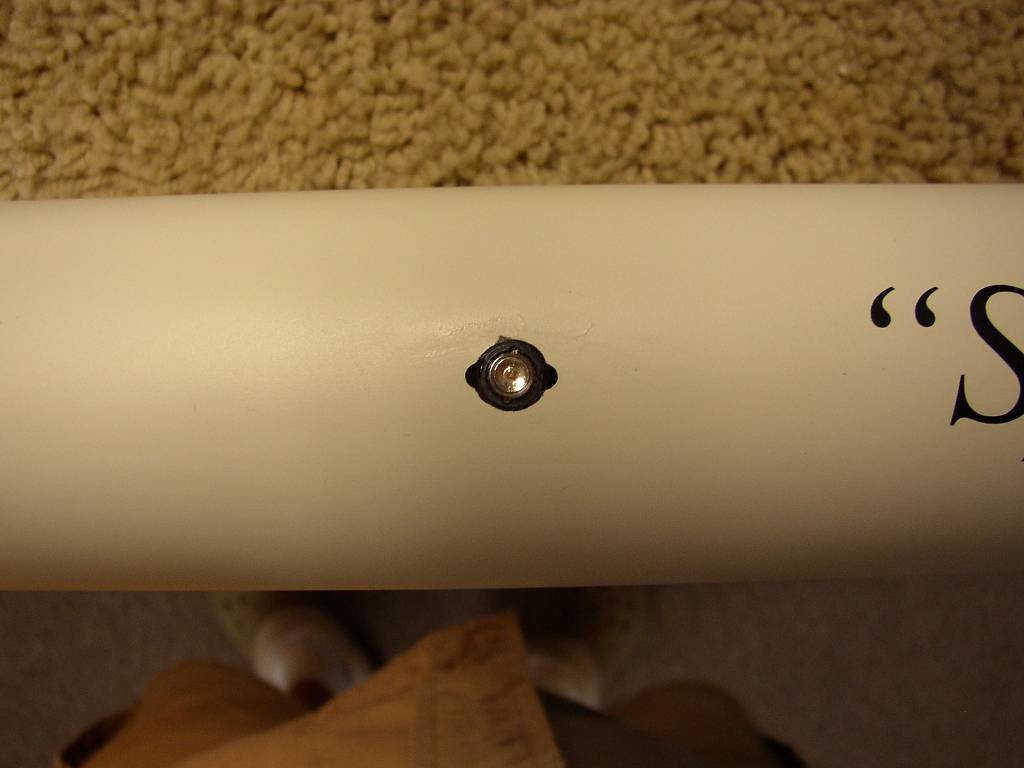

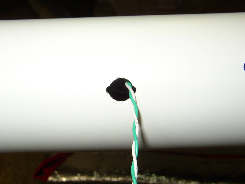

Next was to install the lights. It's going on my CARF Lighting, so I don't need scale lens covers (although easy to add if desired). I cut a hole approx 1/4" in diameter in the wing tips and top of the fuselage for the beacon. The lights are then tacked in with a very small amount of CA on the heat shrink. This way, they can be removed easily if needed for replacement and are very solid and will not move under normal useage.
Fisrt few pics show the hole needed and then last pic shows what it looks like from the inside (fuselage mounted beacon). Very quick and easy to do this way and the finished product looks nice and clean.

A few pics of the landing light installed in the nose gear door....offset to clear the strut.

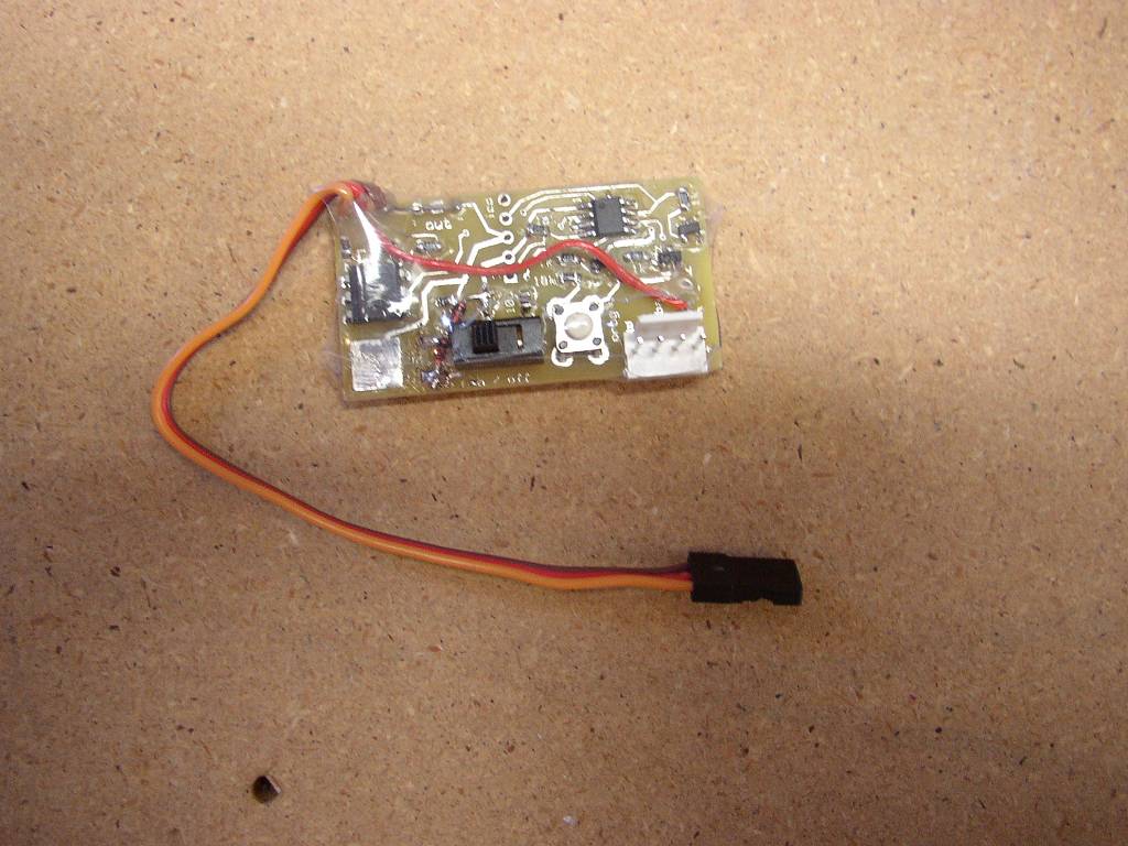

Here's a few pics of the controller board. U plug it into the gear channel and program it so the landing light is activated by the gear switch and is off when the gear is up. Notice the switch on the board and the little white programming button next to it. More about these in the video. The last pic shows it installed and tucked up in the fuselage.
