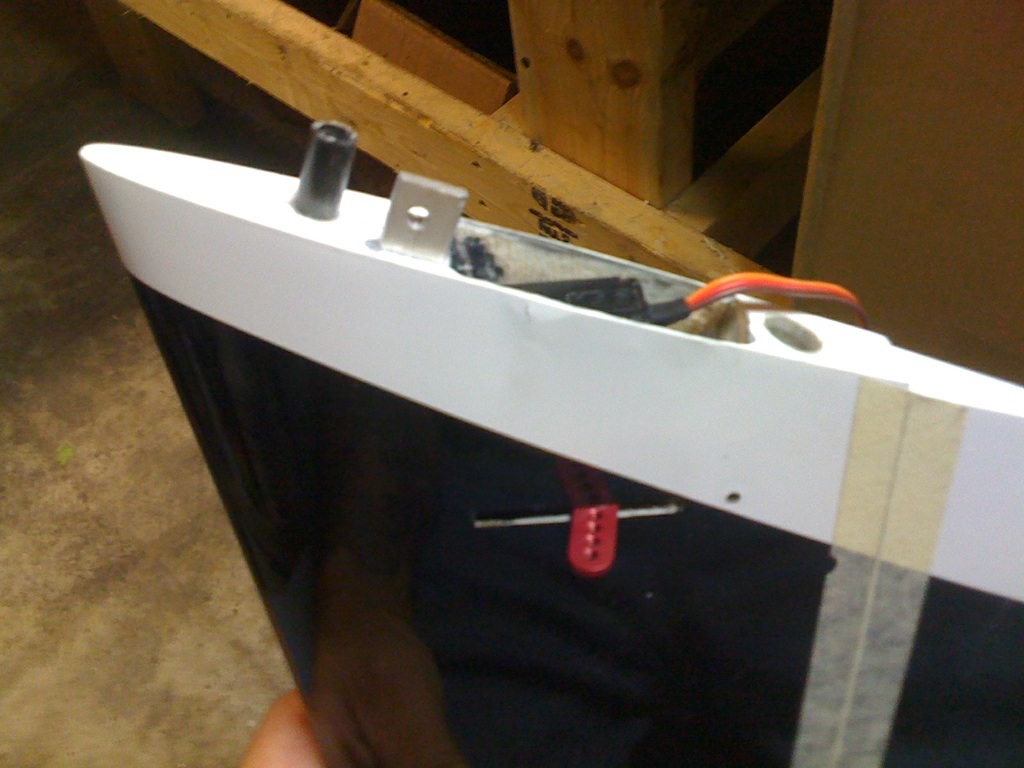

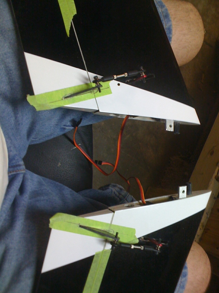

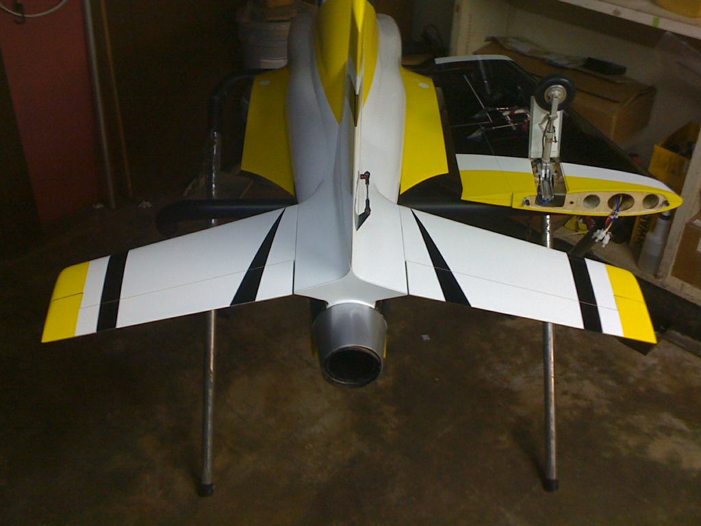

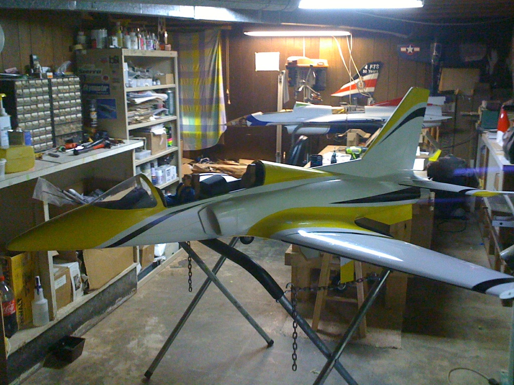

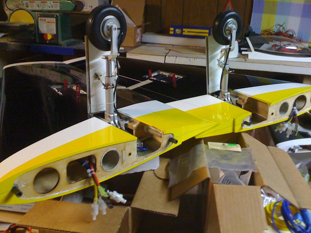

Both Wings done

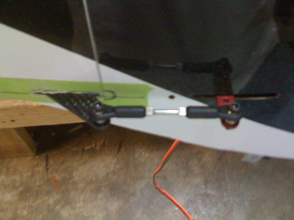

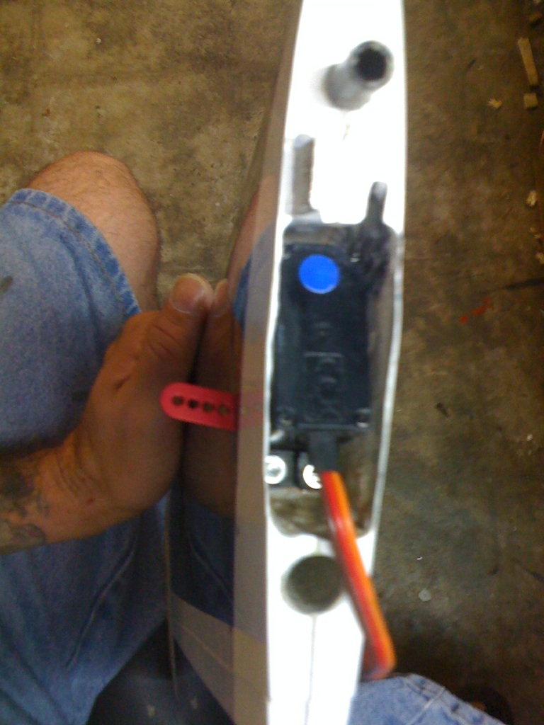

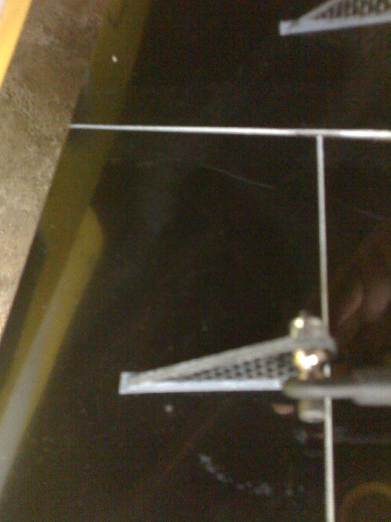

What size of swb arms did you use for the surfaces?
Old 08-05-2010 | 09:57 AM
  #53
My Feedback: (30)
Joined: Feb 2009
Posts: 687
Received 6 Likes on 5 Posts
From: Hampstead,NH
Default RE: Professional Viper 2M Build
Hey Collin,
We used 1" on Rudder, Aileron's and Elevator. We used 1 1/4" on flaps...
Old 08-05-2010 | 09:59 AM
  #54
Colin_Mc's Avatar
Joined: Feb 2006
Posts: 203
From: Scotland
Did they give you the full deflection needed?
Old 08-05-2010 | 12:14 PM
  #55
My Feedback: (30)
Joined: Feb 2009
Posts: 687
From: Hampstead,NH
Yes, we were able to get full deflection..

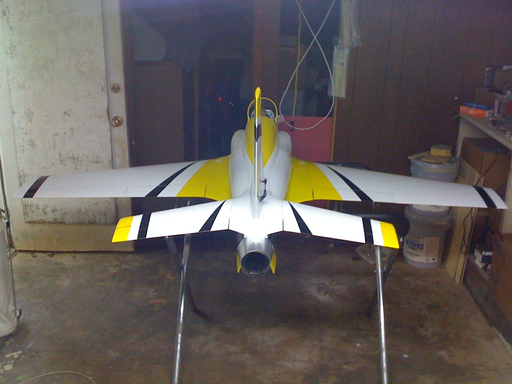

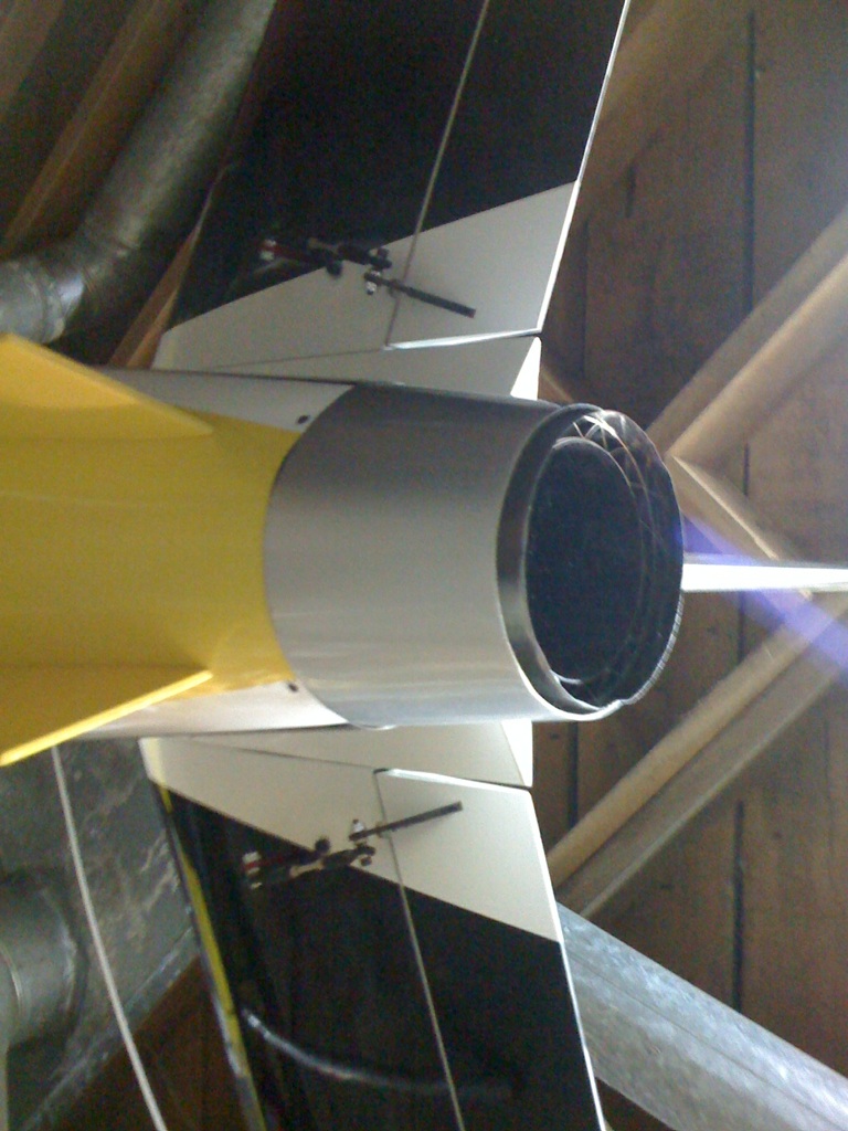

Stabs are done, should be just another day on fuse and will be able to get this thing airborne...

Wings,Stabs and Rudder all done..John is working on fuse today so hopefully I'll have some more pics later...

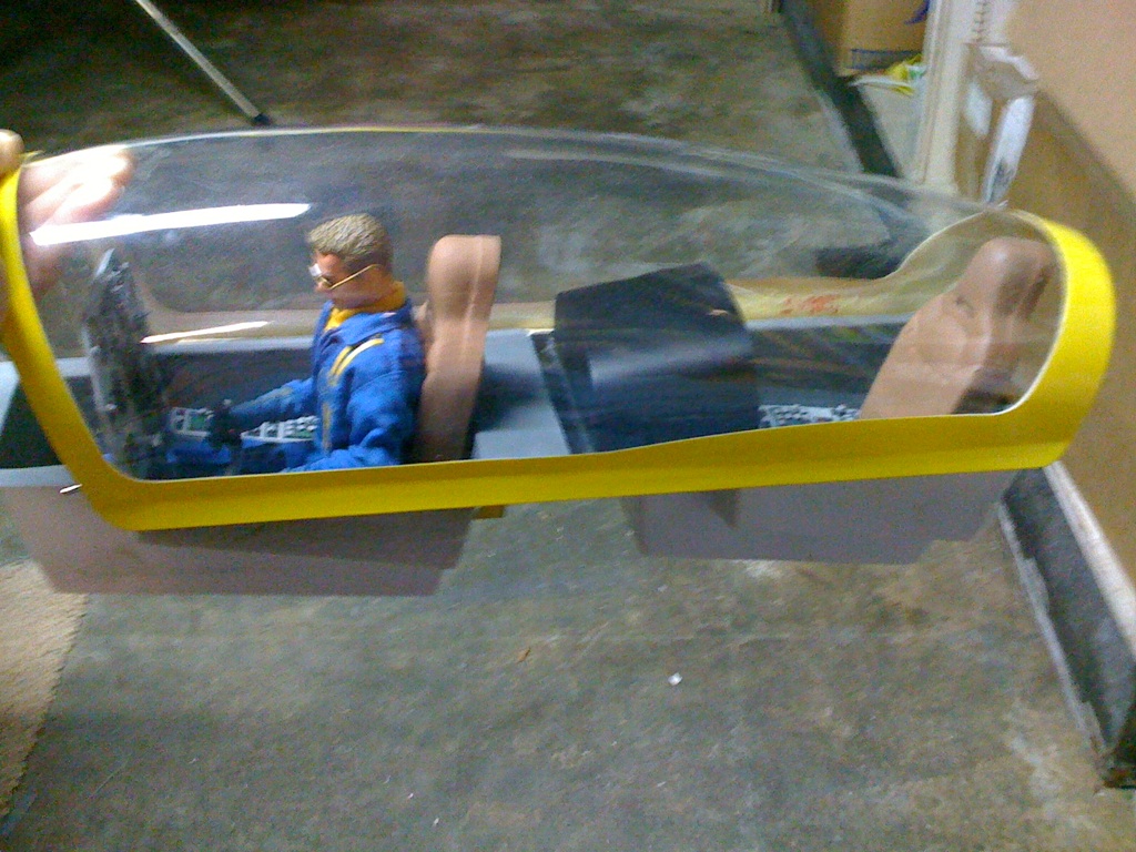

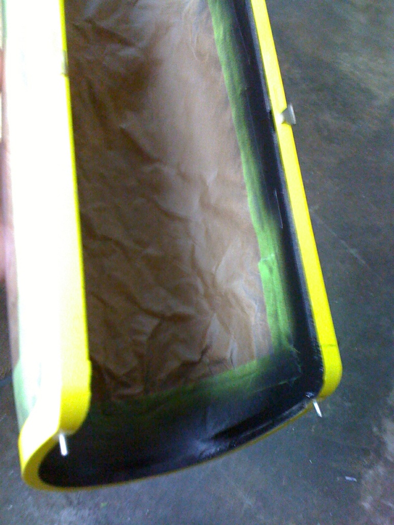

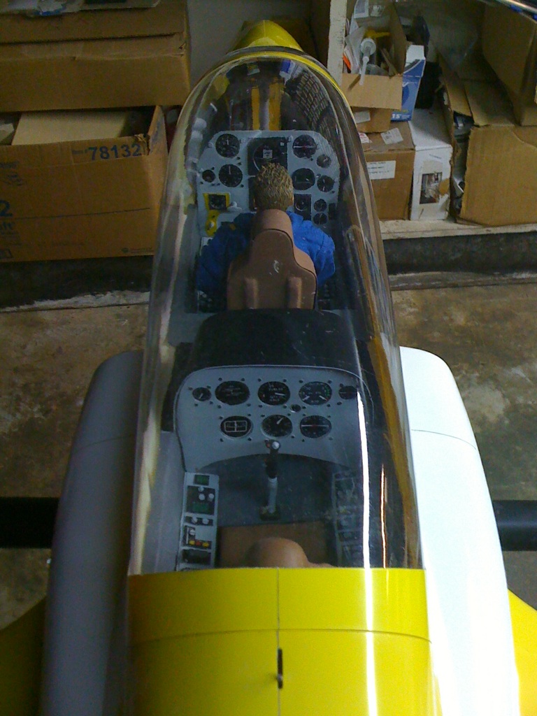

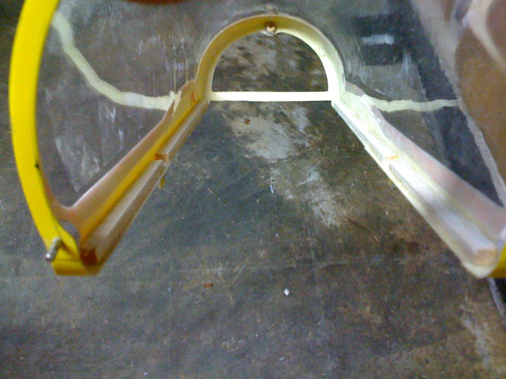

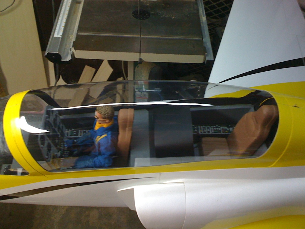

Heres some pics of the canopy. John had to add 1/4X3/8 Balsa to the bottom flange for the tubs to sit on. This will give more room for the equipment tray.

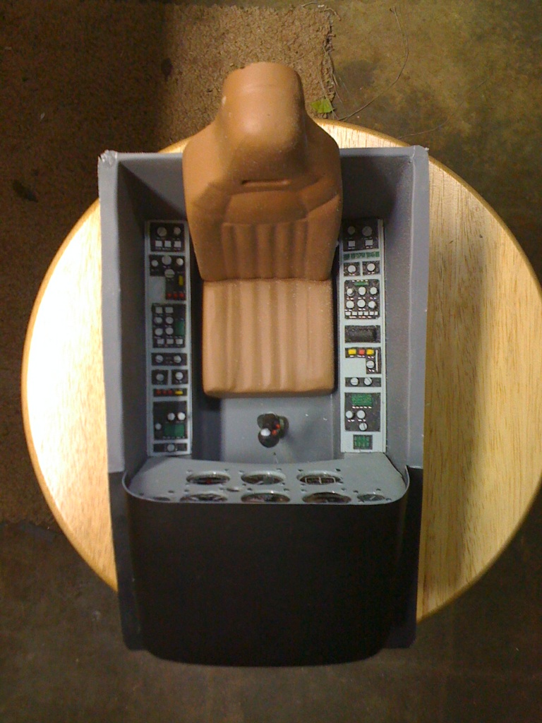

John had to cut the tubs as seen in the pics. Captn Rich is now an amputee...lol..He didnt need them anyway..

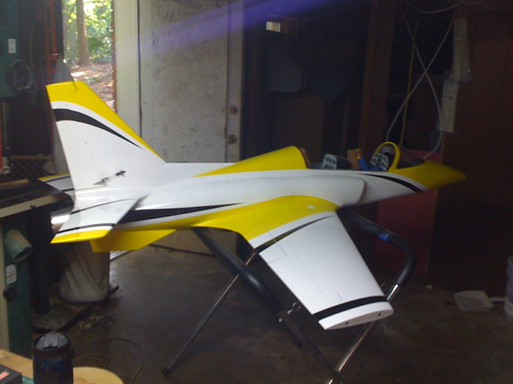

Added a little paint

Thanks for the canopy & cockpit tips [sm=thumbs_up.gif]

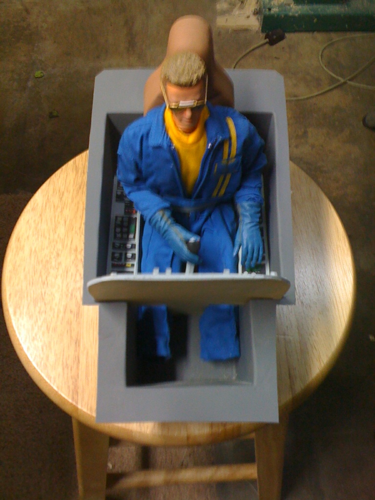

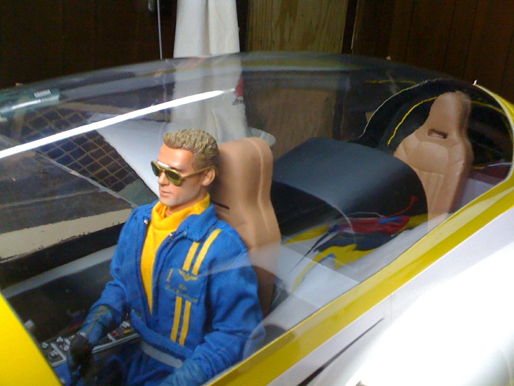

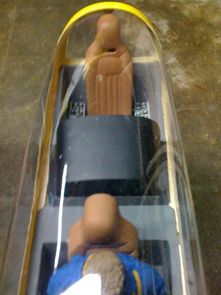

No prob..Heres some more with the paint finished. Pilot is strapped to seat, and sunglasses glued on. Hand is also glued to stick, so he isnt going anywhere..

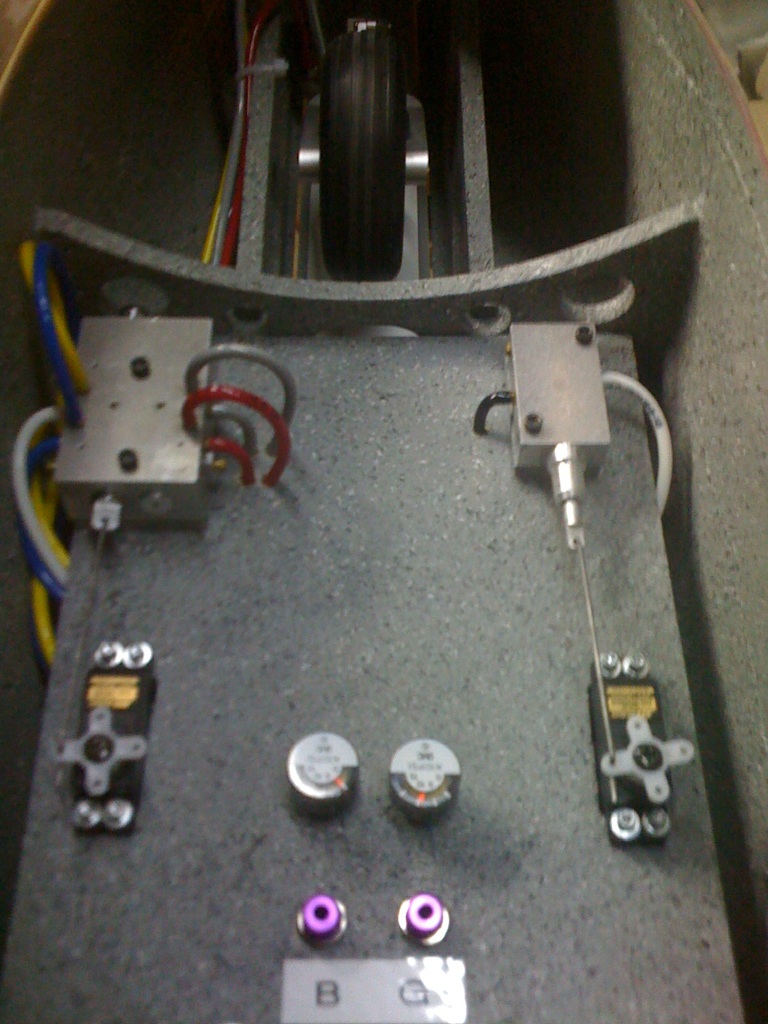

Front tray coming together...more pics to follow. Hoping for a Thursday maiden providing no glitches...John is taking his time making sure every part of this build is done right. When we talk he goes through every step of the build and what he is doing, telling me scenarios and preventions. I'm just happy knowing I am getting a solid jet..Thanks John

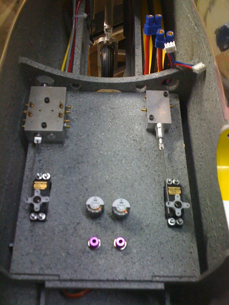

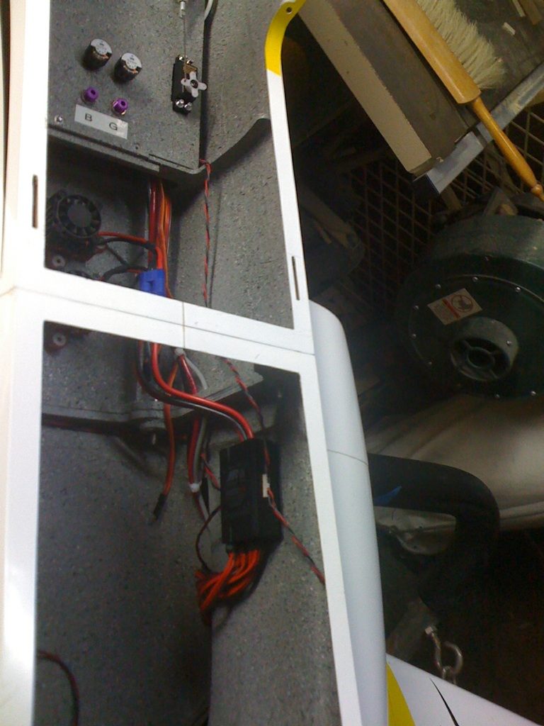

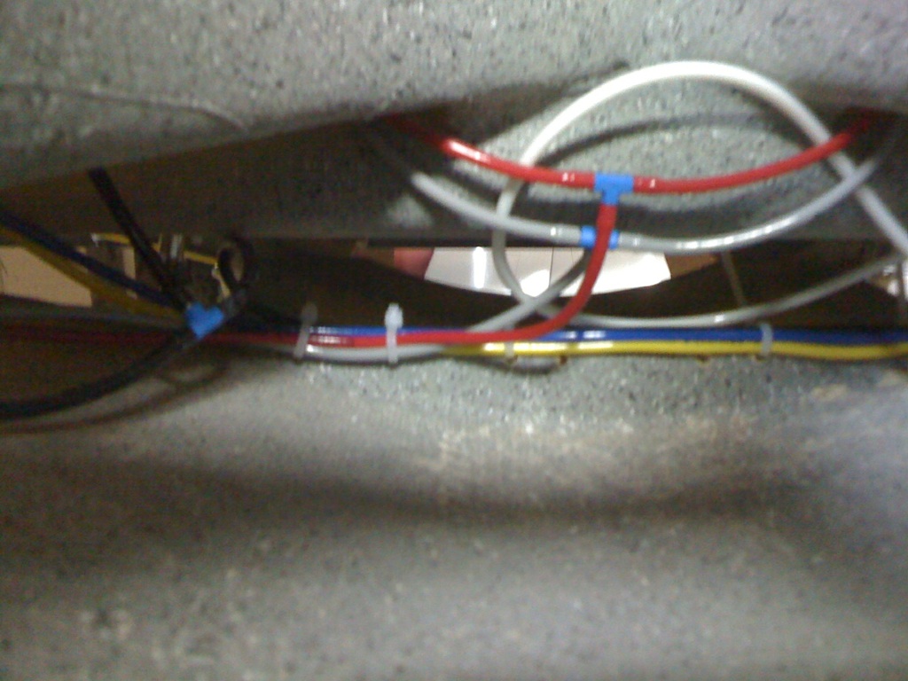

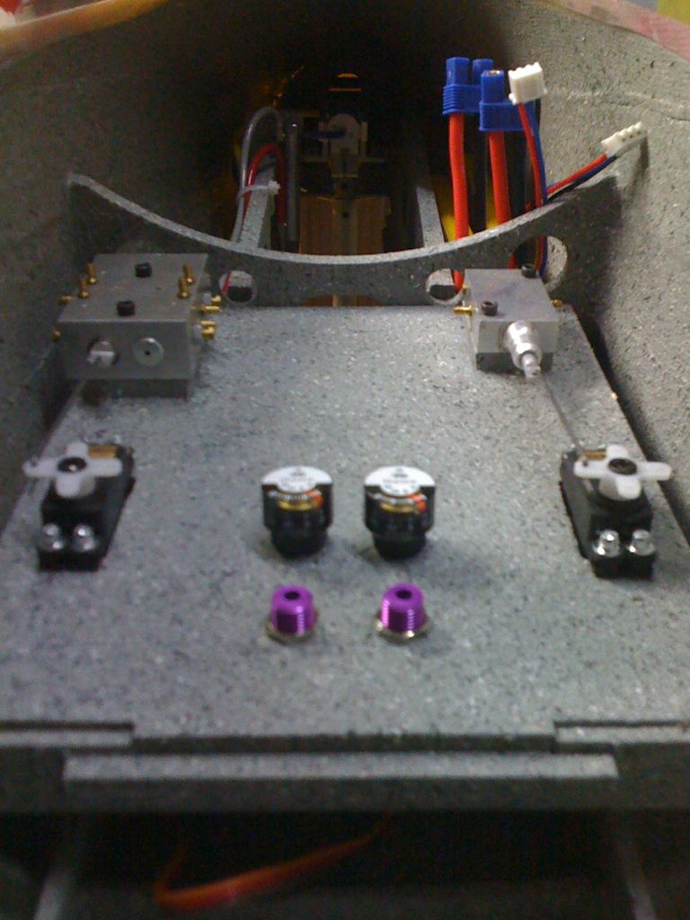

Thanks Andy, John is doing an amazing job...pics of the air system all redone and tank fitting..coming along very neat....

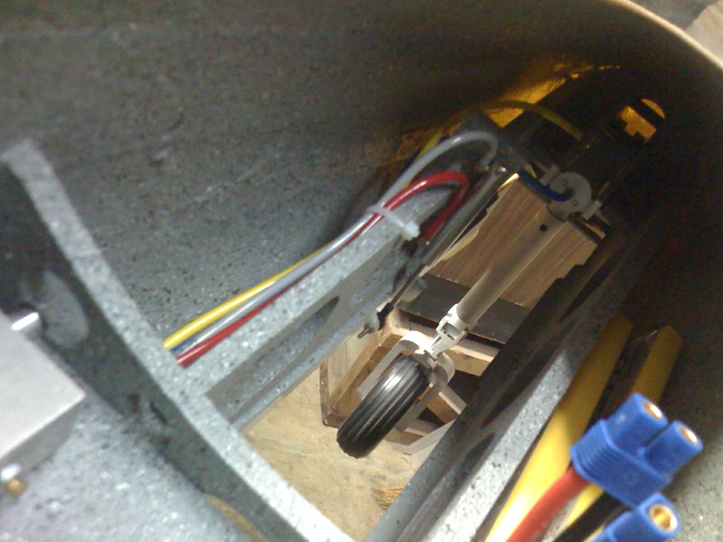

Air System Done no leaks..Trial fitting regs and receiver....
