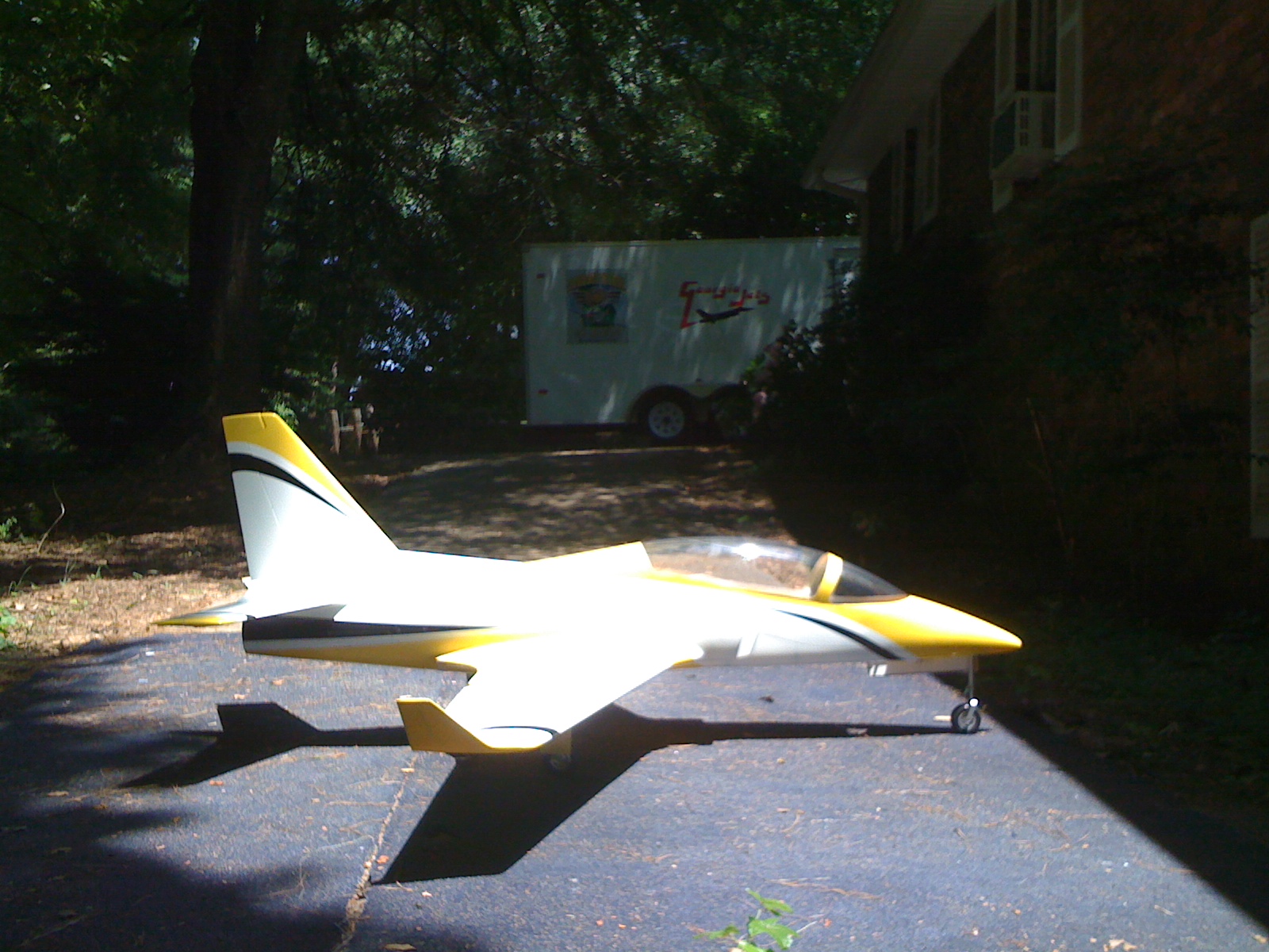

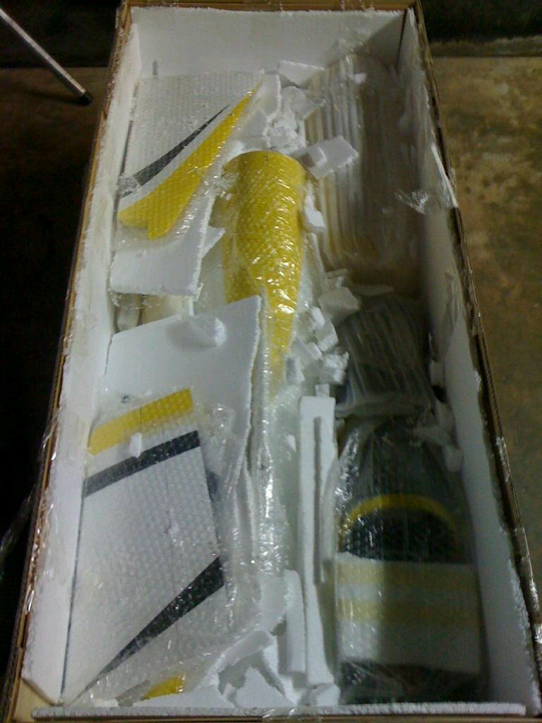

Well with the permission from John at Aeroplane Factory Jets in Canton,GA. I decided to post this build thread for the Skymaster Viper 2M. As work and a new baby boy has taken up most of my time John was recommended to me by another RCU member. I think this type service is exactly what an individual like myself needs, and he's very reasonable to boot. John has been a wealth of knowledge for me and takes the time to take all my calls and answer everyone of my questions that I might have. On top of that he is one of the nicest guys I have talked to in the industry..
John plans on going through the plane, replacing factory air lines, reinforcing where need be, beefing up LG etc...Here are some photo's and John's info. I will be updating this as John updates me...

List of Equipment going in...
Jet Cat P-80SE
Powerbox 40/24
EV5U-PRO
JR DS8411's on Steering, Rudder, and Ailerons
JR DS8711's on Elevator, and Flaps
JR921 Receiver
SWB Arms with stainless ball links
Also going with a JMP Accumulator
Jet Cat P-80SE
Powerbox 40/24
EV5U-PRO
JR921 Receiver

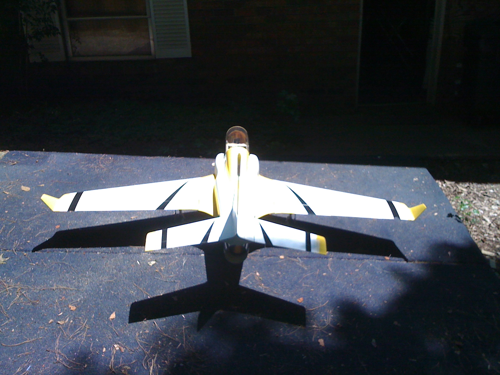

I agree completely with Duncan. We (Hatcher's Hangar) built ours "box stock" other than Bill creating a beautiful set of vents between the ventral fins. Servo's were 8411 equivilents by Hitec. You must use the small and thin aileron flat type servos in the stabs. Nothing else fits. We used JR
We did opt for the EV5U (weighs 2oz more than three servos and three valves) 5 way valve for simplicity. Once you use this unit, it is hard to go back. Ditch the PowerBox or any system similar. . .simply not needed plus there is little room under each cockpit floor.
Having installed Cheeta and complete system added 4lb 1 oz to the airframe. Total weight including Blue Box toys pilot and UAT full came in at 26lb. 1oz. for the paint in the mold 2M Viper we received.
We opted to replace all air lines and the needed T and Y air line fittings. Cylinders were tested and found to be good. The included AirPower fill valves were tossed. . .they leaked and were replaced with Robart "one way" fill valves. Less weight as well. You can see our 2M install pictures on the other Viper thread.
