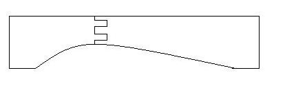

This may seem obvious to more experienced builders, but I want to get it right. I'm building a large scale A-10 from plans, i.e. no instructions. The fuselage sides are 1/4" balsa with a 1/4" ply doubler around the wing cut-out. Unless I'm mistaken, I'll have to splice the balsa sides somewhere since the lengths are limited to 36". The attached sketch shows three locations where I could put the splice, but each has pros and cons. Since the side panels are almost 70" long, the overlap area where the splice would go is actually fairly small, so the issue may be moot. Then again, maybe I should put a solid sheet of 1/4 x 36 centered on the wing cut-out with splices fore and aft.
Any advice will be most appreciated.
Paul

You could always put the join centered around A, but make the join diagonal instead of vertical - that gives you a larger butt-join area for the balsa.

Very good point. Obviously, I hadn't thought of that. I don't like the idea of butt-joints fore and aft. I would have to add more side doublers and weight.

What about something like this???
Chris

Good suggestion. I think I'll be using it. I know that joint design has a name, but for the life of me I can't remember it. "Cabinet joint," or something like that?

Paul,Just a word of caution.Being a full scale structural aircraft engineer for the last 30 years .I would not put a splice in any area for the wing cut out.This would be not a approved in full scale,due to the integrety of the joint.With a plane the size you are building I wouldn't trust it.Try and go with 48 inch material.If you do decide on the scarfe joint.Splice it at the front of the leading edge.Think it was point "B". Use a 4 to 1 ratio for the splice.and going forward Hope this will help you.

Thanks for the advice. I will need to move the splice from that very thin area at the center of the wing, which is where it would fall with 36" sheets. Using 48" from the rear, I could move the splice off the wing altogether. This would mean using another ply doubler at the splice, but maybe that's best. The current ply double only covers the wing and about two inches fore and aft.

Hmm, also an engineer, and also having a big A-10 kit (fiberglass version) there are various ways around this.
First, I don't see why the balsa joint has to be over the wing even using 36" lengths. THe chord of the wing is not over 36" so obviously a single piece could span it.
However, with a 1/4" plywood doubler( I assume it's a one piece doubler) and a good scarf joint there is no real risk whatsoever from putting the splice over the wing. If you want some insurance, put some structural fiberglass (as opposed to lightweight cosmetic stuff) over the joint on the outside. If you like spending money, upgrade to CF.
If you want the best scarf joint, angle it not only from the vertical, but also thru the thickness of the wood. That would require precisely matched cuts in each piece using either a jig or a good bit of sanding to fit.

Initially, I thought only 36" lengths were available. I thought that spanning the wing cutout with one piece would mean two splices, fore and aft, adding weight. Using a 48" length from the rear, I'll move the splice forward and use a ply doubler underneath.
