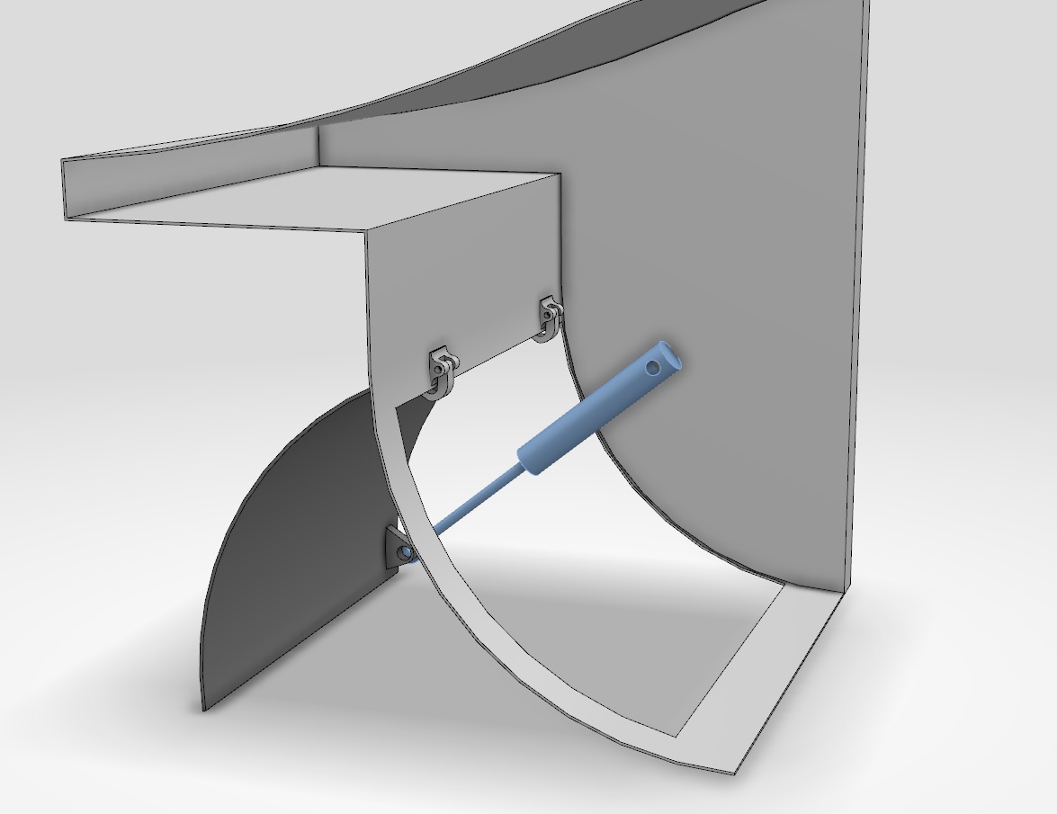

Ok, here we go, Door Cylinder installation.
#1 install the air cylinder to the door. The location of the sylinder mount on the door may take some trial and error, as it will define the amount of available "throw" for the door....similar to installing a control horn. On an F-16, it will have to be on the lower 20% of the door, mostly to keep it away from the wheel in the retracted position.
Retract the cylinder, and tape the door shut to the fuselage.

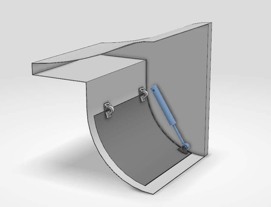

#2, swing the cylinder around along the door mount axis, and mark the circle traced on the bulkhead were the cylinder will be mounted.

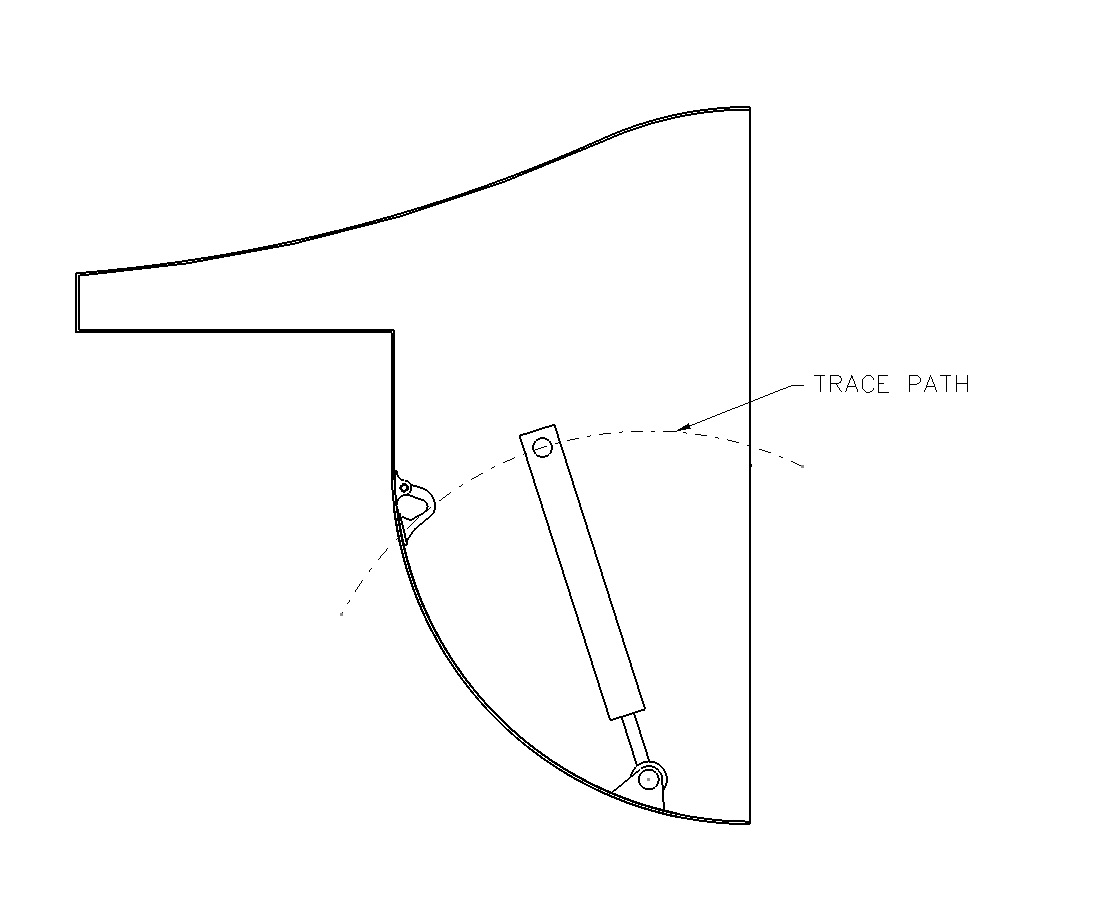

#3, Now try locking the door in the open position, and make sure it clears the landing gear strut in the exended position.

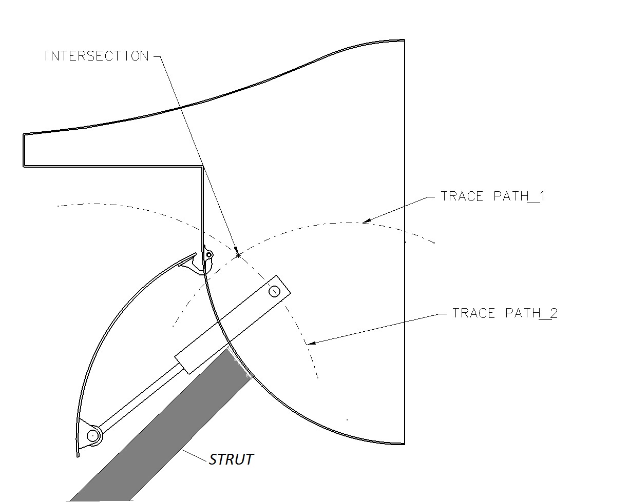

#4, Swing the air cylinder along the gear door mount axis again in the extended position, and trace on the bulkhead where the cylinder will be mounted. The intersection of the two traced cylinders will mark the location of the air cylinder mount on the bulkhead.

#5 Finish the air cylinder installation. You may need to add 1/8" hardwoowd as a mounting block/standoff. It takes some trial and error to get it right, but this is the mechanical concept.
