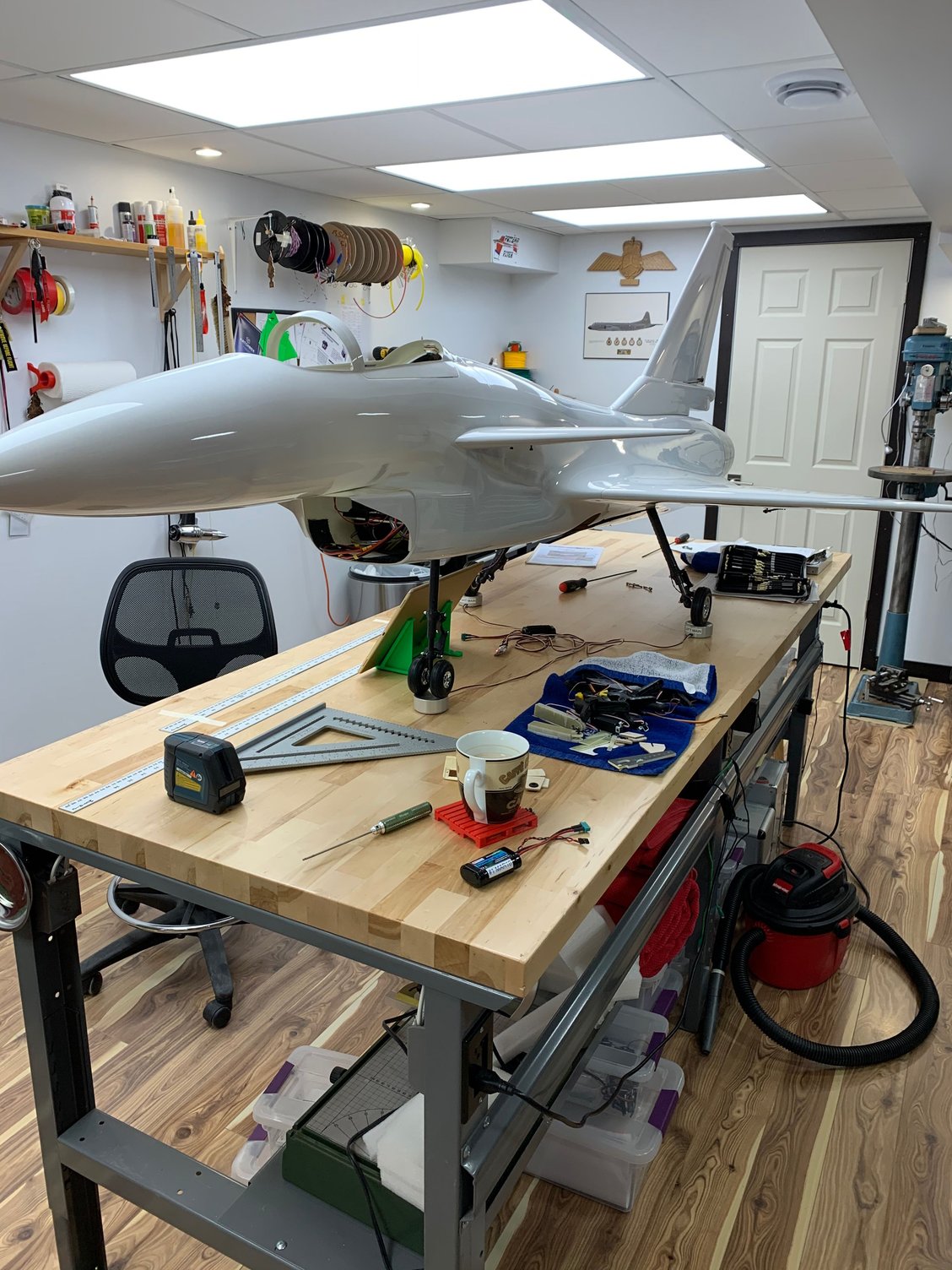

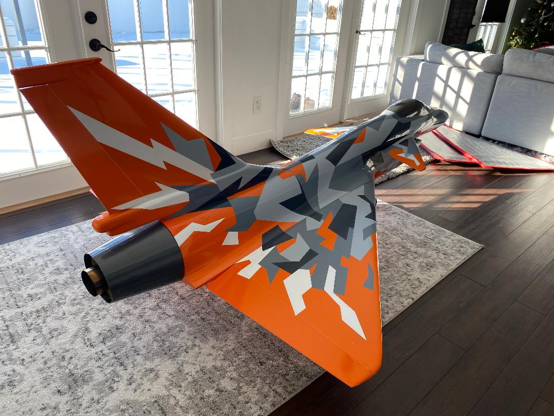

Originally Posted by Dansy (Post 12649850)
Well I’m pretty much done, minus gluing the battery’s tray and canopy (after painting) I put it on the scale all assemble and I’m about 12kg with the uat simulated full...(lead) pretty happy with that....so I took it apart and will start getting the parts ready for paint...with no joint lines anywhere....so that will take a while LOL 😂
https://cimg5.ibsrv.net/gimg/www.rcu...8d9d03683.jpeg
https://cimg9.ibsrv.net/gimg/www.rcu...f464ec5060.png
Dansy - what screwdrivers are you using for the wing bolt and tail? ( I see 2 on your table I assume your using) I can't any long and skinny enough to fit into the hole underneath the wing, T-bar could work but has to be really long otherwise the top hits the wing. Thanks

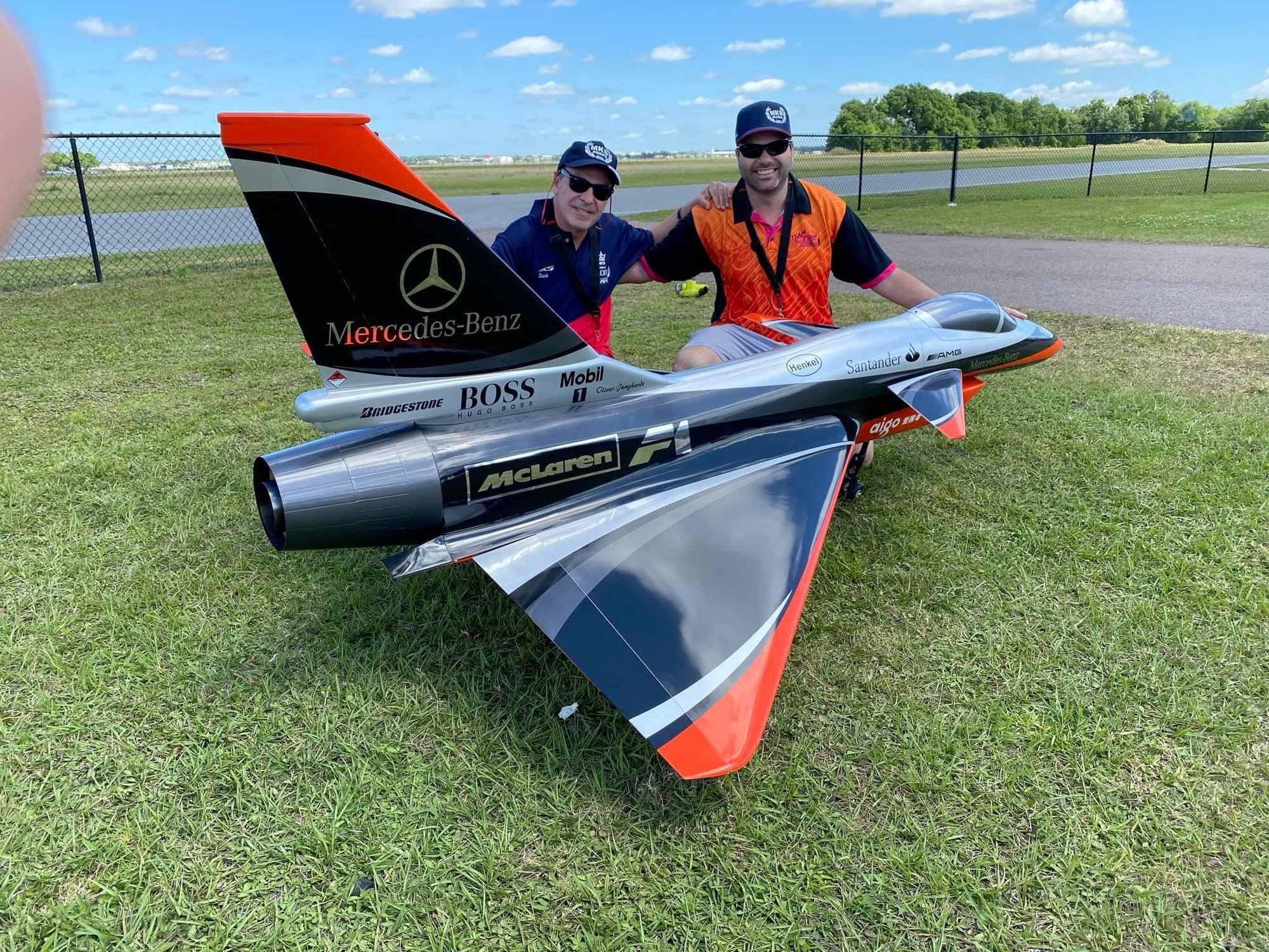

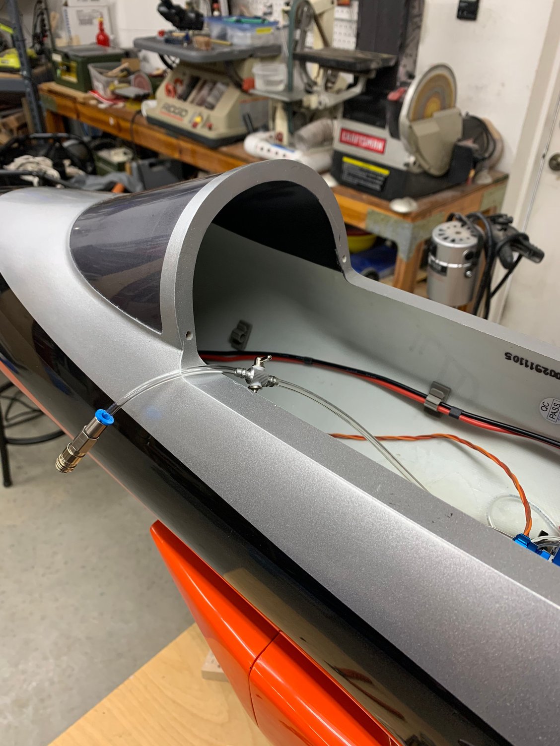

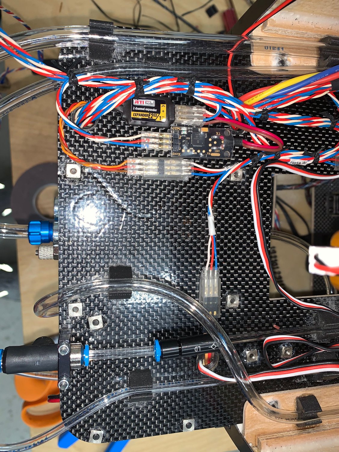

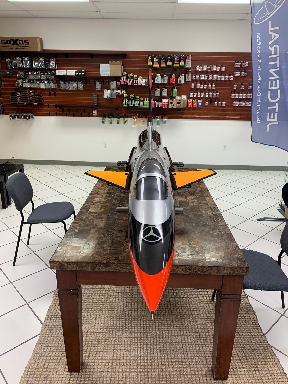

F1 Rocket 03-21-2021 12:13 PM

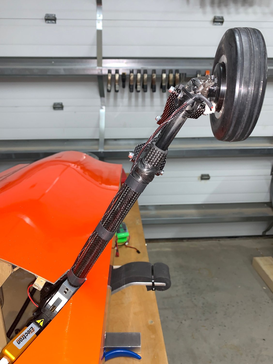

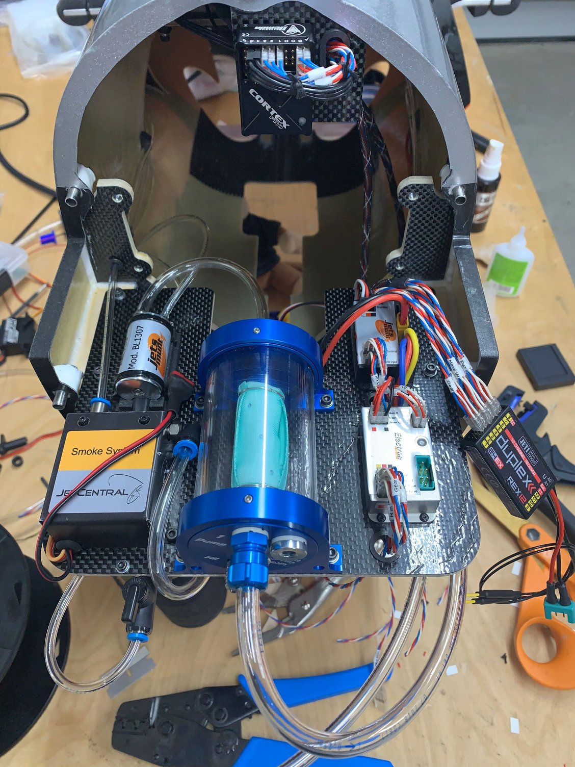

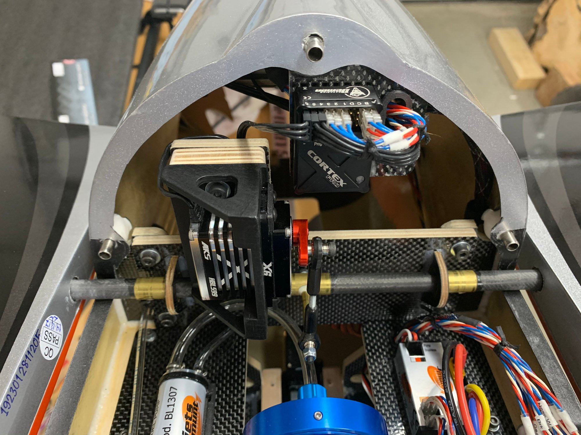

Been so busy lately I haven’t had time to post in this thread. This is a J-10 I built for David and Elad to fly at FL Jets.
Jets Munt 210
BavarianDEMON Cortex Pro
Jeti REX 12/R900
Electron retracts
MKS HBL599 servos
Jet Central smoke system
Pulse batteries
https://cimg0.ibsrv.net/gimg/www.rcu...8be5a7442.jpeg
https://cimg2.ibsrv.net/gimg/www.rcu...7b242b80b.jpeg
https://cimg4.ibsrv.net/gimg/www.rcu...5fa17eaa0.jpeg
https://cimg5.ibsrv.net/gimg/www.rcu...aac7084cc.jpeg
https://cimg8.ibsrv.net/gimg/www.rcu...113c7d944.jpeg

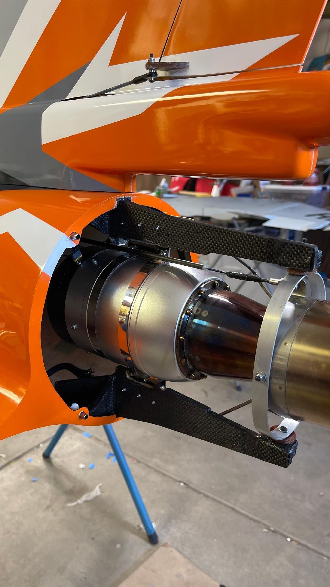

Yesterday I just had installed a new 240 into the J10
