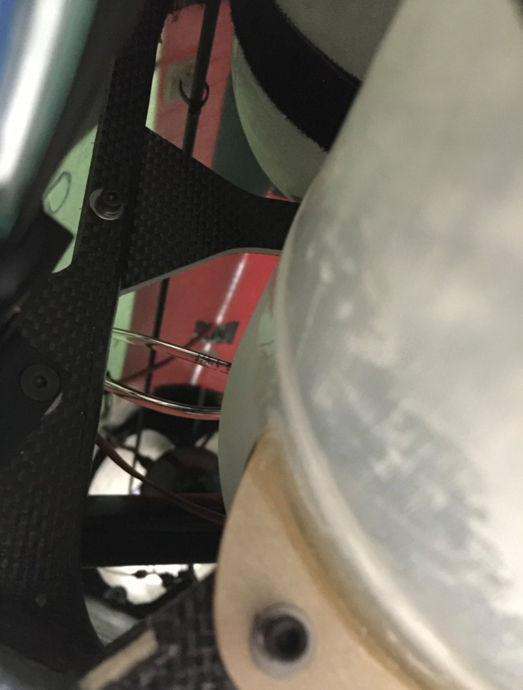

1 Attachment(s)

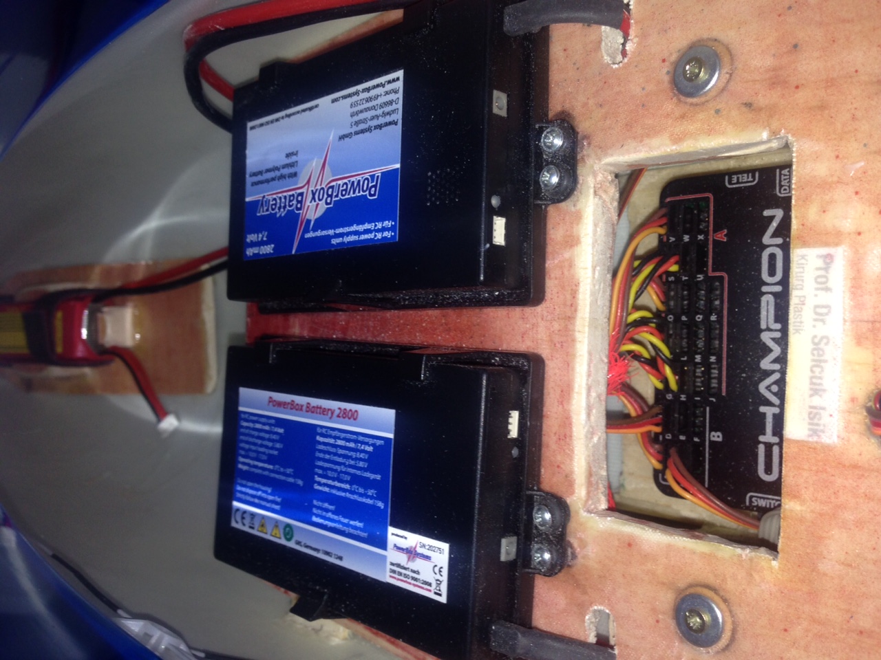

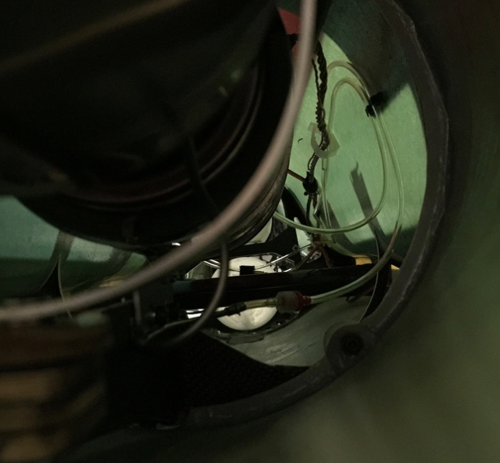

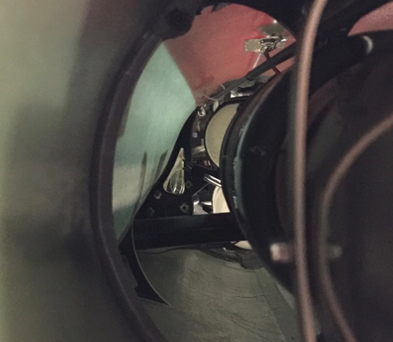

Hello, anyone knows were this plywood covered in carbon piece goes?? I can find were in the manual or in the manual pictures...
Airforce7 10-23-2015 07:53 AM
This part stumped me for a while, but I ended up using it as the backstop for the main fuel tank and the smoke tank. If you take a look at the tanks they each have a step and when you put them in the fuselage near the main gear former you can see that this part sits nicely (overlaps) across the tanks. I drilled some holes in the part as well as the former to secure the part in place keeping the tanks from potentially sliding back towards the turbine. That's how I used this part in my J-10. I'll see if I can dig up some pictures I took and post them here later.

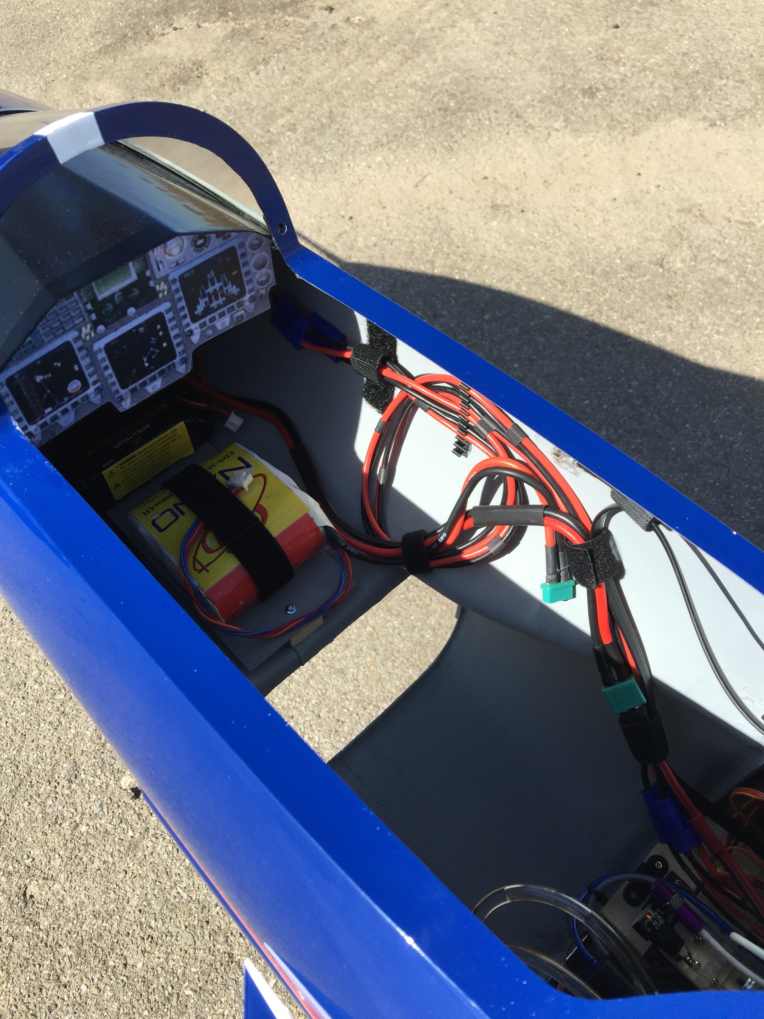

Airforce7 10-23-2015 10:00 AM
Main Tank Bracket Photos
3 Attachment(s)
Here are the photos. So what I ended up doing was mounting the bracket so that the main tank was secure from sliding back. The smoke tank doesn't need the bracket as it is secured using the plywood tabs and some screws. You could adjust it to capture both tanks, but I ended up just securing the main tank. The bracket also acts as an anti rotation beam which keeps the tank from rotating (moving side to side) during flight.
http://www.rcuniverse.com/forum/atta...mentid=2127186http://www.rcuniverse.com/forum/atta...mentid=2127187http://www.rcuniverse.com/forum/atta...mentid=2127188
skymaster68 10-24-2015 05:48 AM
Ok Thanks for the help !

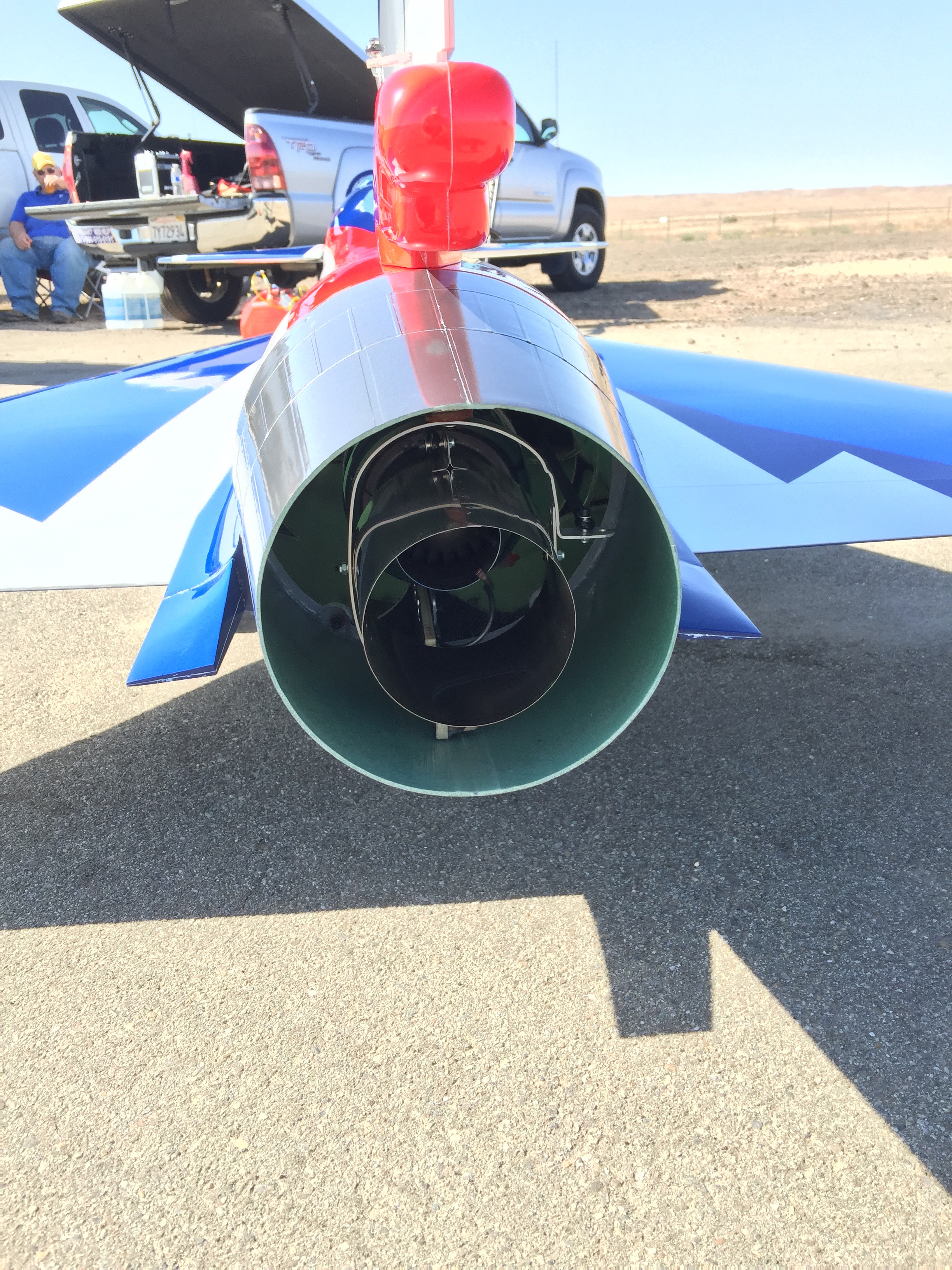

Airforce7 10-24-2015 07:36 AM
6 Attachment(s)
http://www.rcuniverse.com/forum/atta...mentid=2127312http://www.rcuniverse.com/forum/atta...mentid=2127313http://www.rcuniverse.com/forum/atta...mentid=2127314http://www.rcuniverse.com/forum/atta...mentid=2127315http://www.rcuniverse.com/forum/atta...mentid=2127316http://www.rcuniverse.com/forum/atta...mentid=2127317
