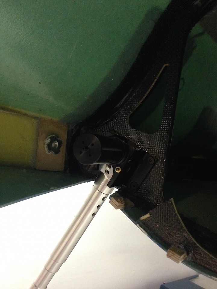

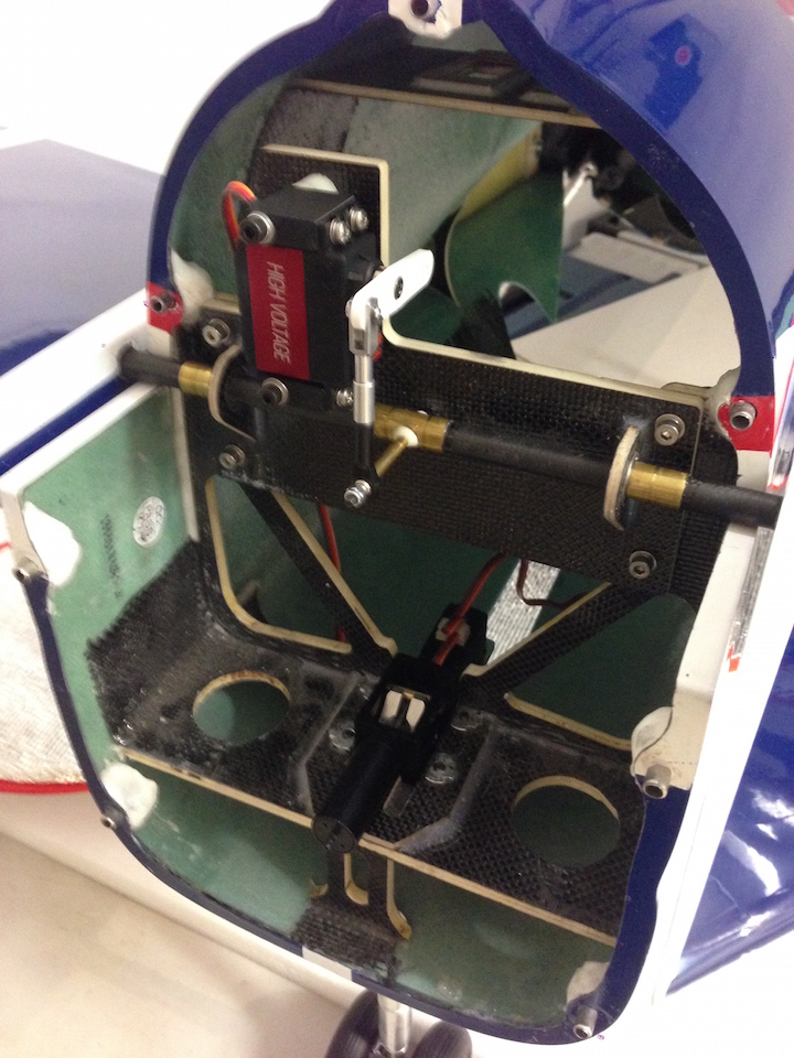

3 Attachment(s)
Flown it many times, just not hovering 3 ft off the ground. :) And if you get the jet, I have some special 3D printed mounts for the canard, left and right wing servos. PM me if you're interested in getting those.
http://www.rcuniverse.com/forum/atta...mentid=2179061http://www.rcuniverse.com/forum/atta...mentid=2179062http://www.rcuniverse.com/forum/atta...mentid=2179063
