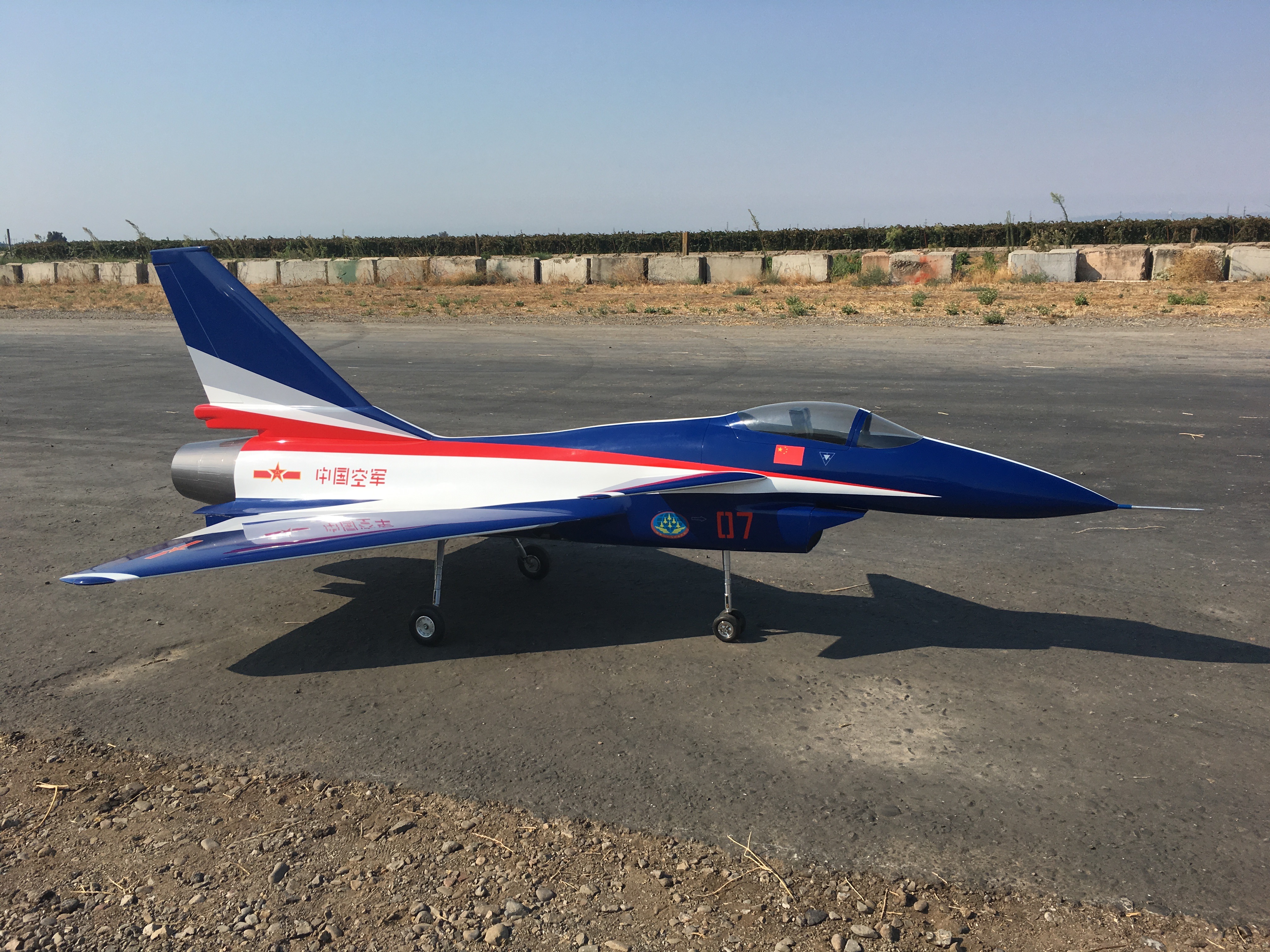

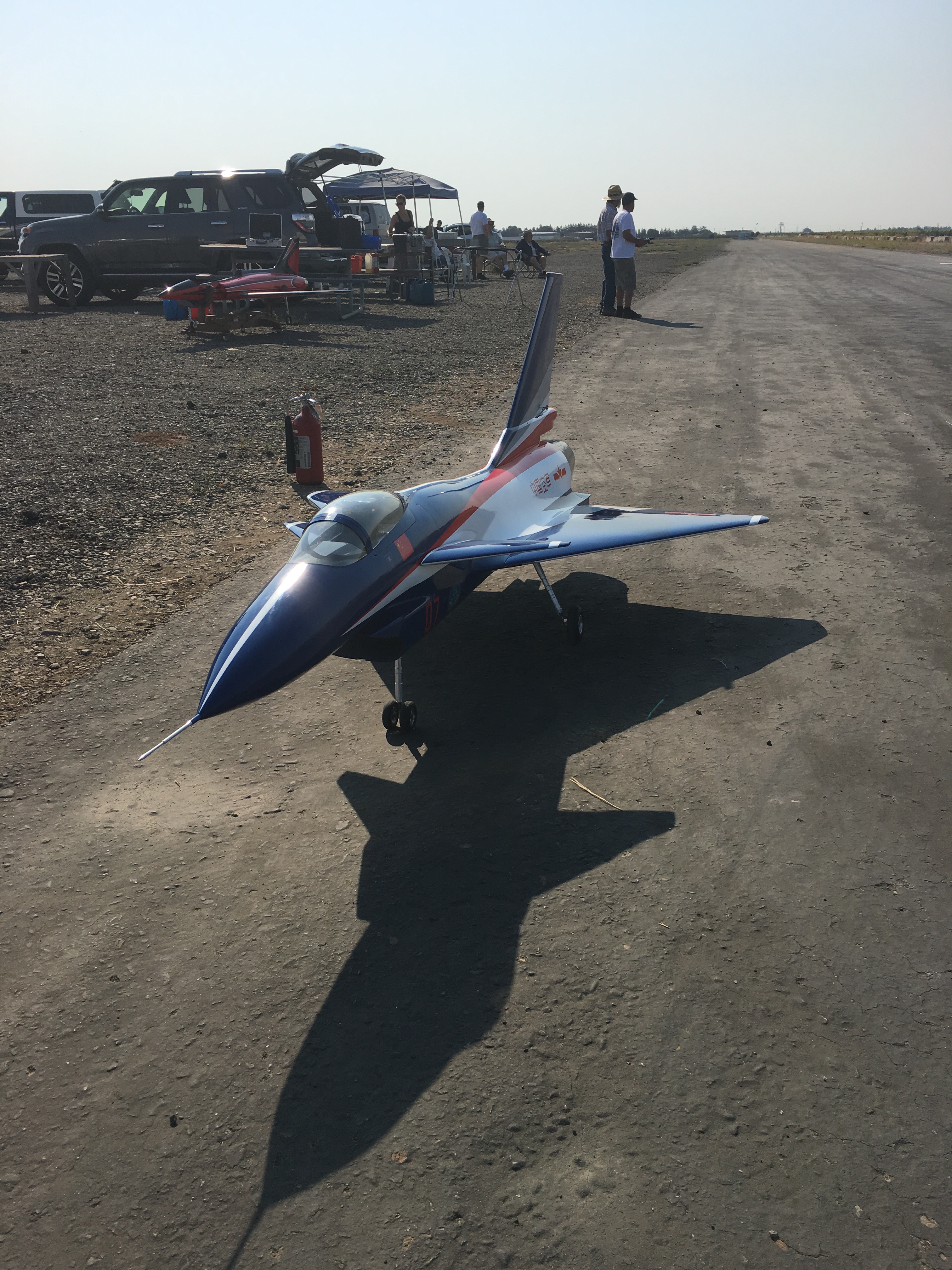

Airforce7 08-23-2016 01:21 PM
3 Attachment(s)
Visibility isn't really an issue in the air with the blue/white scheme. But if you have a smoke system installed like I do then sometimes the smoke will block your view in the air during hard maneuvers (spins) or hovering (vertical) with a tail slide. Flew three times this weekend with the newly applied graphics and I'm really enjoying this jet. I don't have the carbon fiber gear, but the jet still has plenty of power with the extra weight on a P-180RXi. I don't fly it with gyros, I find that this jet is very forgiving and extremely maneuverable and stable with the use of the canard, thrust vectoring and big control surfaces.

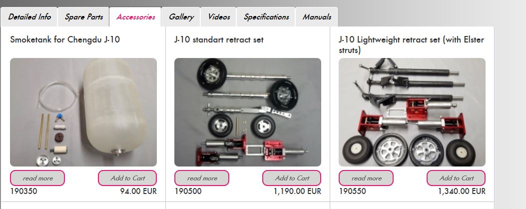

Turbine2010 08-24-2016 05:59 AM
1 Attachment(s)
It is published on the carf-models.com Homepage under accessories. http://www.rcuniverse.com/forum/atta...mentid=2178167
http://carf-models.com/en/products/chengdu-j-10-3d-1
It is the original retract system sold with the jet as accessorie. Before, Behotec did produce one but I wouldn't recommend (had it for 1 season).
Airtech Germany and carf-models have a contract to sell the retracts directly per carf homepage. If you need help in organisation I would assist.
cheers, Emanuel
