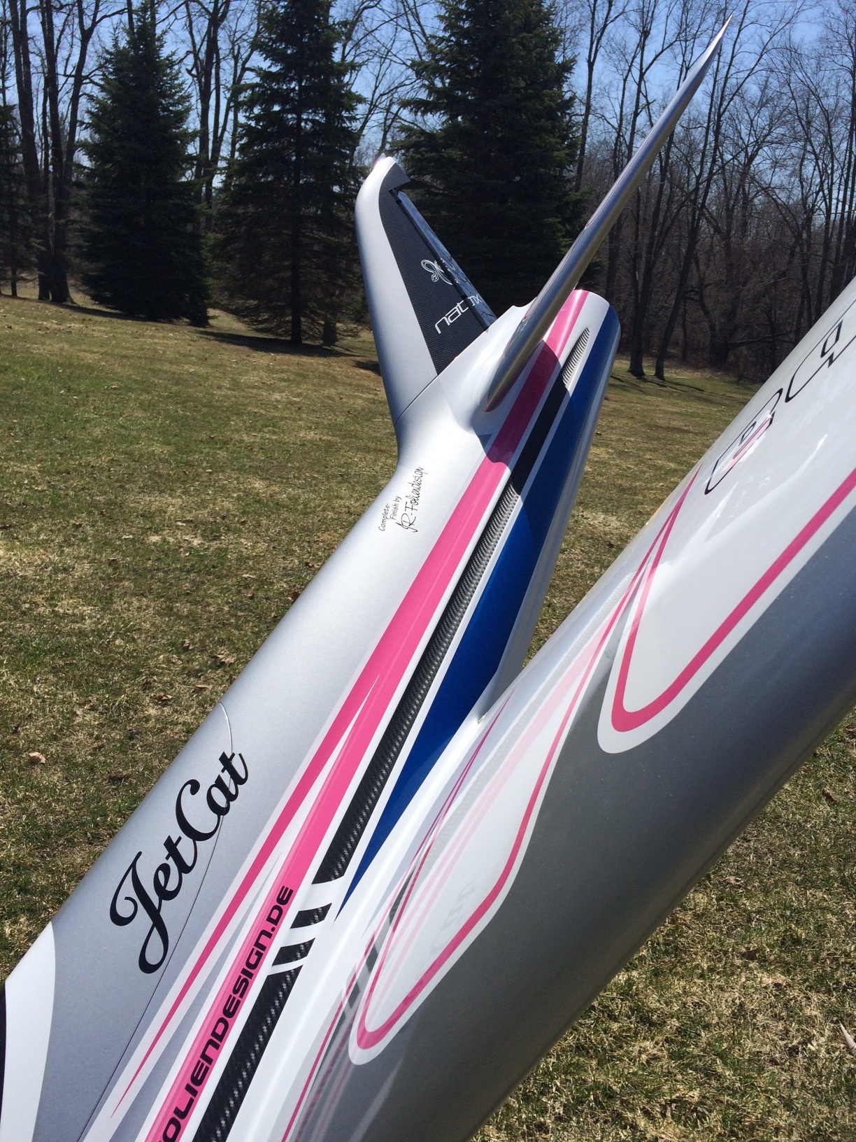

berthoud 04-04-2015 05:45 PM
Paritech Natrix Build
10 Attachment(s)
As this is the first Paritech Natrix in the US I thought I would post my experience with the model as well as a short build thread (not much to build!).
Dad and I first discovered the quality of Paritech through the Tomhawk Viper XXL (the pink one) which is made in part by Paritech. The Natrix is a new sport jet and this particular one is the carbon version with electric retracts/brakes and a paint/vinyl scheme. The model options included the high quality lined fabric/zipper bags. The pictures are shortly after unboxing the model, as it arrives from them, everything basically done. Paritech could not have been nicer to work with on the transaction. Always professional and very quick to respond to email.
For reference I am 6'3". The model as shown in the pictures with retracts/wheels/brakes and the fuel tank installed is exactly 26lbs. I should be able to make it around 36 lb dry with the rest of the gear.
I dont routinely have access to RCU but will update this thread with pictures throughout the build as well as the specifics like setup, CG, throws ect.
With any luck the model will be flown before and at First in Flight.
Scott

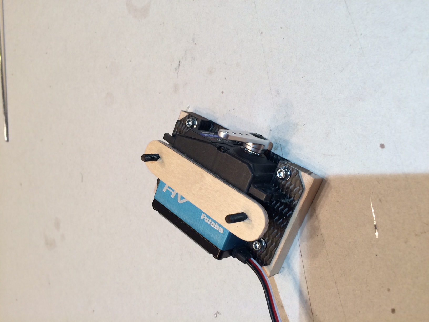

berthoud 04-15-2015 04:59 PM
9 Attachment(s)
I've started with the stab and elevator while I await for some parts for the fuse.
Overall quality is excellent. Light, strong. Appears to be top shelf material and craftsmenship.
The rudder servo mount needs installed. It fits the Futaba HV BLS servo perfectly. It had a very light and neat way to mount it to the servo holder but I modified that to something more traditional by adding some maple blocks, 3mm x 30 mm bolts, and a ply strap. The servo arm is a 20 mm thin Futaba servo arm mounted on the second arm out for max ATV/throw. I did have to open up some of the vertical former to allow for the servo arm.
http://www.rcuniverse.com/forum/atta...mentid=2089385http://www.rcuniverse.com/forum/atta...mentid=2089386http://www.rcuniverse.com/forum/atta...mentid=2089387http://www.rcuniverse.com/forum/atta...mentid=2089388http://www.rcuniverse.com/forum/atta...mentid=2089389http://www.rcuniverse.com/forum/atta...mentid=2089390http://www.rcuniverse.com/forum/atta...mentid=2089391http://www.rcuniverse.com/forum/atta...mentid=2089392http://www.rcuniverse.com/forum/atta...mentid=2089393
I also added a dowel in the main rudder alu tube for long term durability. Next, I added 4 ply corners and button head screws to attach servo covers vs tape.
Finally, to connect the rudder servo at the fuse junction I had to dremel a small hole in the vertical former that supports the main alu tube to pass the servo extension wire up into the round hole at the base of the rudder. This is not shown, unable to get a picture.
