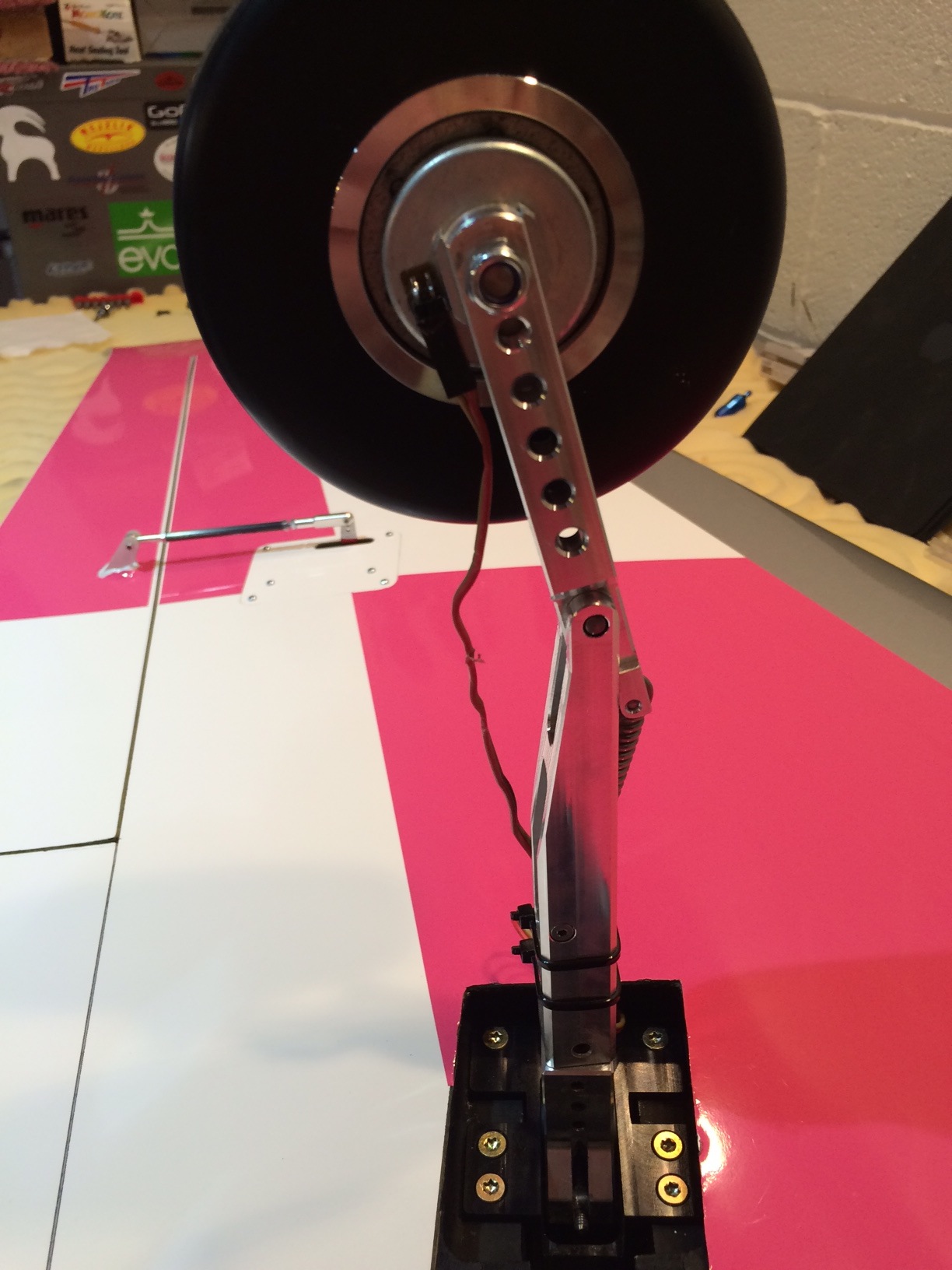

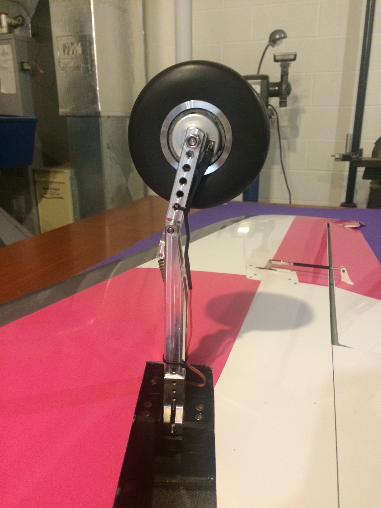

So the next step was the wings. I used 400mm length servo extensions for the flap and ailerons. The gear and brakes were included.
The aileron servos are typical door/cover mounts. Minimal work was necessary to fit the Futaba servo. I aeropoxy carbon over all of the horns. I used SeCraft 20mm servo arms (2mm thick) with 2mm pin holes. I replaced the stock 1.6mm MPJet connects with 2mm pins as I couldnt find any horns with holes less than 2mm.
The flap servos were a bit more difficult to get too. I had to use the Dremel attachement and chuck to be able to get a drill into the wheel well. Some work was done here to open it up to accept the Futaba servos. Although not final, this was the basic geometry I was looking for for the flaps. With the flaps in the down position the servo arm is full extended so the load is minimal to the servo motor.
The retract bays were painted black and coated with a finishing epoxy for waterproofing. There was already a glass covering some of the critical parts on the l/g blocks.

Final product with installed retract. Next on to the fuse.

So after the first 8 flights or so I had an eventful landing when after applying brakes, the model veered off the runway. I later found a severed brake wire and after soldering this back up I added heatshrink to it where the articulation is. I dont have much prior experience with electric brakes so this was a good lesson.
I also have had the spring(s) soften up considerably in the first 20 flights likely due to this severed brake line event. Fortunately Mathias at Paritech and Gotz were able to express mail a set over for the event next week. The main struts do seem fairly soft and I am looking into an alternative compression option for them.
On the note of these Xicoy type electric retracts. I have found it is very important to either have all of the retracts plugged in when you are working on them OR when you do not have all three plugged in allow, an extra amount of time after deployment or retraction for the "lock" that occurs. When all units are plugged in there is an audible and mechanical electric "lock" that occurs when all three motors have amped out at the end of extension or retraction. This normally happens within a few seconds of retraction or extension. When you do not have all of them plugged in the ECU seems to have a delay of 20-30 seconds programmed into it while it "waits" before it does this lock. If for some reason you unplug turn it off before this "lock" you will end up with one or more struts out of sequence when you plug the other unit in. Clear as mud right?
