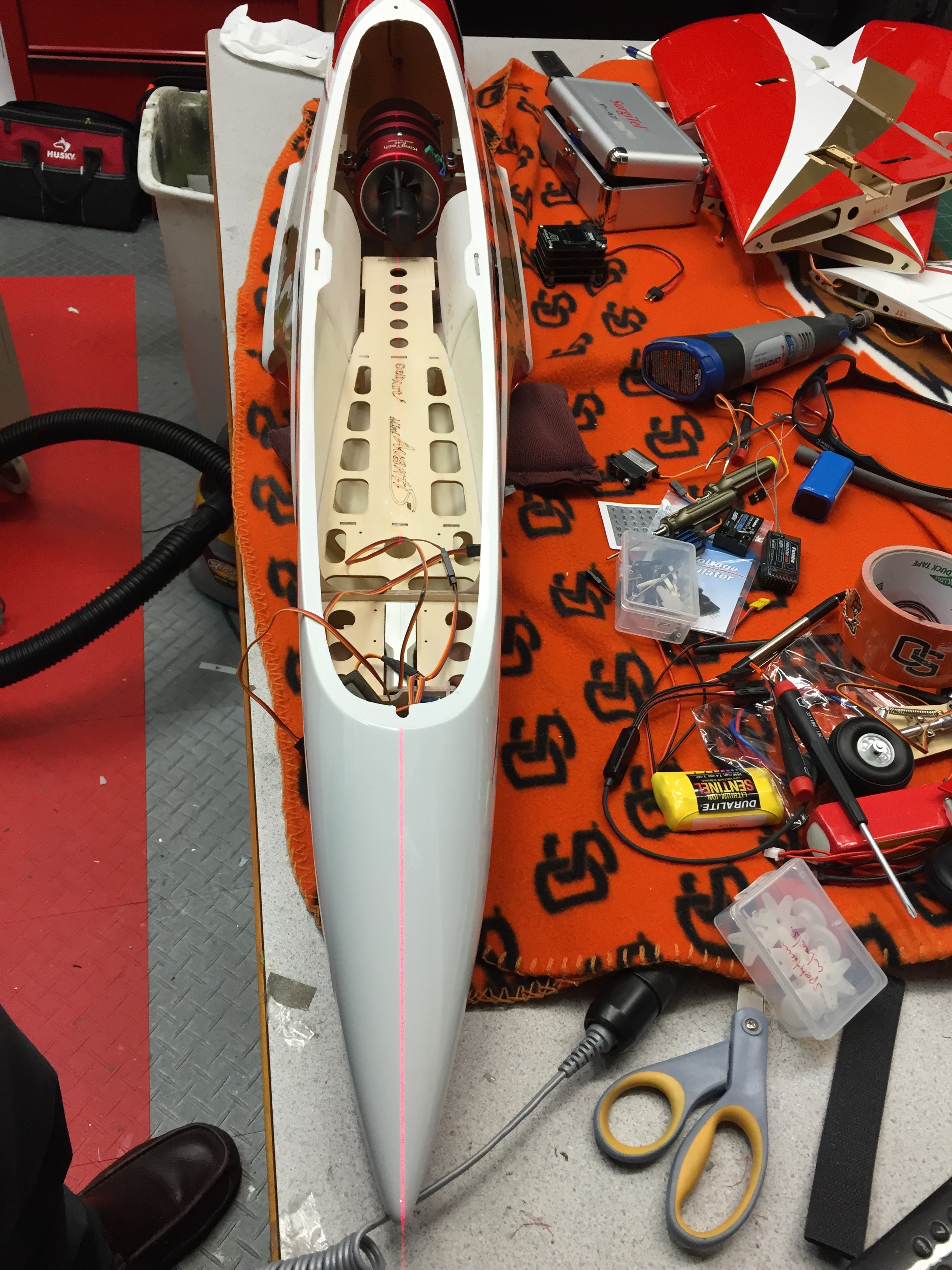

I trimmed about 1/8" on the turbine mount rails on each side to get it to clear the locknuts from the turbine mount ring. Got out my laser level (love this thing) and lined it up on the fuse, then indexed the turbine. The rails and blind nuts are not even on each side. Not sure if the formers are not square, but definitely couldn't use the blind nuts without slotting the mount that you use for the fan or turbine. Not a big deal, I'm planning on using wood screws.

Fuel tank and turbine plumbing is done. 30 oz in the mains, and the 2oz UAT. I didn't want to touch the fiberglass intakes, if you did, you could probably get one 30oz tank in quite easily.
Pipe shipped today from Europe, not sure how long it will take to get here. This plane goes together fast.

PLane is done until pipe arrives, should be here soon. Someone asked the pipe dia.. its 70mm. The turbine mounts very easily, just a little bit of trimming on the rails to clear the lock nuts on the mount. I have it as far forward as possible. I did some very rough CG testing last night. I don't think its gonna be tail heavy. Obviously, I don't have the pipe in, but if I put the two batteries as far forward as possible, its very nose heavy. I think they will be able to go along side the nose gear retract right where they're supposed to.and this was with the 2oz UAT empty. Find out soon. There is plenty of room for everything in this plane. It was a quick build, the only cutting I had to do so far was a square in the tray for the UAT, and that wasn't necessary, just looks cleaner. I have a tracking number for the pipe, need to see where it is.
