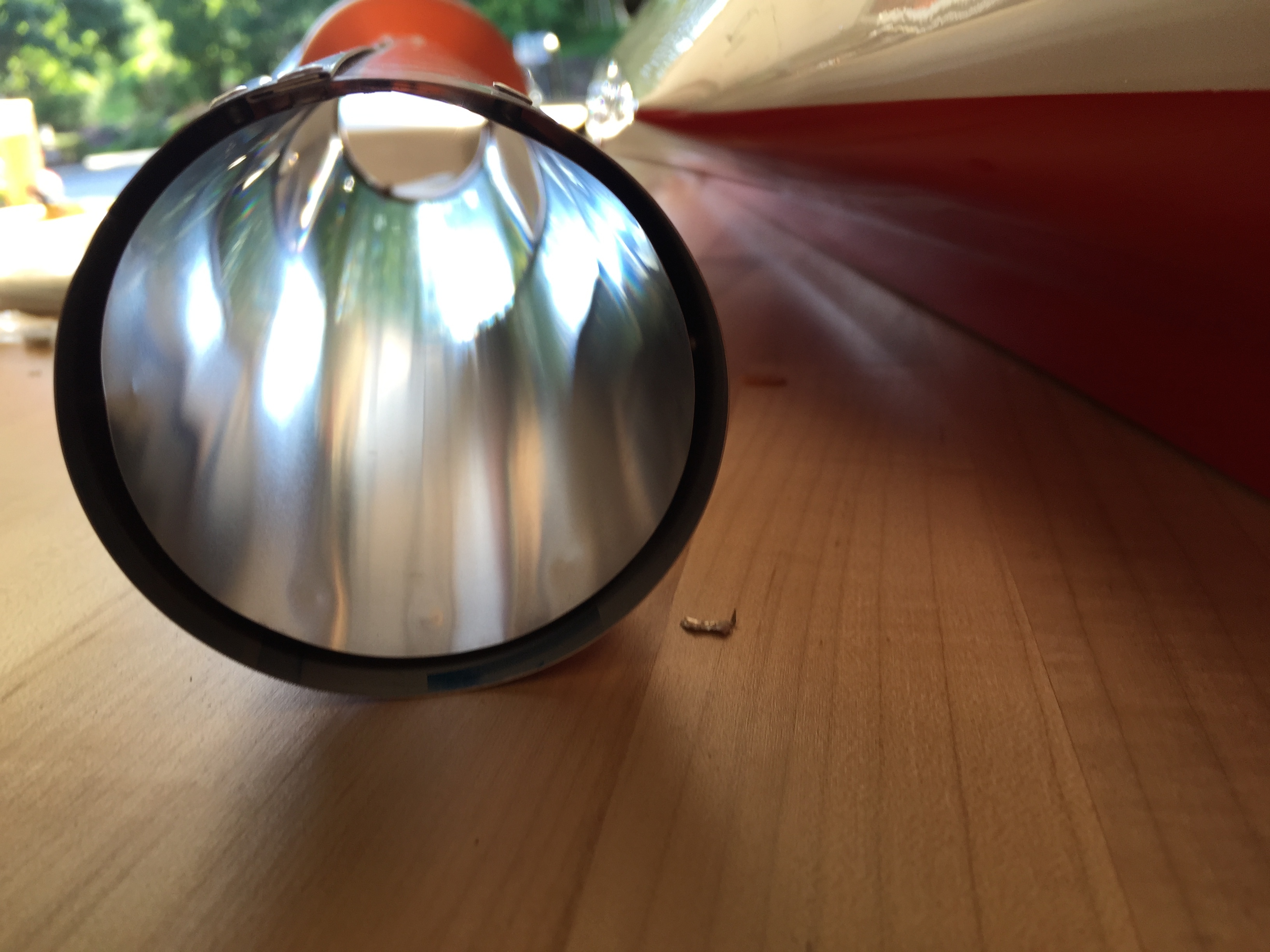

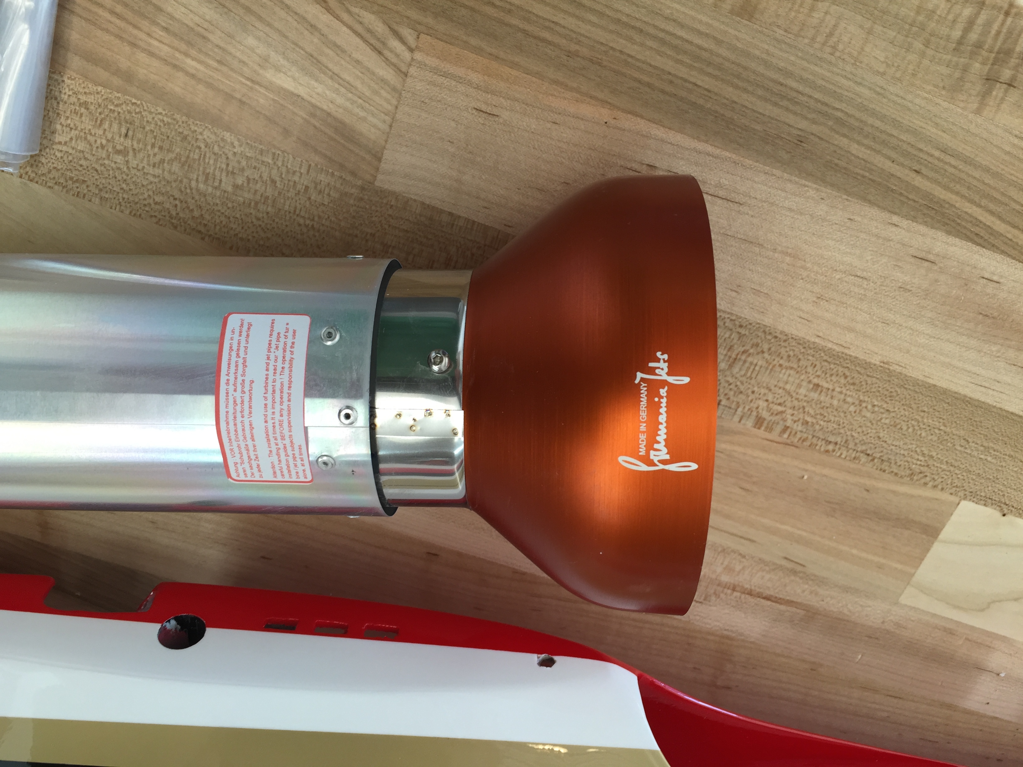

DrScoles 05-27-2015 06:29 PM
4 Attachment(s)
Got the pipe in the mail today. It is very nice. T-shirt was a nice touch, and my son was pleased to see the gummy bears ;-) The bell mouth comes off, wouldn't go in otherwise. I might need to trim the bell mouth a bit, find out this weekend.
http://www.rcuniverse.com/forum/atta...mentid=2099122http://www.rcuniverse.com/forum/atta...mentid=2099123http://www.rcuniverse.com/forum/atta...mentid=2099124http://www.rcuniverse.com/forum/atta...mentid=2099125

c_makhija 05-28-2015 01:51 PM
1 Attachment(s)
http://www.rcuniverse.com/forum/atta...mentid=2099253
Just got my pipe too, and picked up a new T35 for the Avanti, now just waiting for the Avanti. Pipe is very well built and service
from Grumania is outstanding.

DrScoles 05-30-2015 04:04 PM
2 Attachment(s)
Had a chance to weigh everything. 8.4 pounds with tanks dry and a 2oz piece of lead in to account for the header tank. Kero weighs 80% of water by volume, (according to google)… ;-) So, the 32oz tank will be roughly 1.6 pounds of fuel, so take off weight will be right at 10 pounds. This is with a 2100 life turbine battery and a 2600 liion. My 8S habu 32 is gone, but this plane sure feels lighter than it.
I think Ilja and I had a communication error, the pipe might be too short. Need to see where CG is, then see if it will work. The pipe is fine if the turbine is back farther, but where I had it, its 4cm too short. ;-(
http://www.rcuniverse.com/forum/atta...mentid=2099624http://www.rcuniverse.com/forum/atta...mentid=2099625

DrScoles 06-01-2015 09:06 AM
Originally Posted by Stevojet (Post 12047542)
All,
My friend maidened his at the basin today with a K45 and put two beautiful flights on it. Required some elevator trim and a click or two of aileron and away it went. Very fast and all the vertical you could ask for. He Set the timer for 5 minutes and landed with a third of a tank of kero. He uses a demon cortex gyro. We have a great photographer at the field so will try and post some photos soon.
Steve
Steve, do you know how big a tank he installed? Please share pics!
The bell mouth on the grumania pipe does need to be cut down. I've been talking to Ilja quite a bit the last few days. If you want the turbine farther forward, the rear former gets in the way of the bell mouth. I may move it back a bit to find a happy medium. I did need to get a slightly longer pipe made.
The wheels were from a guy on regroups out of singapore. I will post a link.

DrScoles 06-14-2015 07:13 AM
4 Attachment(s)
I got the ebrakes and the pipe installed. For those of you who need brakes due to flying at AMA fields, these are 2" replacements. The axle is 4mm, so you have to drill the strut out, pretty simple. They look very nice, but will obviously add some weight.
The grumania bell mouth is too wide to place the pipe and it at the same time. You have to bolt it together using three 3mm bolts while its in the plane. If you have large hands, might want to teach the wife how to turn wrenches. If your wife has big hands…. well… I put an angle bracket on the bulkhead for the bottom, and used one of the aluminum straps that grumania supplies and clamped it to the turbine. I had to cut down the bell mouth 2cm. Obviously, neither this pipe or the the kit were meant for each other, but you can make it work. I know Tam has made a pipe that might be easier to install???
I need to do some wire routing and it will be ready to go. Moving in the next two weeks, so doubt I will get a chance to maiden for a month or so… ;-(
