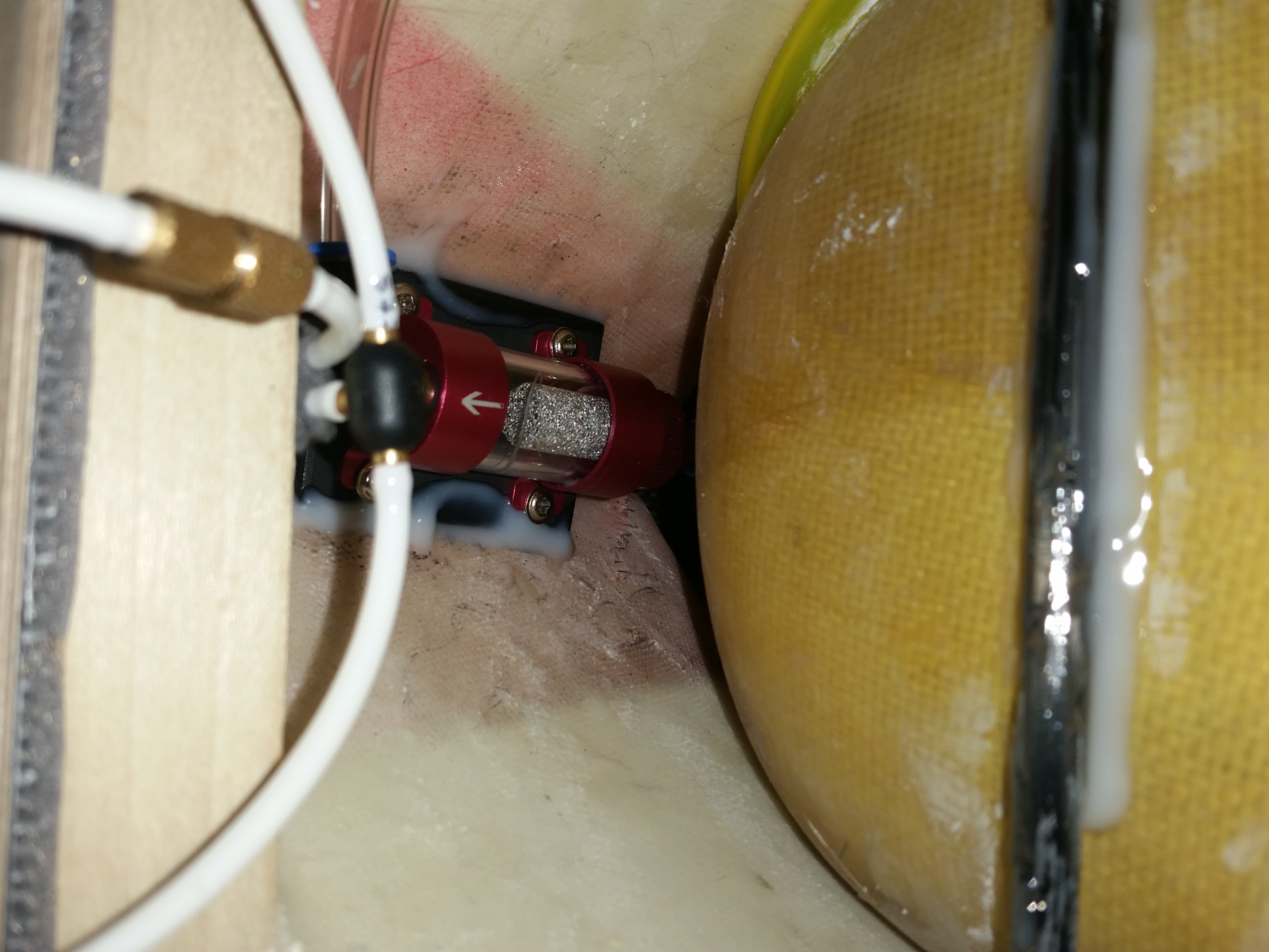

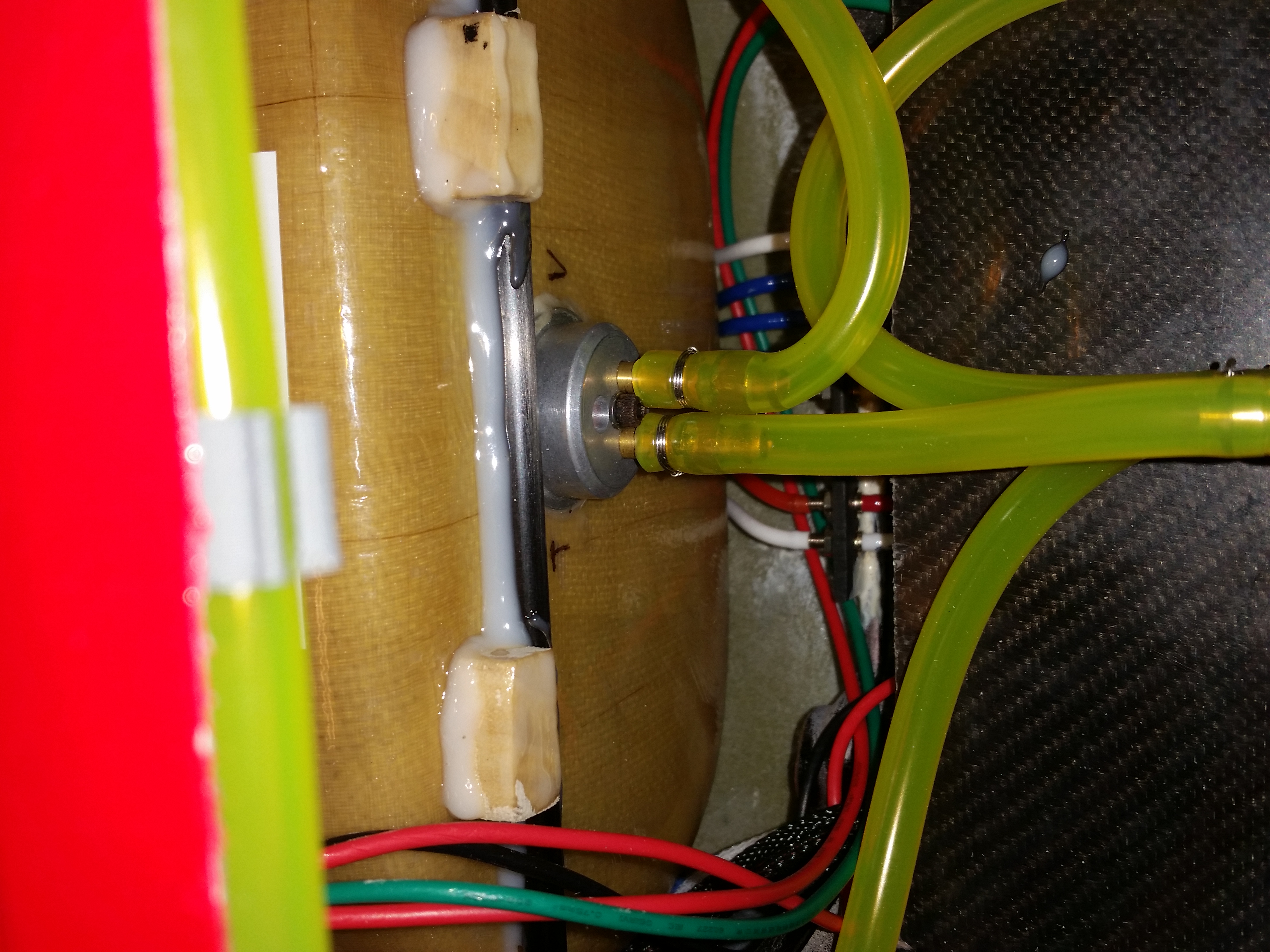

4 Attachment(s)

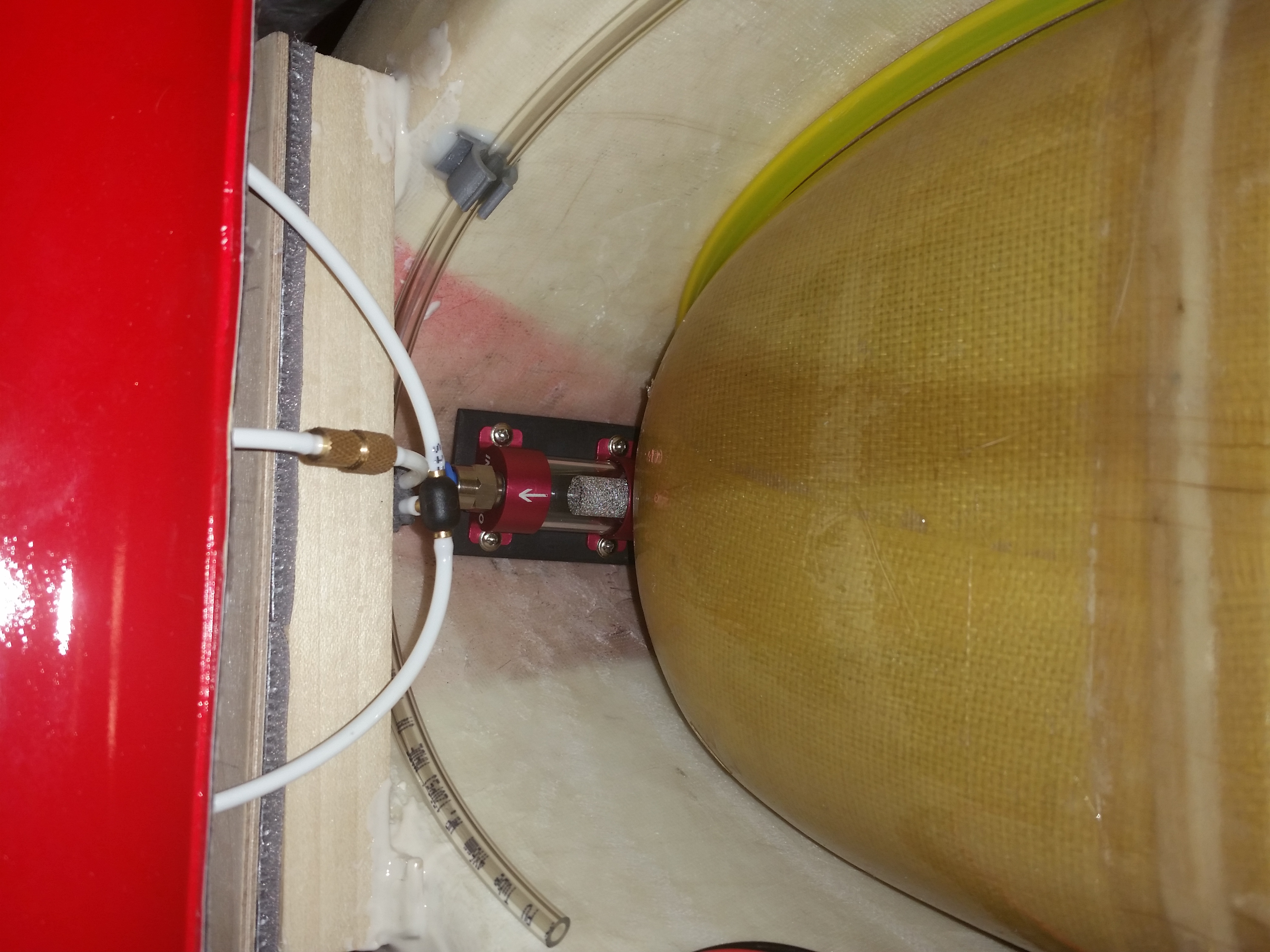

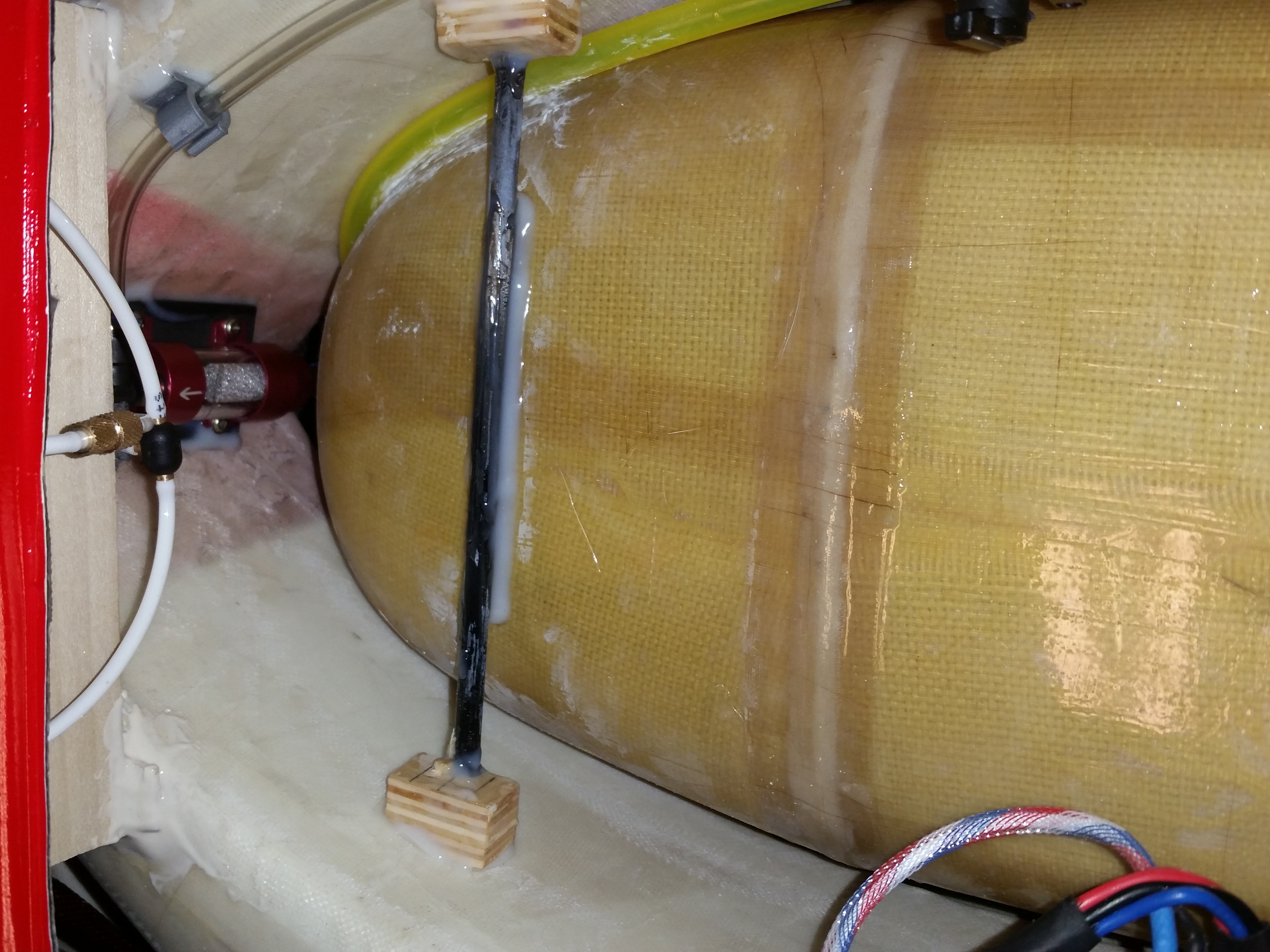

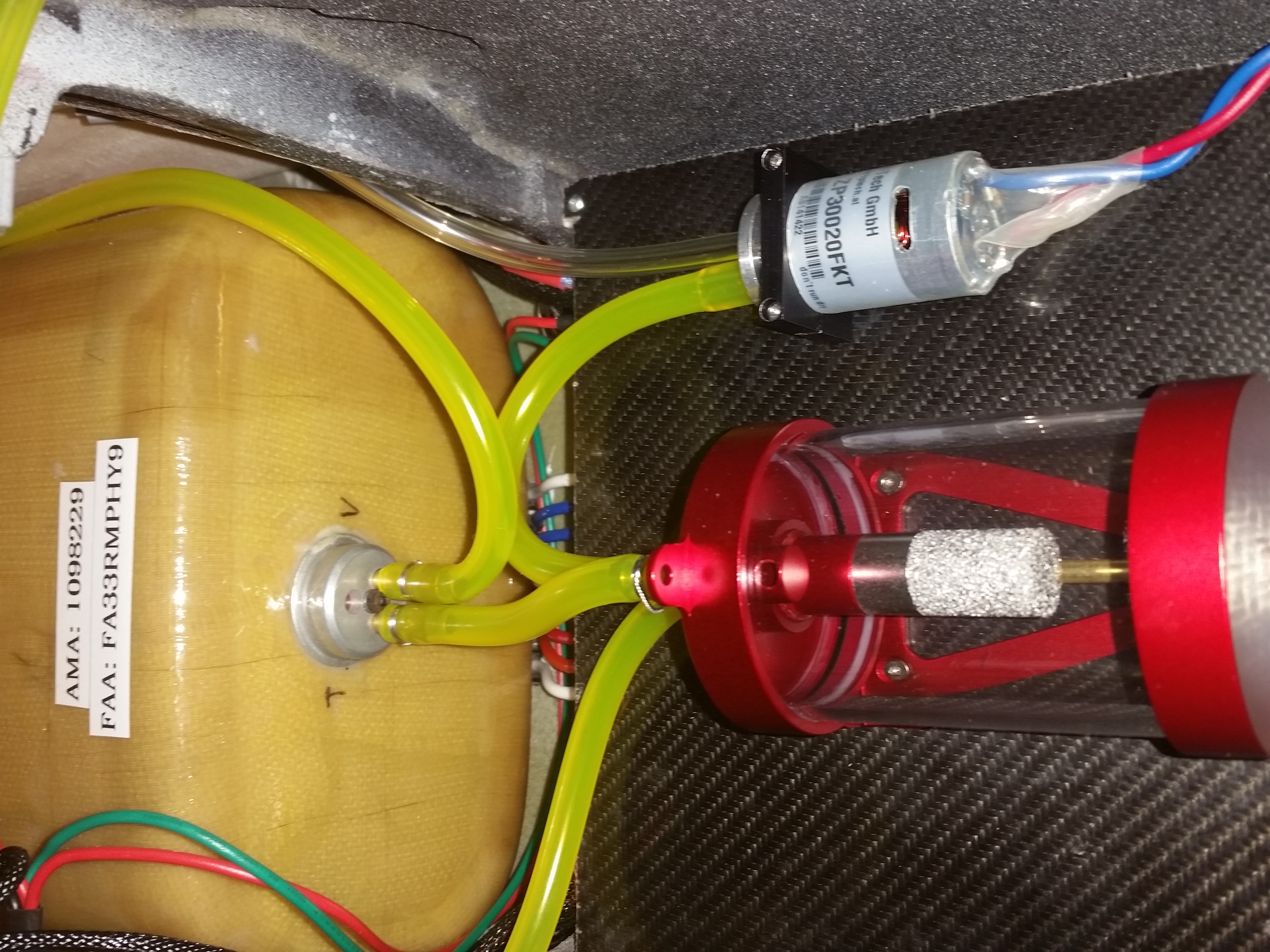

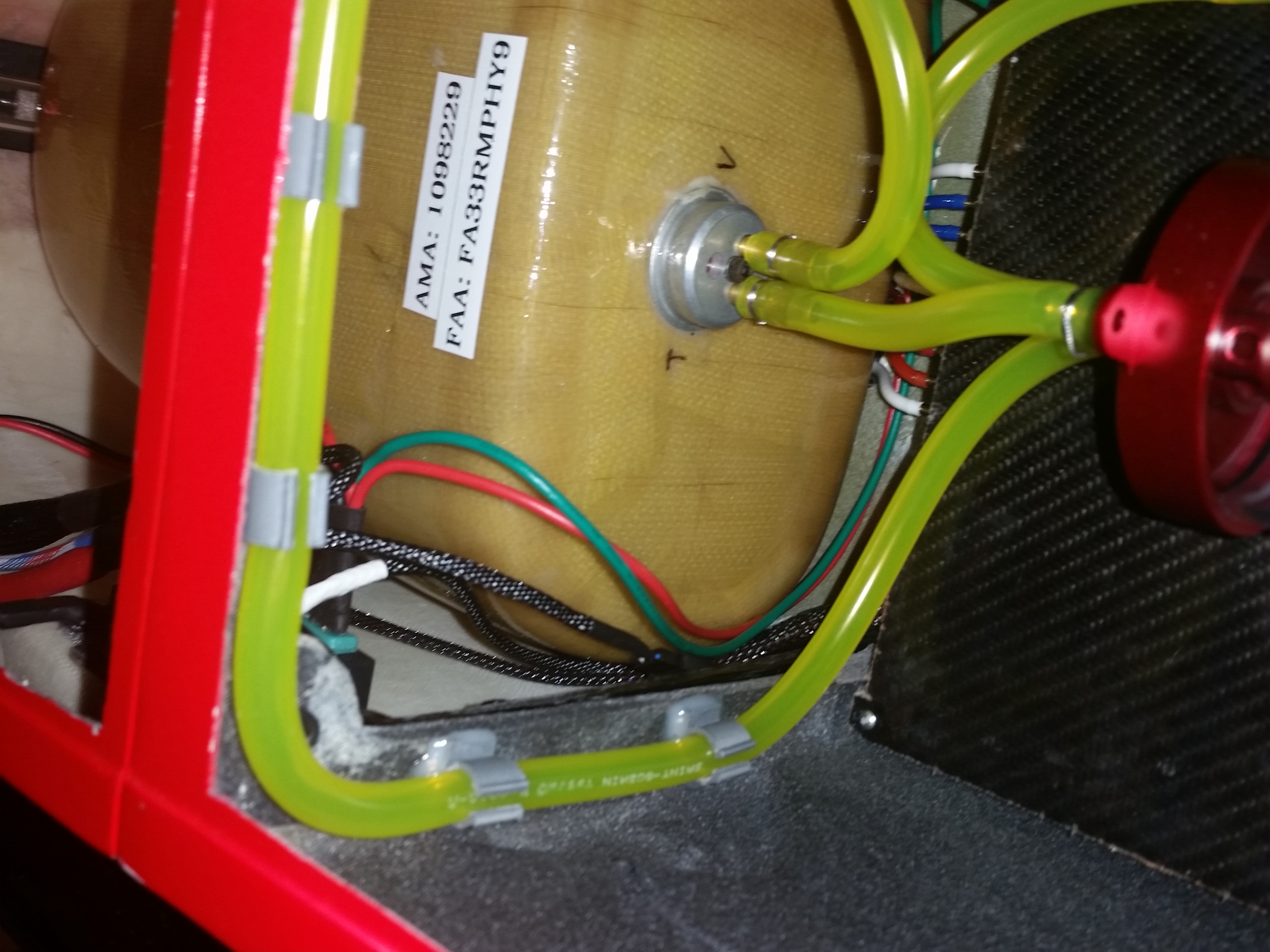

Here is a few more pictures of what I have done. Currently I am working on finishing up the fuel line. I am waiting on 90 degree festo fittings so that I can install the fuel filter in the location in the picture. I am putting at the back of the tank. I made a mount for it so that if needed I can remove it from the mount. I also mounted my tube brackets that holds my fueling/defueling line. I am waiting on the plug to come in. I also have both component plates put in as you can see in the pictures. Once I get the CG meter " maybe this weekend" I will start to balance it. I am looking to put fuel in the air trap and just a hair in the tank so I can balance it how I like it. Question for balancing, do you balance with the cockpit in or does that matter? All my neighbors are waiting for me to get this thing done so they can hear it start up! I keep telling them that I can only go as fast as the mail will let me.

FenderBean 04-07-2016 08:33 AM
http://www.rcuniverse.com/forum/atta...mentid=2156236http://www.rcuniverse.com/forum/atta...mentid=2156237http://www.rcuniverse.com/forum/atta...mentid=2156238http://www.rcuniverse.com/forum/atta...mentid=2156239
Bling bling LOL looking food, I like those tygon line holders. Be sure and balance with the cockpit in, gear down and with the UAT full.
JoeJr1485 04-07-2016 07:01 PM
okay sweet! Thanks Keith. I got the holders from Ultimate jets. I got a ton of them b/c I know I will need them for the next build.

Looking very clean with those tasty Intairco parts, good job! :)

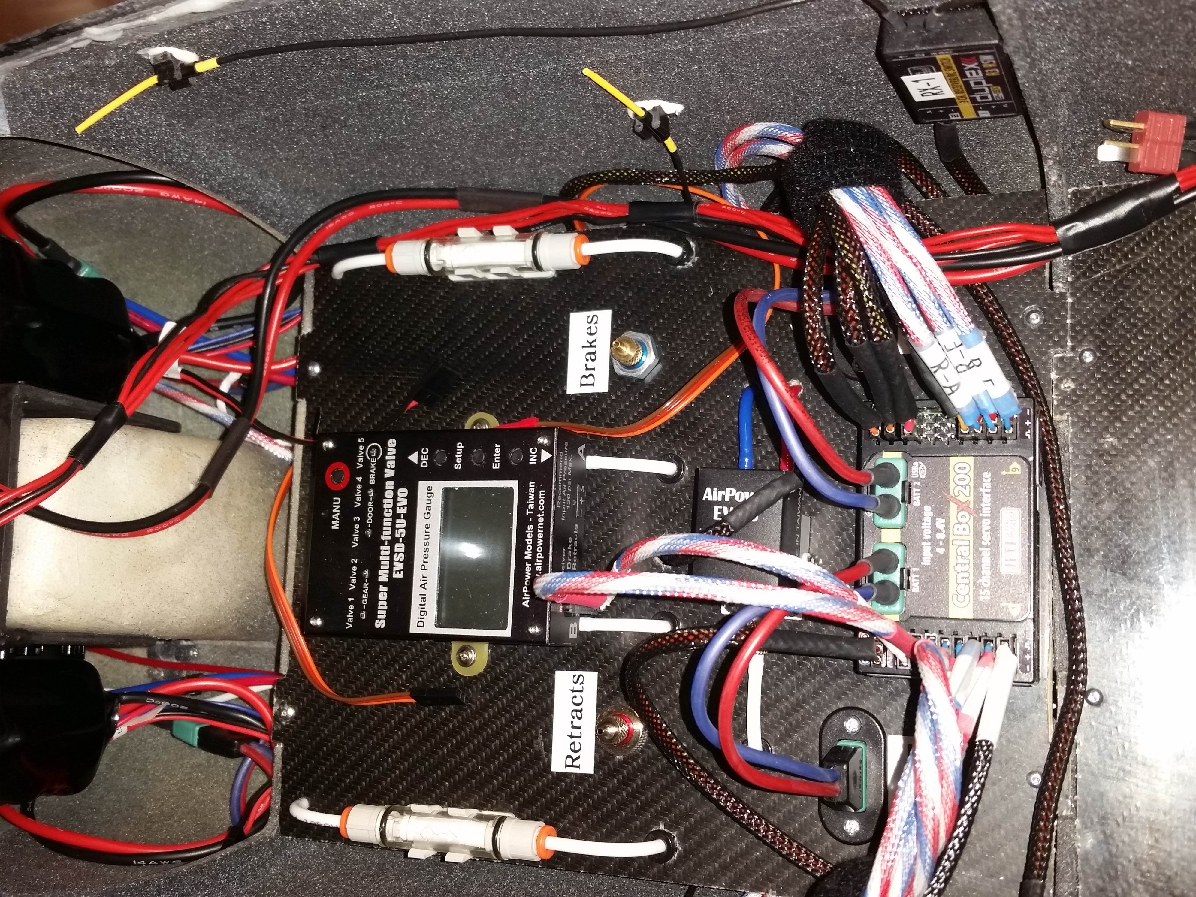

6 Attachment(s)

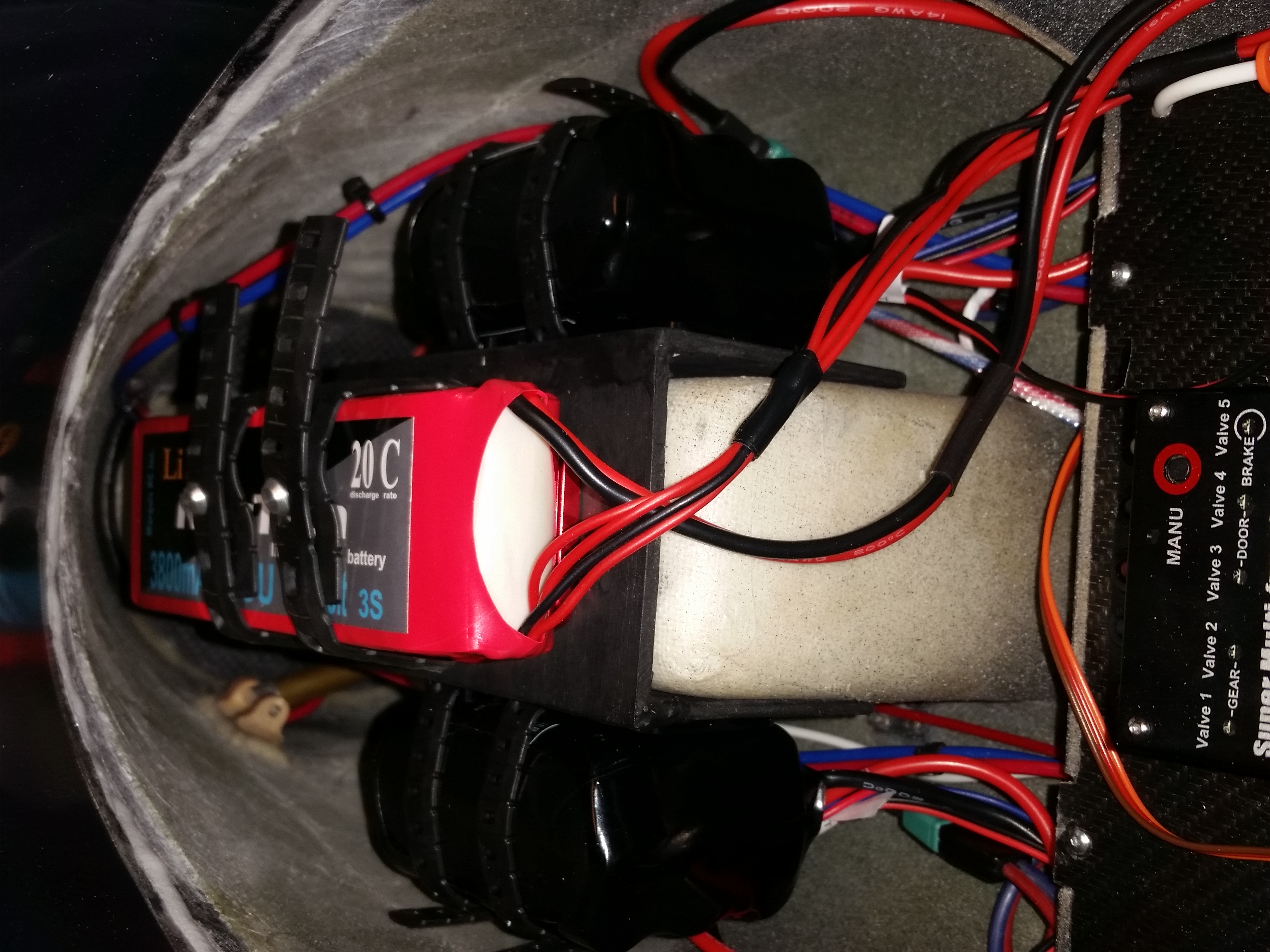

Okay I narrowed down my rudder servo problem to my CB200. I hooked everything up to a 12 Channel Jeti receiver and used the same battery and what do you know smooth as icing. I switched out batteries with another one and same thing nice and smooth. I still need to try another channel on the CB 200 just to make sure its not my complete radio setup but if it is I will start fresh. If that doesn't work then I am calling Jeti for a replacement. I will post soon of my results. I have also attached pictures of tank install completed, electronics, and battery holder. The dry weight come out to be 35.2 pounds.

JoeJr1485 04-13-2016 04:00 PM
Okay so I reset my CB200 and its still doing it. my other MKS servos are not doing that and its funny that on the R12 receiver it works fine but not on the CB200. I also noticed that the first 8 channels on the 12 channel is PPM and the rudder servo falls in the 8. I don't think you can set PPM on the CB 200 which sucks. I need help figuring this out please.

JoeJr1485 04-13-2016 06:09 PM
Okay I have it fixed!!!! not sure why I have to do it this way but it works very smooth now. Here is the video: https://www.youtube.com/watch?v=net9ZsPwEyE

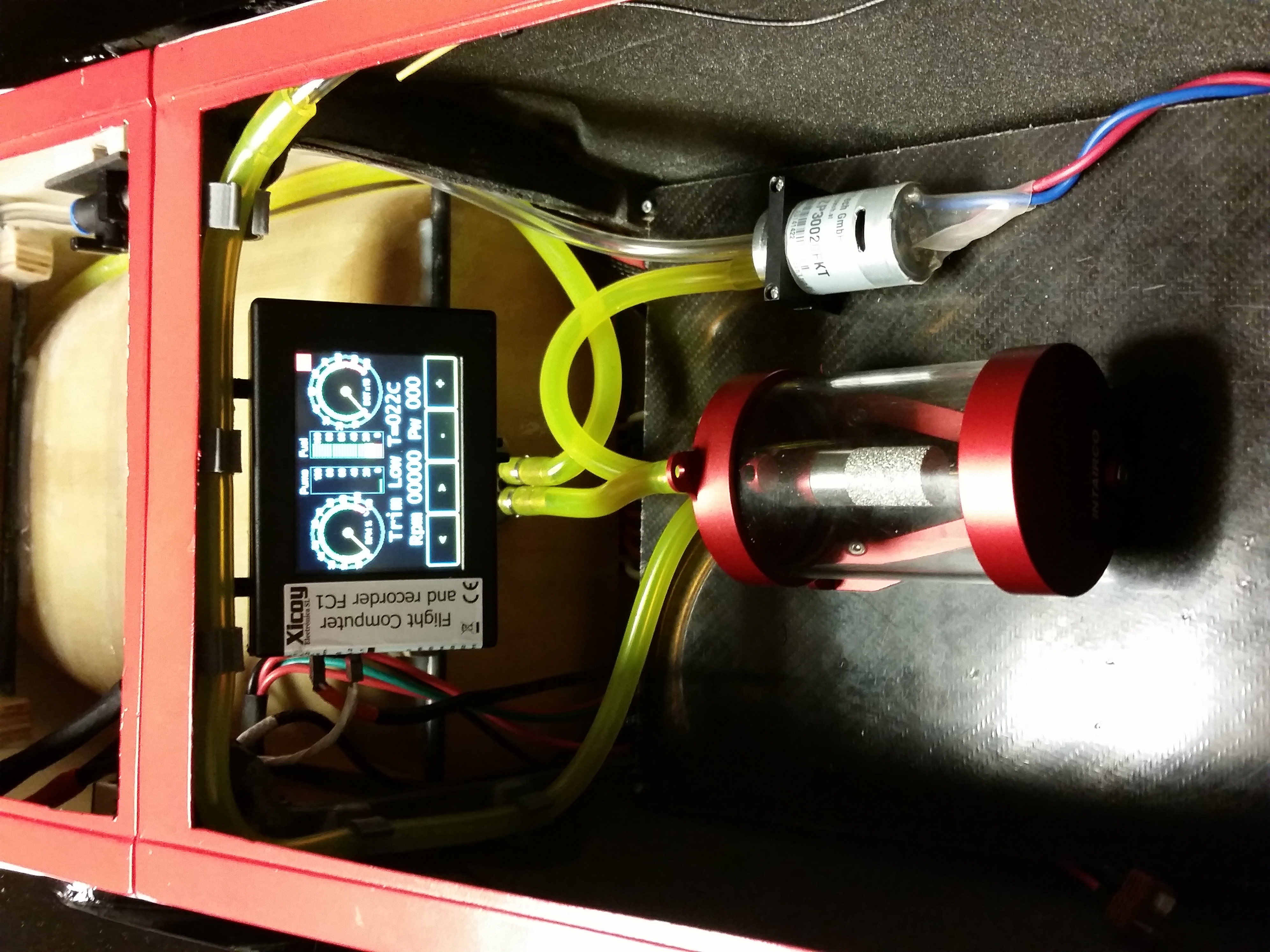

2 Attachment(s)

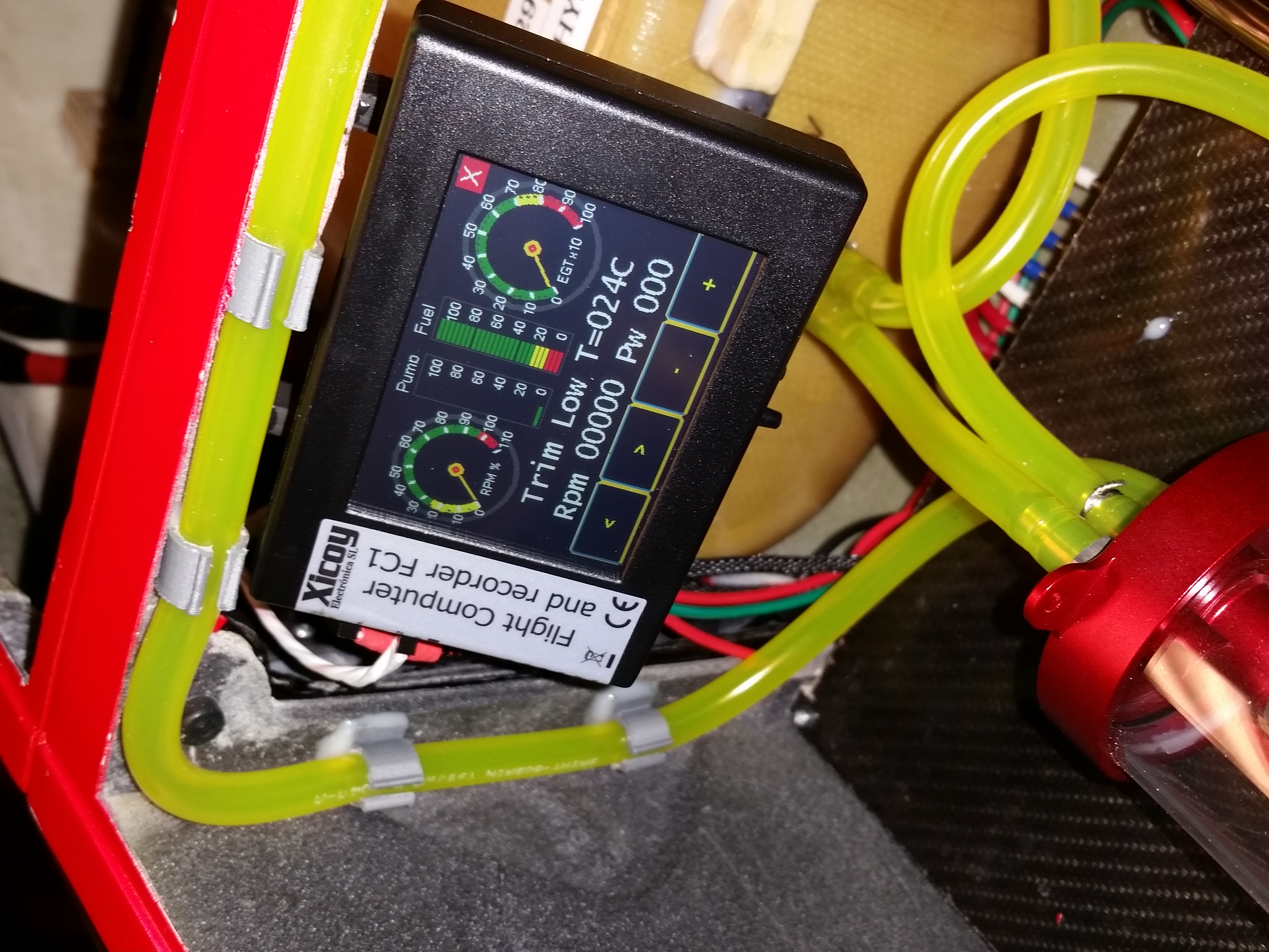

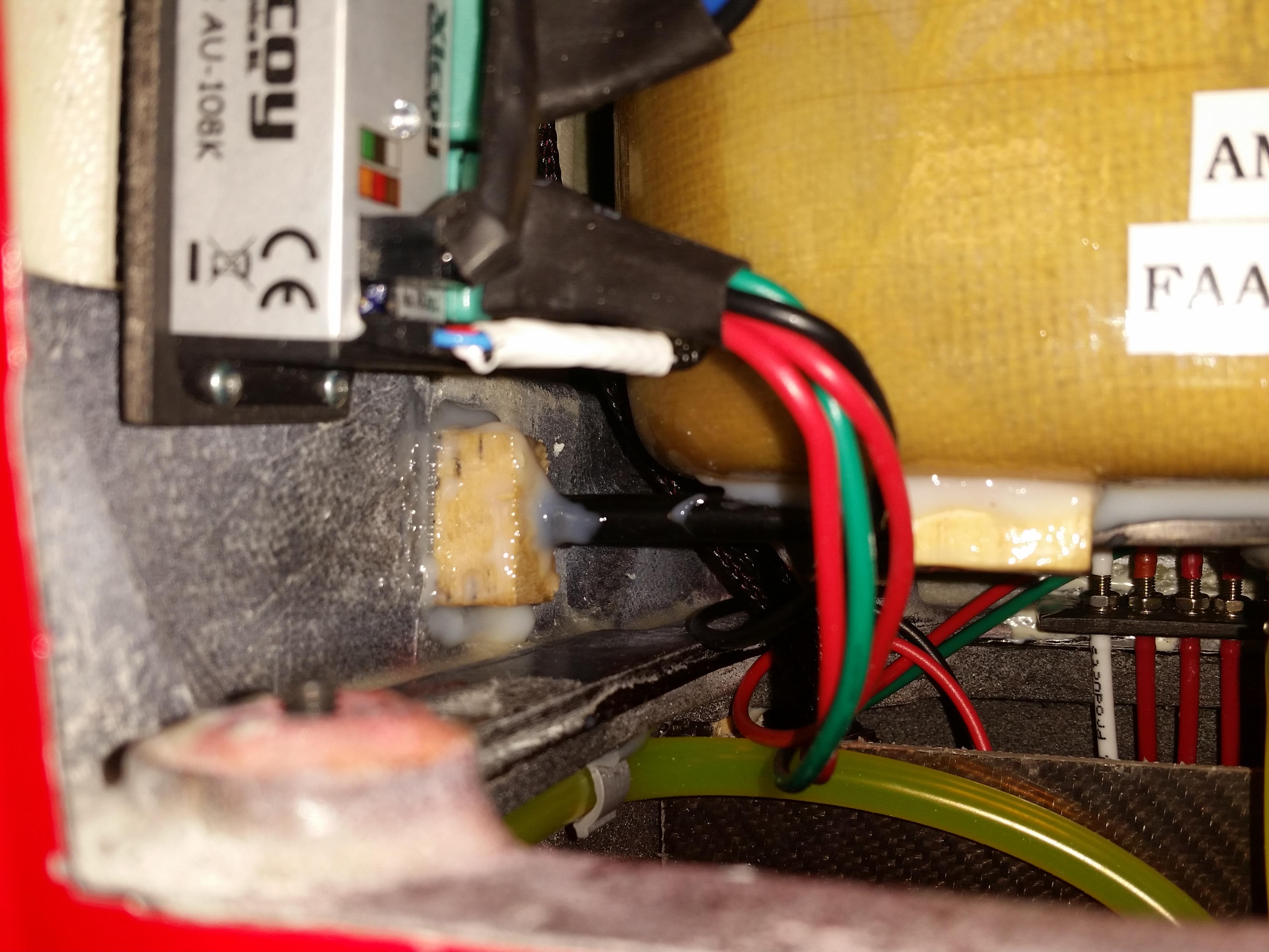

I had a setback on the build. I have to replace the servo in the rudder from a MKS 777 to a Jr8911. there is an issue with the MKS and Jeti not liking eachother with long extensions. It should be in on Monday. I also have the xicoy FC1 installed and it looks awesome. here is a frew pictures of it.

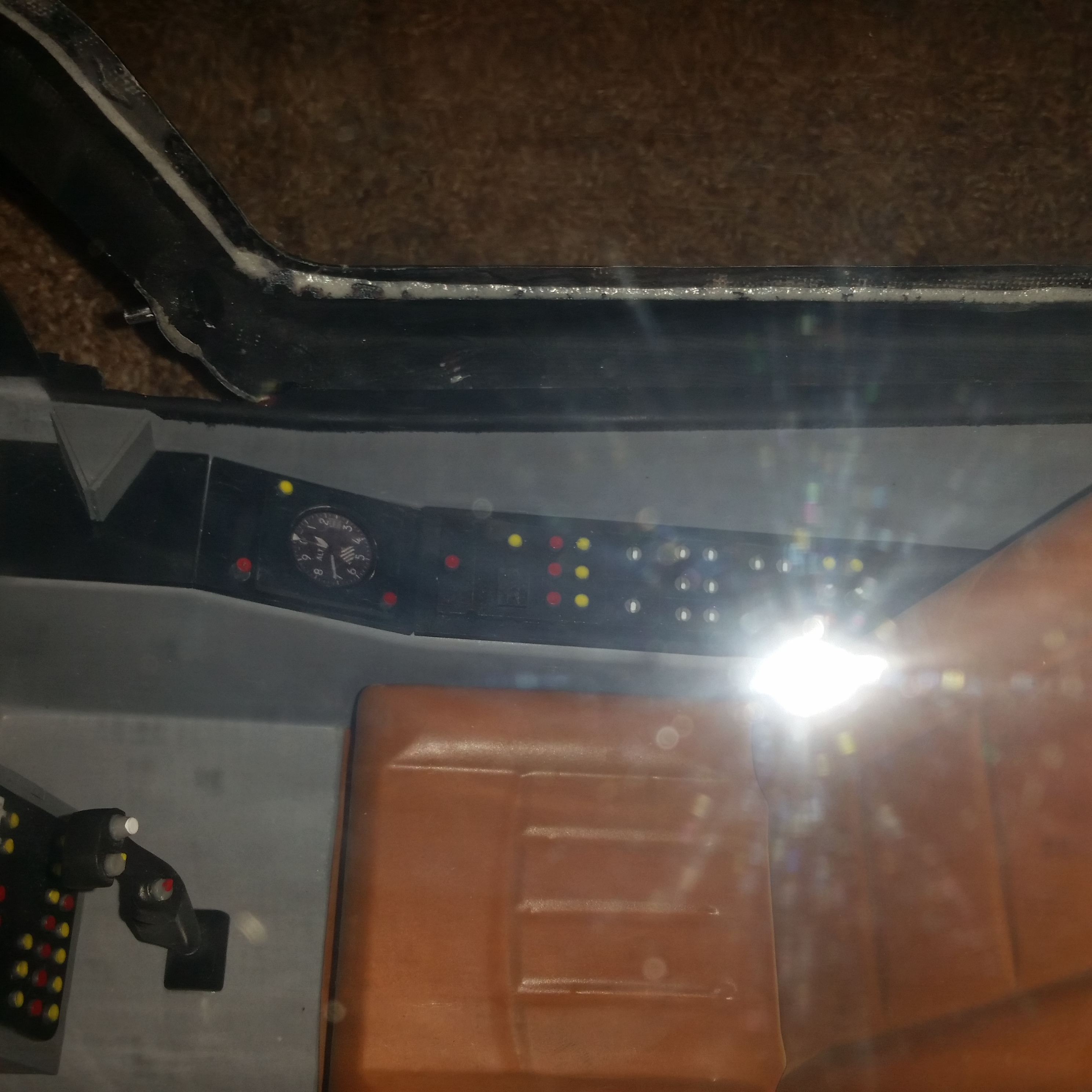

6 Attachment(s)

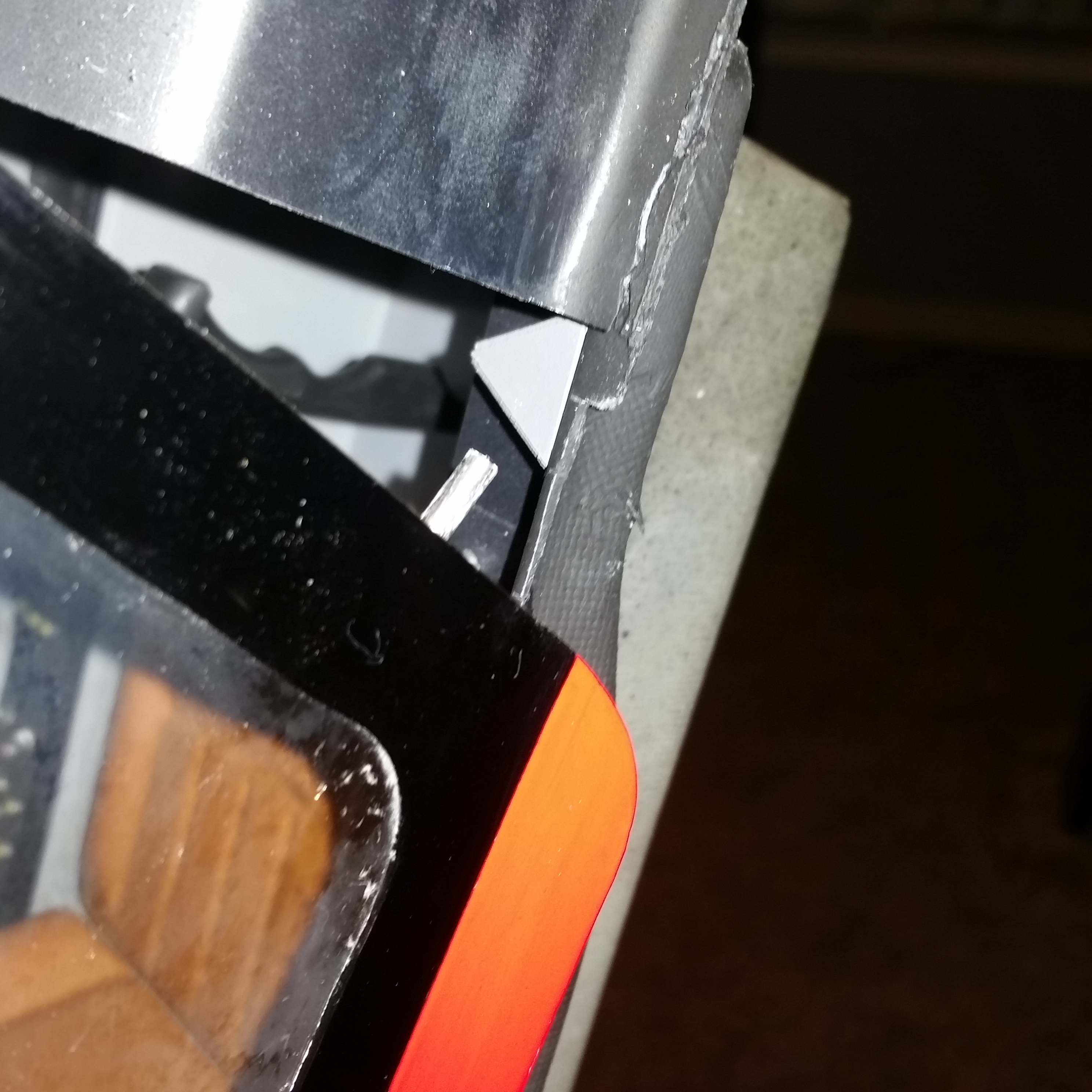

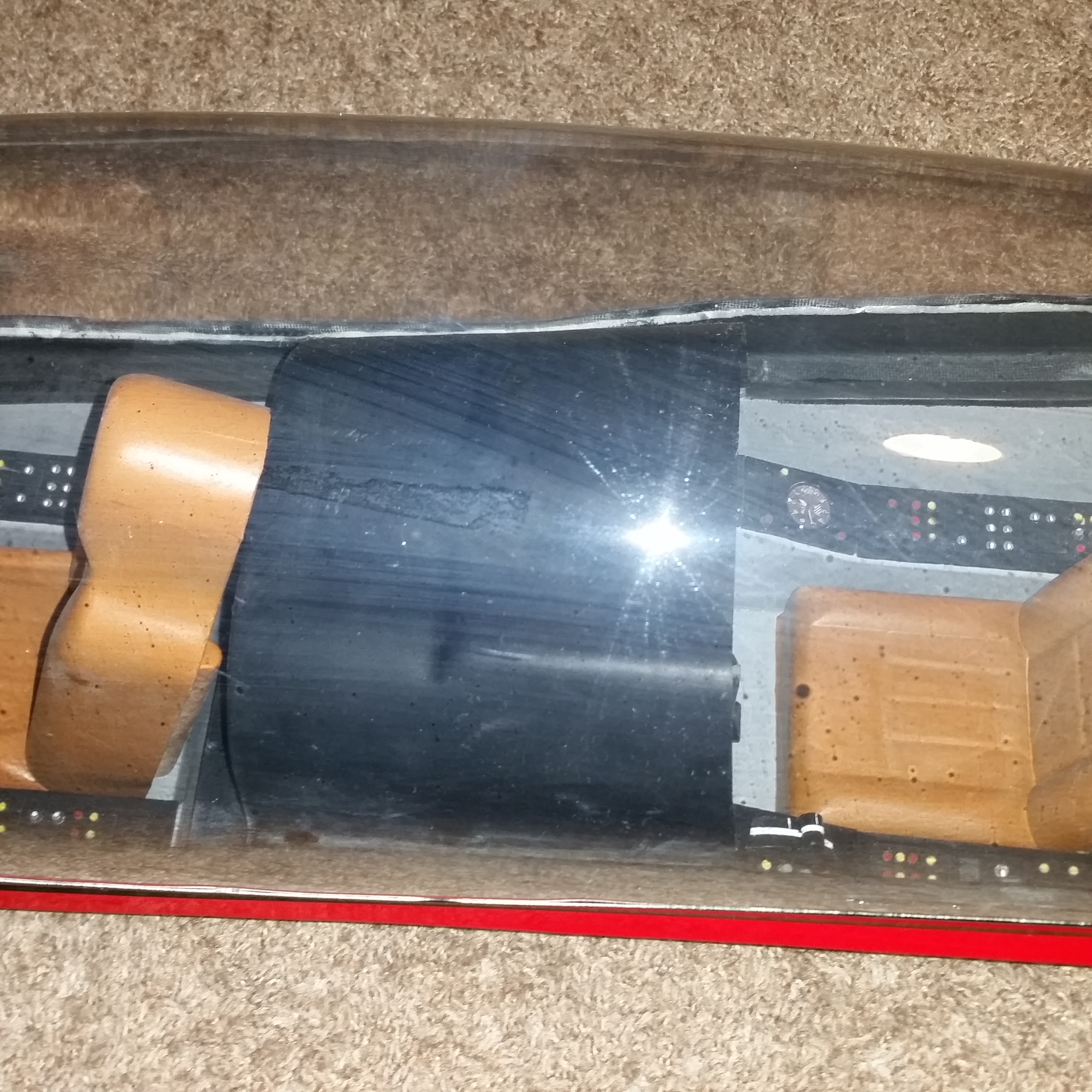

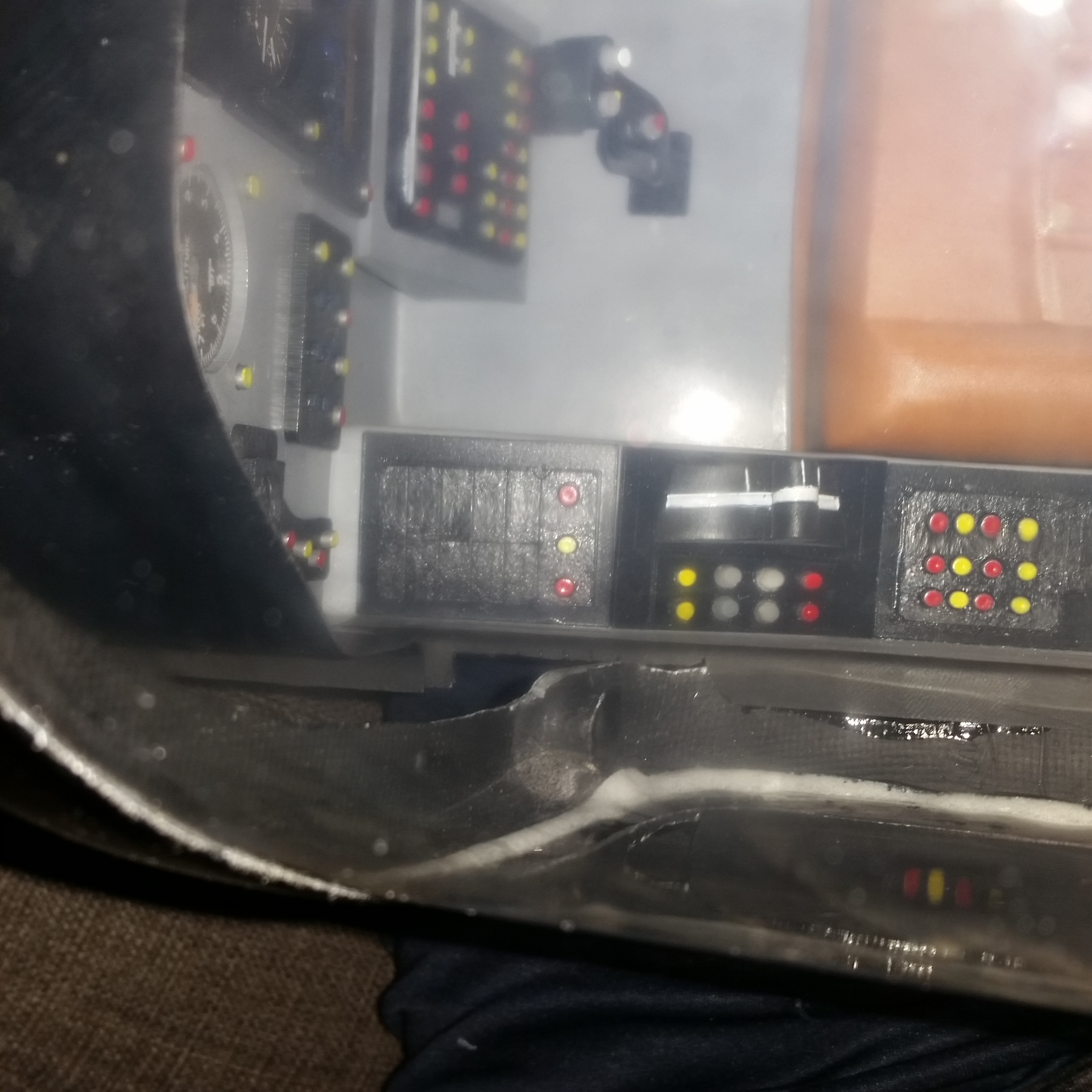

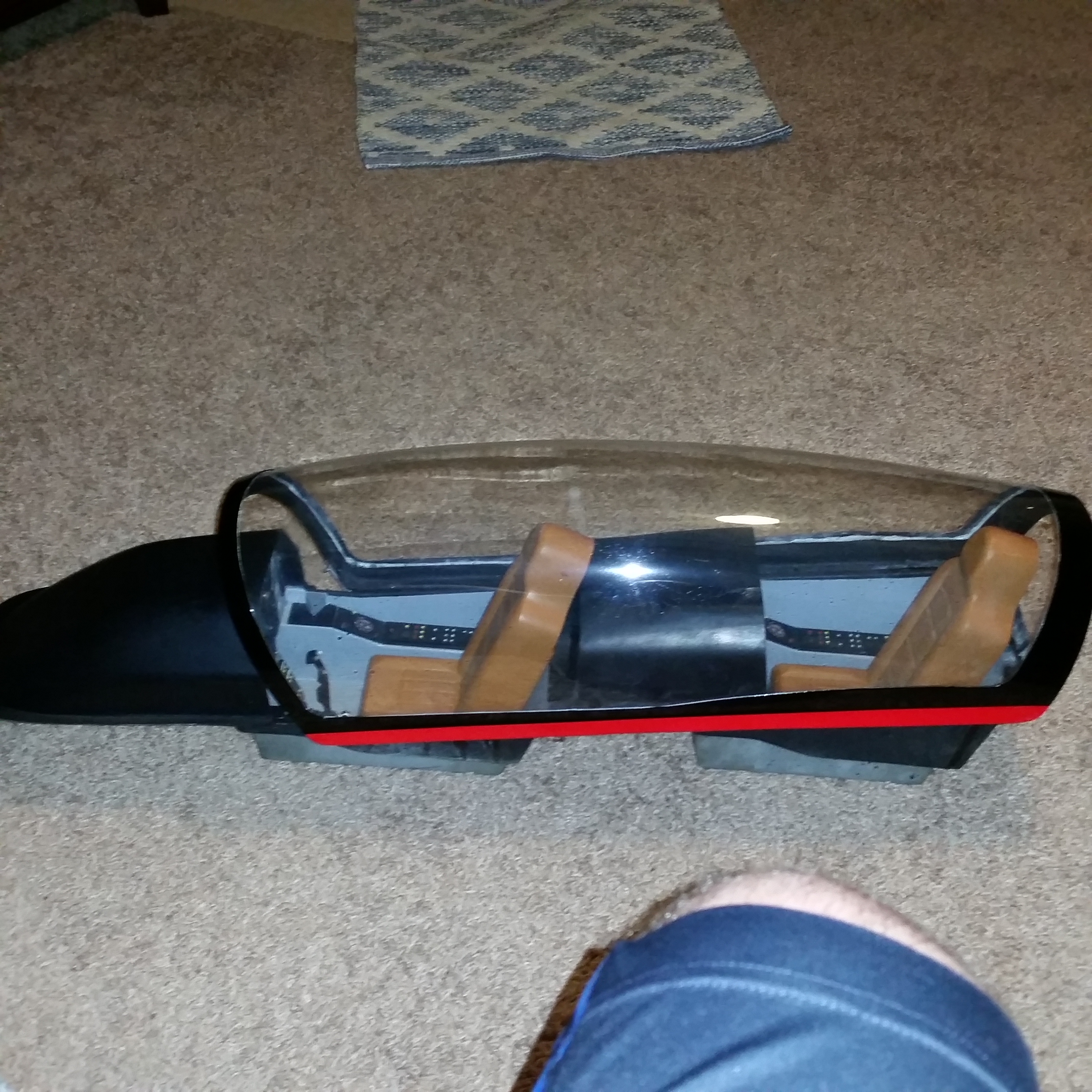

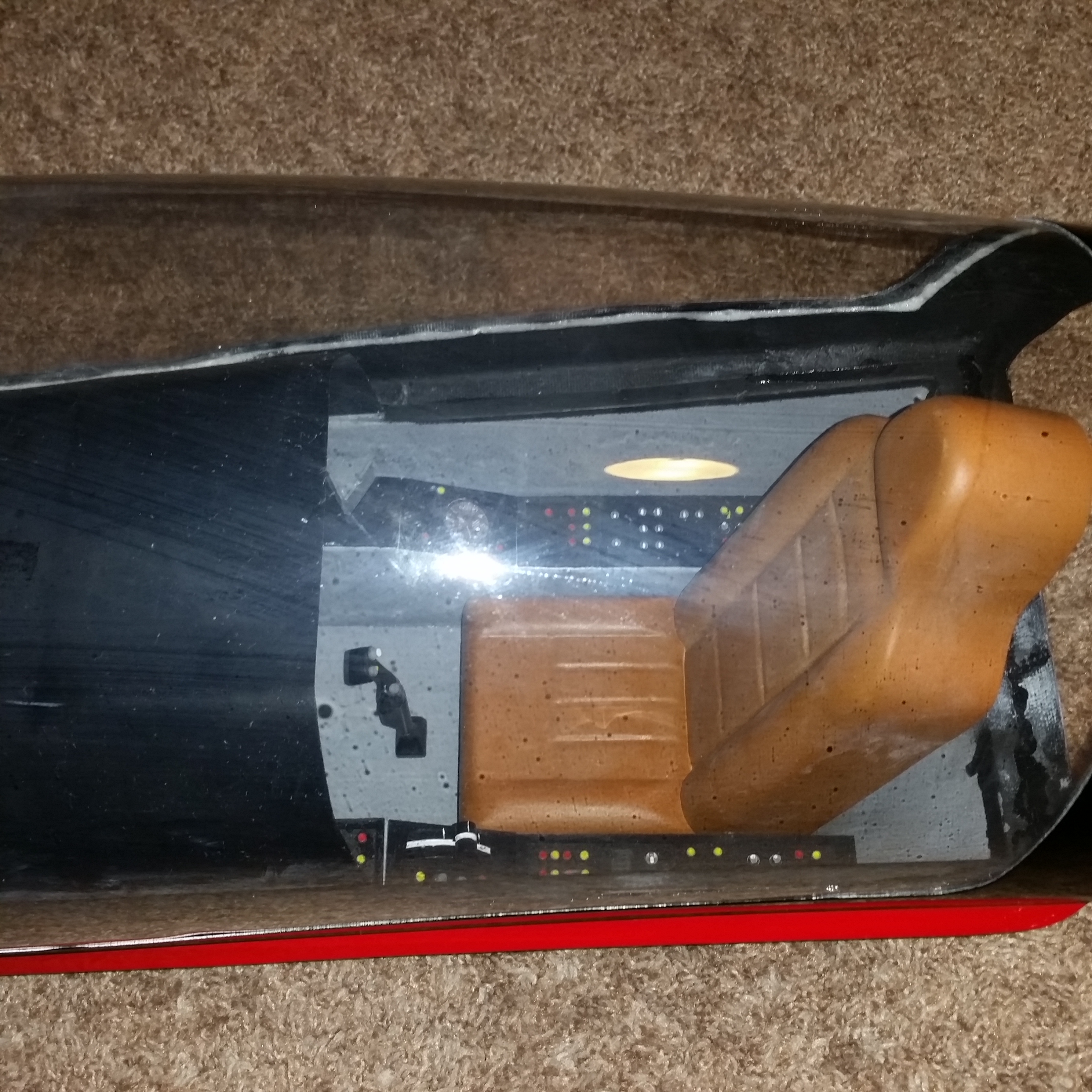

So I got the new cockpit in and have it glued into the canopy. I masked it off and painted the over hanging lip that is glued to the canopy black so it blends in What I also had to do is at the front of the cockpit where it passes through the canopy; applied little notches so that when placed inside the fuse, it will pass the alignment holes in the front. It has a great fit and it is easy to get out and put in. I ran into an issue after the install. I thought it was a good idea to use thick CA to glue it in place and it worked great but now I have a fog film on the clear plastic :mad:. I have most of it removed by using canned glass cleaner but looking at the pictures you can still see a little of it. It also clouded the black cover that is around the passenger seat. But after a good wipe (or the best that I could get using a paper towel and a rod to get inside) looks okay now. Praying that it stays that way. I have to find something a little longer to reach all the way to the middle of the clear plastic so I can try and clean it. The other option that I have is that When I got the airframe from FB, they gave me an extra set of clear plastic that I could just replace it but the issue is, I am trying to figure out how I will take the current one out with the cockpit still glued in. The cockpit flanges along the side are kind of brittle and I am afraid that if I try to remove it, it will mess it all up. If I remove the clear plastic with the cockpit in I will have to use a exacto knife with a square tip on it. that's fin but not sure how I will put the other one in with glue and hold it in place. I am hoping you all can give some guidance on this one. Here are some pictures.

FenderBean 05-28-2016 08:37 AM
1 Attachment(s)
Only thing I can think of would be some air plane window polish it's for clear plastics. I bought mine at the auto store a long time ago works great for making a crystal clear canopy. Also the best thing I have found for canopies is hysol or the rc canopy glue. For mounting the cockpit buckets I have switched to regular old goop. It's clear and if you need to remove the cockpit from the canopy for any reason you can. It's good for securing fuel tanks and air tanks as well.

JoeJr1485 05-28-2016 10:20 AM
Thanks Keith. I checked this morning when I got up and it still looks better. I need to try and get all they in the middle to clean it as well. I look at getting the air plane window polish. lol So I ordered the canopy glue from DreamWorks but its on back order, that's the reason why I thought it would have been a good Idea to use CA. I also wonder if I had set it in front of a fan to let it fully air out would it have done the clouding. Not sure. Your Viper is looking nice! lol love the minions. For my next project, I WILL not use CA for the cockpit/Canopy install.
