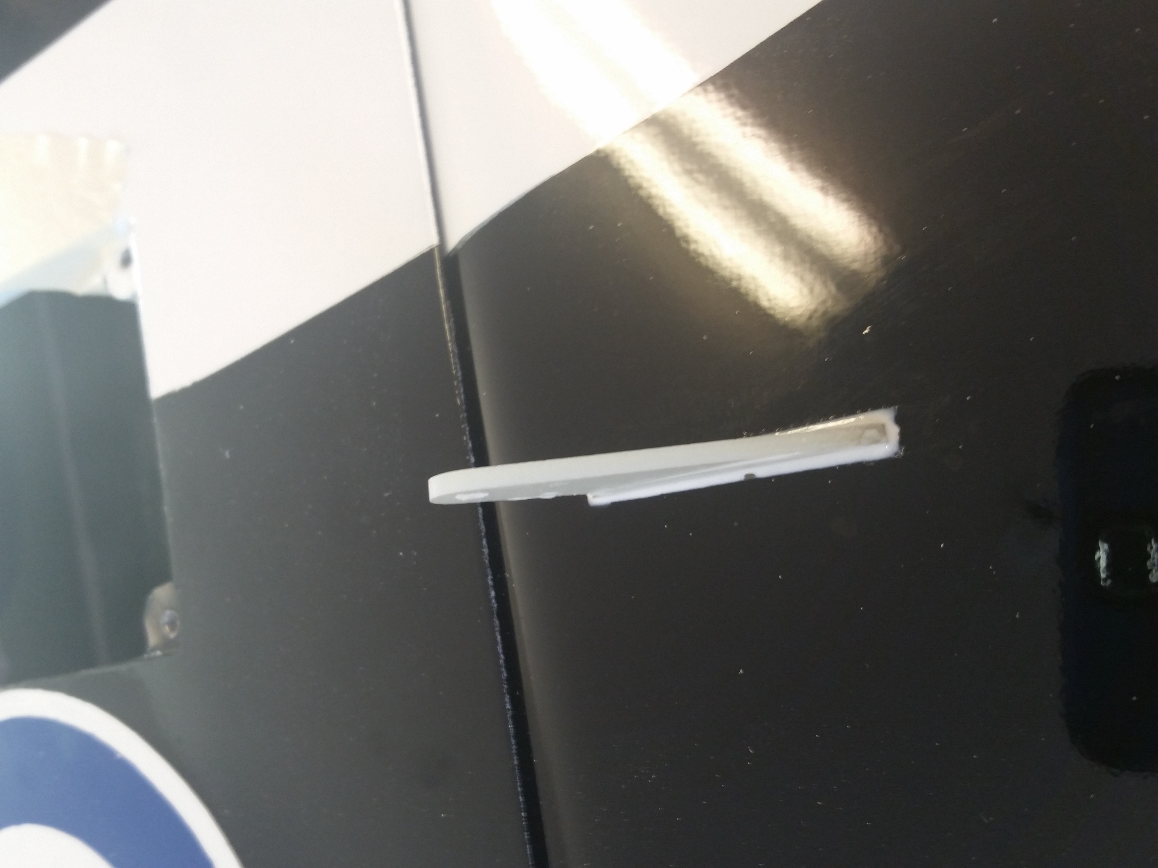

Okay so here are some of the pictures of the unboxing. I will add more in a bit. The only issue that I found is on one of the wing tips I believe a piece of wood broke off inside. I am getting with Marvin to see if I can get it replaced. I have to get my fuselage stand put together today so I can take more pictures. I have run out of room to put the pieces on tables haha. http://www.rcuniverse.com/forum/atta...mentid=2147195http://www.rcuniverse.com/forum/atta...mentid=2147209http://www.rcuniverse.com/forum/atta...mentid=2147211http://www.rcuniverse.com/forum/atta...mentid=2147212http://www.rcuniverse.com/forum/atta...mentid=2147213http://www.rcuniverse.com/forum/atta...mentid=2147214http://www.rcuniverse.com/forum/atta...mentid=2147215http://www.rcuniverse.com/forum/atta...mentid=2147216http://www.rcuniverse.com/forum/atta...mentid=2147210http://www.rcuniverse.com/forum/atta...mentid=2147196http://www.rcuniverse.com/forum/atta...mentid=2147197http://www.rcuniverse.com/forum/atta...mentid=2147198http://www.rcuniverse.com/forum/atta...mentid=2147199http://www.rcuniverse.com/forum/atta...mentid=2147200http://www.rcuniverse.com/forum/atta...mentid=2147201http://www.rcuniverse.com/forum/atta...mentid=2147202http://www.rcuniverse.com/forum/atta...mentid=2147203http://www.rcuniverse.com/forum/atta...mentid=2147204http://www.rcuniverse.com/forum/atta...mentid=2147205http://www.rcuniverse.com/forum/atta...mentid=2147206http://www.rcuniverse.com/forum/atta...mentid=2147207http://www.rcuniverse.com/forum/atta...mentid=2147208

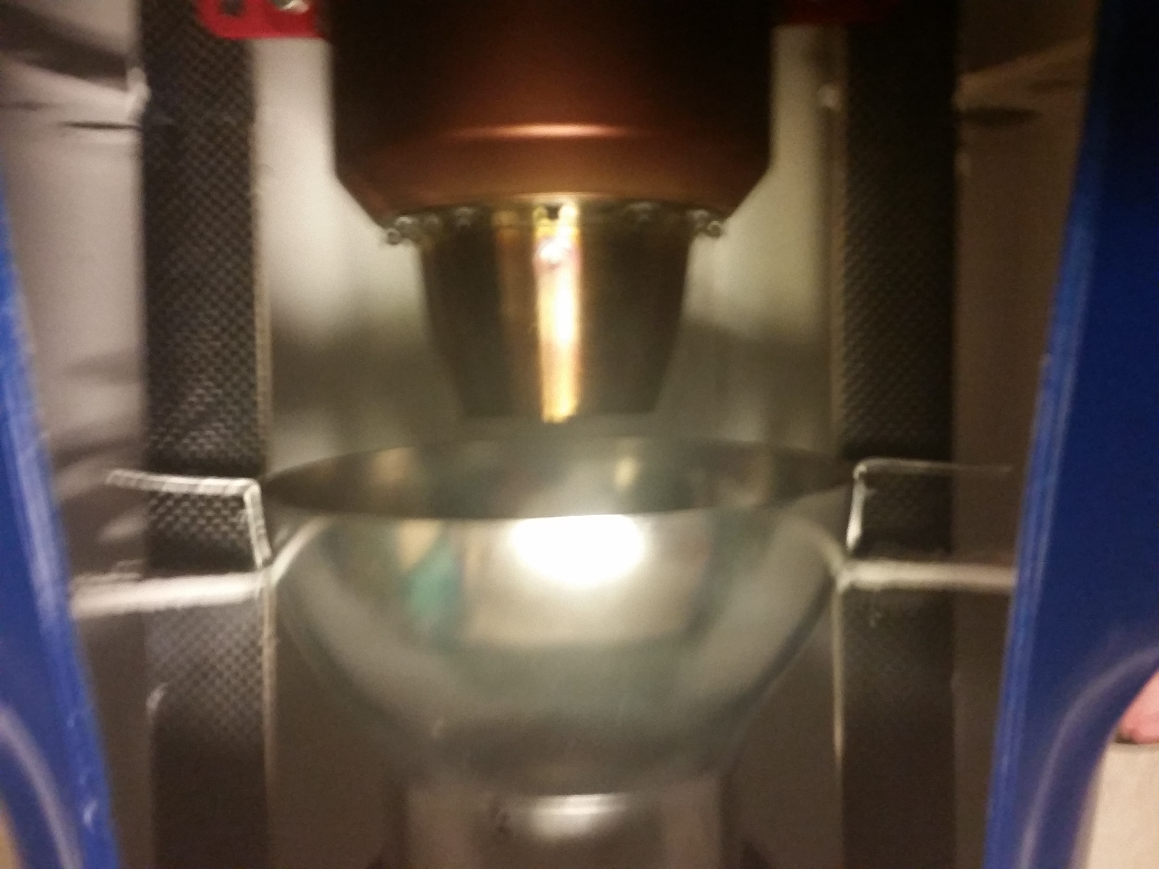

So I'm about to coat the turbine area with heat shield paint. What is the best or recommended cleaner to ensure the inside is clean? do you just use a wet cloth or do you use something else to make sure its clean?
trying to find out what cleaning agent or solution to use inside the fuselage. I want to start putting on the heat shield paint but want to clean the inside first. What are your recommendations?
JoeJr1485 02-15-2016 10:12 PM
9 Attachment(s)
Well I didn't get a response from anyone regarding what to use to clean the inside of the fuselage. So I just used water and a wash cloth. I applied the heat shield paint two coats. I am waiting for the blanket to come in so that I can cut it to fit between the bulkheads. I applied the paint to the bulkheads as well. I forgot to take another picture of the bulkheads that I missed and reapplied.

In regards to the cleaning, I would use acetone or something like that to remove mold release from the inside. As for the fin, if the thread I loose in the fin you can either go with a large screw and just make the hole bigger on the jet or you can add some hysol to the screw and secure it. Just make sure the fin has a block of wood inside for the screw to attach to. Welcome to jet building :D
What bulkheads are you missing?
Also for the future, the ceramic paint is heavy and generally you only need it around the aft part of the turbine and bell mouth area. Lots of room between the turbine and skin in this particular model, other jets that have a tight fit turbine may require more area. I personally wait till the turbine test runs and check for hotspots then add heat protection. The wires in the tail all get heat protection during the build, I just hold the turbine area till its ran.

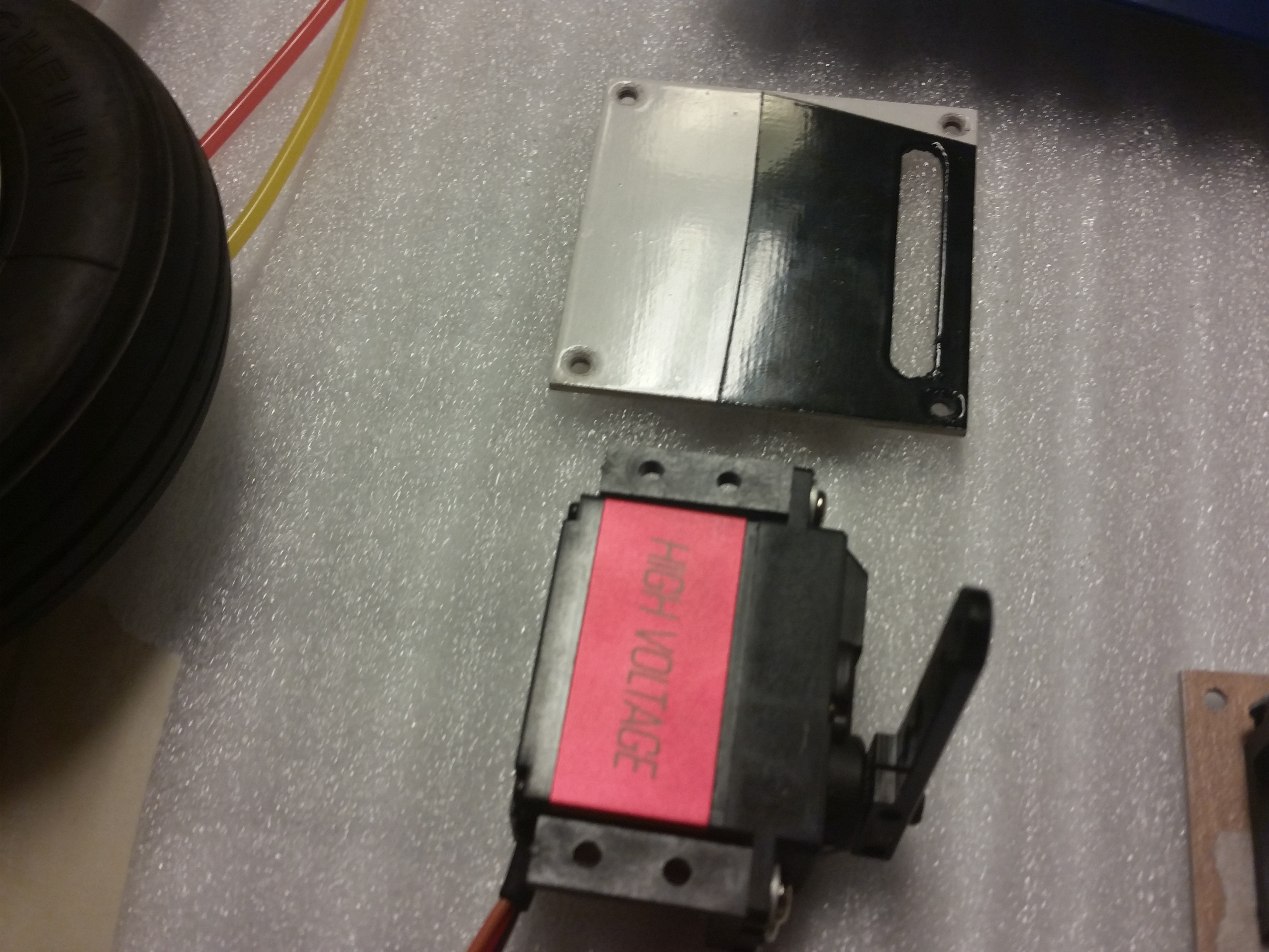

Keith I forgot to add. I talk to FB about the screws being too small for the servo mounts for the wings and they informed me that we are supposed to use wood blocks to fasten to the servo covers and then servos to wood blocks. I told them that in the manual it doesn't show or state that. I will be going to the shop today to get some wood, glass and work on them today. I will post pictures later tonight.

So I got a little more done this morning. I had to go out and get a band saw last night. I wanted to get one anyways so good time to get it. I got all my wood block cut, glued in place for my servos. Have to wait until its dry to reinforce with the screws. I am going to apply a thin layer of hysol over the wood blocks to seal the grain.
http://www.rcuniverse.com/forum/atta...mentid=2148502http://www.rcuniverse.com/forum/atta...mentid=2148503
FenderBean 02-20-2016 01:32 PM
interesting the one I am building for my friend is different, the servo mounts are attached to the top plate with screws.

Hey Keith, I was having the same issue with the screws being too small for the holes so when I talk to Catherine at FB she informed me that they are supposed to be screwed into wood blocks. I informed her that in the build manual it doesn't state that and they didn't supply the wood blocks or parts for it so I had to make my own. If you add all the small screws up 8 per servo it comes out right. two for the blocks to plate and two for brackets to block. What I did is I placed the servos on the plate then measured what size I needed. I hysoled one side and put them in place with the servo sitting on top so that I get the correct distance needed. I wait to dry then drill holes from the plate to block, insert screws. Once they are done I will take another picture.

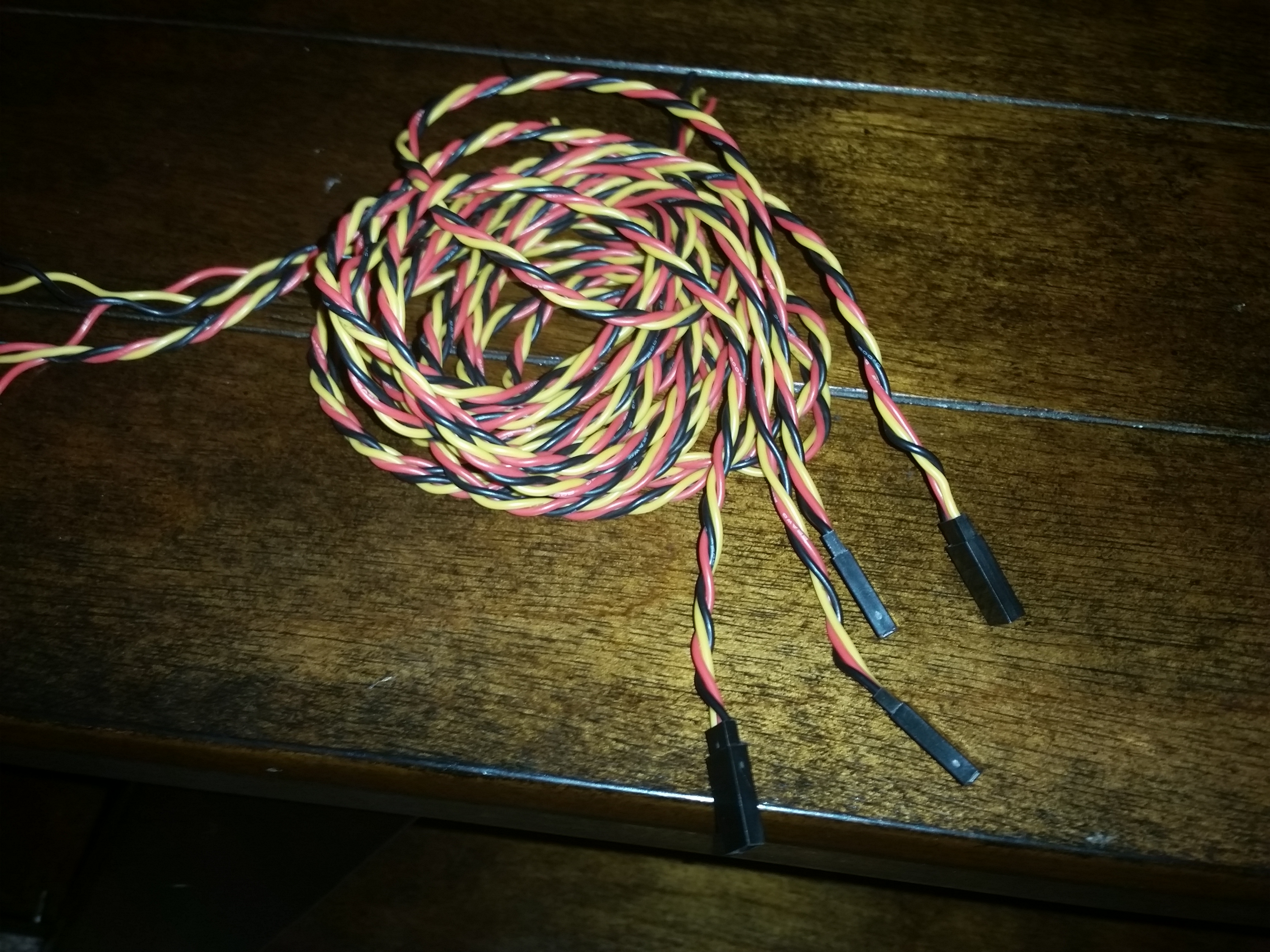

So while waiting for the hysol to dry on the blocks of wood for the servo mounts, my wife made me watch one of her shows. So I decided to make up my extension wires for the wings. The unfixed ends will be soldiered to a 8 pin plug. The connection from the wing will be free hanging and the connection in the fuse will be mounted. The servo wire inside fuse will be all powerbox servo wire from dreamworks. I will take pictures of that part soon and will add to this post. Wires will be incased in braded wire loom. but for now here is my extension.

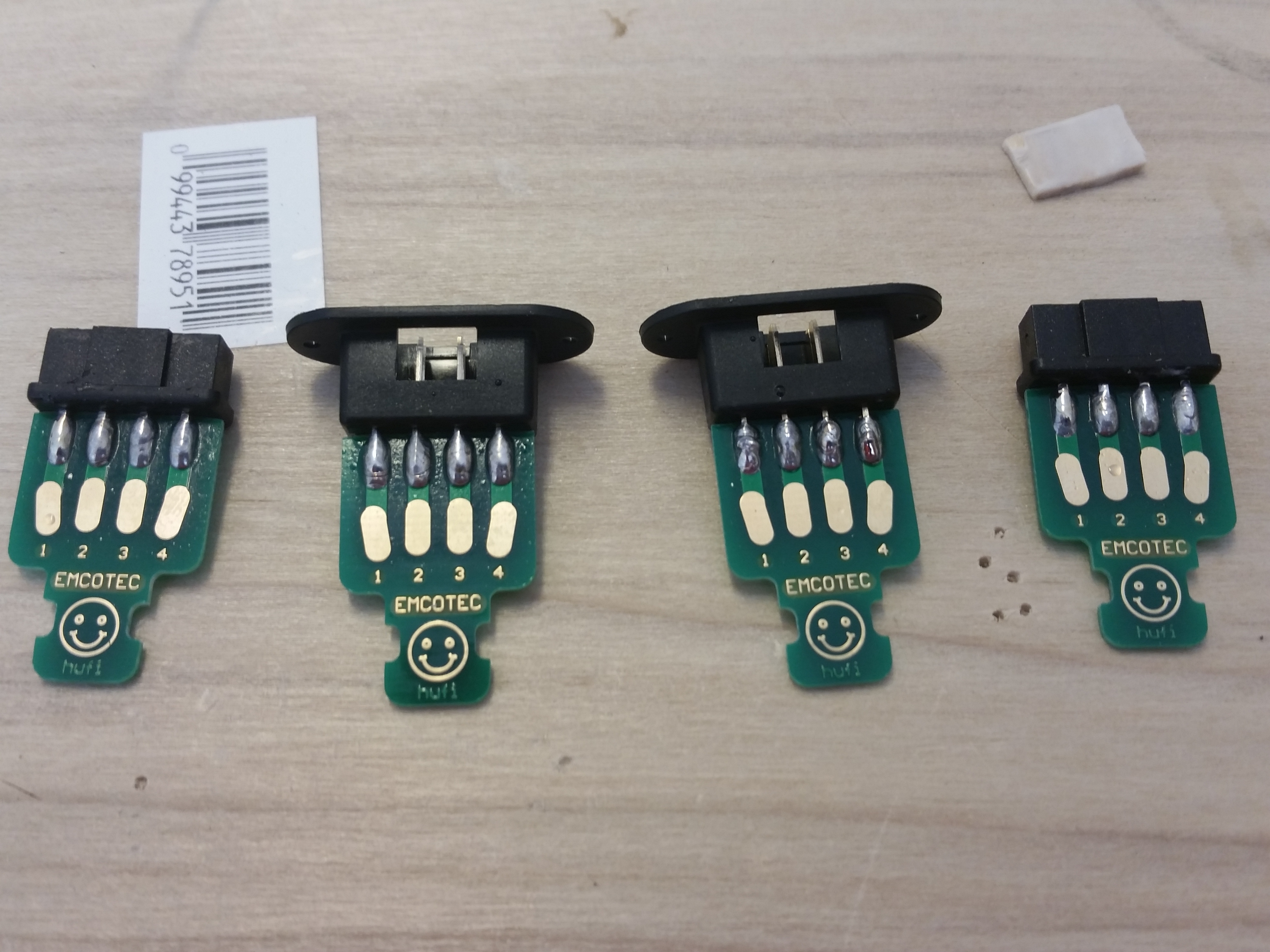

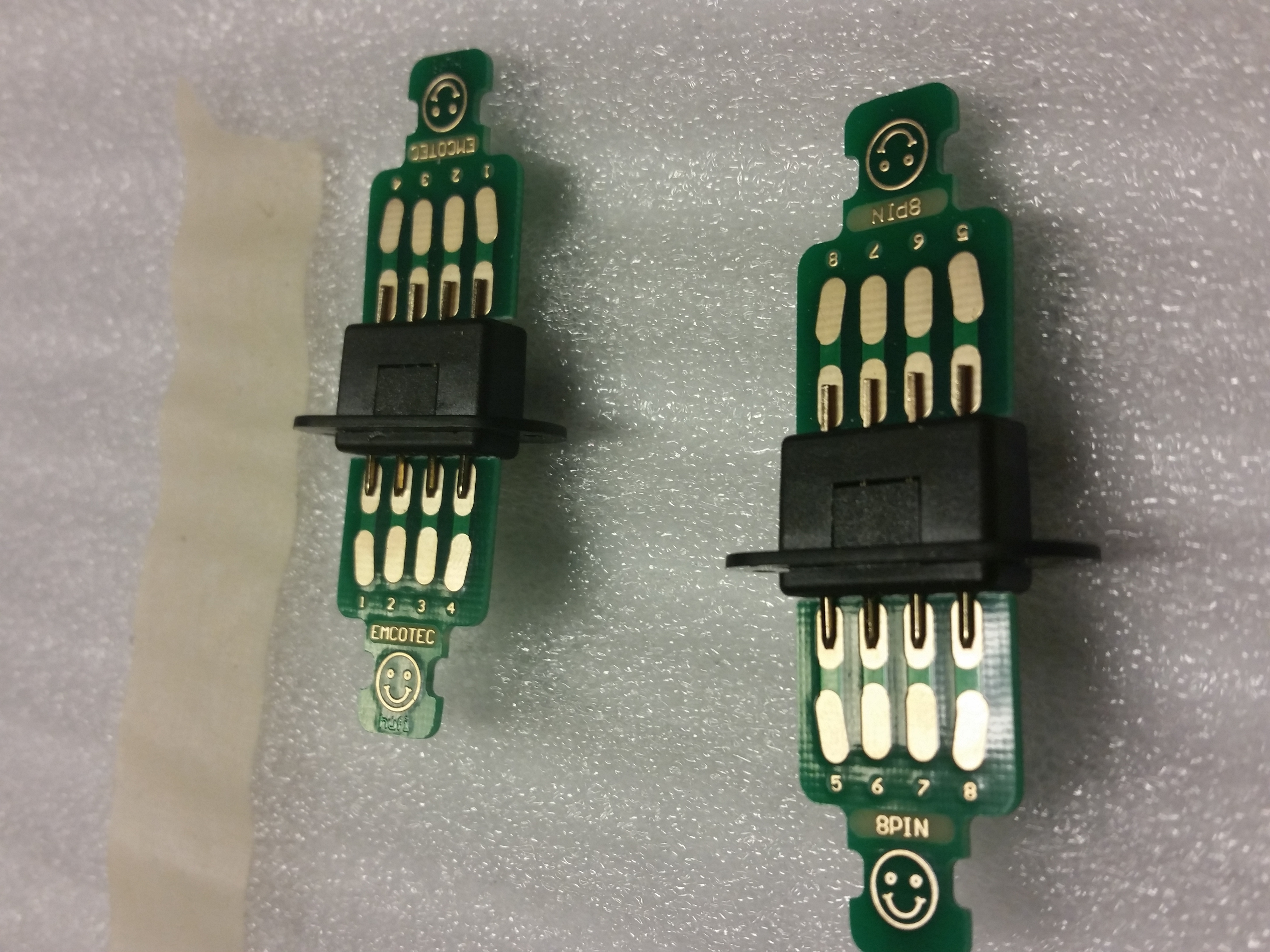

Well I am still waiting on items to arrive today so I decided to soldier some connections for the wings. Just add a little flux and good to go.
