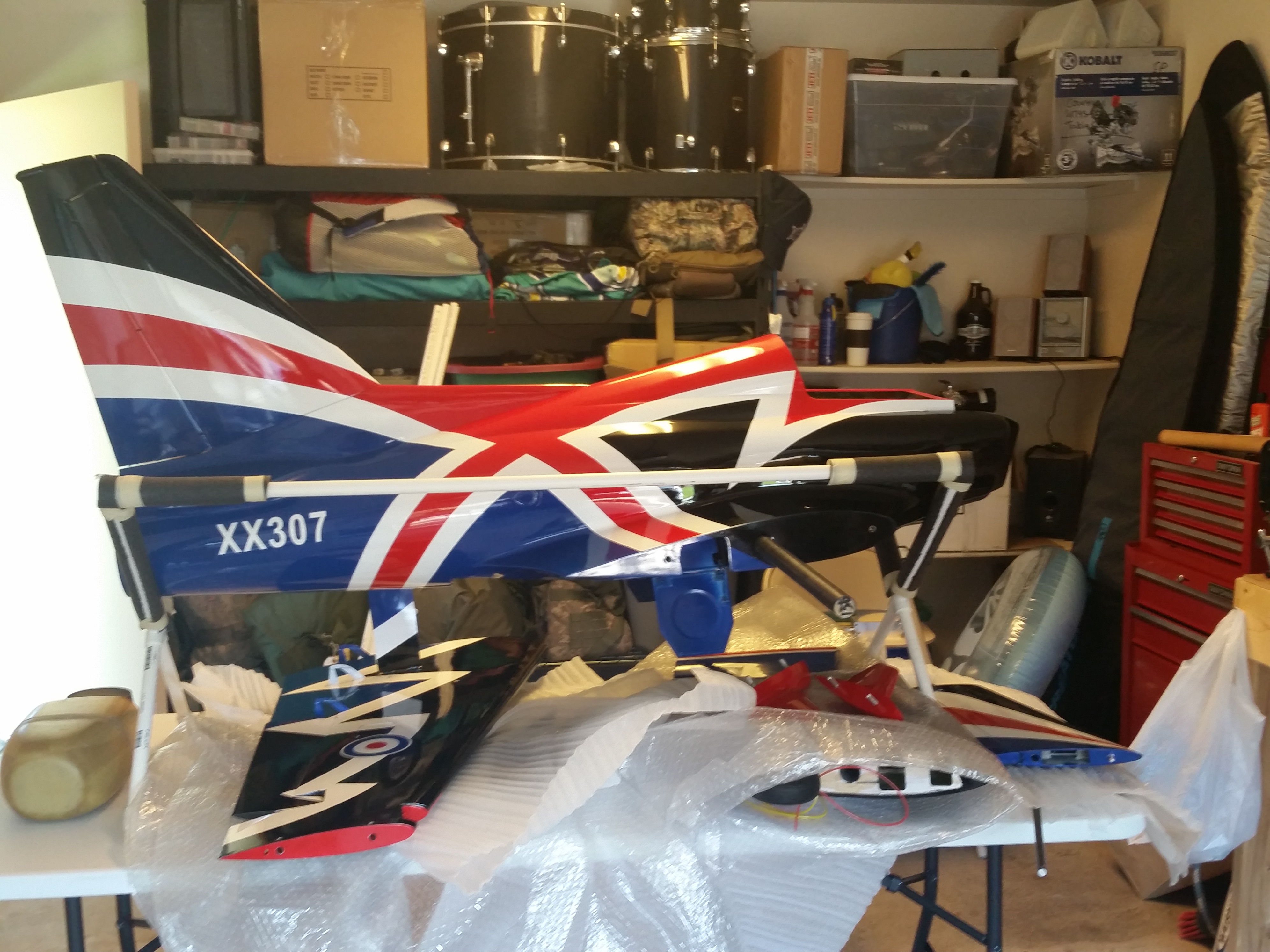

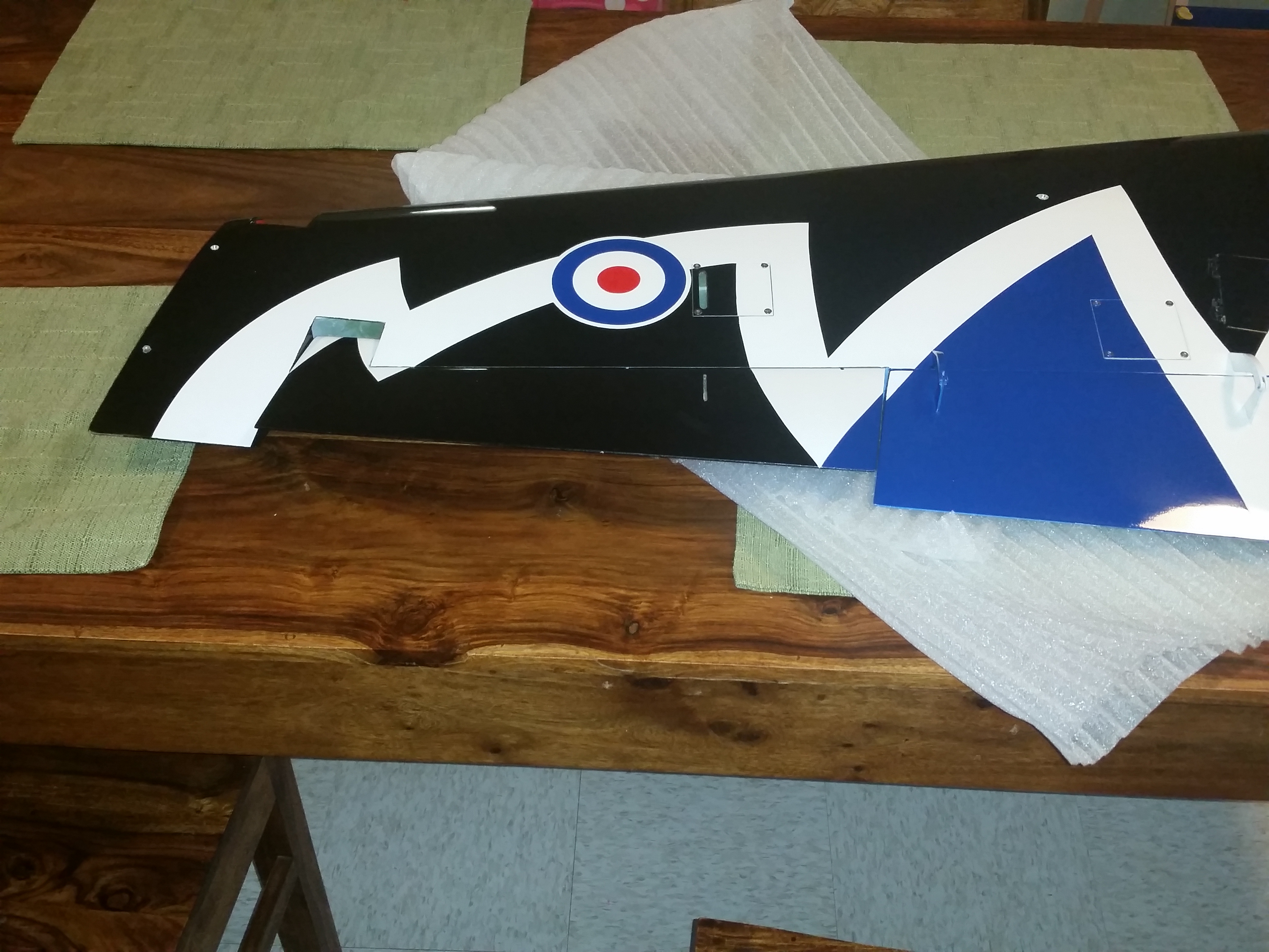

Well it's done! I purchased a FB Viper and I just got pictures showing that it's done with paint and put together for me to see the final product. I have not seen a FB Viper build on here until fenderbean started one. It was with his thread that is going help me build this thing. This is my first turbine build so I would like to have each and everyone of you to aid in my build. "We are going to build it together". What I would like is support and I know I will be asking questions and suggestions from you hence build it together. My radio equipment is Jeti and a mix of Jr and MKS servos. This is going to be a slow build due not being used to buying high end equipment lol. So I will keep my eye out on second hand items. Once it arrives I will post more pictures.

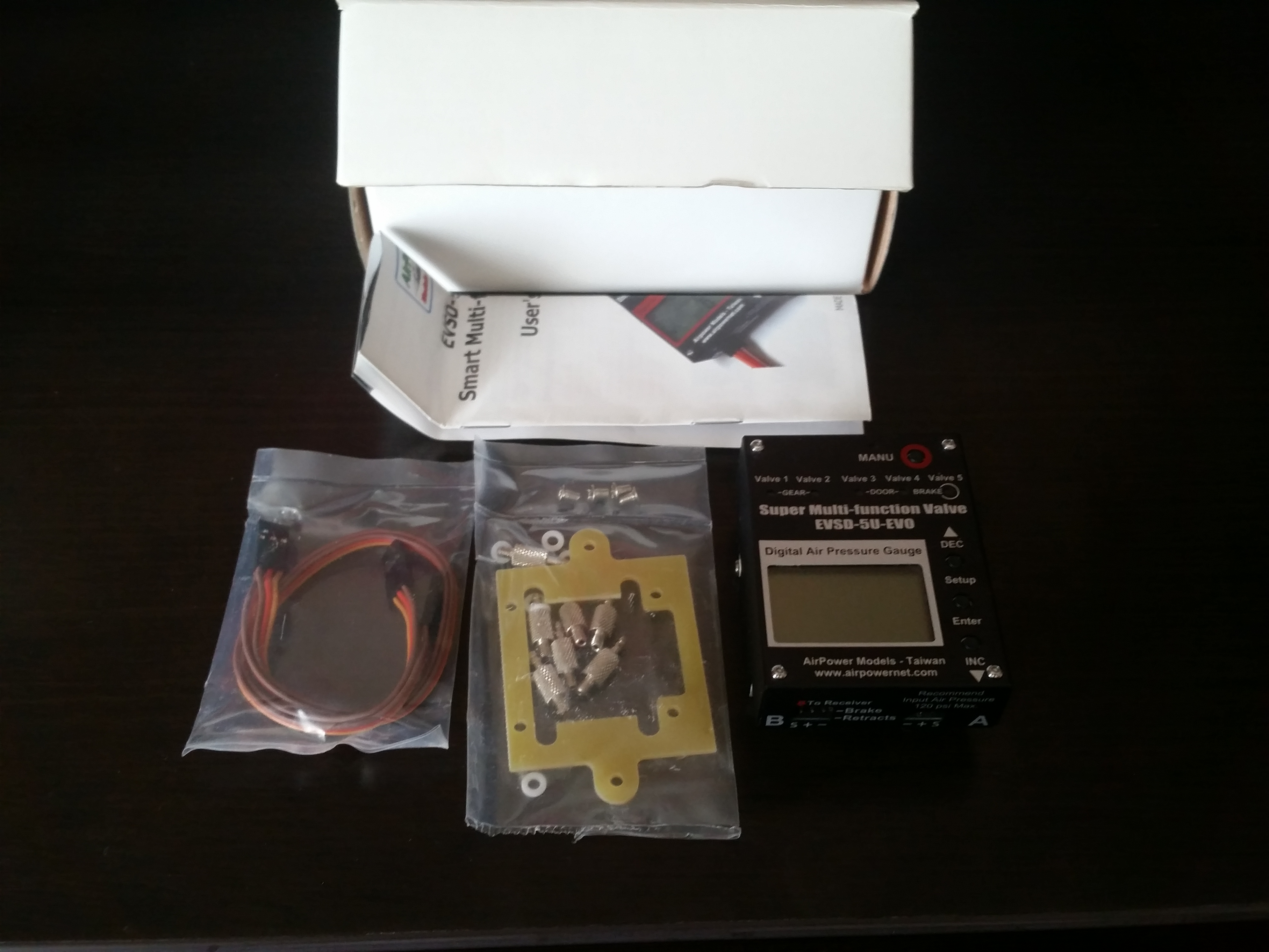

So I finally found a brand new EVSD-5U-Evo and just waiting for it to come in the mail. Next I will start getting air fill valves and air traps. I know this jet will come with air line but I was thinking of buying some new airline from dream works. The airline that comes with these kits, are they good or do most of you replace it? I will also being buying the bulk powerbox servo wire to make all my extension. I should have my tracking number for the jet tomorrow and the arrive date. Stay turned for some more updates.

Well I got notification that the Viper will be delivered on the 10th! I cant wait to get this thing in. Also I just received my airpower EVSD-5U-PRO in the mail. Just have to order one more valve for the speed brakes.
Name:	AirPower Valve.jpg

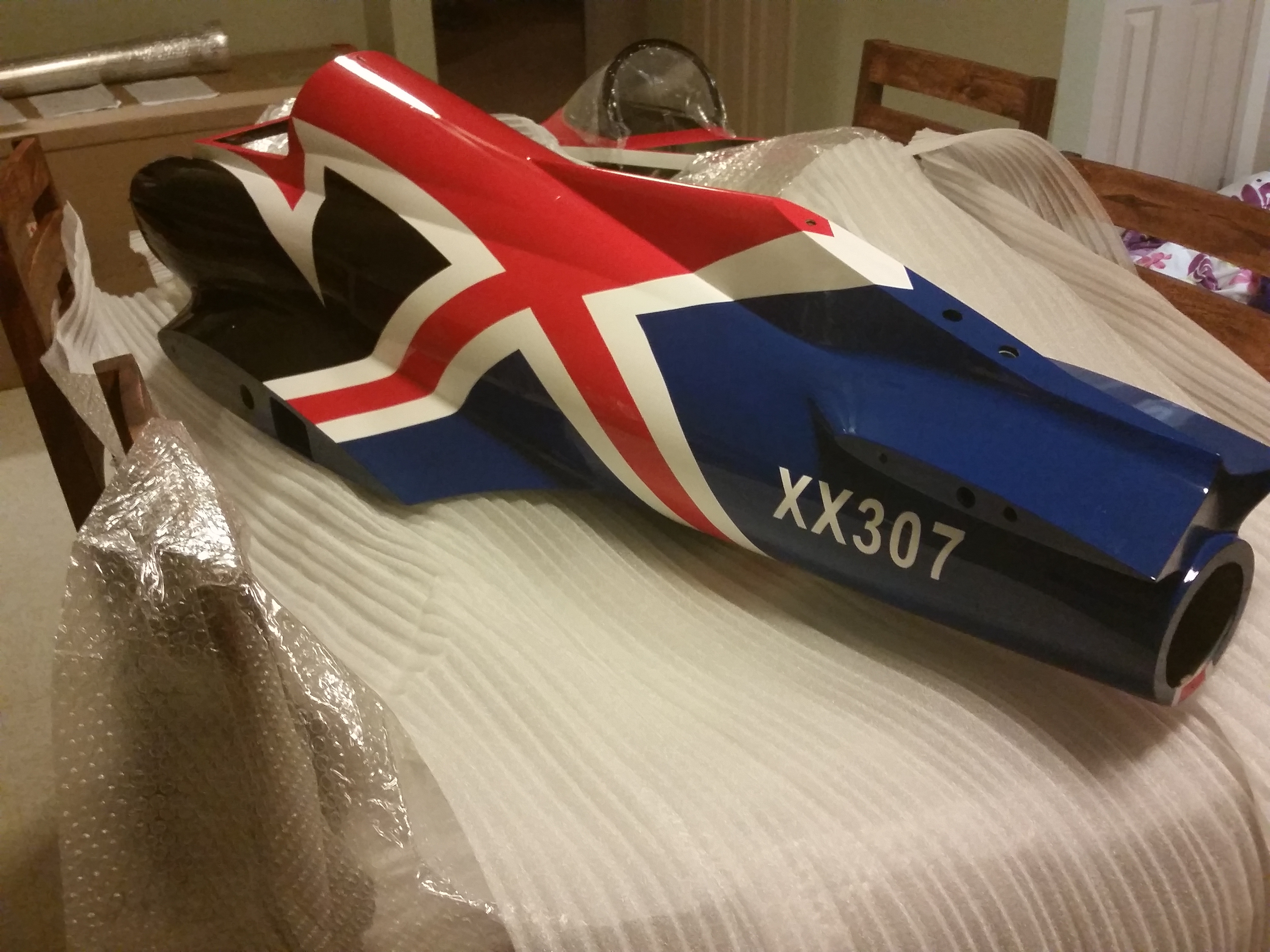

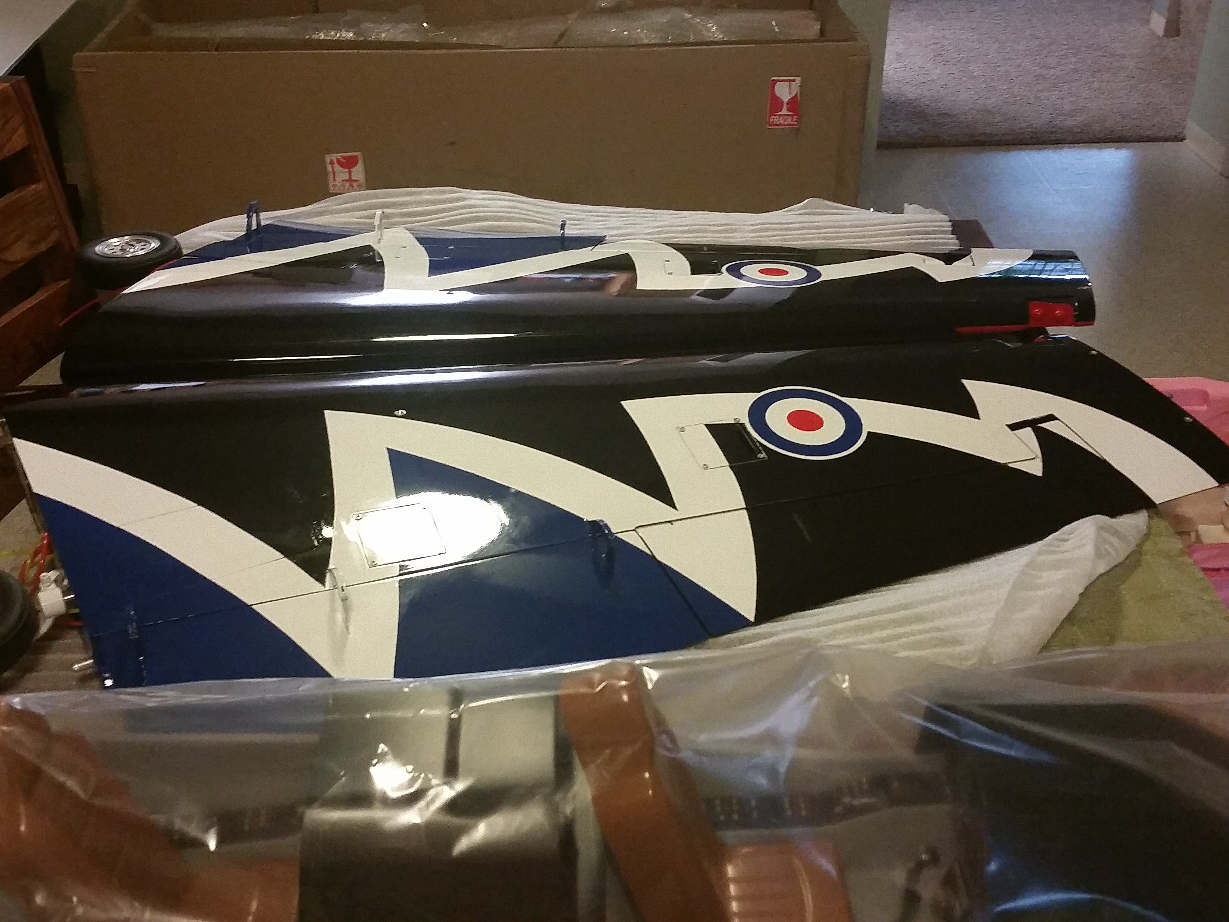

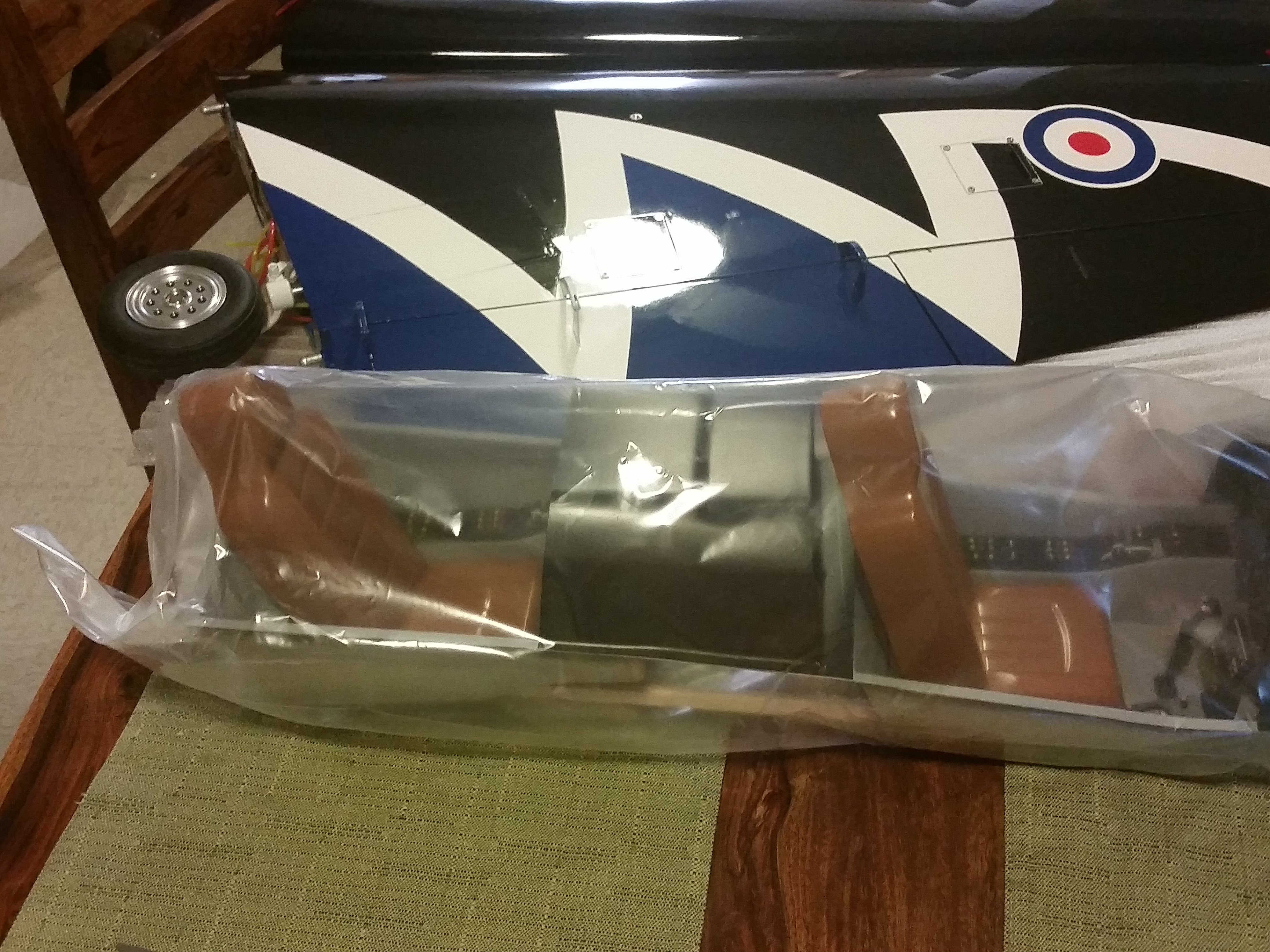

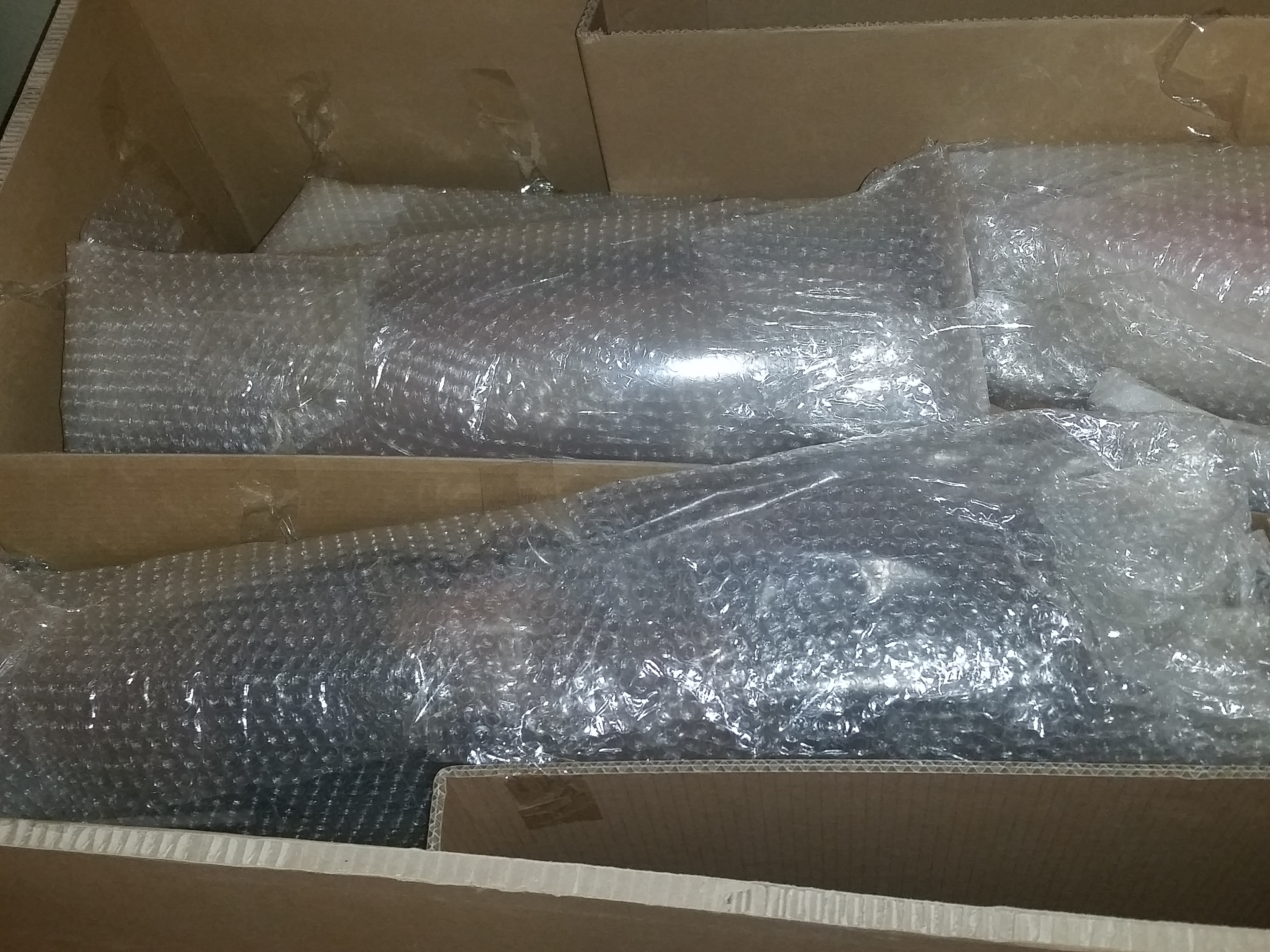

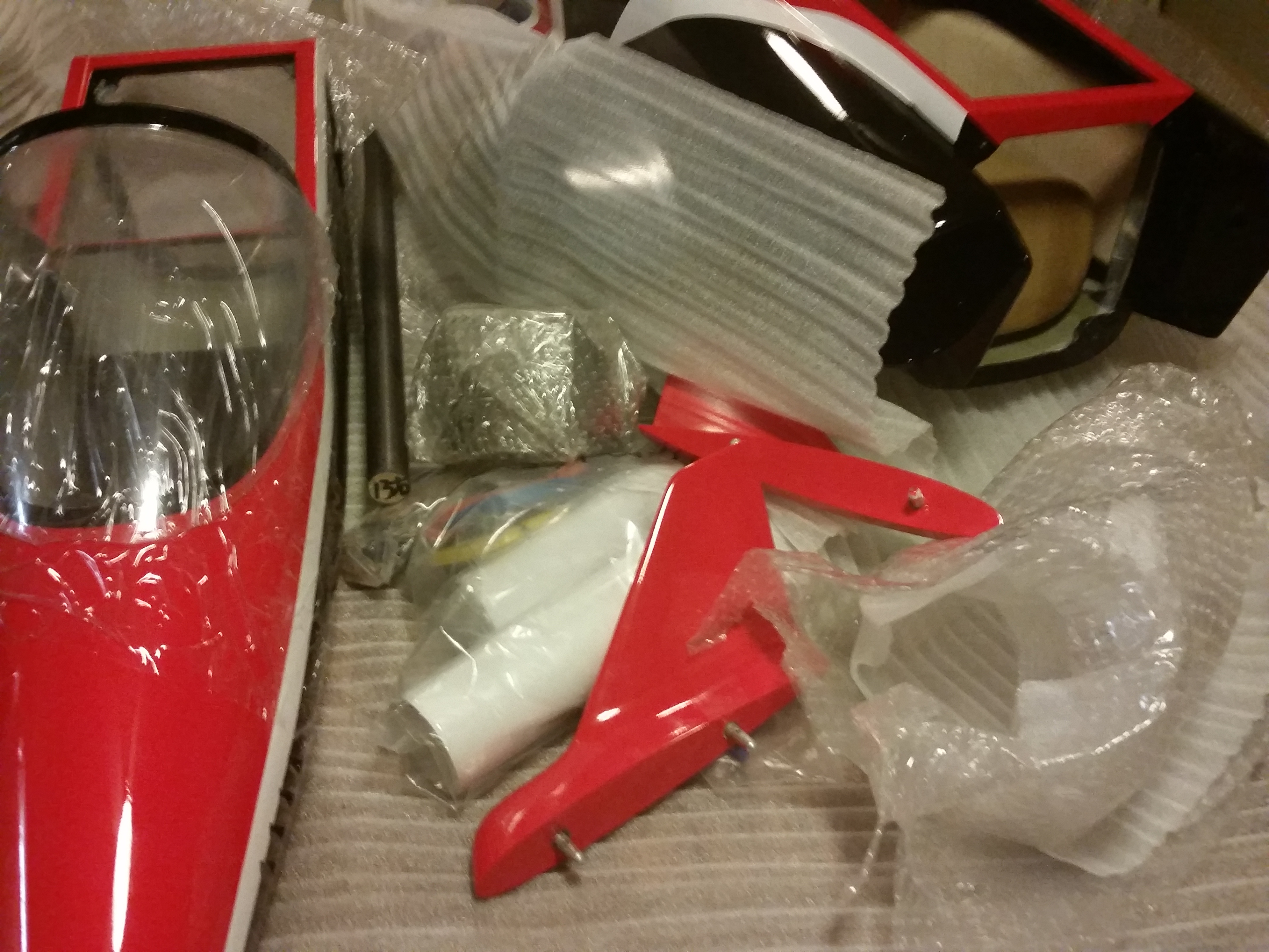

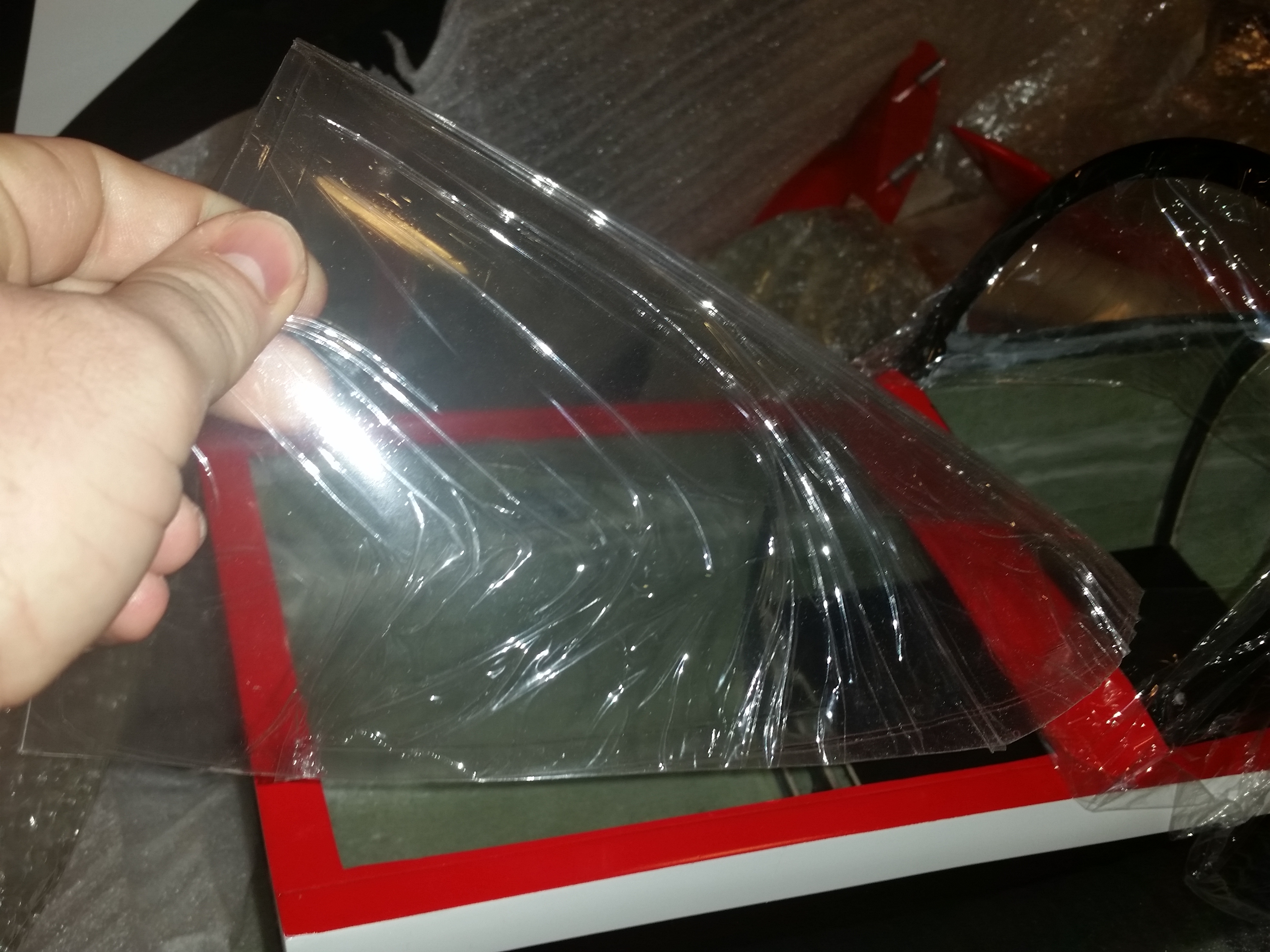

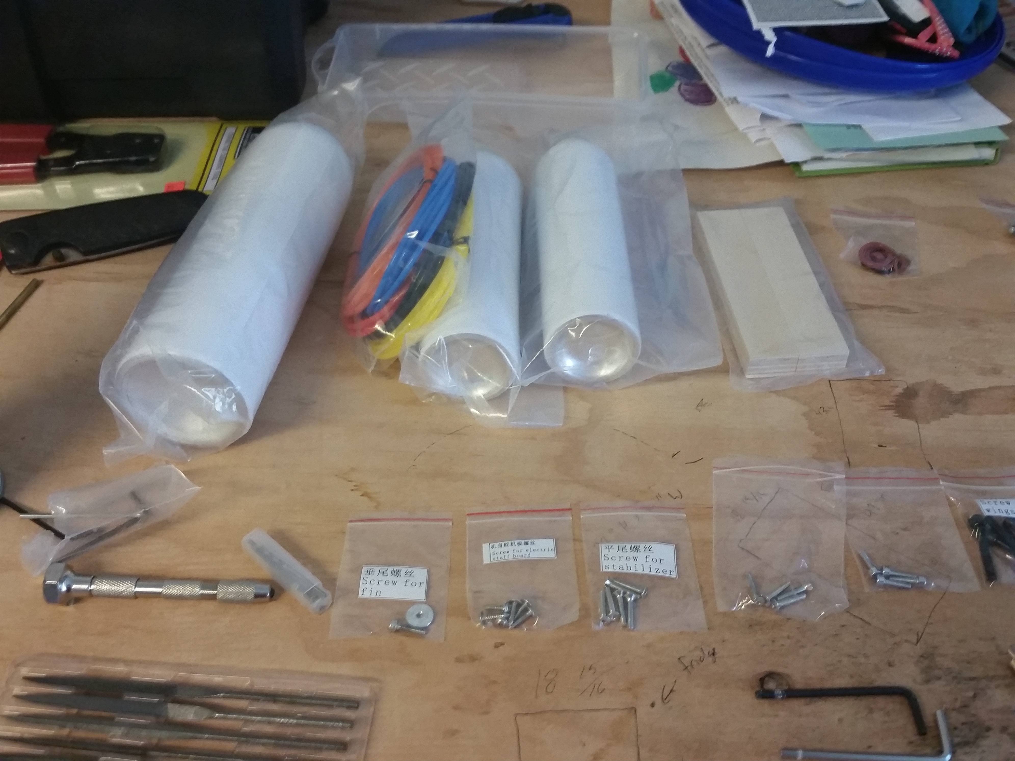

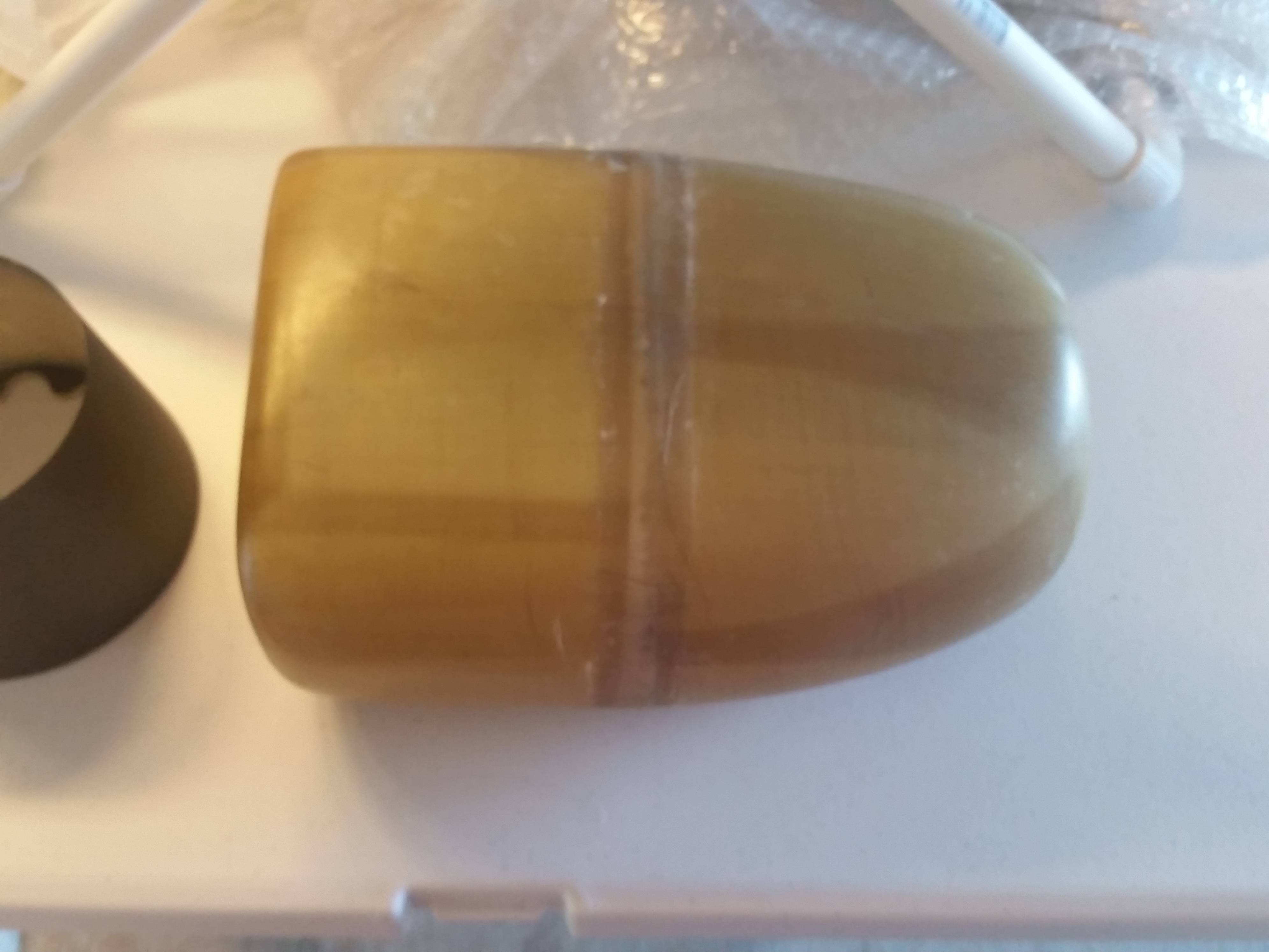

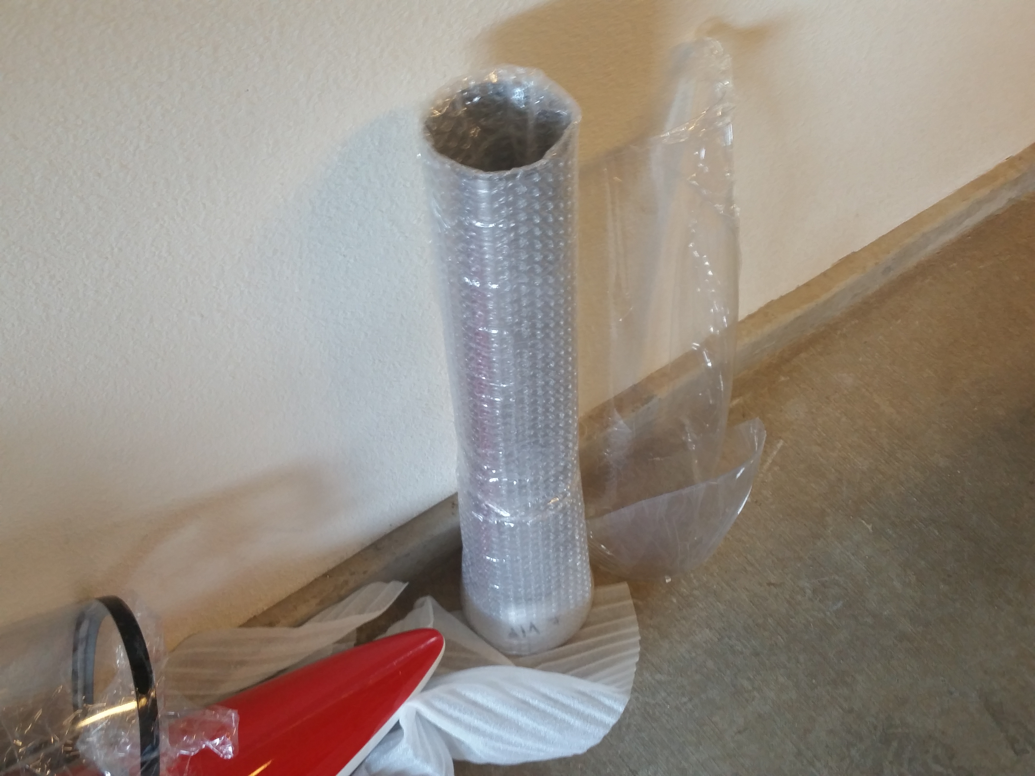

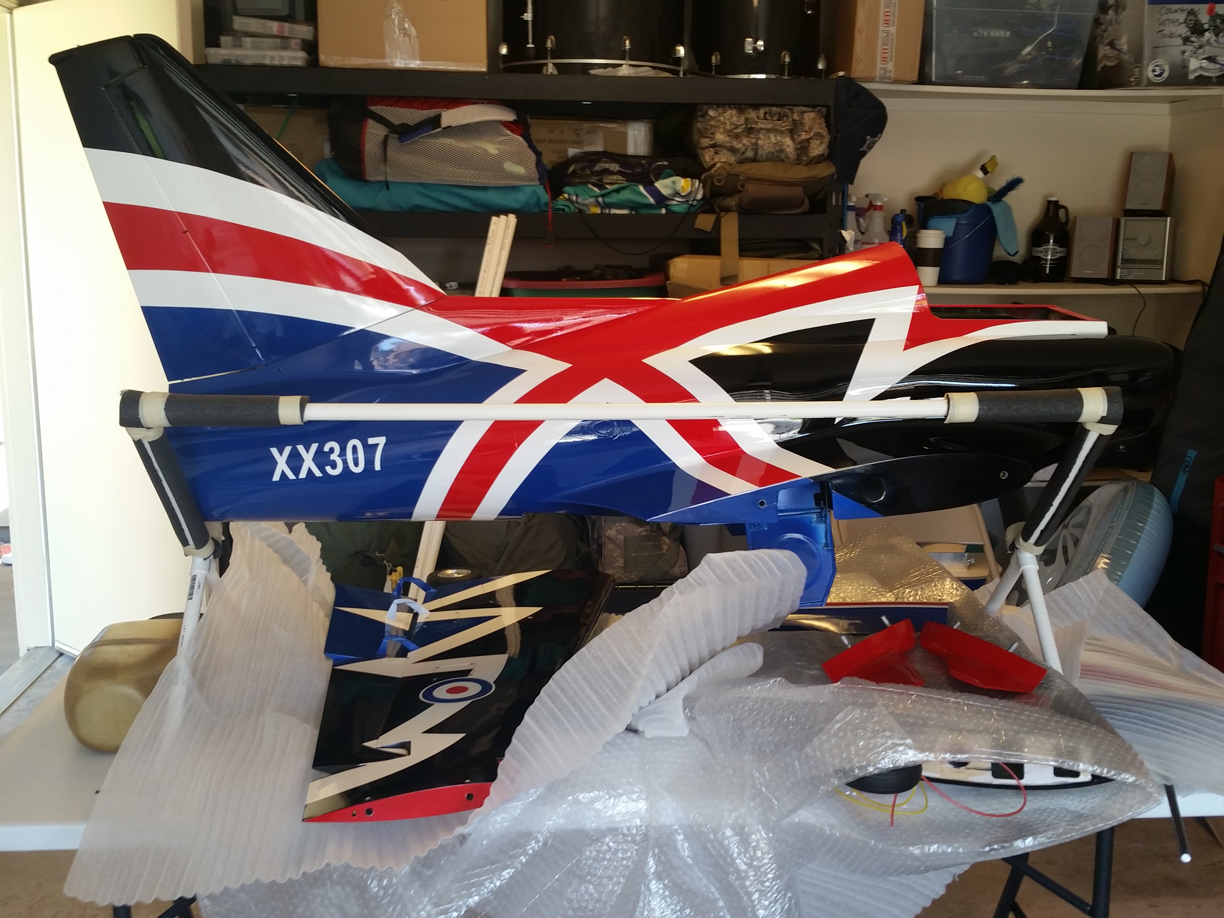

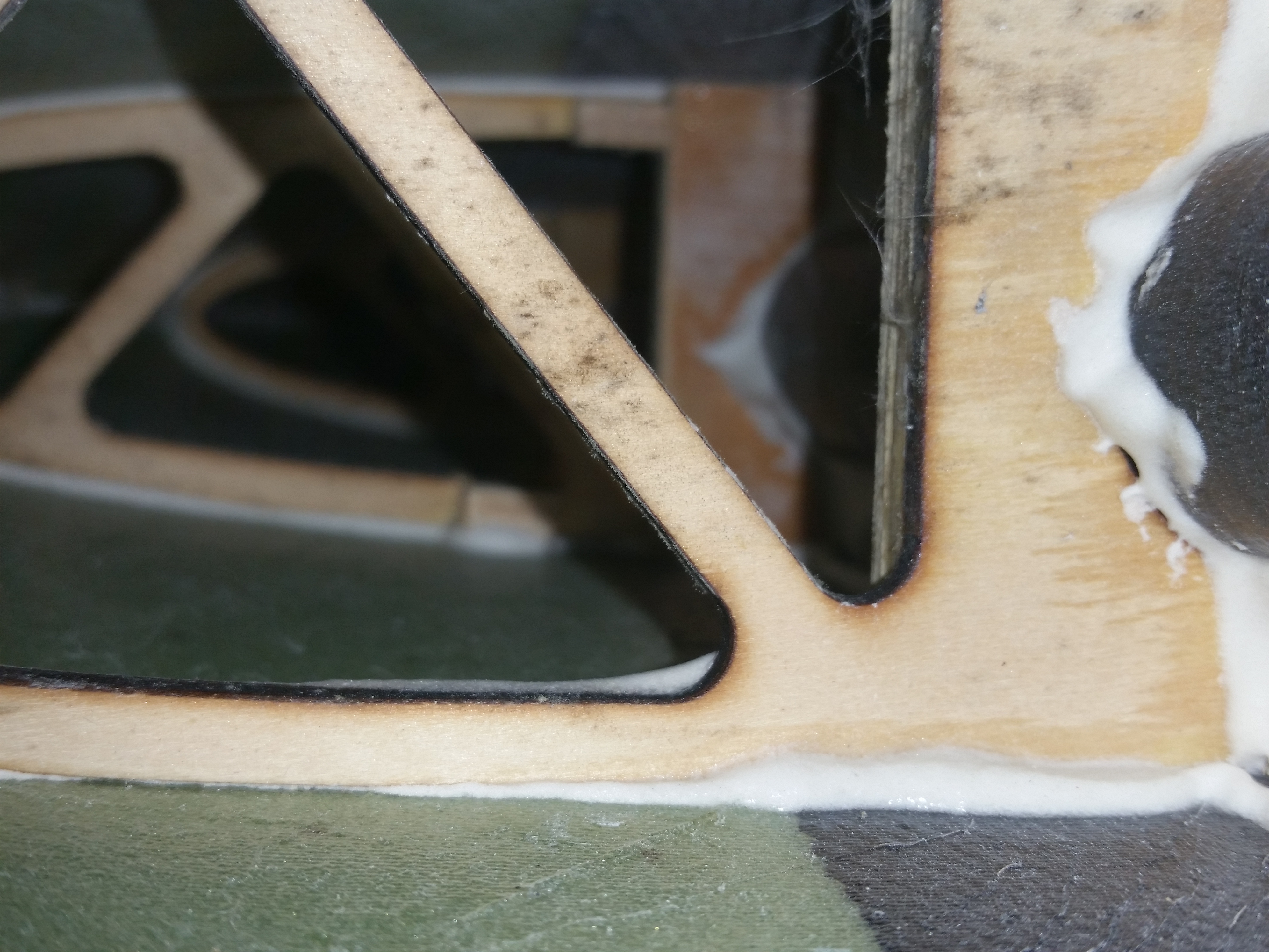

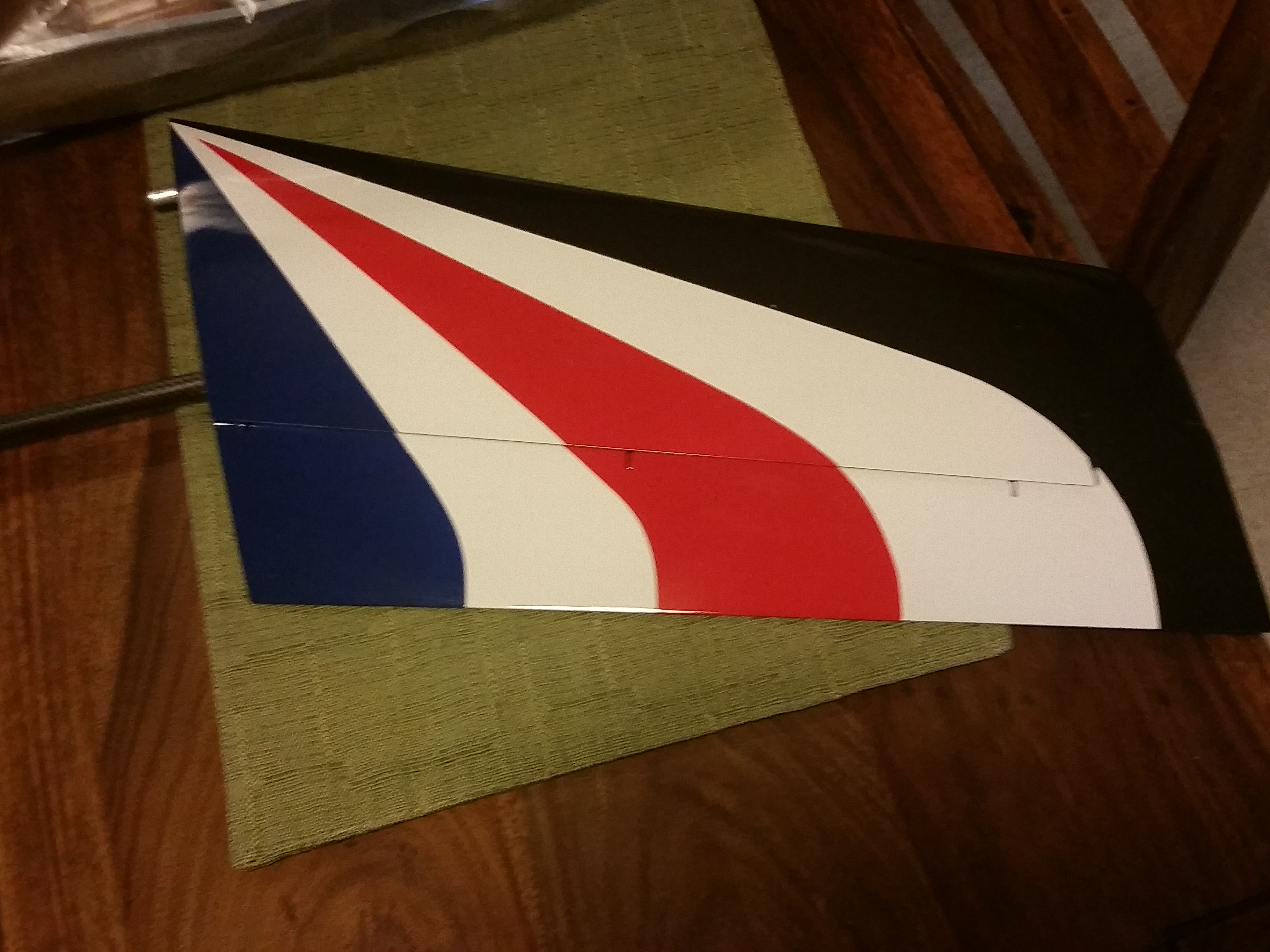

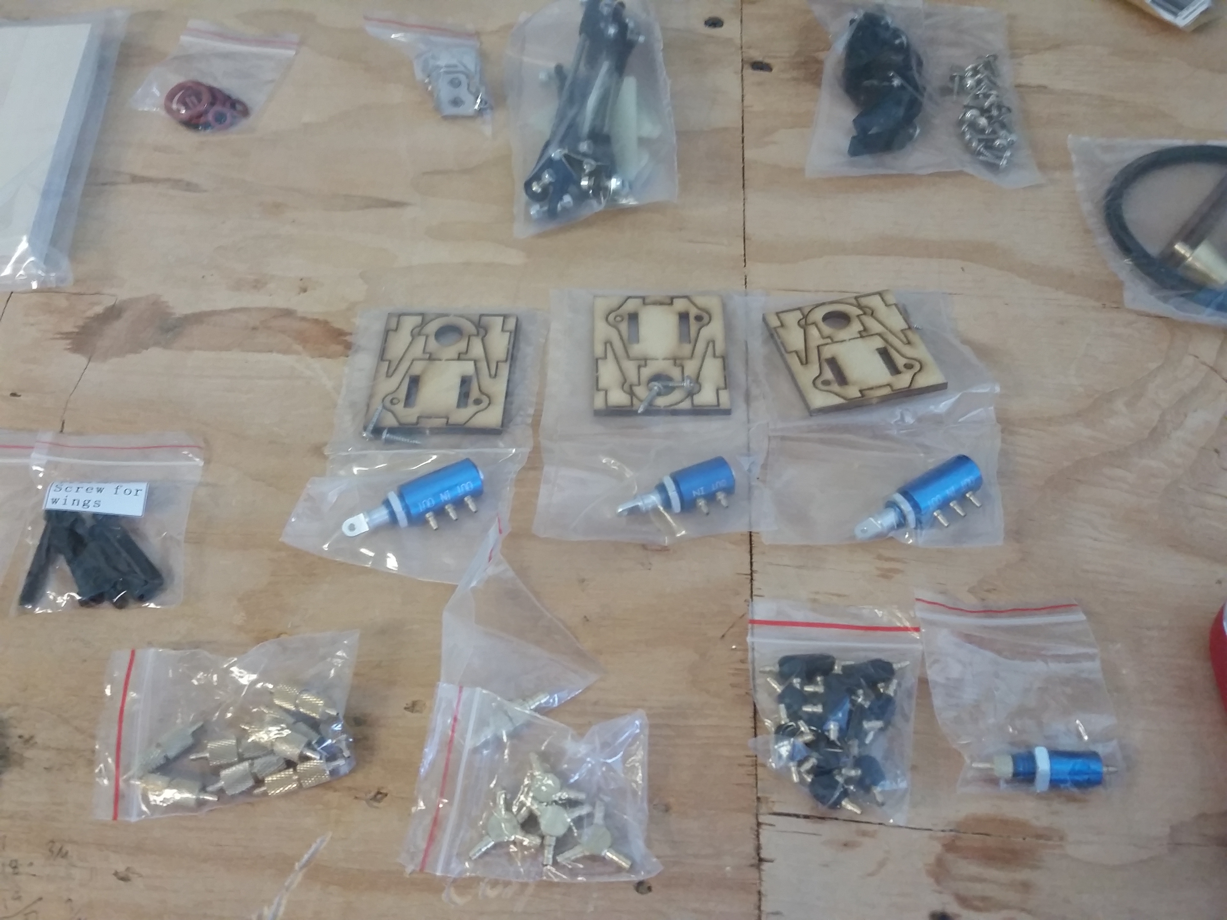

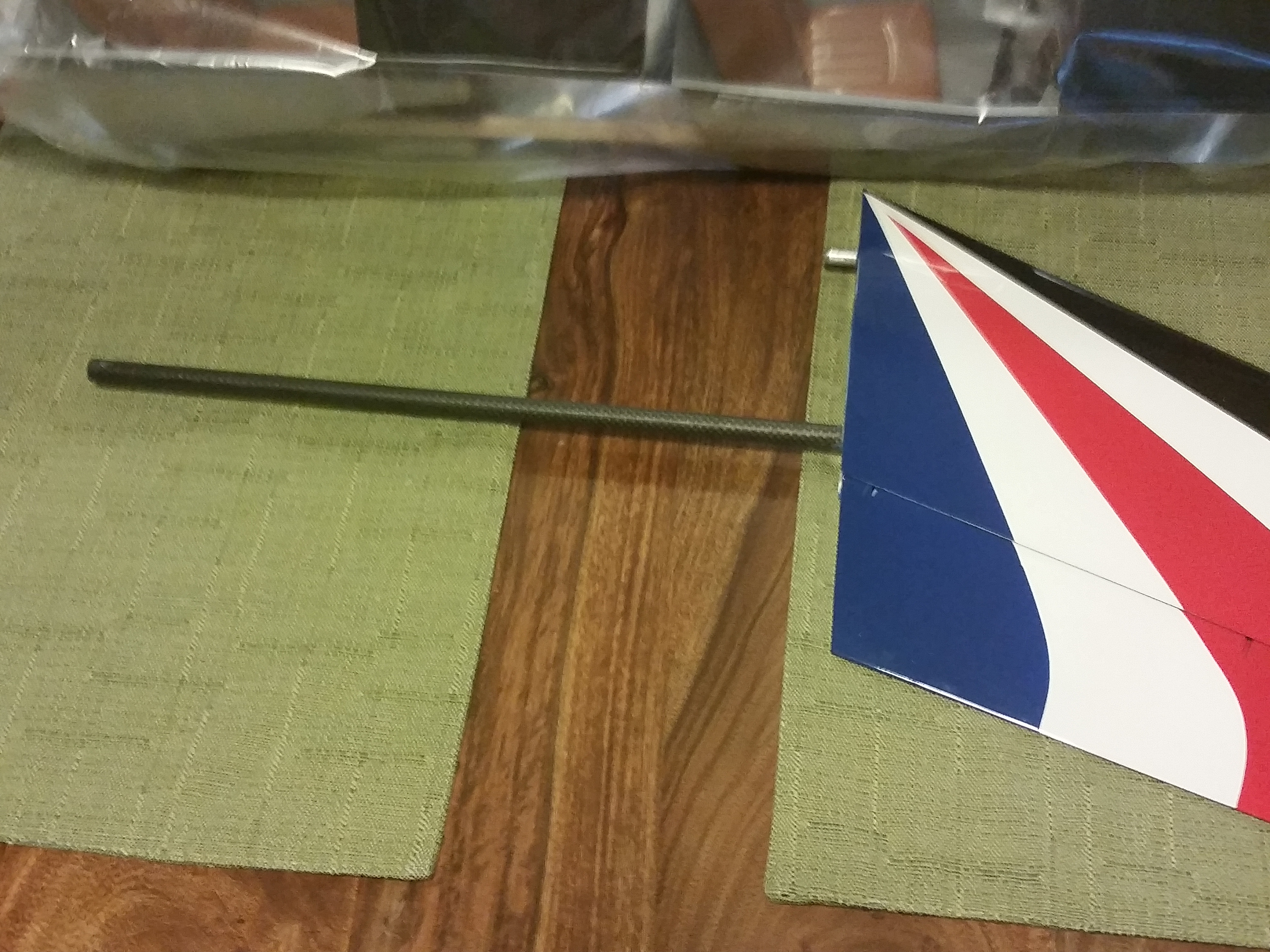

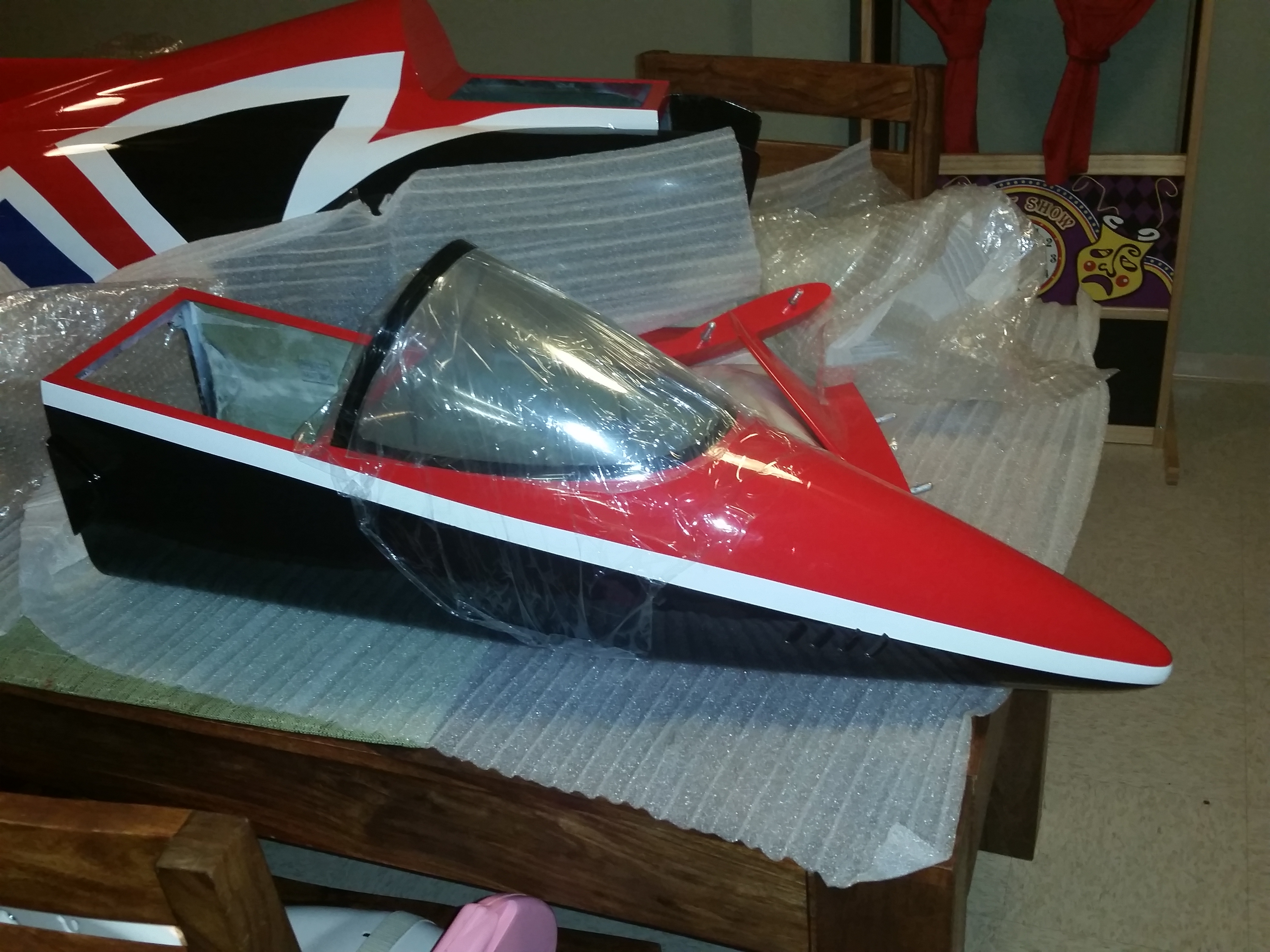

Okay, so I started to unpack the Viper and I have to say that I am very pleased so far. The paint is spot on just a little wipe down for the shine. I have started to take pictures. I am still unpacking but after being on the plane all day I am getting tired. I will post pictures tomorrow and will go from there.
Old 02-14-2016 | 08:23 AM
Joined: Dec 2015
Posts: 470
From: Germany

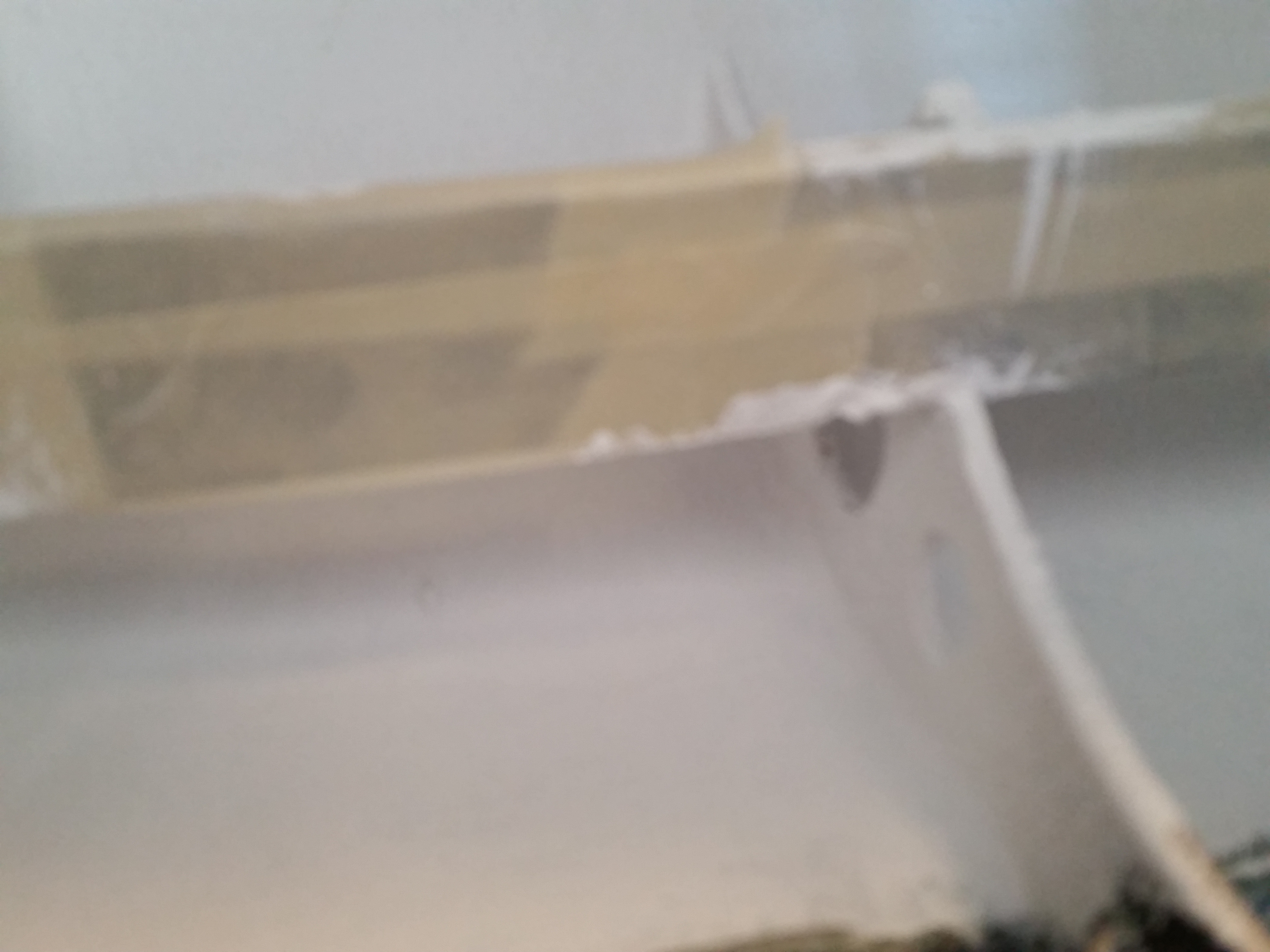

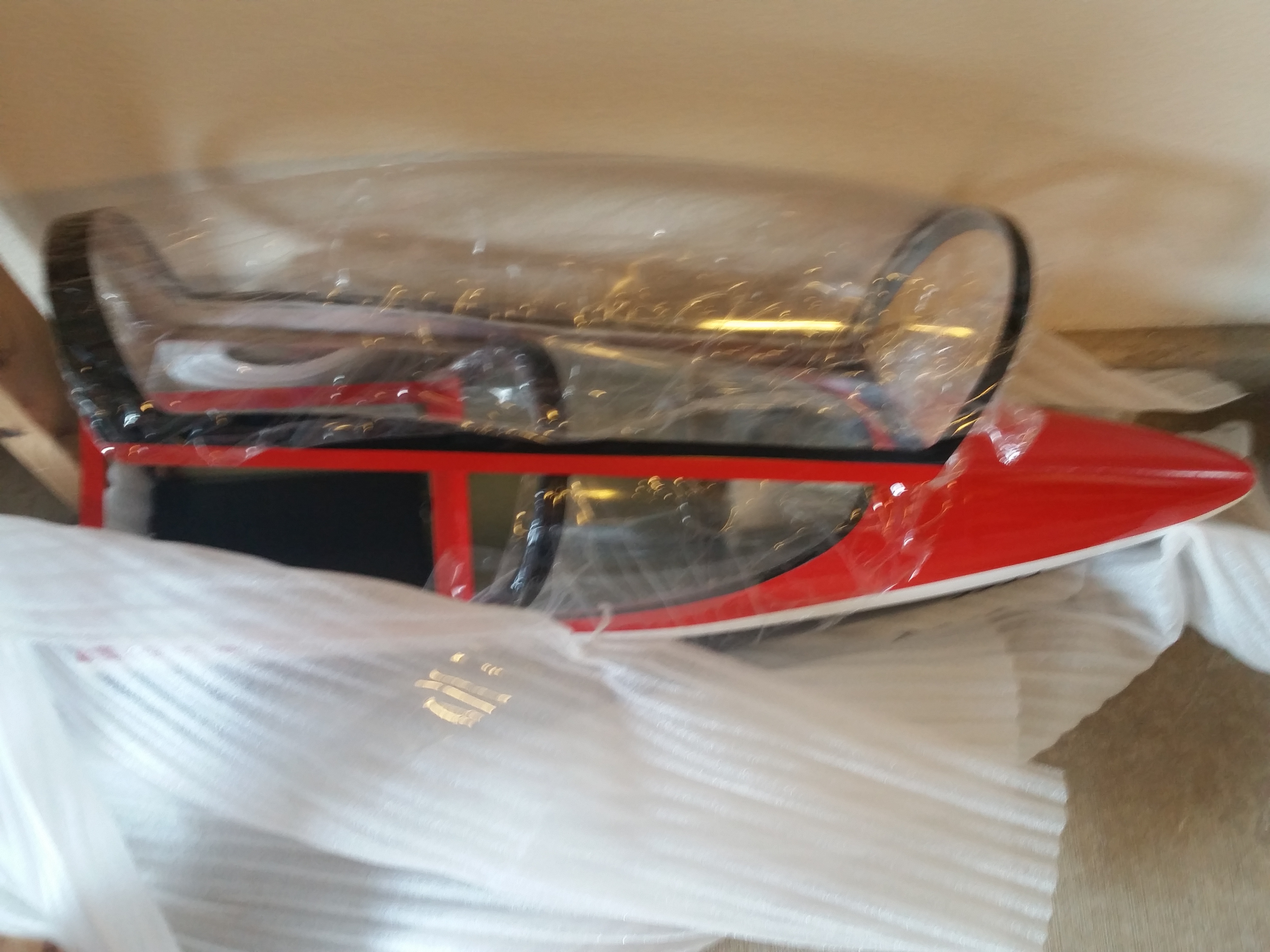

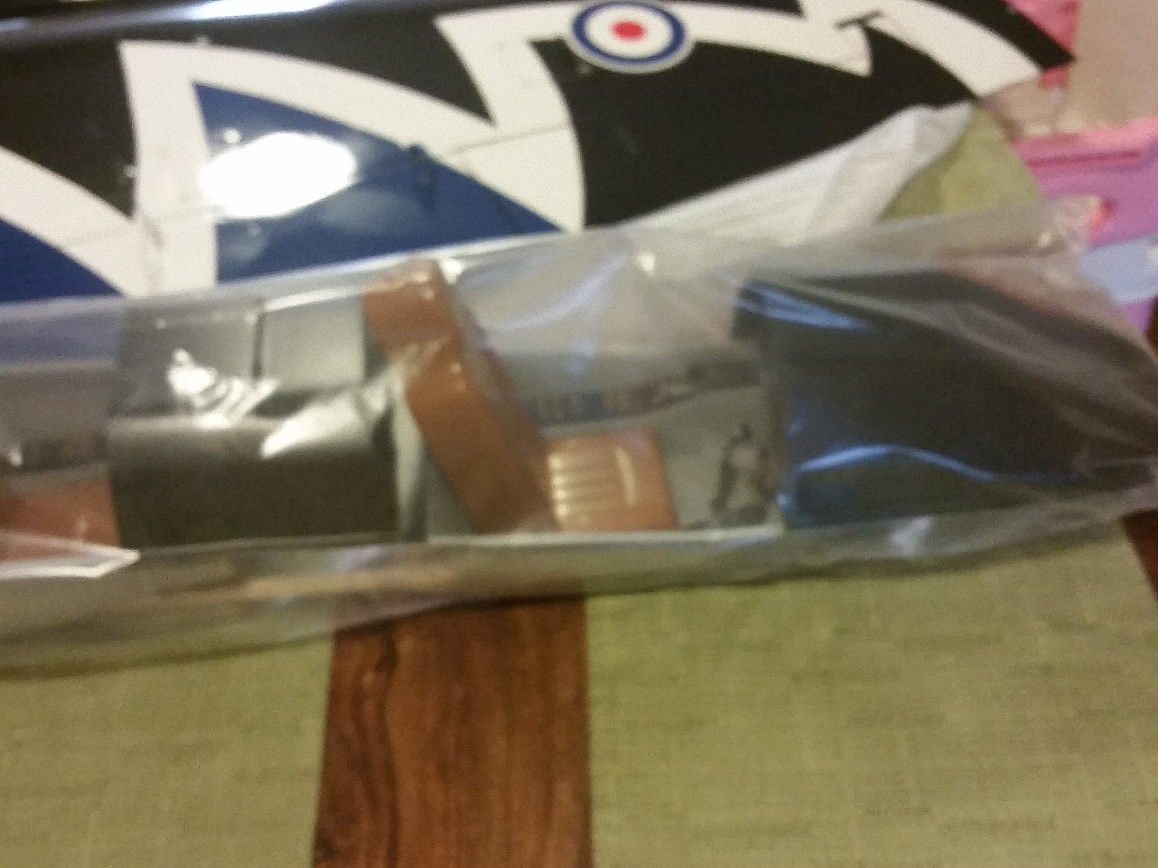

Okay so here are some of the pictures of the unboxing. I will add more in a bit. The only issue that I found is on one of the wing tips I believe a piece of wood broke off inside. I am getting with Marvin to see if I can get it replaced. I have to get my fuselage stand put together today so I can take more pictures. I have run out of room to put the pieces on tables haha.

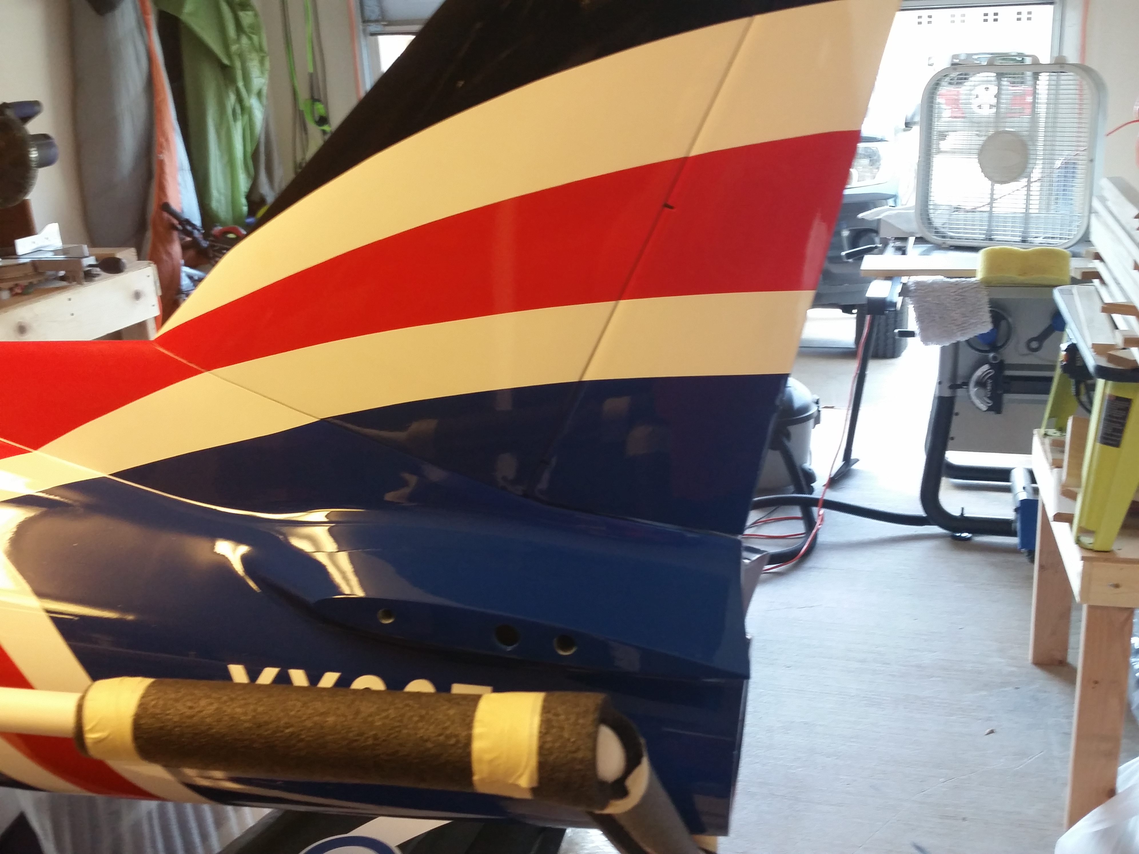

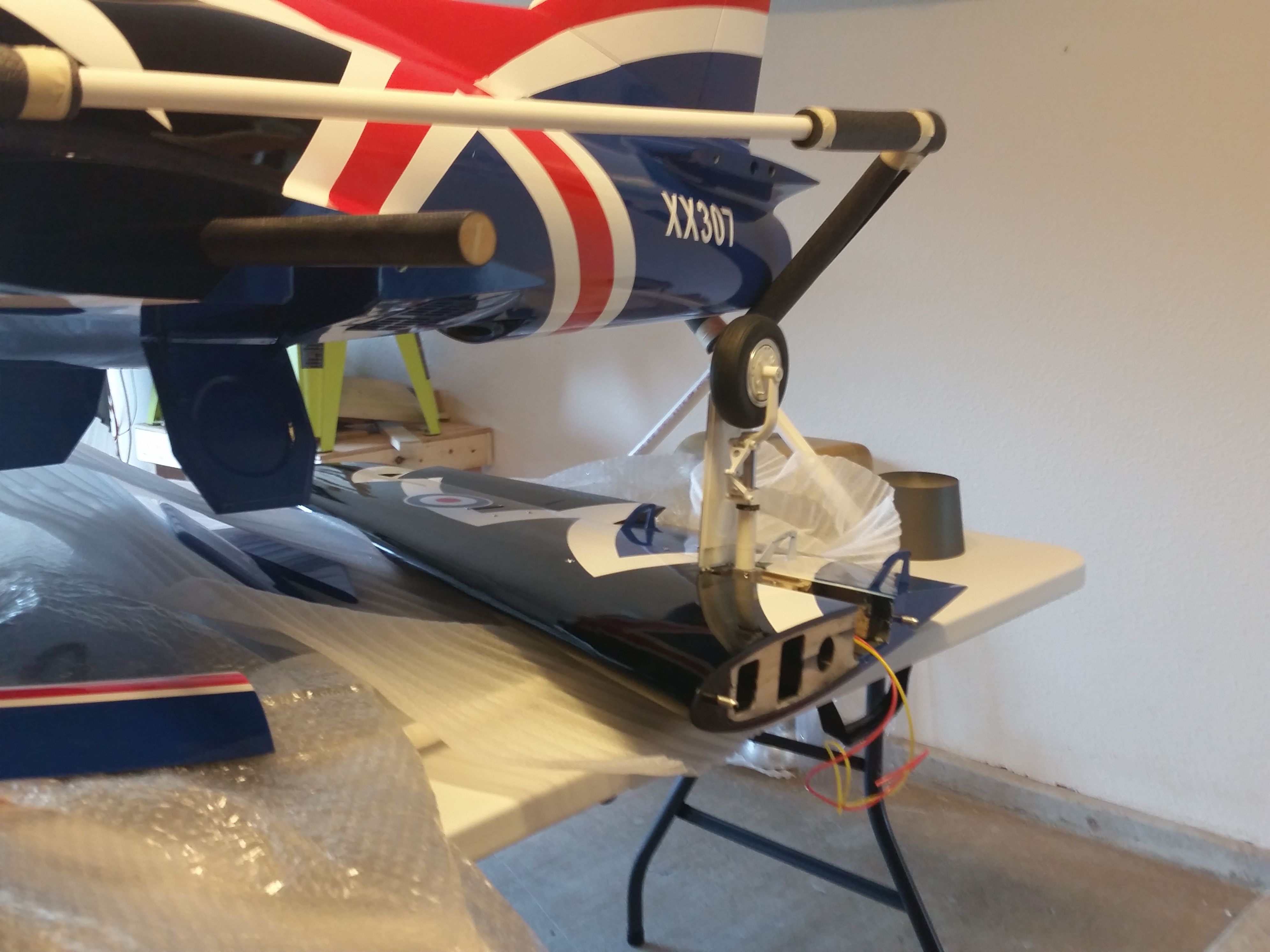

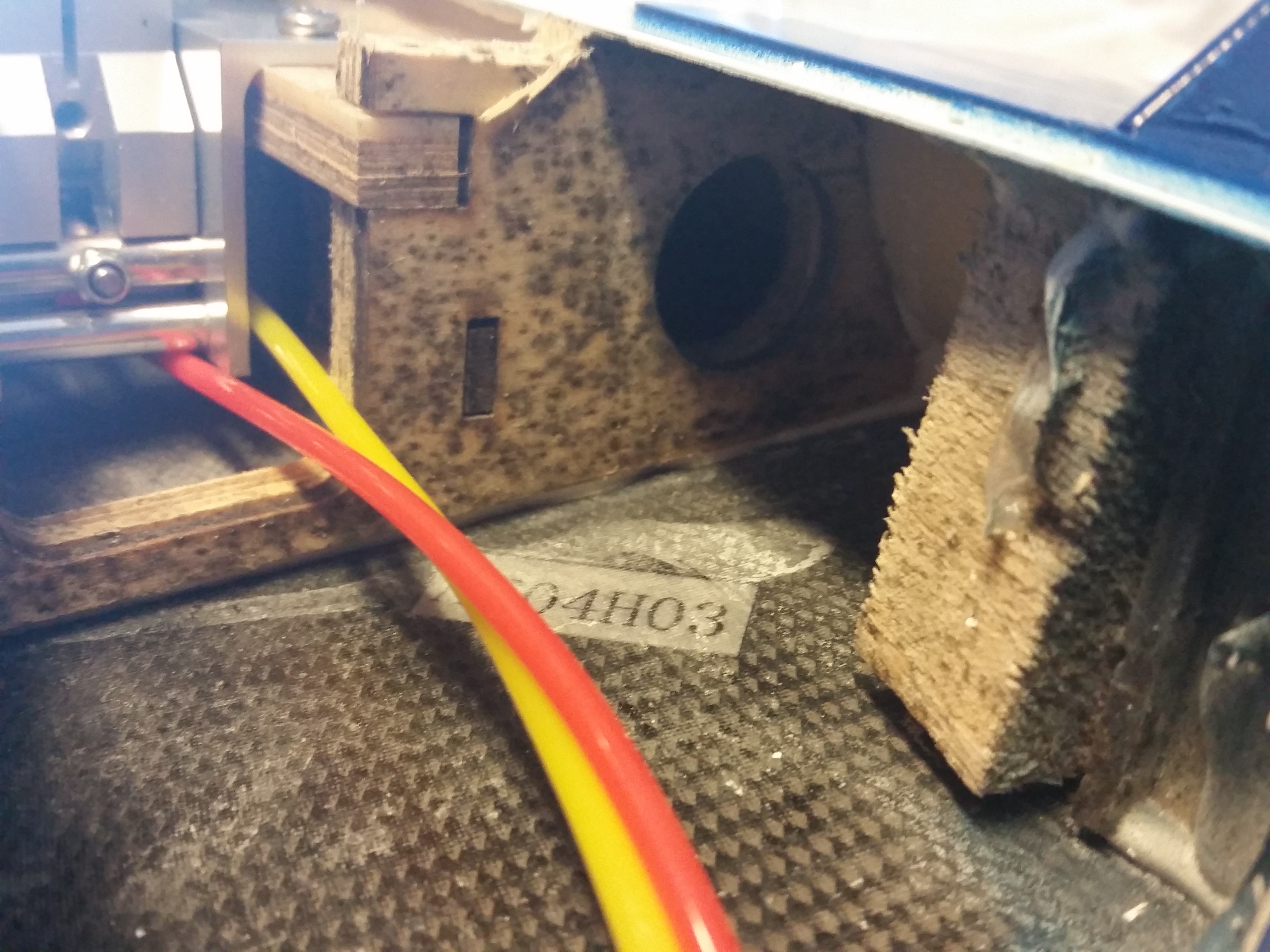

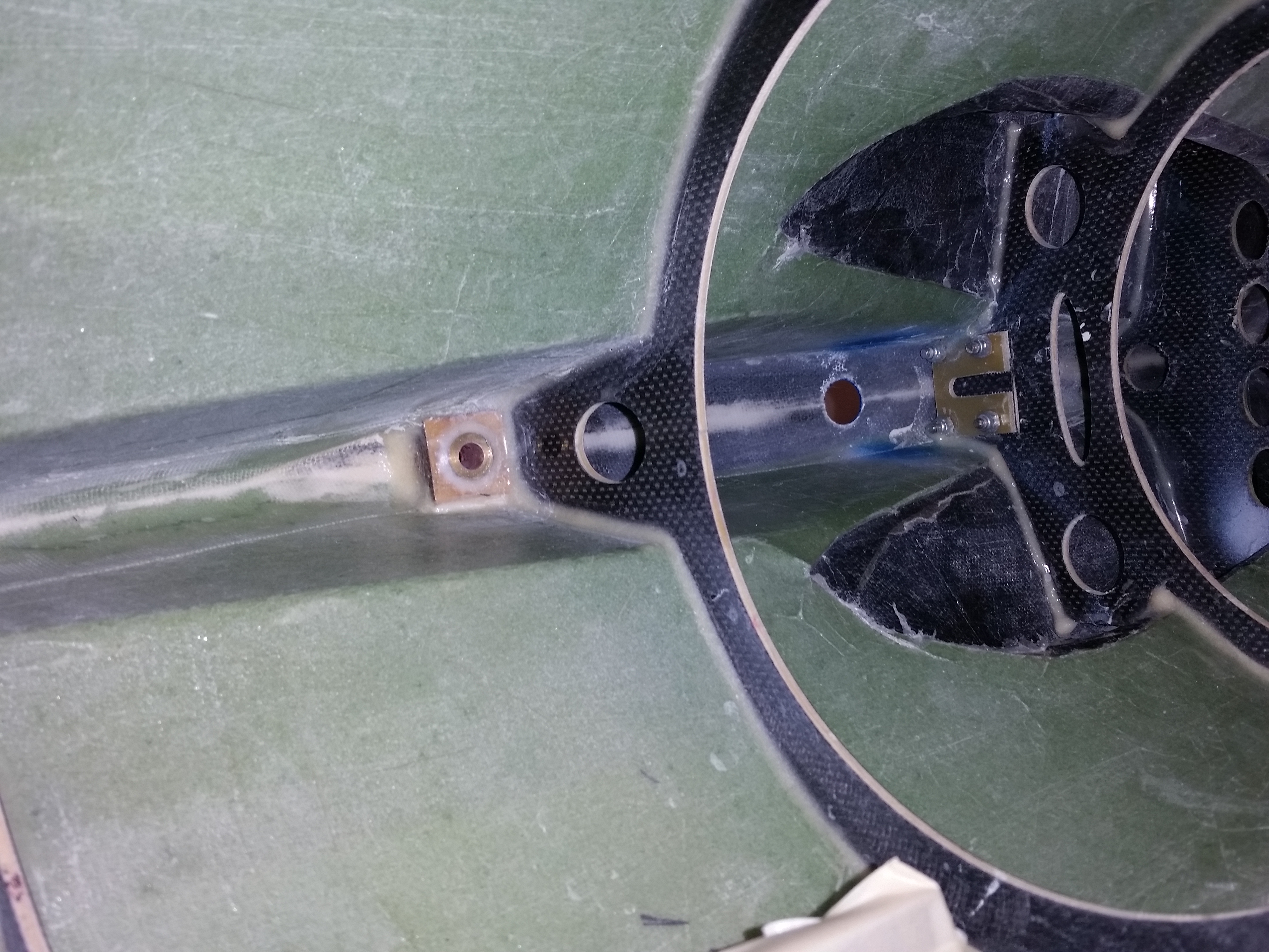

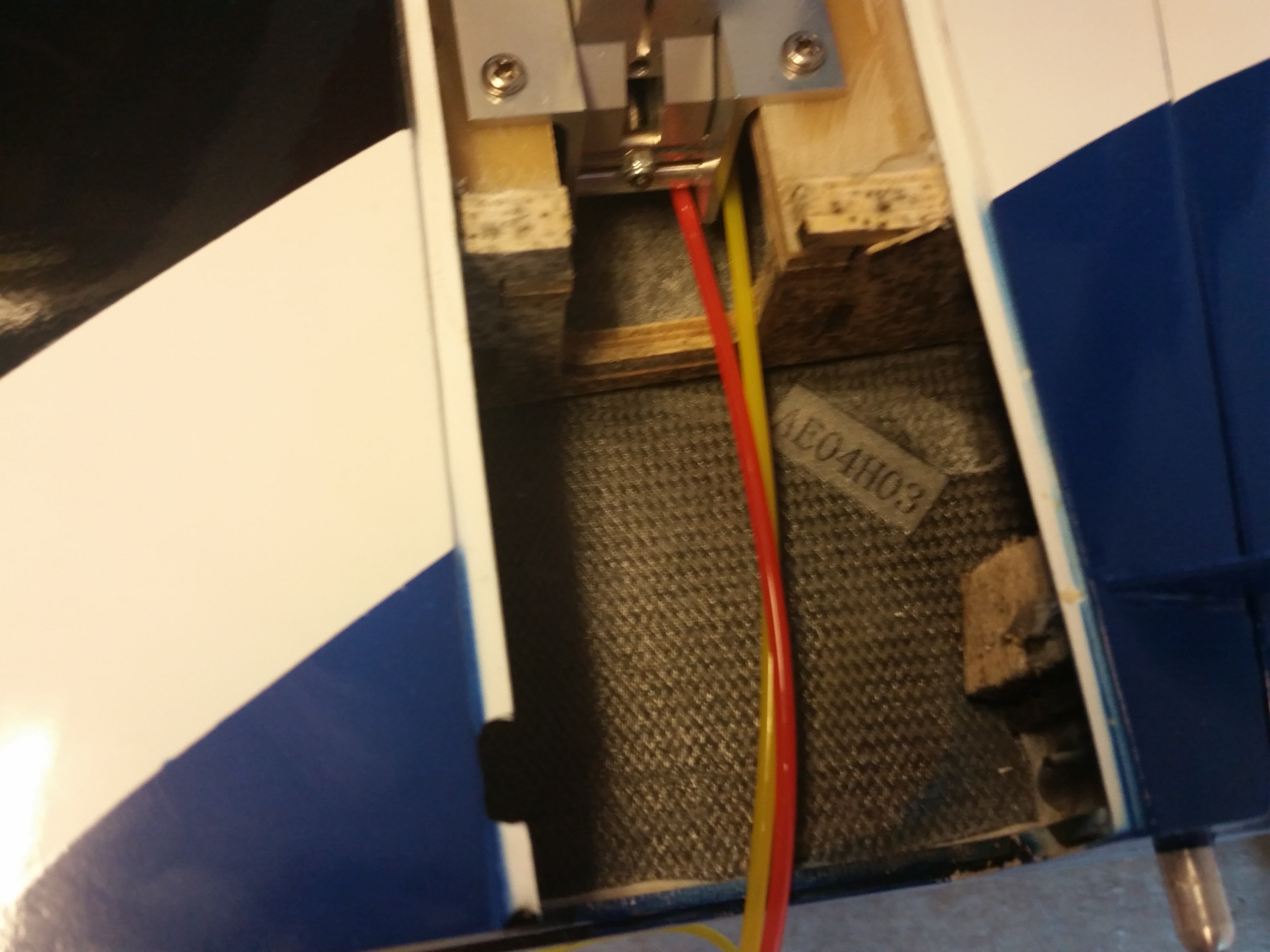

Here is some more pictures of the viper. The picture of the landing gear up shows the wood. It looks like it has a bunch of mold on it. Almost like the wood was wet when they used it. either way I am going to clean that up and make it look nice. Once I start the installation, I am going to start with the heat shield paint and get all that done. Then I will start on the tall section on the servos, wiring, and prewire for lighting. Also I have to take the air cylinders off due them getting paint on them. It kind of stinks. I will clean the shafts for smooth operations and go from there.

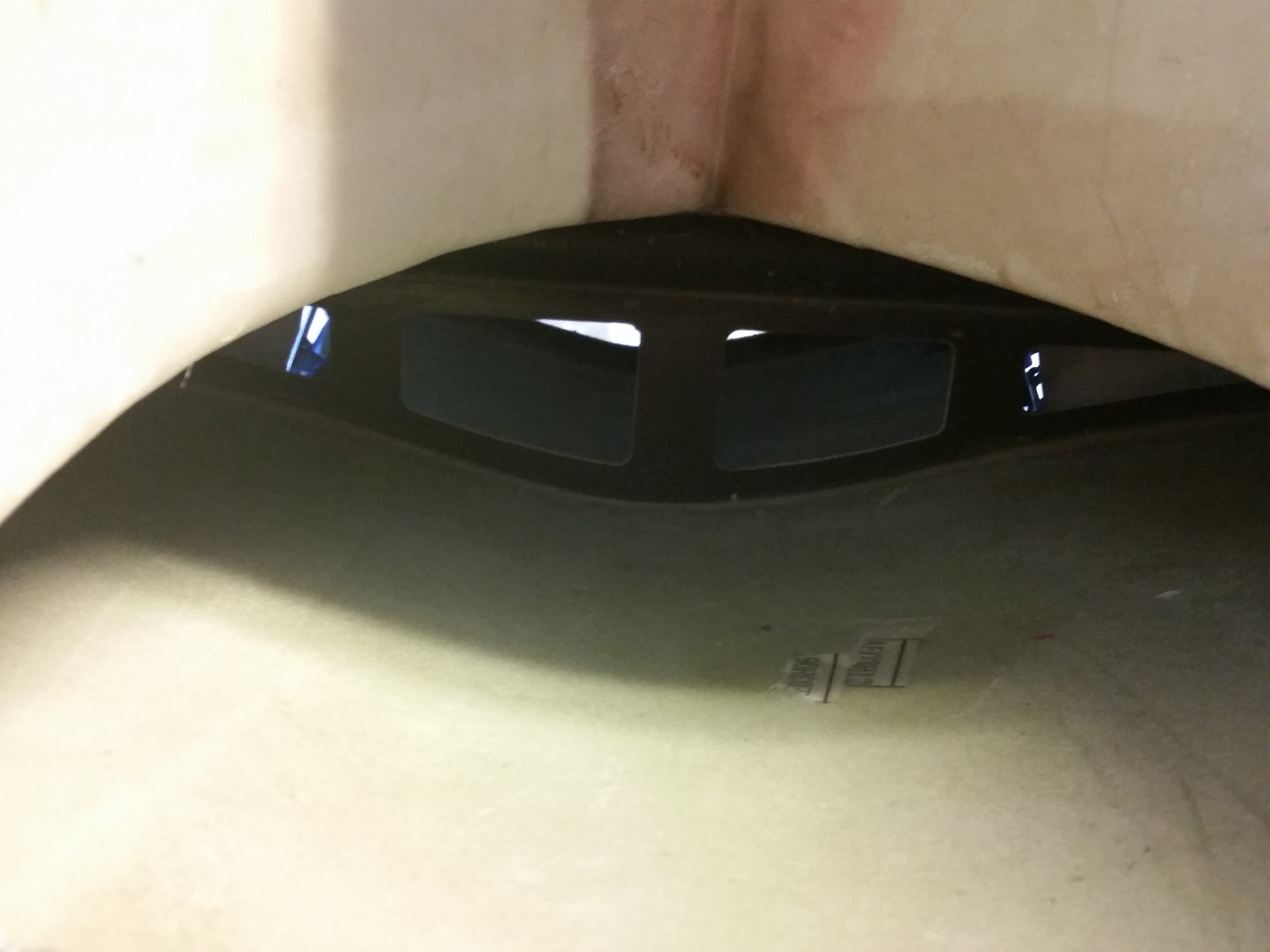

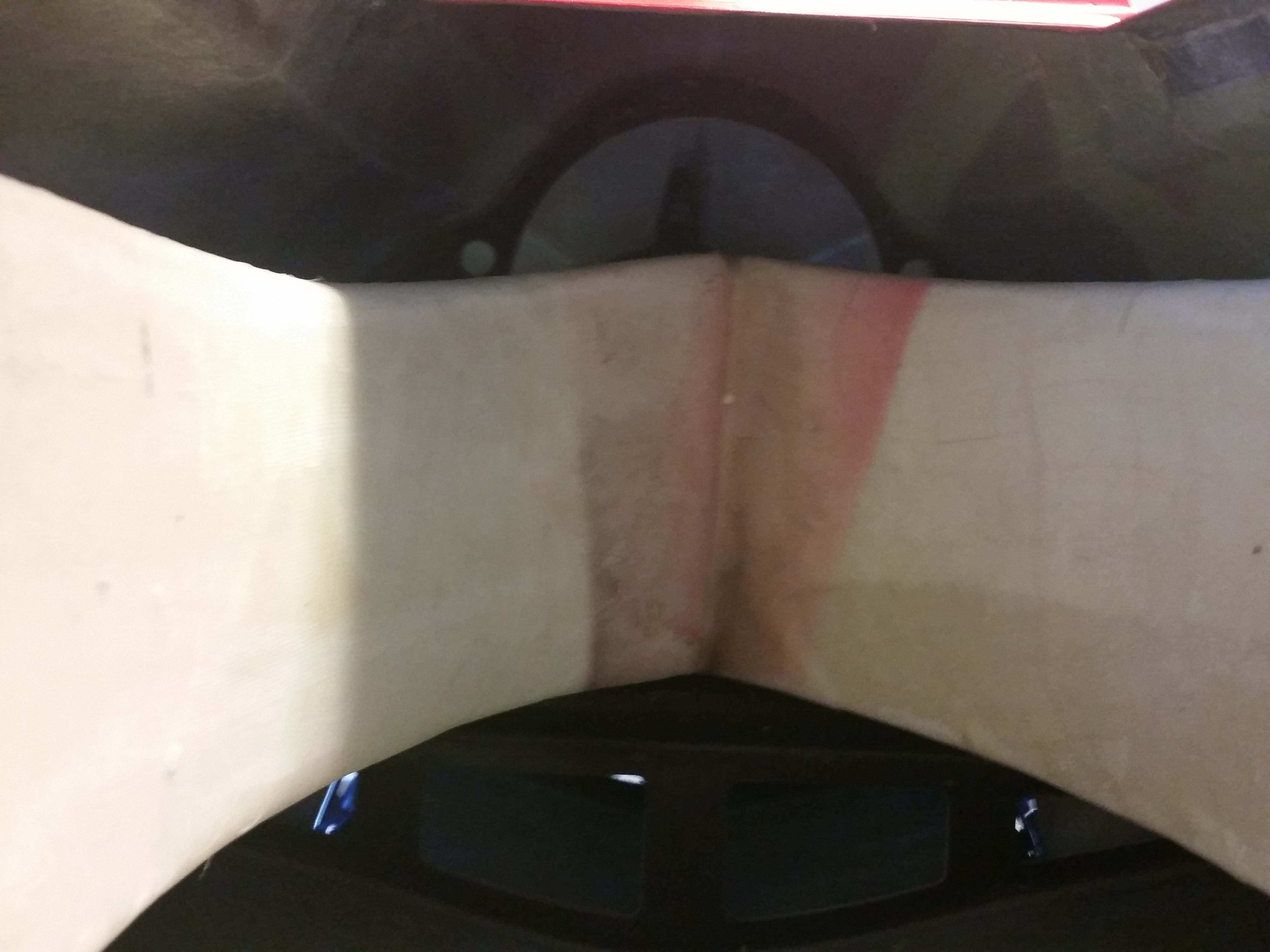

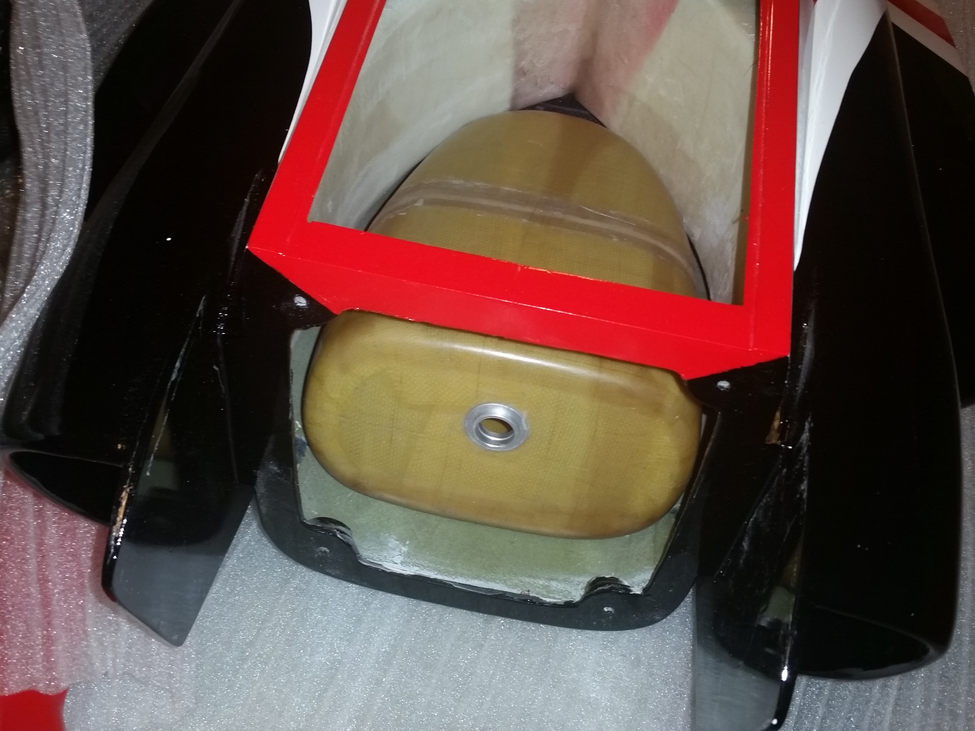

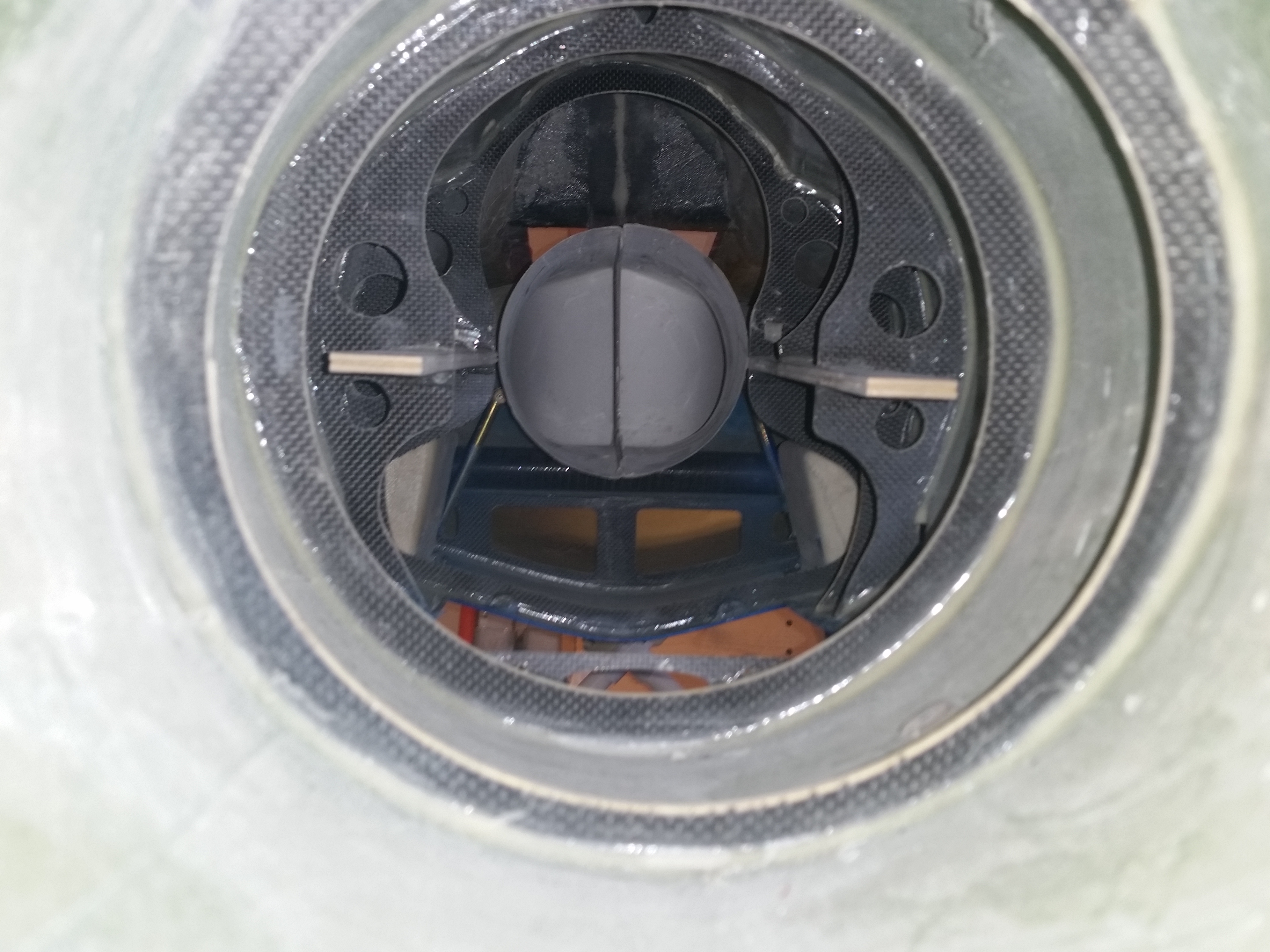

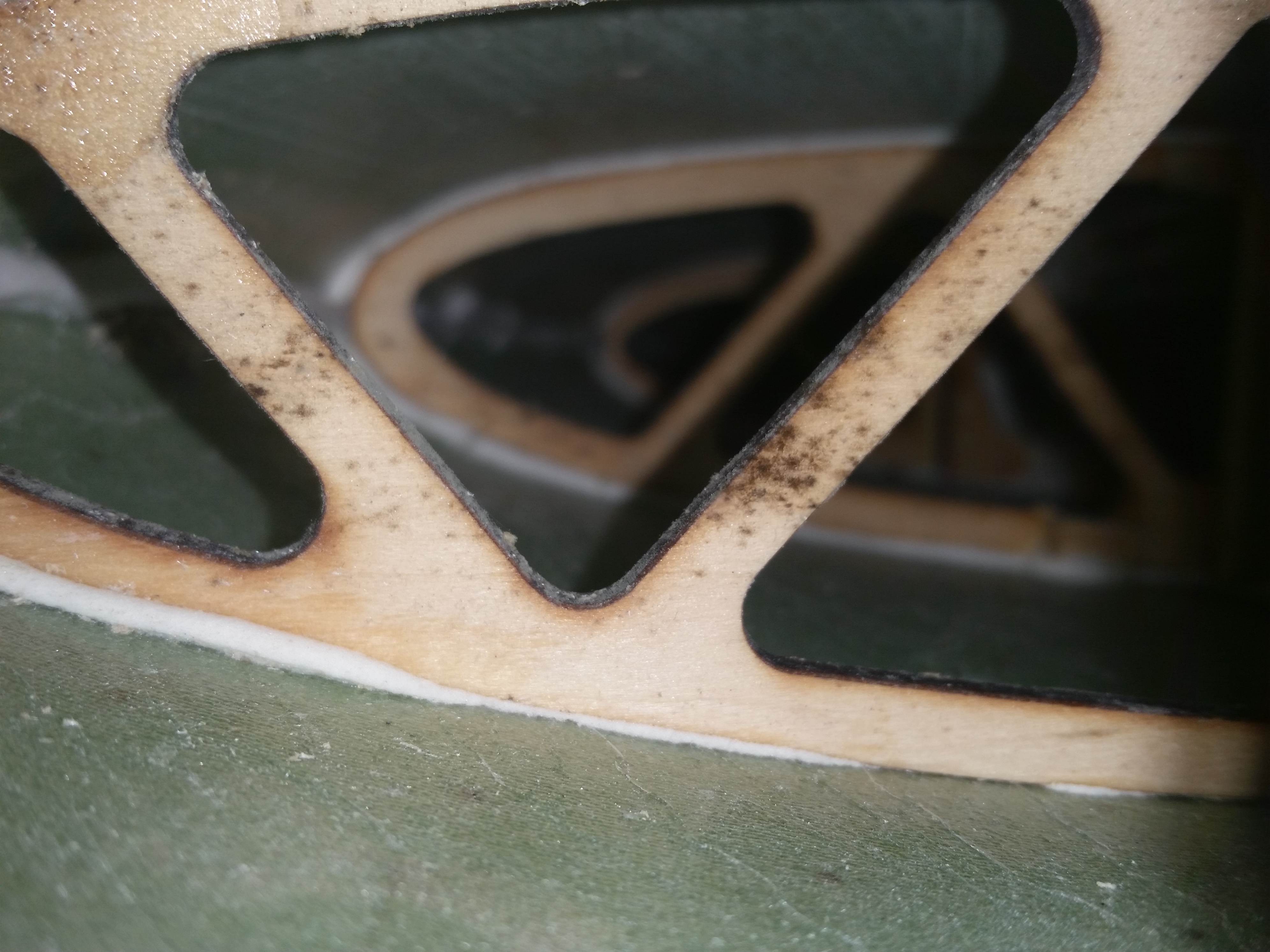

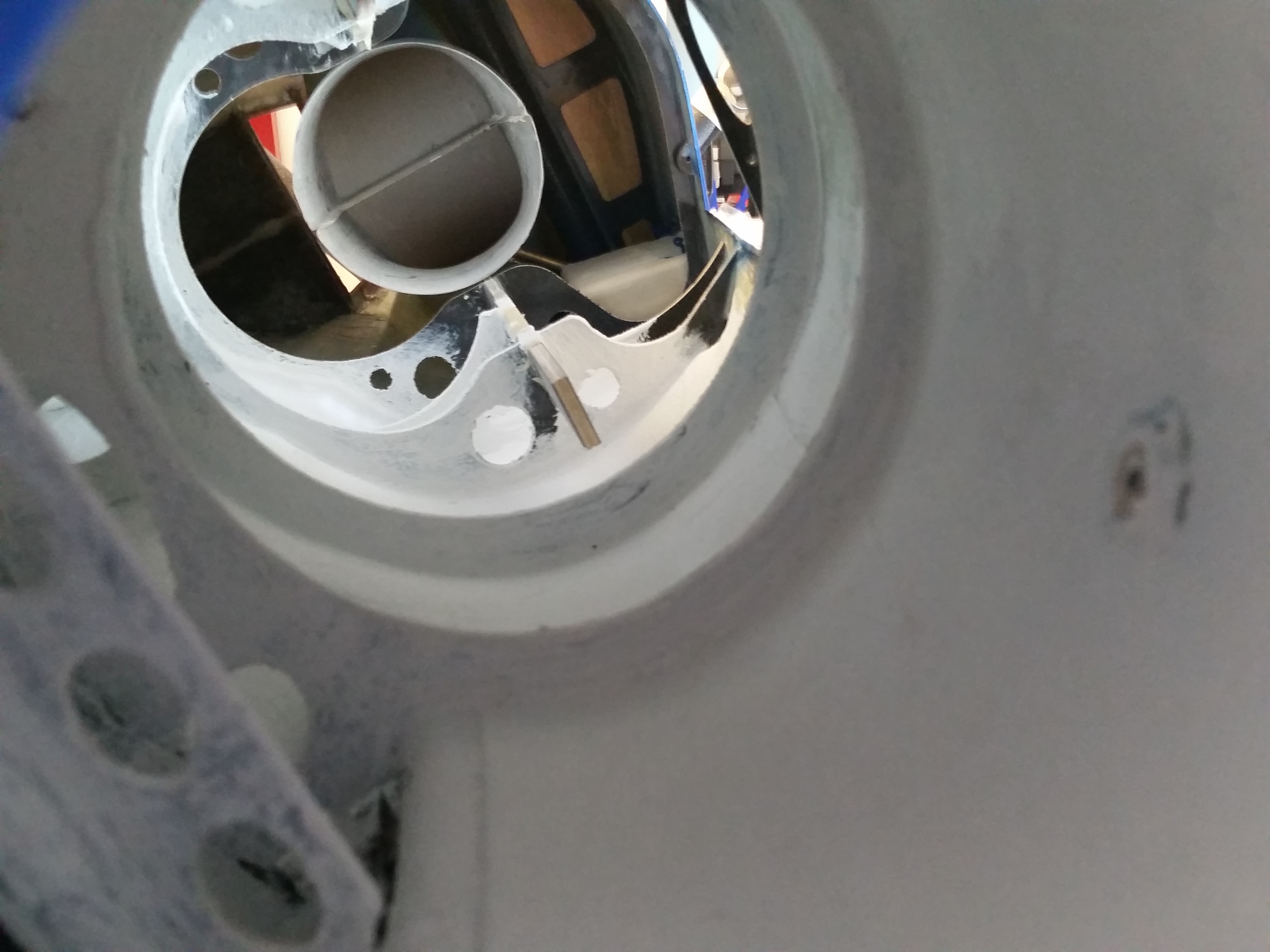

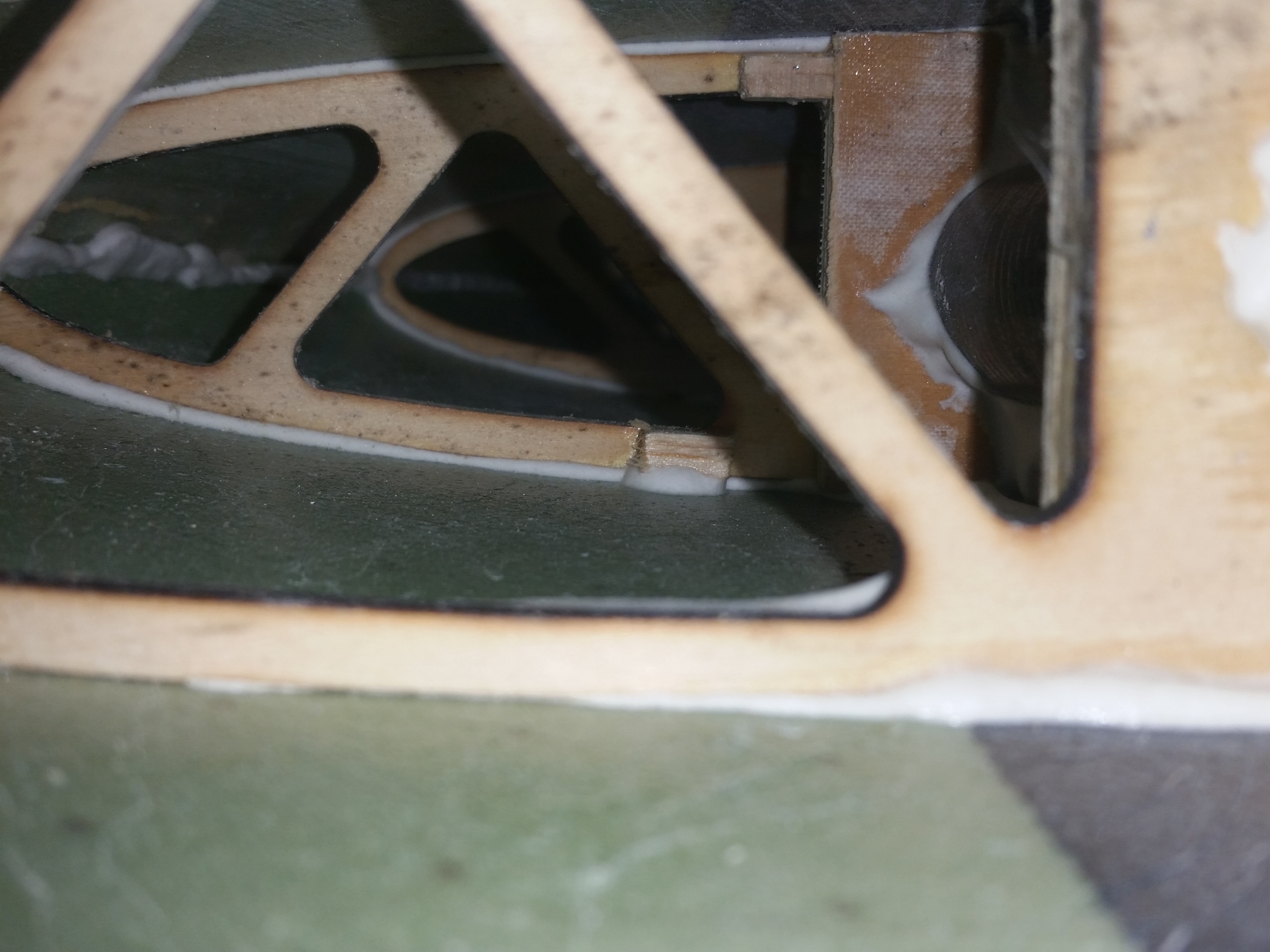

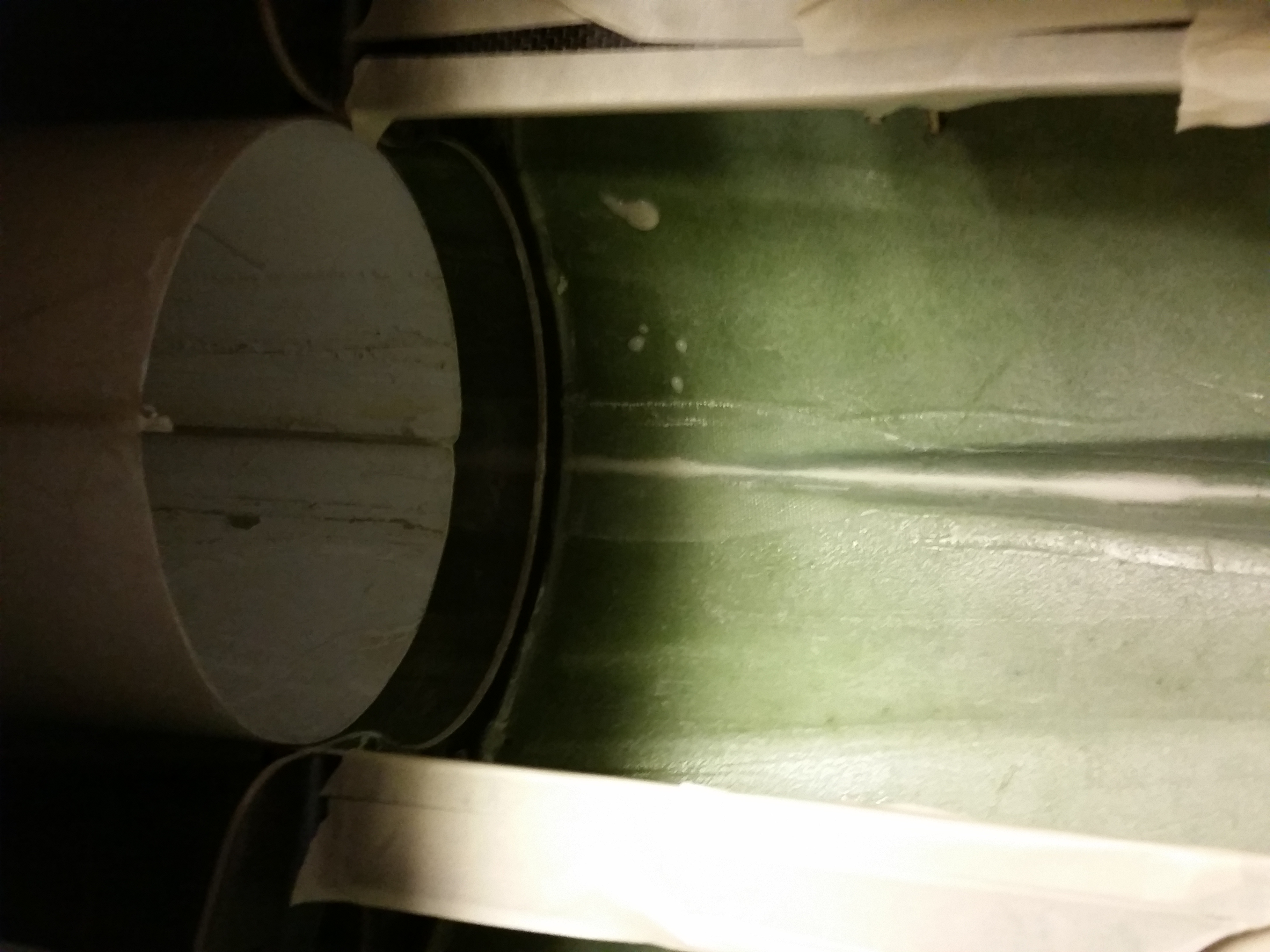

So I'm about to coat the turbine area with heat shield paint. What is the best or recommended cleaner to ensure the inside is clean? do you just use a wet cloth or do you use something else to make sure its clean?
trying to find out what cleaning agent or solution to use inside the fuselage. I want to start putting on the heat shield paint but want to clean the inside first. What are your recommendations?

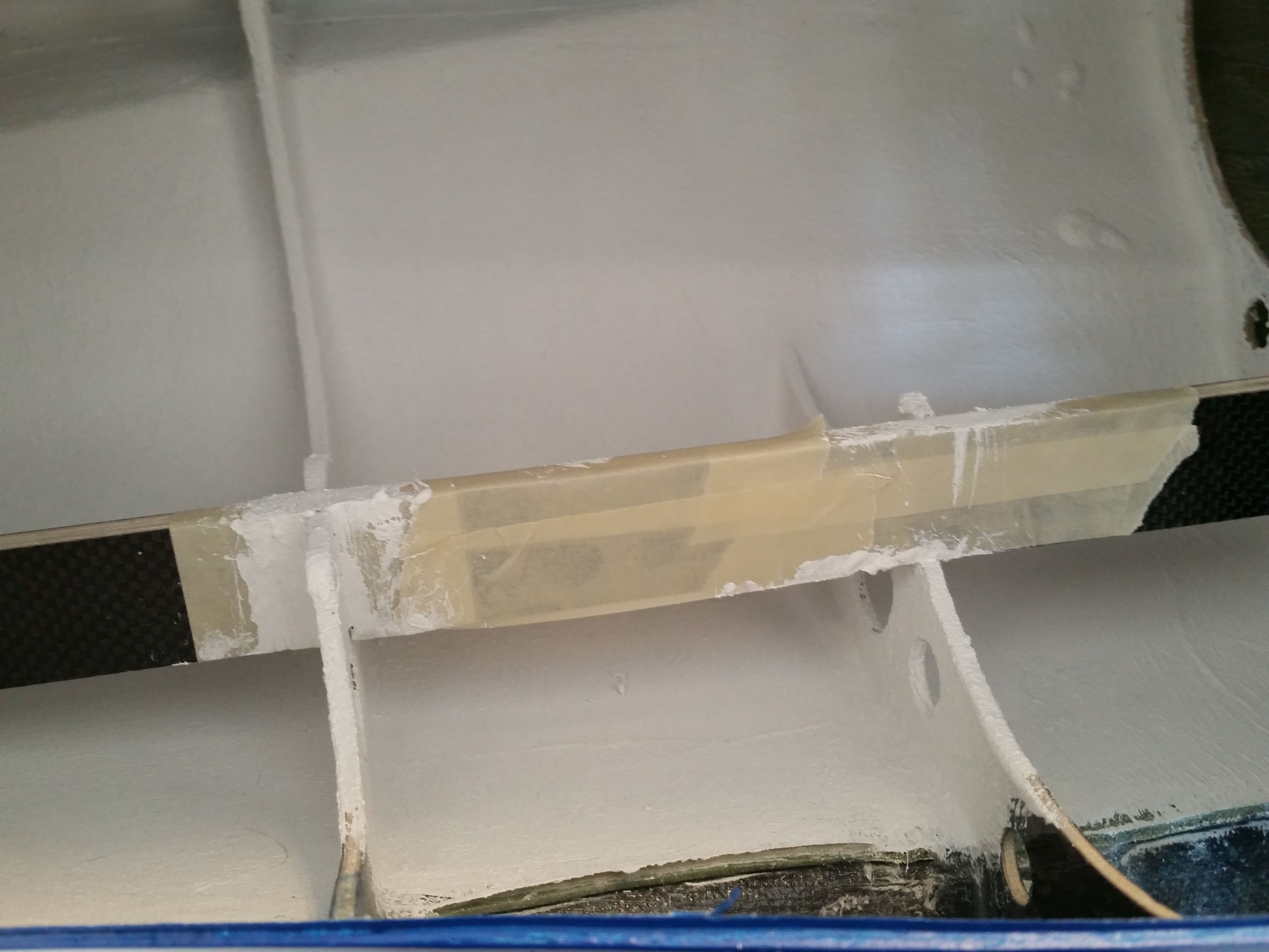

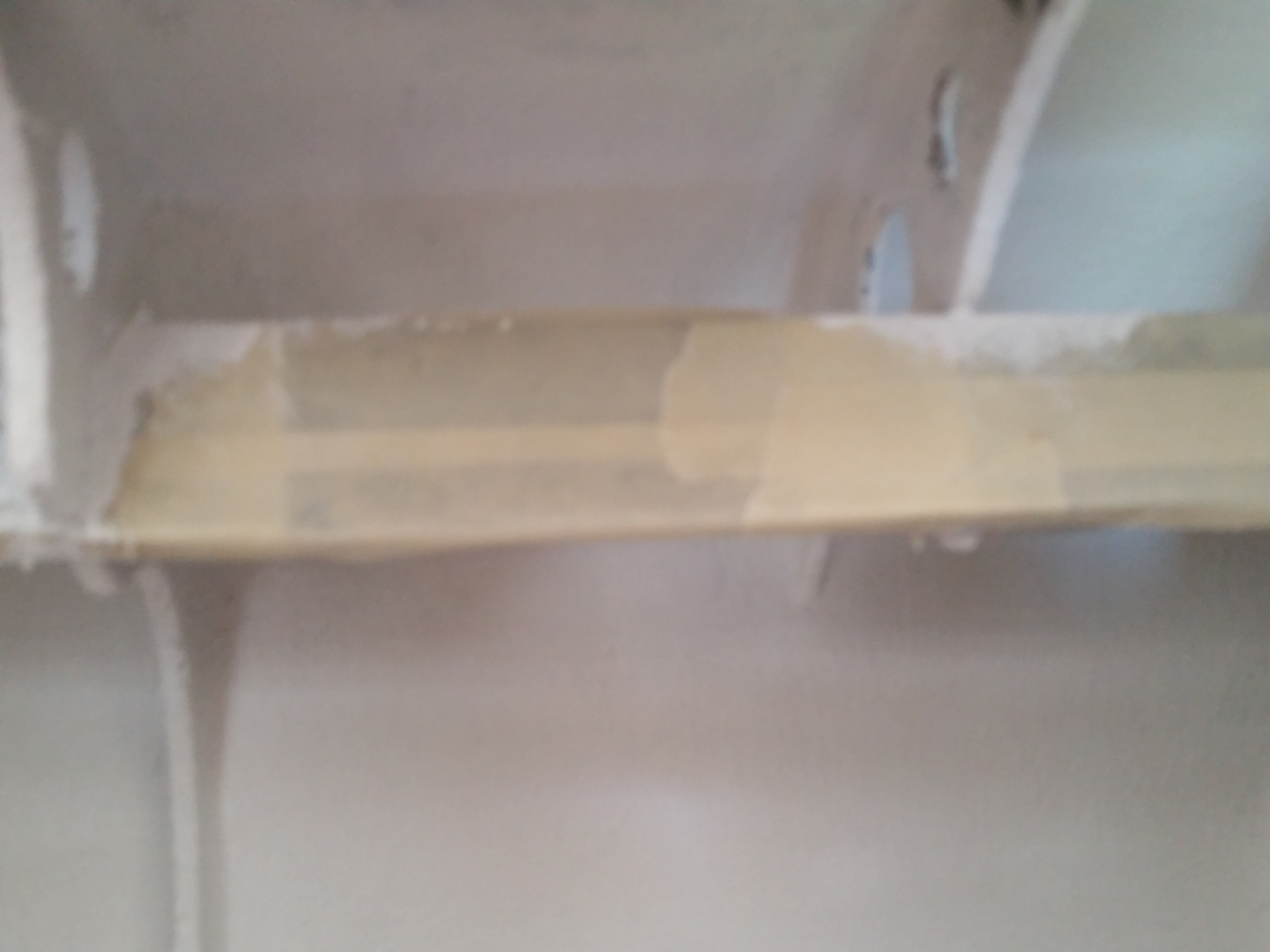

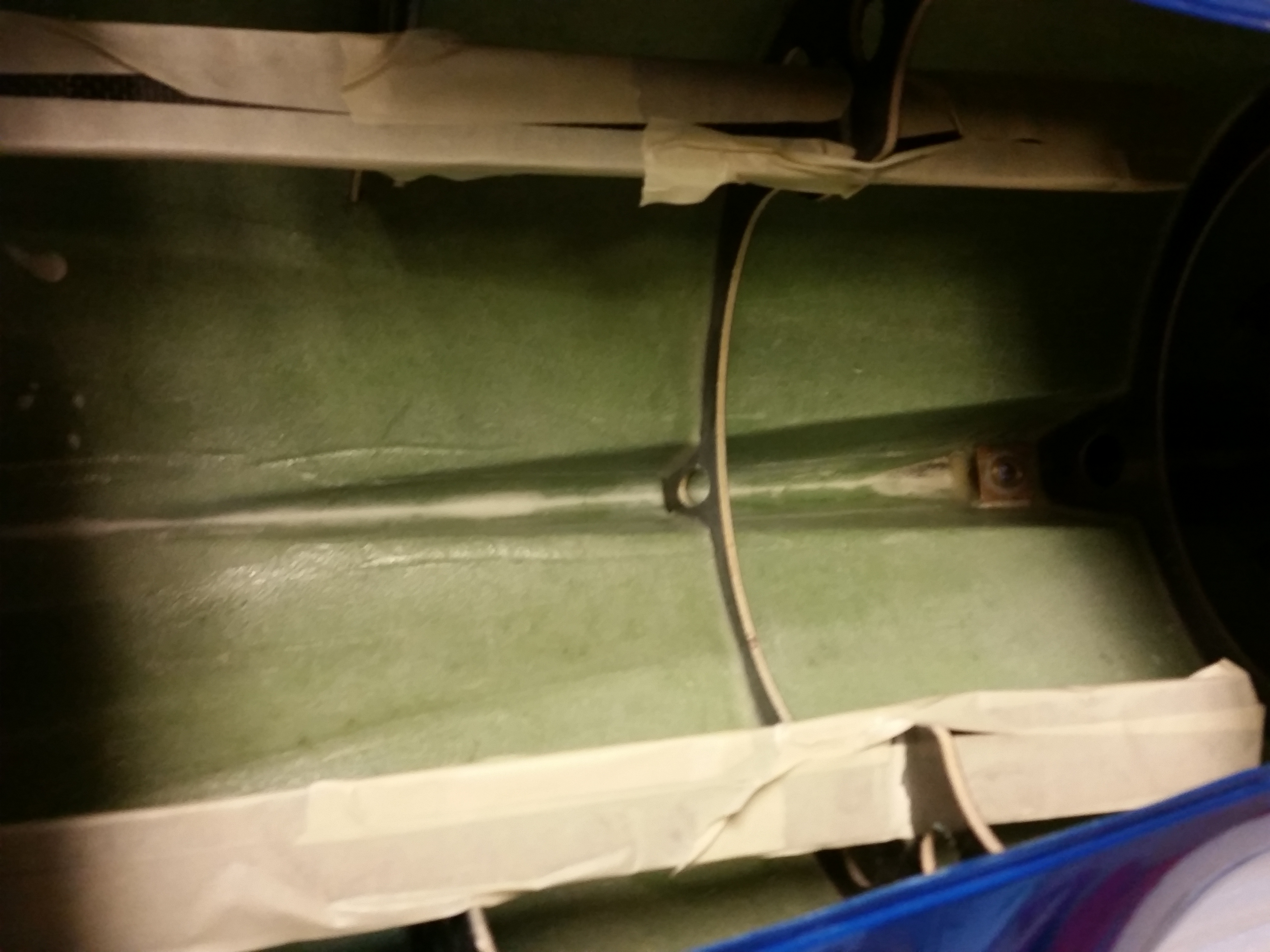

Well I didn't get a response from anyone regarding what to use to clean the inside of the fuselage. So I just used water and a wash cloth. I applied the heat shield paint two coats. I am waiting for the blanket to come in so that I can cut it to fit between the bulkheads. I applied the paint to the bulkheads as well. I forgot to take another picture of the bulkheads that I missed and reapplied.

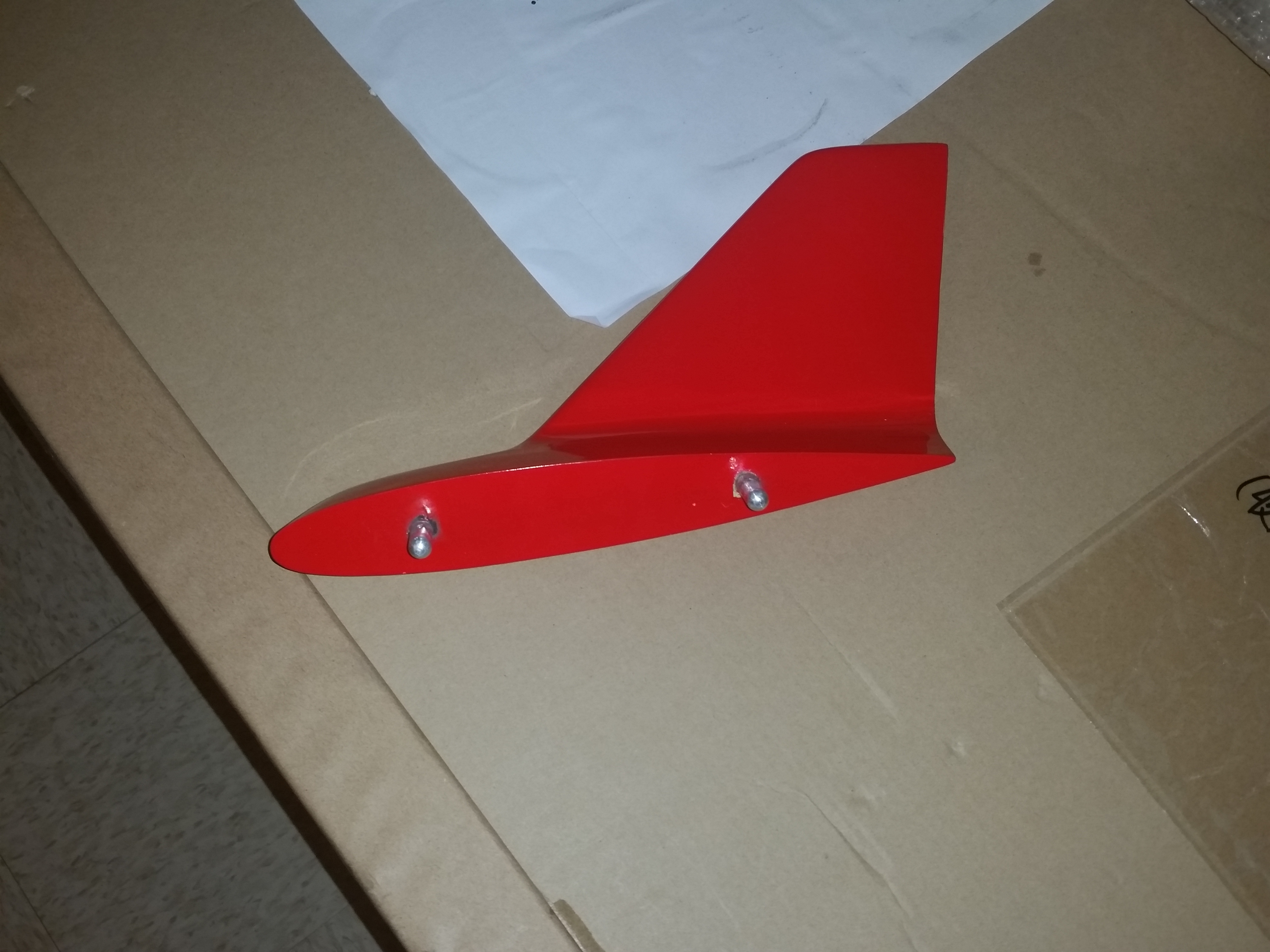

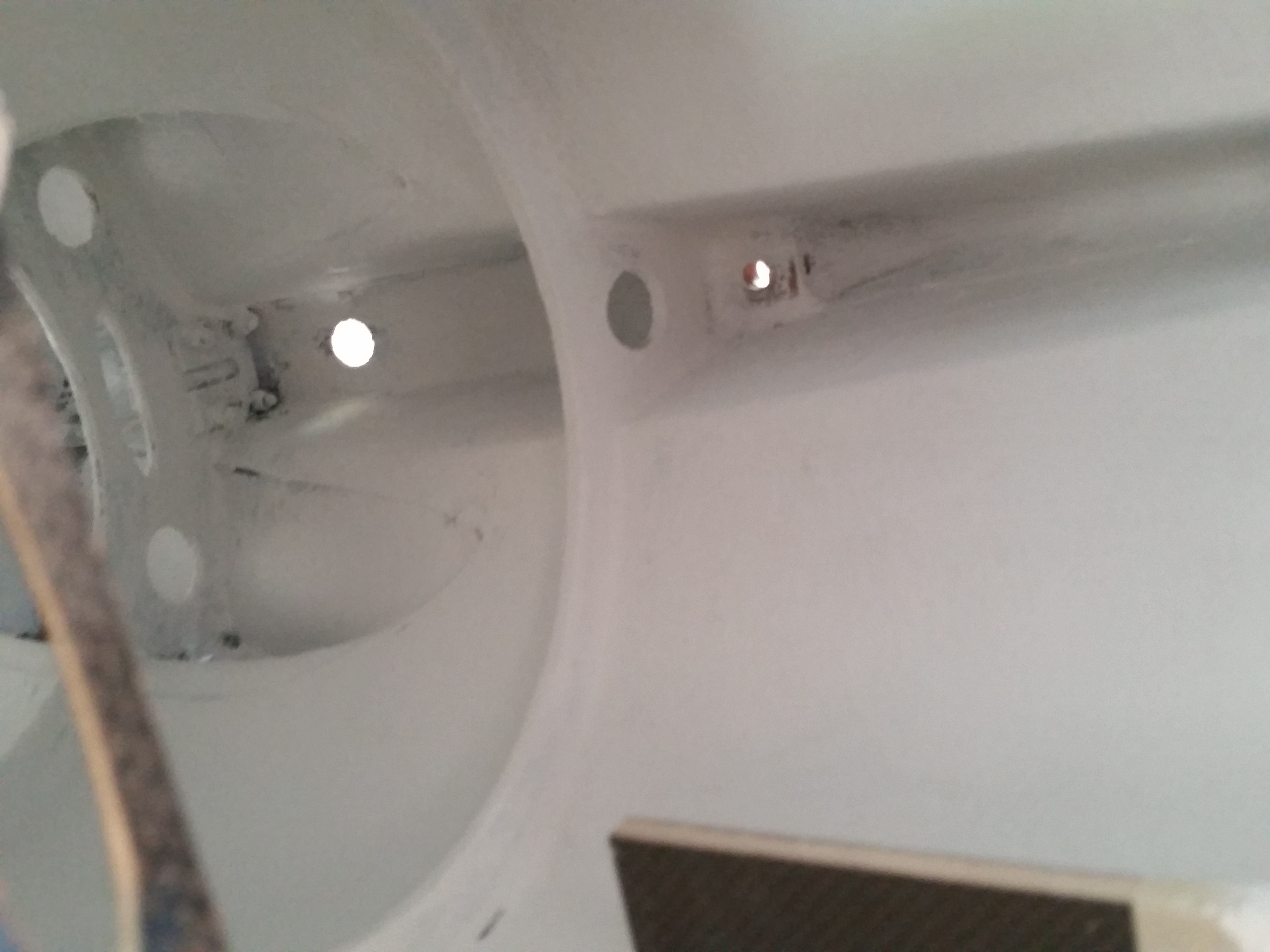

I have a question and need some help. I put the rear belly fins on and one of the screws is not tightening. Its almost as if the whole is striped. How can I fix that? do I fill the hole with CA and then re-drill?
Old 02-16-2016 | 08:26 AM
FenderBean's Avatar
Joined: Feb 2006
Posts: 7,213
Received 99 Likes on 65 Posts
From: Huntsville AL
In regards to the cleaning, I would use acetone or something like that to remove mold release from the inside. As for the fin, if the thread I loose in the fin you can either go with a large screw and just make the hole bigger on the jet or you can add some hysol to the screw and secure it. Just make sure the fin has a block of wood inside for the screw to attach to. Welcome to jet building
What bulkheads are you missing?
Also for the future, the ceramic paint is heavy and generally you only need it around the aft part of the turbine and bell mouth area. Lots of room between the turbine and skin in this particular model, other jets that have a tight fit turbine may require more area. I personally wait till the turbine test runs and check for hotspots then add heat protection. The wires in the tail all get heat protection during the build, I just hold the turbine area till its ran.

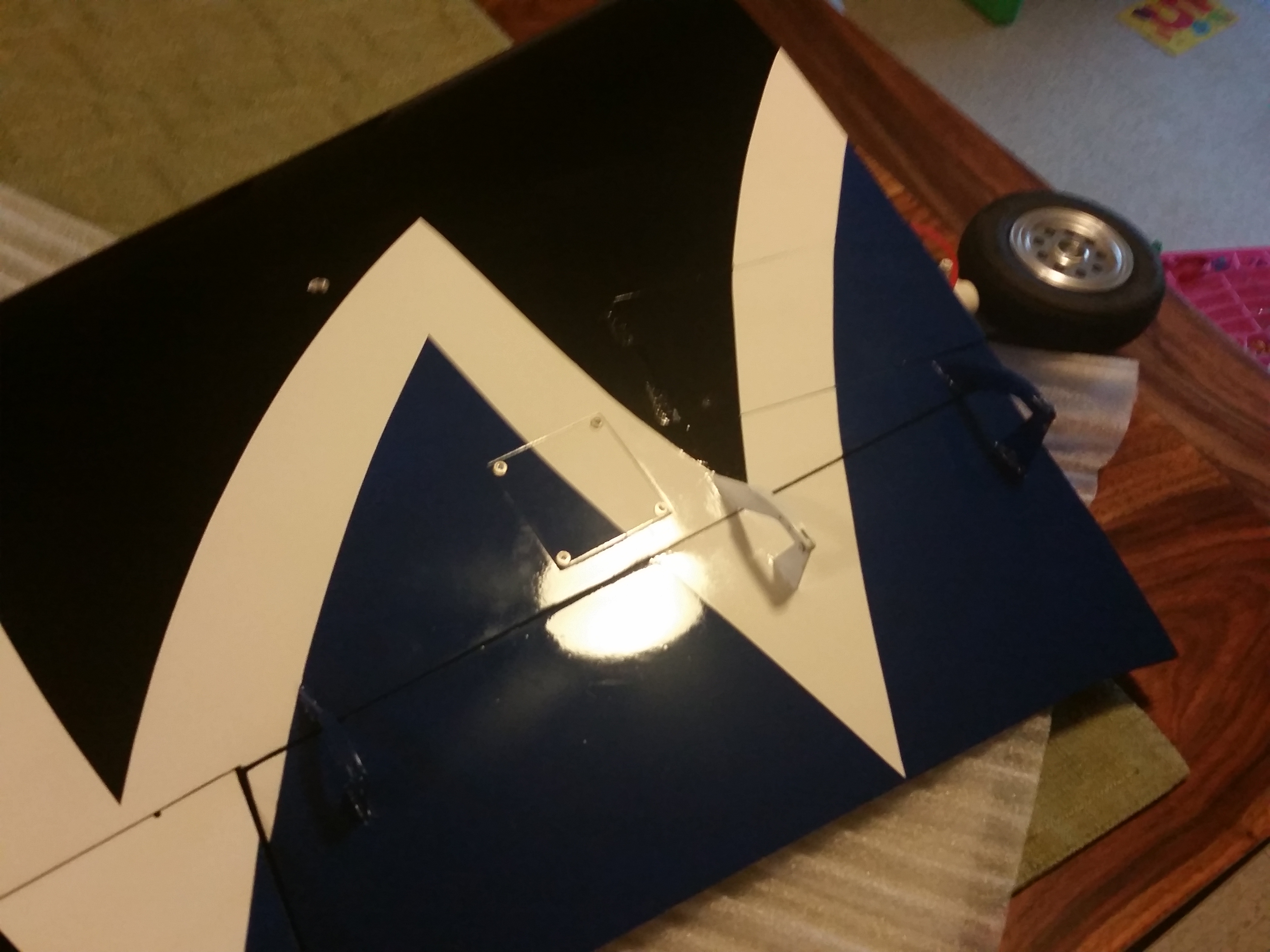

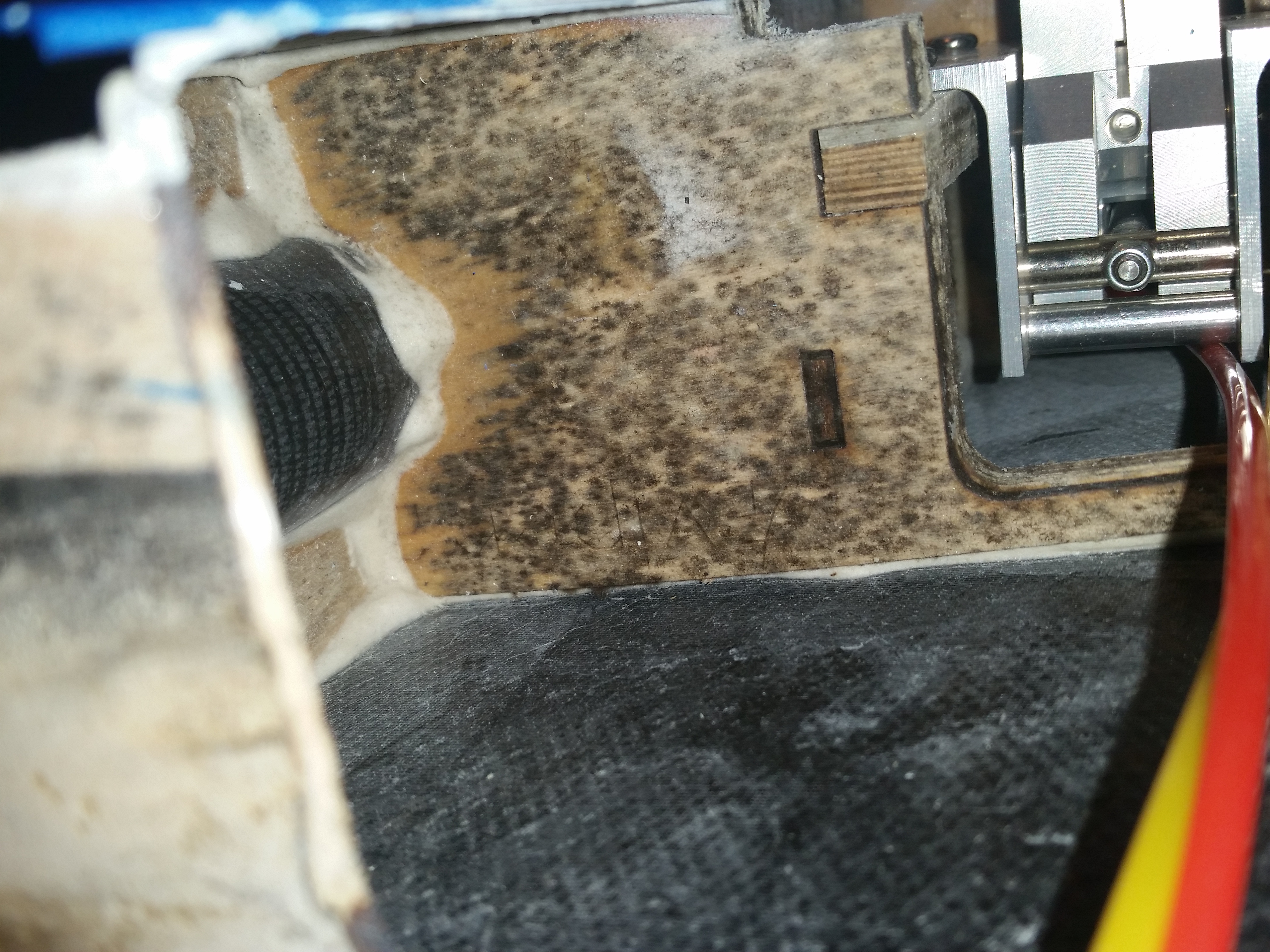

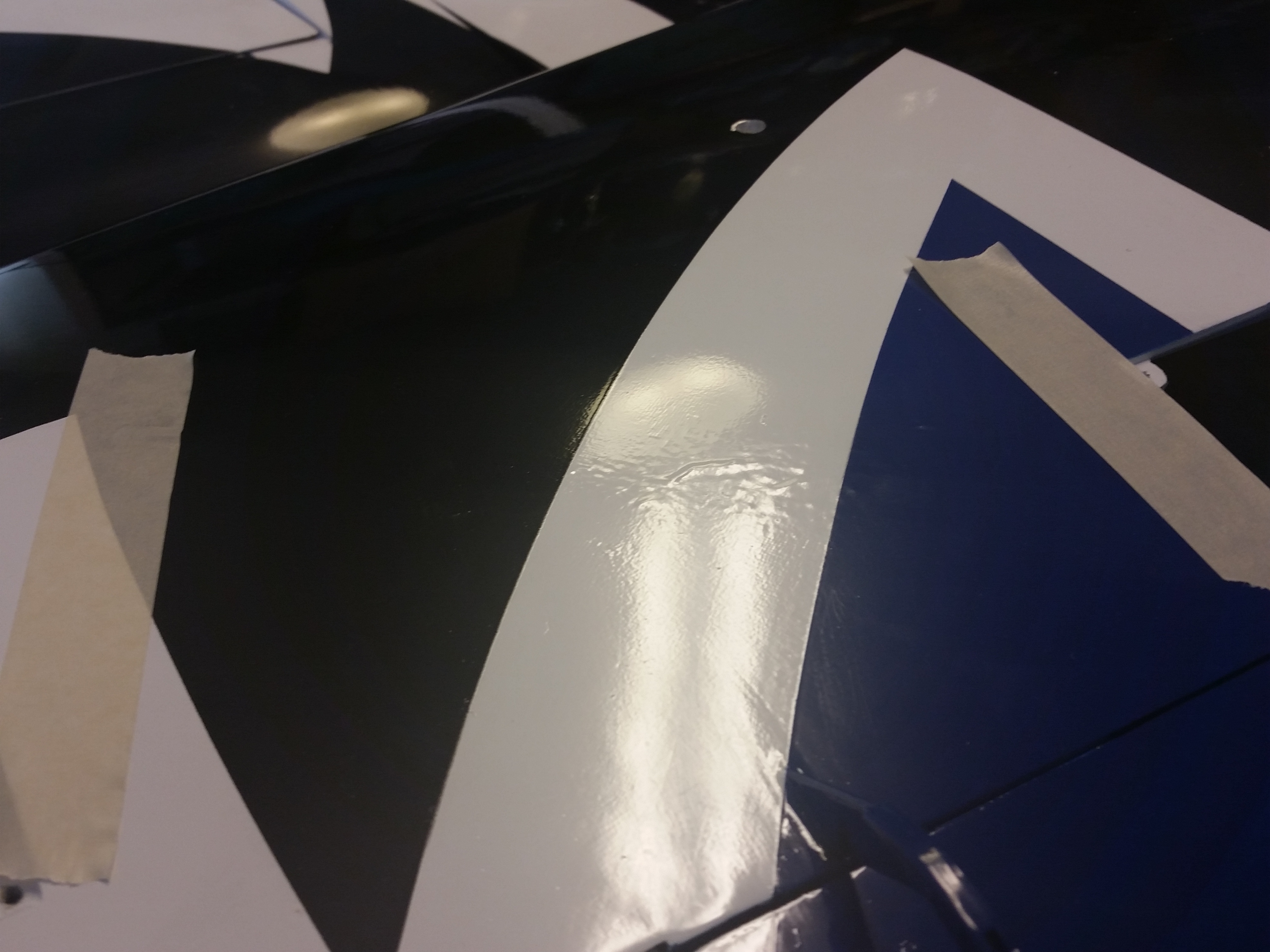

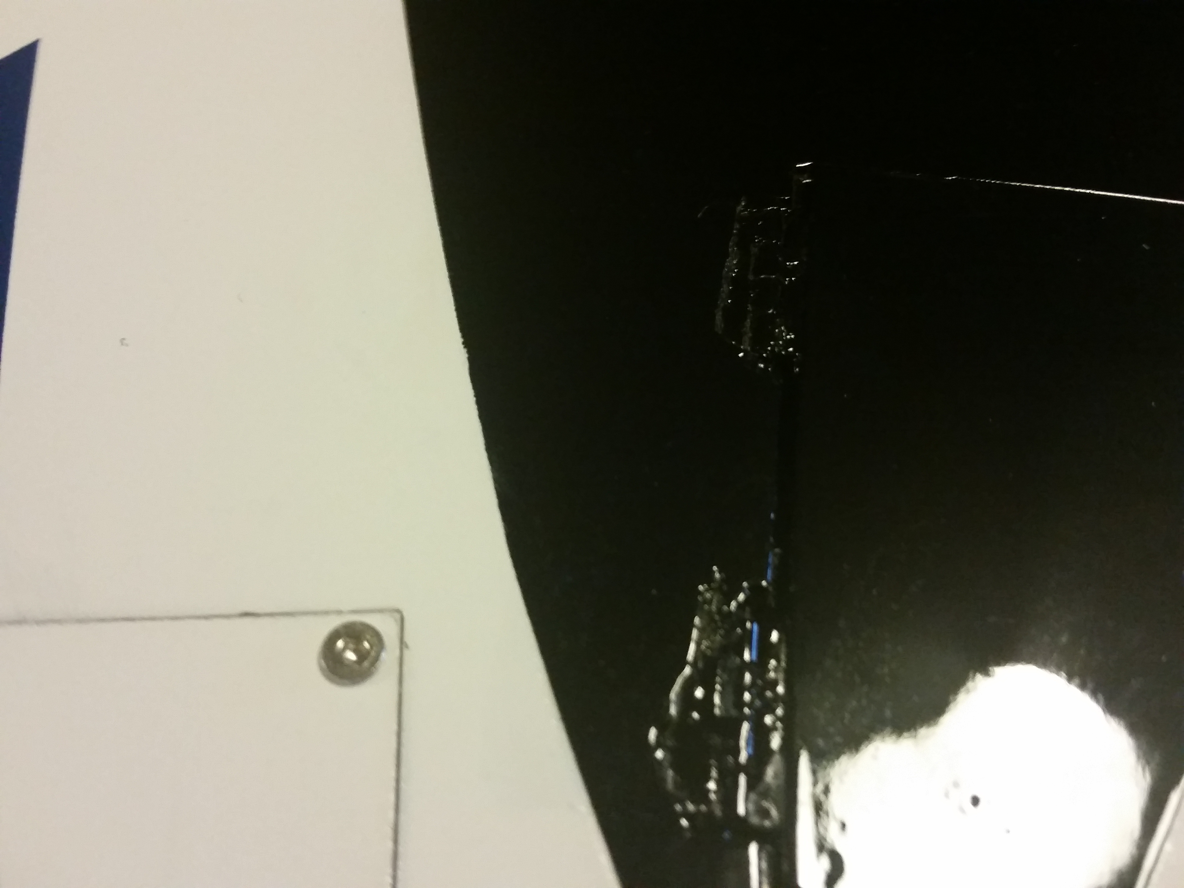

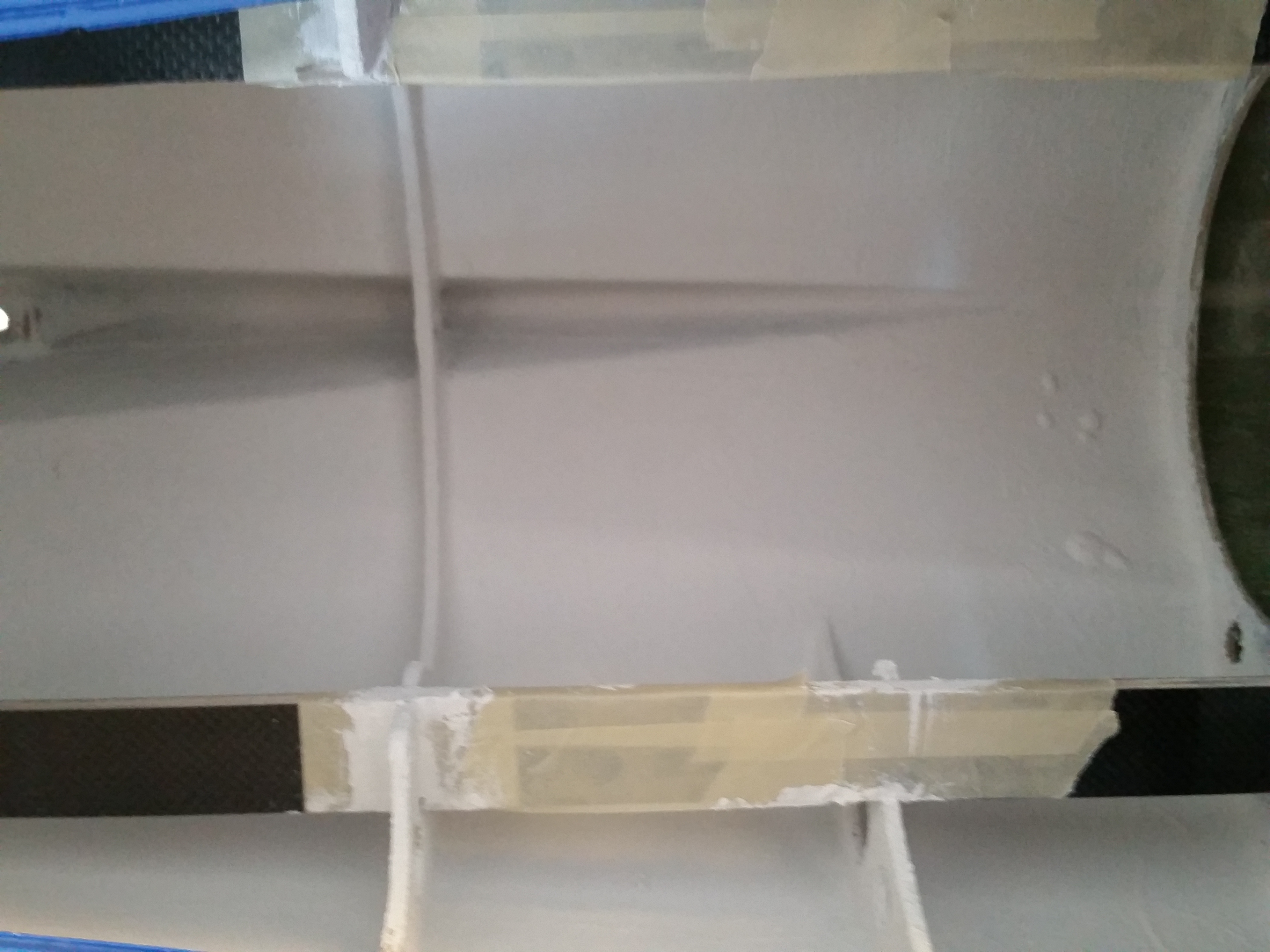

So after having the viper in my hands for a few days now I have noticed that on one of the wings the bottom paint is starting to bubble. I have gotten with FB and I have two options: they will send me paint to fix it and a refund of $250 or send the wing back and have them fix it and no refund but they will pay for shipping. The section is not very big but trying to figure out the best option. What do you guys think I should do? Send the wing back and have to wait a few weeks to month to get it back or get the paint sent to me and have it fixed here? Also I have some more work done. I will add picture soon.
Here is a picture of the bubbling of the paint:
Old 02-19-2016 | 11:59 AM
FenderBean's Avatar
Joined: Feb 2006
Posts: 7,213
From: Huntsville AL
Joe, was it that way from the get go? I don't see how it would bubble up this long after the paint process unless something else caused it.
I would not bother getting paint from the factory, I have tried this before and the paint seems to never make it before its ruined. If its something you can deal with being on the bottom it may be more advantageous to either ask for some money back. If you have to fix it your best bet is to find a good painter locally.
My F-14 had to have a new nose due to the paint being messed up, I tried and spent a lot of money trying to find matching paint and fix it locally. Its not very noticeable and you will never see it in the air but I know how particular I am so I completely understand wanting it perfect.
Sorry your having issues, never fun.
Old 02-19-2016 | 12:23 PM
Joined: Dec 2015
Posts: 470
From: Germany
Thanks Keith! I was thinking the same thing. Honestly I didn't look at the bottom of that wing when I got it. when I flipped it over to start working on it, I seen it. It is in the house at 70 degrees F and nothing has been on it. I left it in the bubble rap after looking at it as I unpacked it. I will just get the money back. its white paint so I should be able to sand a little and put new layer on it. I am the same way you are. If I am paying this much for something, then yes I want to have it right and no issue. For this amount I can get a nice looking car with no paint issues. overall I still love the Jet and Catherine at FB is great in customer service. Also On one of the landing gear, it is stuck solid. it will not move up or down inside the shaft housing. Looks like I have to take it apart and see what is going on. not sure if the spring is stuck.

Keith I forgot to add. I talk to FB about the screws being too small for the servo mounts for the wings and they informed me that we are supposed to use wood blocks to fasten to the servo covers and then servos to wood blocks. I told them that in the manual it doesn't show or state that. I will be going to the shop today to get some wood, glass and work on them today. I will post pictures later tonight.
