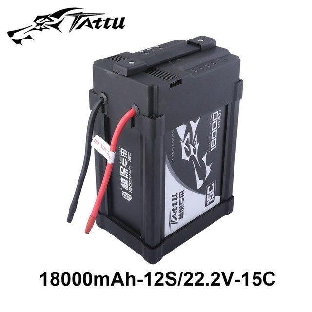

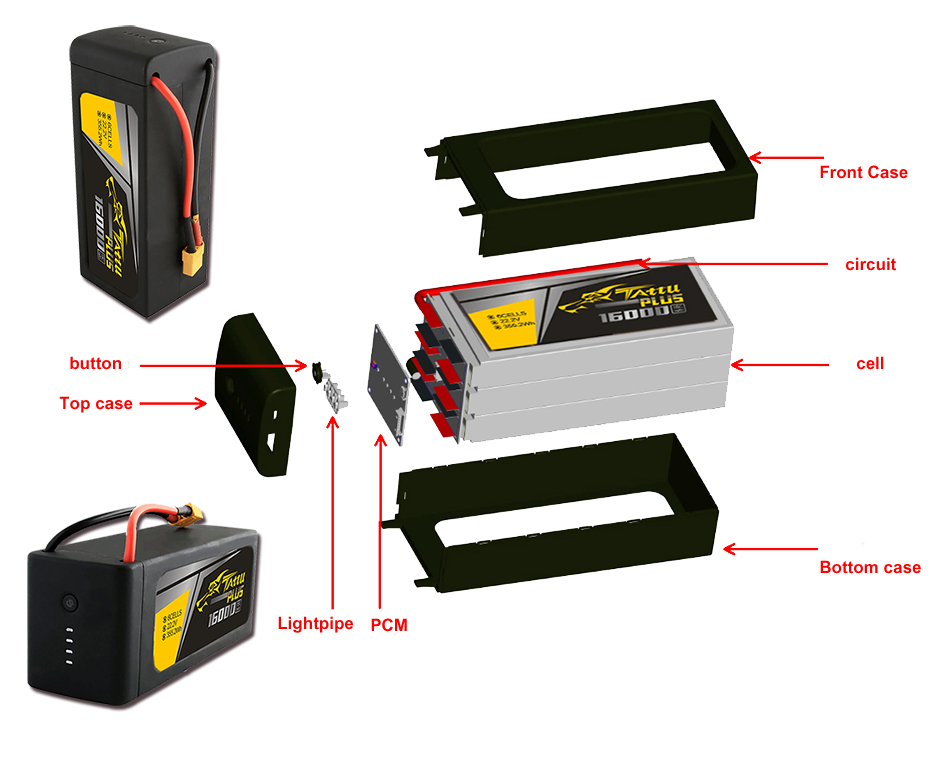

Therefore you need to look at batteries, Tattu is putting out 22,000Mah UAV Lipos at 22.2 volts coming in at 2500g, so you need 8 of those 4s2p of those giving you an all up weight of ~20kg in a 88.4volt 44,000Mah setup.
So you’re not far off the whole turbine equation, and the difference is that your system will always have better performance over time as your batteries will continually increase in capacity. So you can therefore increase you flight times or use the same capacity as the batteries get lower in weight.

Tattu is also making 30,000Mah UAV packs and they are 25c, so you really have to be drawing the amps to get to those levels. Even @ 10c your still not stressing the cells. They also have another range with a "Smart" battery management system which has all the bells and whisles actually on the pack.
We use other industrial cells but the point is these cell are available now and have alot of capabilities. The big movement in the LiPo side is actually coming from the large drone side, big quadcopters to be precise.
