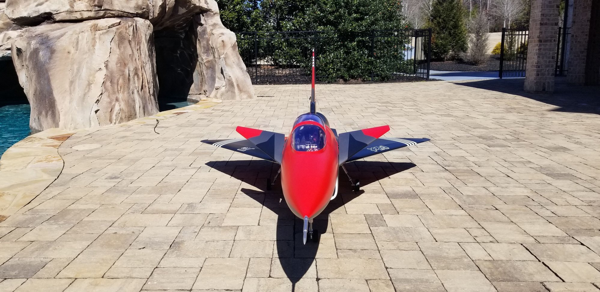

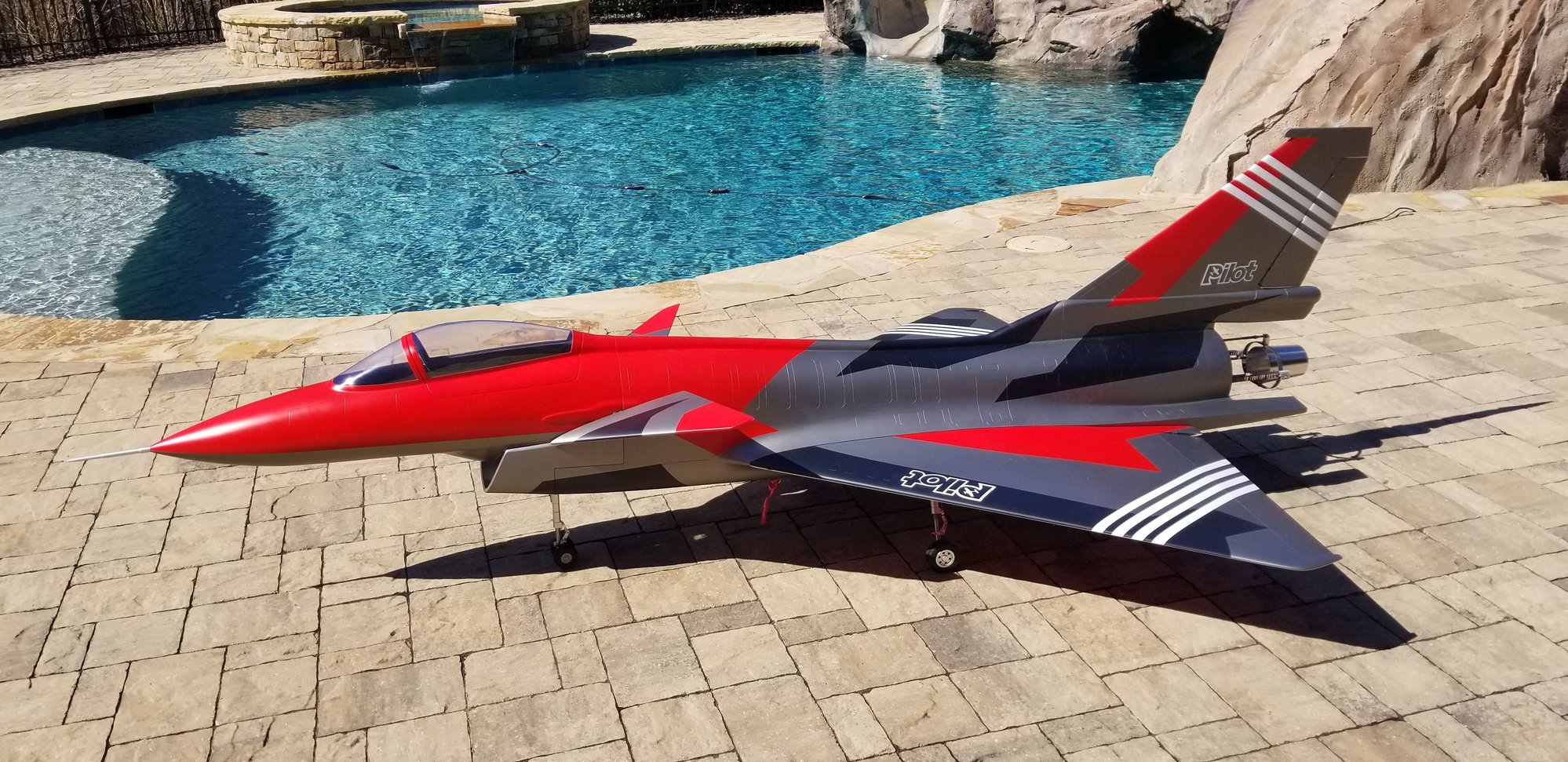

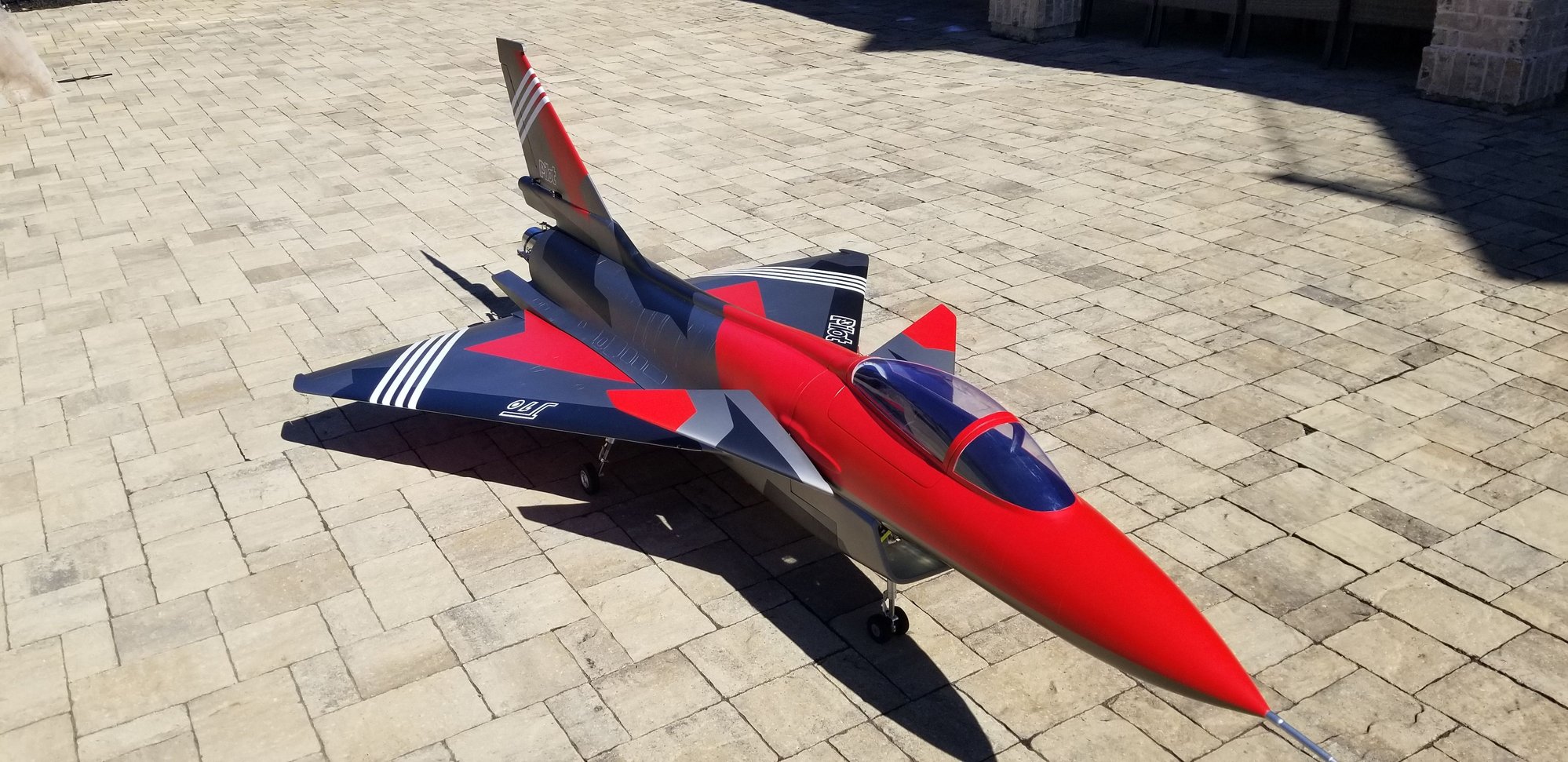

GULDUKAT 02-19-2021 01:20 AM
Almost ready for maiden - this Sunday (weather permitting)
PilotRC J10 Red 112"
Swiwin SW 220
Bluebird H51B Helical Gear Servos X 5
Cortex Pro
3s lipo 2200mah
2s lipo 2X 4400mah
Full uat - 250ml
No smoke fluid - empty 1.5L Smoke tank and PilotRC Smoke pump
No fuel - Empty larger 5L tank for possible 8-10min flights
Right gear 5704
Nose gear 962
Left gear 5646
12312g = 27.14lbs dry (full UAT)
