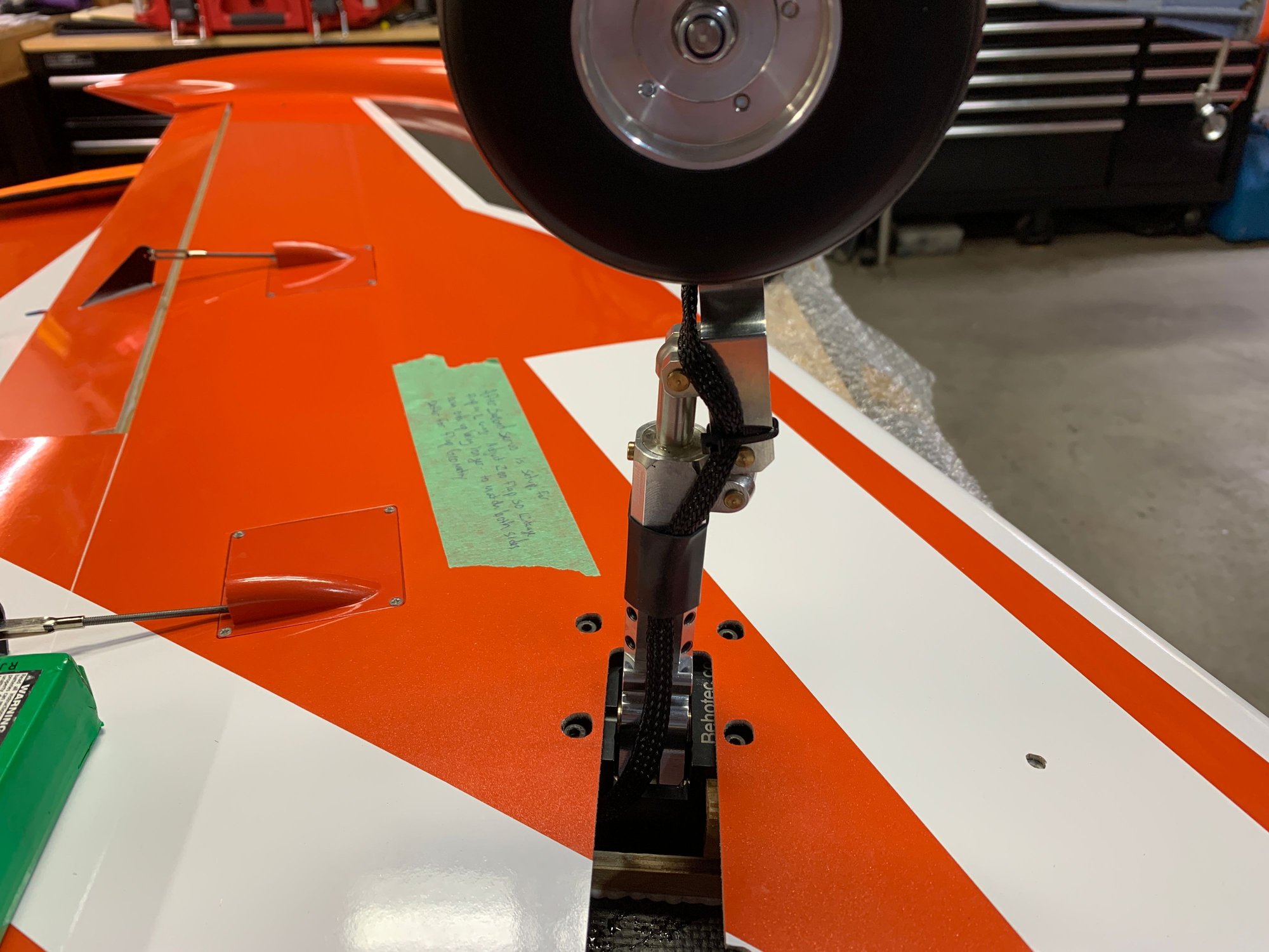

https://cimg6.ibsrv.net/gimg/www.rcu...44b9fe0843.jpg
Some pictures of final brake line routing.
https://cimg8.ibsrv.net/gimg/www.rcu...5de167c3d9.jpg
https://cimg1.ibsrv.net/gimg/www.rcu...c0ba0da81b.jpg
https://cimg2.ibsrv.net/gimg/www.rcu...9b01278e3a.jpg
