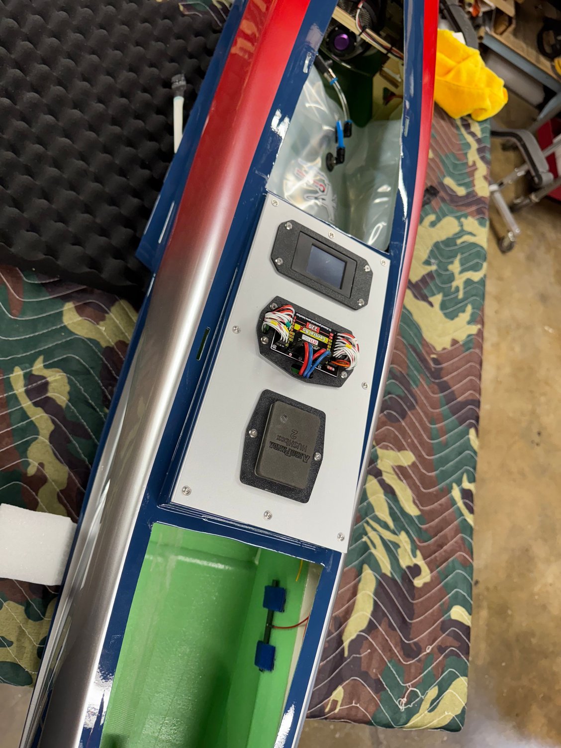

tmgreen64 12-26-2024 01:51 PM
Just a little info, might help out the next person with their build. I do not have the VT Matrix and have a kingtech 130G5 in it. With the turbine battery up front on the supplied tray, the receivers batteries needed to be placed way back almost to the tank, it is a pain to get them in and
out. So I made this tray and the CG seem to be just right. This way I can get the batteries in an out much easier. I am going to paint it so it looks nice. One other thing: I cannot get full flaps with the servos arm supplied. I am going to work on that today.
https://cimg4.ibsrv.net/gimg/www.rcu...e67cd99a95.jpg

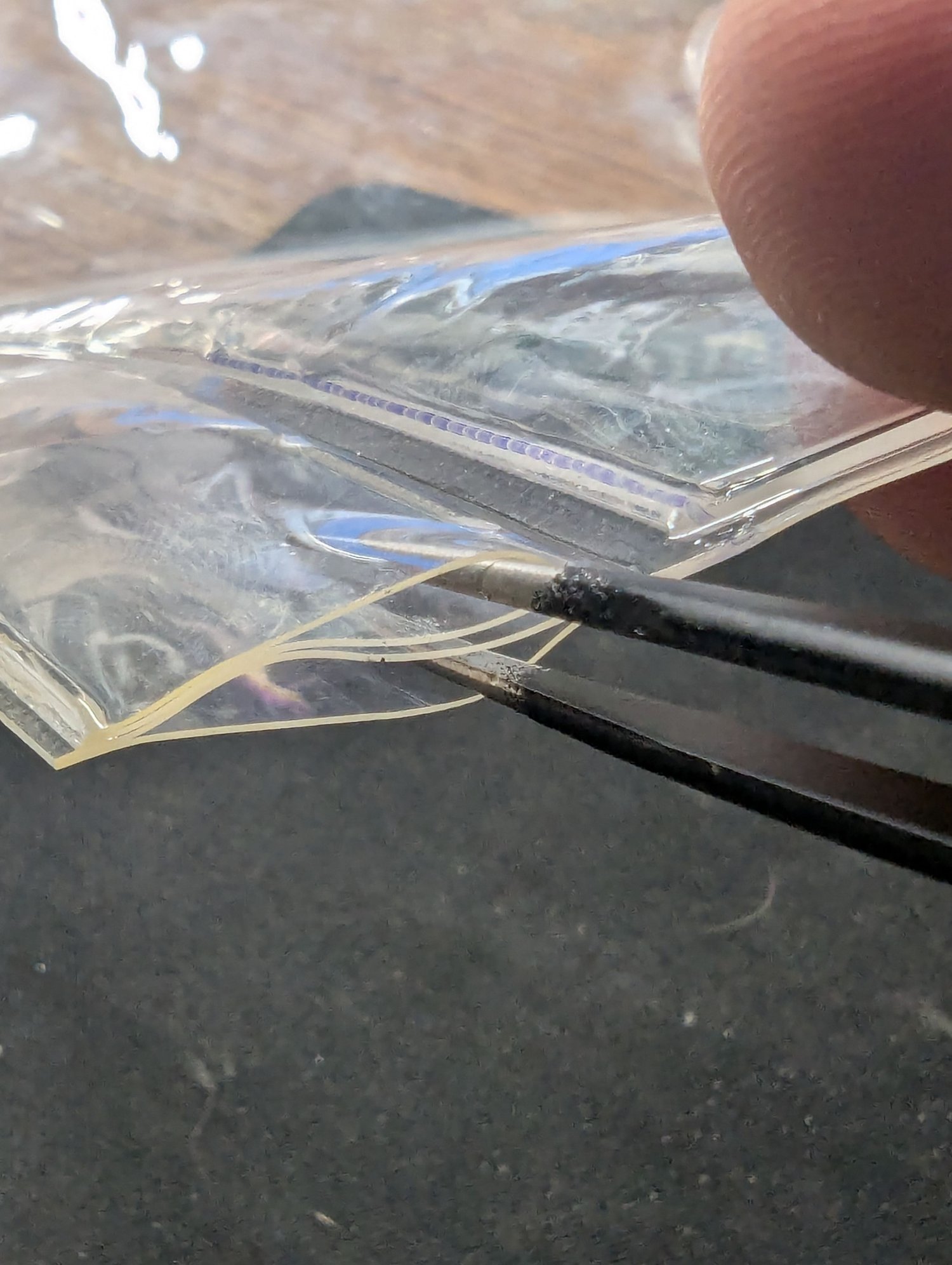

jvaliensi 01-20-2025 09:30 AM
Hi.
I flew my Matrix over the weekend. What an awesome jet! It goes fast enough but it feels so good flying it slow.
I have bought the fuel bag for it. Has anyone tried this yet? I see on the Banana Hobbies web site that the new kits come with it, instead of a kevlar tank. The Pilot bag does not have a fuel pickup line in it. Pilot seems to be really interested in making good airplanes and testing their stuff before selling it. So, I kinda of trust that this thing will work.
https://cimg6.ibsrv.net/gimg/www.rcu...a7dd87d64.jpeg
https://cimg7.ibsrv.net/gimg/www.rcu...f2def2e66.jpeg
https://cimg9.ibsrv.net/gimg/www.rcu...2bbee4f47.jpeg
BarracudaHockey 01-20-2025 10:35 AM
That doesn't meet the specs if you plan on using your AMA insurance
jvaliensi 01-20-2025 10:36 AM
Hi, How do you know that?
BarracudaHockey 01-20-2025 10:56 AM
I pretty much wrote the new rules for the fuel bags :)
Its that single layer nonsense they have been sending over here.
5. The fuel tanks shall be of rigid construction with consideration given to burst and puncture resistance. Consideration shall be given that non-metallic fuel lines may not be able to contact hot parts of the engine as installed. Bag style fuel cells are permitted under the following conditions:
a. is a multi-layer fuel cell that is purpose built for the application and designed to be resistant to rips, tears, hardening and cracking from kerosene/jet fuel exposure.
b. is mounted in such a way as to ensure no contact with rough surfaces capable of causing abrasion between the tank and any aircraft surface.
c. is mounted away from or protected from heat exposure from the engine(s) and pipe(s).
d. is filled with a pressure sensing fueling system to ensure the cell isn't over pressurized during fueling.
​​​​​​​e. NO plasma/IV bags are permitted.
jvaliensi 01-20-2025 11:46 AM
It is pretty thick and I cannot tell if it is double wall construction. Its was never an IV bag, it is made of different plastic.
No matter, I ordered a proper one from Carlos. The Pilot mounting hardware will be useful.
Thanks for the information.
BarracudaHockey 01-20-2025 11:53 AM
My pleasure, I have seen the PIlot fuel cells and unless they very recently changed something they are not complaint. In fact I have one in my truck along with a sample from Germany to show people what are and are not compliant when I go to events.

Diver09 01-26-2025 05:13 PM
I also recently ordered a Pilot-RC fuel bag for my matrix (from Banana Hobby).
My bag is most definitely 2 layers. I can see a total of 4 layers between the top and bottom seams.
On a related note, has anyone seen any good photos of what a good mounting job looks like with the included mounting system?
https://cimg4.ibsrv.net/gimg/www.rcu...832ecaecac.jpg
jvaliensi 01-26-2025 05:21 PM
Page 14 of the Pilot manual has a few photos. You can find the book on the Pilot web site.
jvaliensi 01-28-2025 12:00 PM
I took a closer look at the Pilot fuel bag and it is double wall!
BarracudaHockey 01-29-2025 06:22 AM
ok cool, thanks, they must have made the required changes

I recently upgraded to a CM Jets 3l bag tank. I removed the stock Kevlar tank and MAP UAT. I think the weight was reduced approximately 300g. I cannot find the orignal weight, but I weighed the parts that came out and they were more than 400g.
Because the UAT was way up front, I thought the airplane would be tail heavy after the conversion. Turns out it was nose heavy and I needed to move one battery back near the CG. The X132 I use is quite light and a heavier turbine would be tail heavy.
I also redid all the electronics using the mounts Aeropanda supplies. This makes it very neat and tidy.

1. One of the CM Jets fuel bags I got leaked. Appearantly a seam failed. It filled my fueslage with fuel. Carlos said he'd take care of me, but so far it looks like I'm eating it.
