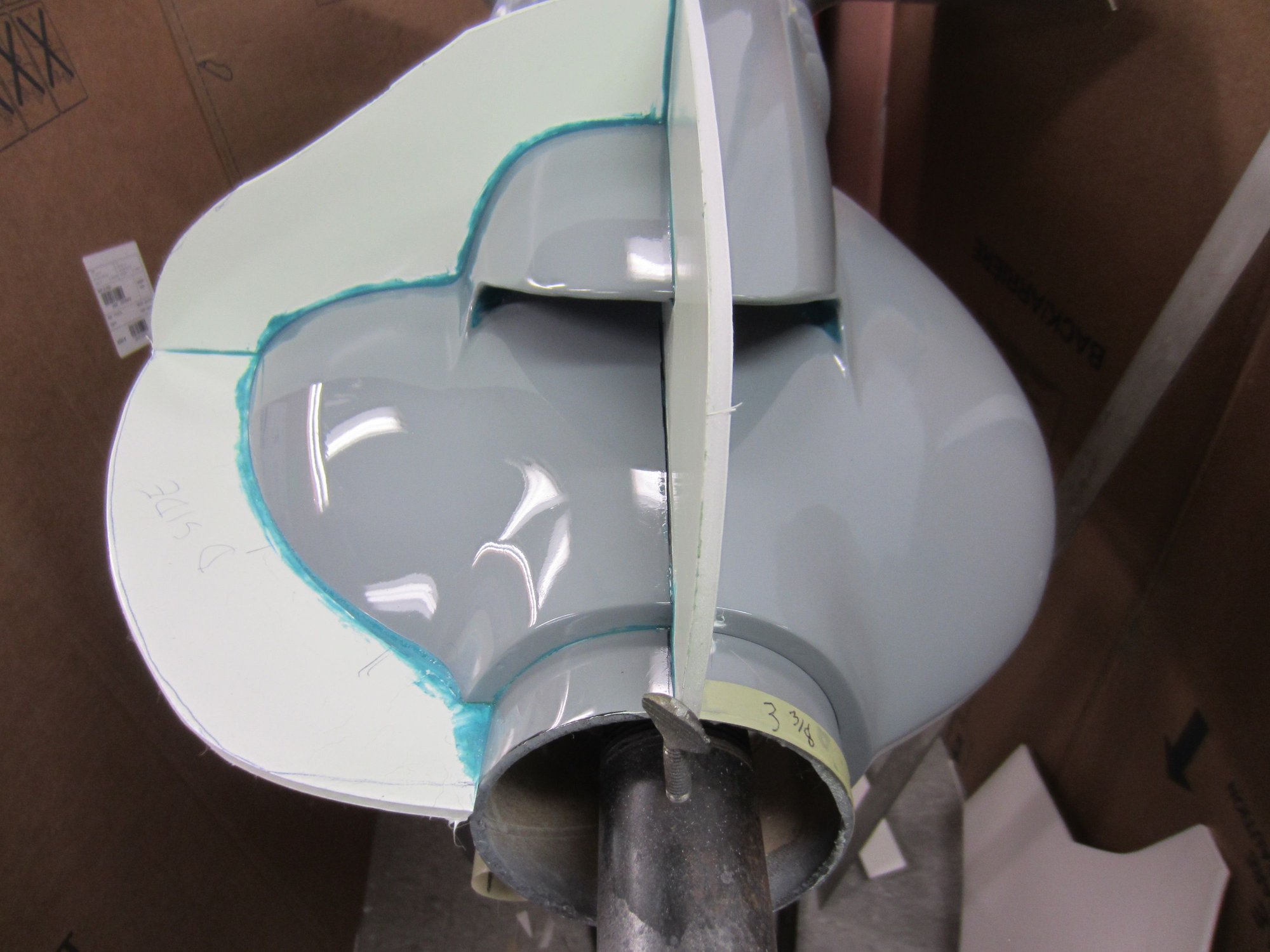

rick hamel 10-28-2014 04:50 PM
Glasscat variant
2 Attachment(s)
Strakes worked out OKhttp://www.rcuniverse.com/forum/atta...mentid=2042927http://www.rcuniverse.com/forum/atta...mentid=2042928

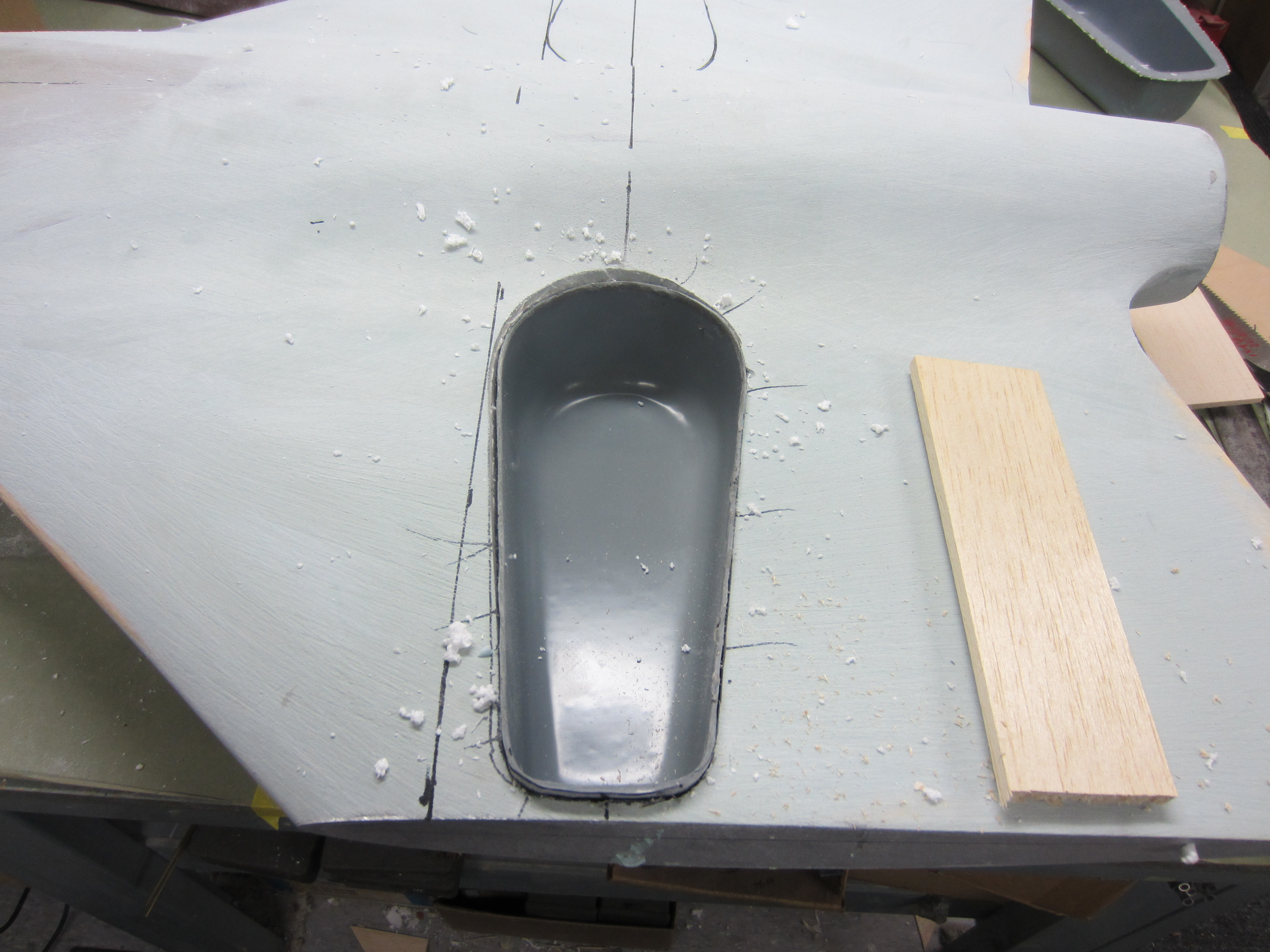

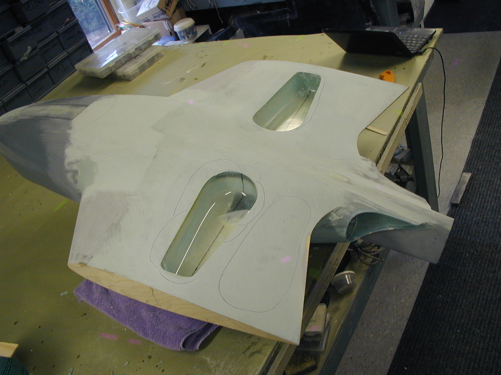

Glasscat wheel wells
2 Attachment(s)
Laid up a set of wheel wells to install in the glasscat variant--since the canard lifts the nose off the ground I don't have to worry about the elevators in the rear as on a standard jet providing the force-so I located them in the thickest part of the wing which puts them 6 inches behind the projected CG location. Normally I put the CG just in line with the frnt of the tires-- these wells are the same as the ones in my Caproni varianthttp://www.rcuniverse.com/forum/atta...mentid=2045202http://www.rcuniverse.com/forum/atta...mentid=2045203

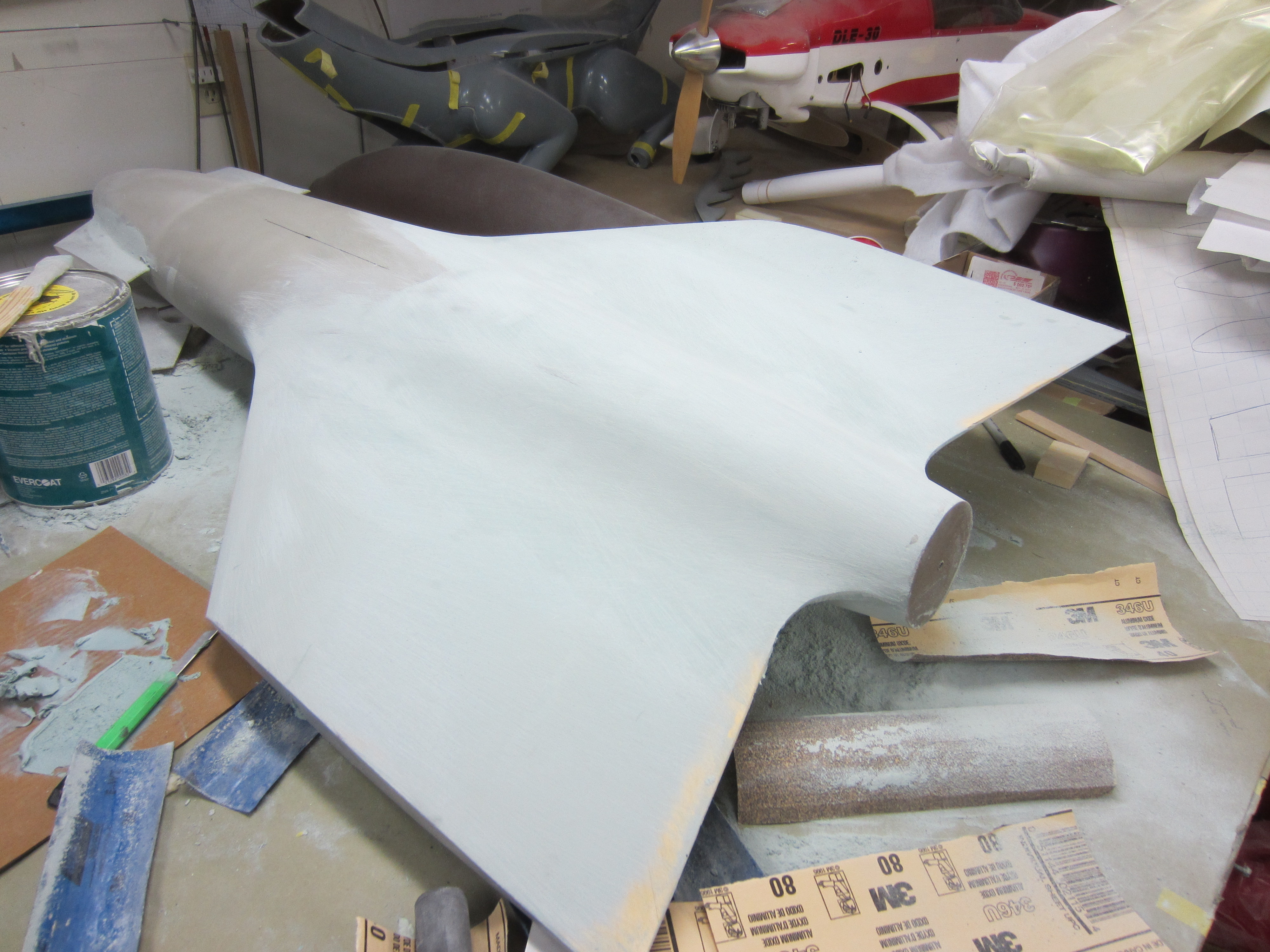

rick hamel 02-21-2022 05:04 PM
modified glasscat
Plug is finished--requires sanding--moulds next
https://cimg1.ibsrv.net/gimg/www.rcu...2e0cda266e.jpg
https://cimg9.ibsrv.net/gimg/www.rcu...729ab01615.jpg
https://cimg2.ibsrv.net/gimg/www.rcu...bd9a49cc62.jpg
