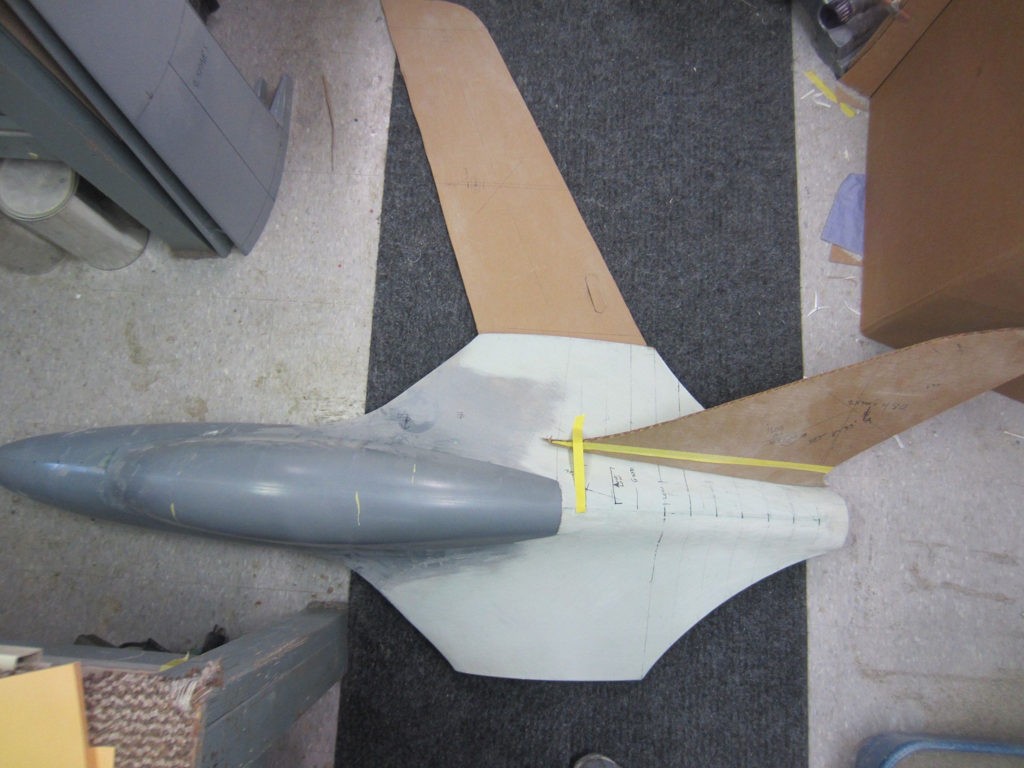

The fuselage that just keeps giving
Here is yet another variant--always wanted some
https://cimg4.ibsrv.net/gimg/www.rcu...a0f2e13043.jpg
thing forward swept--extended the ass end to facilitate a trailing edge with the sweep angle I was looking for--wing needs more taper than shown--stabs will be V tail--this was a weekend fun project
Woketman 02-25-2022 02:14 PM
Nice. Moves the aero center forward. But elevons may be too ineffective (too close to the CG). You would probably need to add some horizontal stabs in the back for good pitch stability/control. But it would look quite awesome!!!
rick hamel 02-25-2022 02:15 PM
epoxy is from US composites #635 thin epoxy 45 min pot It was about $1100 for 32 gallons last I ordered---great for moulds
rick hamel 02-25-2022 02:19 PM
You are on target with that--- and on forward swept --CLA needs about 35% compared to the normal 25%--tail volume on this sucks but I think I can make it work
Woketman 02-25-2022 02:22 PM
I was thinking about that too. Two stiff square section rods sticking out back of the turb exhaust, swept away so they don't get too toasty, that support more aft verticals and the two horizontal stabs (with anhedral of course, so Travolta and Cruise will think it is bad-ass!!!!)
rick hamel 02-25-2022 02:26 PM
You know that might add to the cool factor
pilotdude57 02-25-2022 02:46 PM
Oval cross-section tail booms with an inverted V-tail. Similar to the Starjet. May need strakes on the inside of the tail booms to augment pitch stability. The booms help with directional control. The forward section of the tail booms can contain the main landing gear, which retract to the rear, so as to not change the CG since the nose gear would retract forward. Thanks for the info on the epoxy, looks like it is less expensive than the Alphapoxy from Aircraft Spruce and Specialty.
