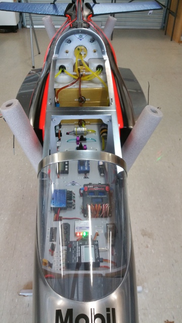

6 Attachment(s)
Just received a new Skymaster 2.6M Viper. A small hole in the side of the fuse that I can repair and some paint runs that I will try to rub out. Otherwise everything looks good.
One area I could use some help is mounting the upper fuel tank. I think I'm missing one plywood mounting piece and instead received 2 of the other plywood piece it mounts to.
One photo shows the 2 plywood mounts I received. The second photo shows where I believe one of the mounts gets epoxied. However I don't know how to mount the upper tank.
The upper tank has a curved top and somehow mounts above the intake duct. The instruction manual photo does not show what is under the tank and has vague instructions.
I can figure something out and make my own mount, but if someone else has done it then I'll see what you did first. Any suggestions or photos would be greatly appreciated.
The last photo shows the upper tank sitting on one of the supplied mounts. Only half the tank bottom covers the mount. I should have something else between the plywood mount shown and the bottom of the upper tank.

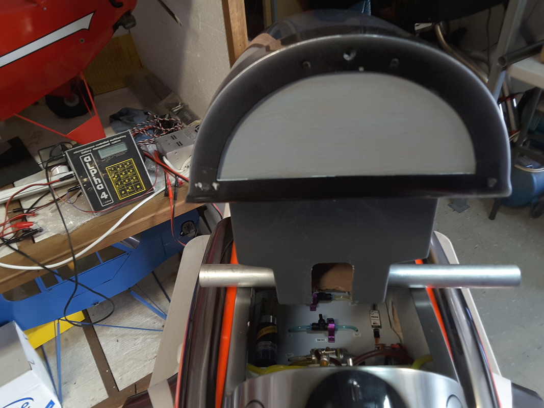

1 Attachment(s)
Harvey,
I installed the top tank between the intakes. Flip it back, seal the current hole and make a new hole for the tank fittings. This way you don't need those plywood fittings and can use Velcro between the tanks and intakes. It also leave you the space above the intakes to use for smoke and other bits.

With the above setup the aft cockpit will need to be modified. I mounted per the instructions but made a mount to support the aft portion of the tank. I used a screw/blind nut on the aft support so it was removable. Plus it's closer to the CG for the second tank. That being said many others have done the above so both will work.
The only modification I had to make was behind the rear seat; I opened the rear cockpit wall so that the fuel fitting on the top tank had some space without pushing up hard against the aft section.
Harvey, I have not had any reason to think my CofG is any different at any time during the flight.

Thanks again Jan. I'm not sure I understand what you mean by rear cockpit wall. Is it the piece you mounted behind the top rear lip of the cockpit opening? Did it come with your plane or did you make it?
Springbok Flyer 08-05-2017 08:18 PM

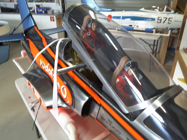

2 Attachment(s)
Harvey, it is the flat part of the rear cockpit tub against which the seat is mounted. When you open it up, you will find the seat is hollow and gives you the space you need for the modified fuel position on the top tank. No other modification of the cockpit tubs are required.
Attachment 2227026
Of course, knowing this in advance will guide you to install the cockpit kit forward, rather than backwards when you are doing it. My canopy and cockpit is a complete unit and is removed and installed in a single operation.
