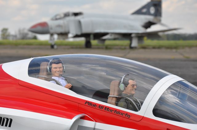

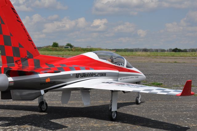

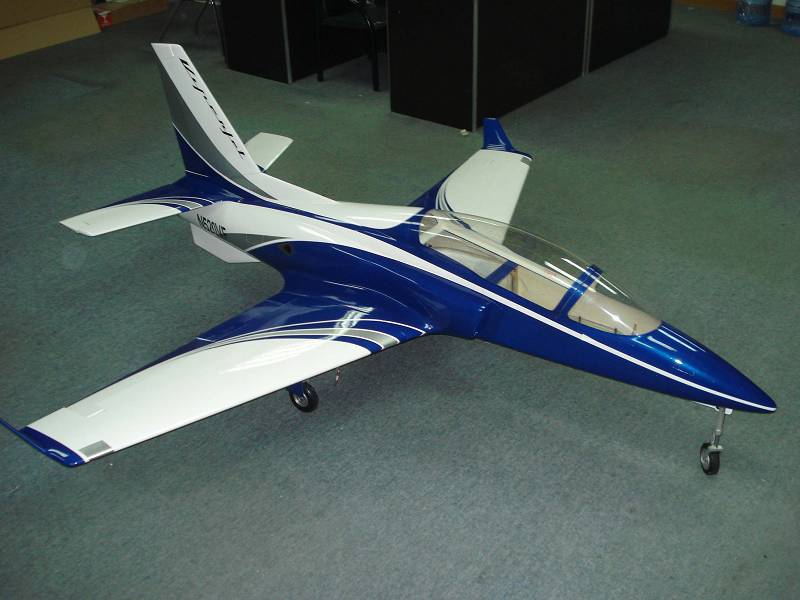

Yep sorry if you guys are getting bored of them by now, but I am still loving these great models. This is one we are just finishing off as a Turn key for a customer overseas. Part of the service is a test flight, shakedown and set up service.
All pretty high spec ( as per customers request ) Jet Cat P-160Sx, JR DSX 12, all 8411 and 8711 servos,Lights, Smoke, Airpower valve. Two of the new 1/4 scale pilots etc etc. All going well so far apart from the need to increase the venting to the main tanks.
This one is so good that I might have to keep it for my own demo model and do another one for the customer??

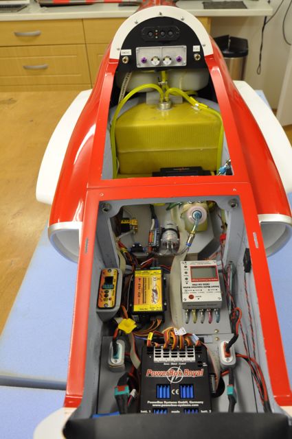

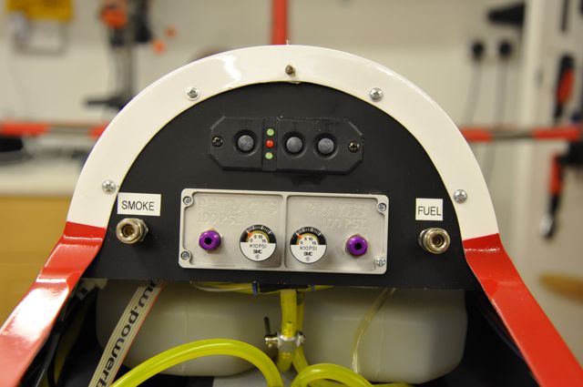

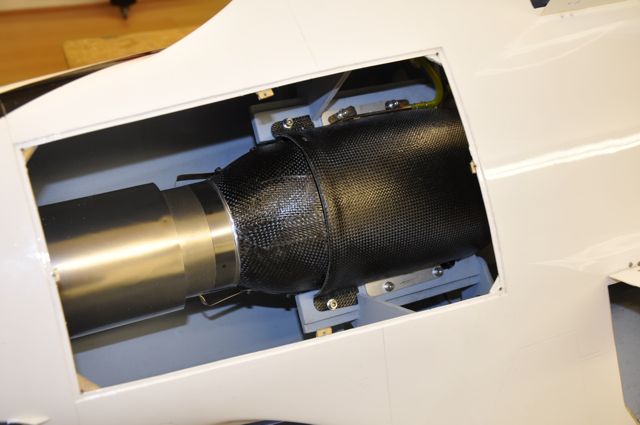

A few of the internals

Beautiful, veruy nice.

Ali,
Very nice! love the color too.

Nice, are those festo fittings for the fuel/smoke or something else?

They are the fillers for the smoke and fuel.
I have just started using them again and hoping that with some regular oiling they should not stick. I hope so as they are a much neater way of filling liquids..

I did not mention it but the install is very nice as well Ali. You customer should be very happy. Love the pilots too.

Cheers Ron,
Yep we tried to get it a good a blend of neatness and practicality. I have seen a few installs now where if something goes wrong or needs to be accessed it becomes a nightmare to work on.
I even thought about cramming a P-200 in it for laughs, but decided to leave that to you Arizonian's

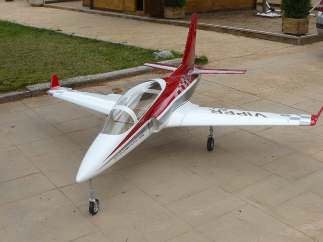

Congratulations for the model Ali , is good flight?
This is my Viper Jet, I hope to finish it in fifteen days, which a Merlin 160 (17.5 Kg Thrust), no smoke system, Airpower valve, Hitec 5955 in all controls and a 2.4 system ACT /Graupner mc-24.

they look like the ones i use on my flash, even have them between the wing tank/main tank/vent, I've had no problems with leaks and it's allot quicker connecting/disconnecting the wing tank with them and once the wing is disconnected just snap the vent/fill together and it's leak free too. also when filling i disconnect the wing tank from the main and fill it first then hook it back up before filling the main, with only air being pushed out of the main into the wing tank it puts less stress on the main tank when filling it.
