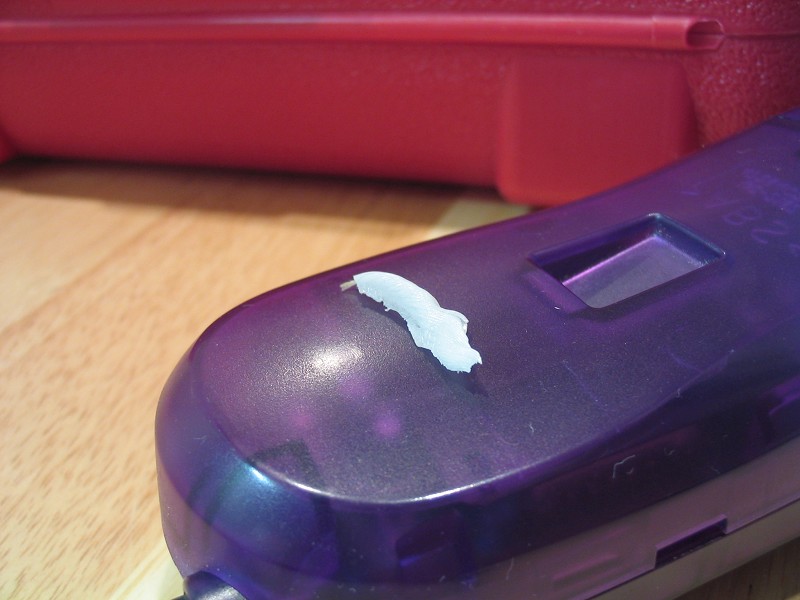

Here's a new one on me......I start my Savage SS and it runs for about 10-15 sec. still and doesn't stay running. I tried leaning the engine out 1\8 turn to no avail. When it's running, I feel something hit my bare foot, and I lean down to pick it up and it's this (a plastic-like shaving):
It looks like it's coming from this wheel (big wheel on underside of Savage):
Is this the brake disc, and shavings are coming off of it?? If so, I don't know why because my brake isn't engaged. Also, when the truck is off the wheels spin freely. I'm confused...

the engine has to warm up first, so 1/2 throttle (or wherever you say is the sweet spot) get it going let it run around for a bit before you back off the throttle, it sounds like you are running too lean...Ihave no idea what that plastic part is though. maybe something was stuck in you truck?
I didn't get any blisters durring break in on my .21, well I almost got one.
Old 09-11-2003 | 04:19 PM

There's a couple more of the shavings lying around where I've started it up.

From: El Cajon, CA
Default RE: savage ss problems starting engine
Remove your rims and see if they are stripped...I knwo the SS is supposed to have new hexes but the rims are still too soft for a Big Block Engine...Thats my best guess....
But the wheels haven't even hit the ground yet. The whole time the engine is running, I've been holding the Savage up in the air so the wheels have met no resistance. I"ll check when I get home in about 2.5 hrs just to be sure, though.
yes that would be VERY strange then, can you better describe "wheels spin freely"
"Wheels spin freely" as in that they are perfectly installed with the nuts tightened, but I'm holding the truck off the ground so that when the throttle is applied, the wheels spin without resistance.

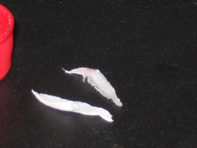

I didn't think that even a fully charged glow plug igniter could continuously run for 15 minutes....thanks for the tip, I'll try it the next time I fire it up. Before that, though, I'd like to find out what the shavings are......I don't wanna be running it if something's set up wrong. I'll probably take it to the LHS Saturday and take the shavings with me and see if they can tell me anything.
More pics of the shavings, and for size reference a 20 oz. coke bottle top:
Here's a full res full quality pic of one of the shavings. As you can see, it's fibrous....for the life of me I can't figure out what it is.

Do you have the needle settings on the engine right? It sounds like its too lean and starving for fuel when you give it throttle.On the glow plug...if you flooded it a couple times and have left the ignitor on for a long time, its probably a good idea to get a new glow plug.
If you're holding it up in the air,and holding a radio,then its pretty hard to tune the engine....I would prop it up on somethin close to the ground so you can make adjustments on it.Is there maybe a little bit of fuel and smoke coming out of the pipe while its runnin?It should be rich enough to be spittin a little bit of fuel for the first few tanks and you really shouldn't go over 1/3 throttle on those tanks either.....I'd actually drive it too but resist gettin on it;Its not too good for the drivetrain to spin the wheels with no resistance.
On your plastic shavings...Is this the SS? Did you build the truck? If so,where on the truck have you seen that material?Look over the truck real slow and carefully...turn the wheels real slow and watch everything and see if you can find anything.
