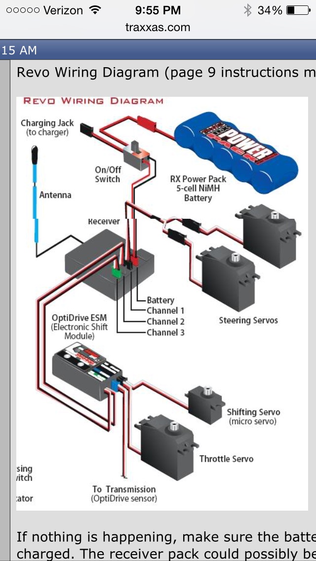

That makes sense! I also don't see the optidrive ESM electronic shift module? What's up with that?? And is that splitter connected to the steering servos pretty common?

A FOC (Forward only conversion) removes the reverse gears from the transmission as well as the linkage. There should be a little blue plug where the shift linkage went into the transmission. If there's no reverse gears there's no need for the Optidrive module or shift servo. Some 3.3 models of are o actually came without reverse. If you really want reverse I recommend buying a transmission that already has reverse in it as well as the linkage and such from an eBay chop shop where they part out brand new vehicles.
Yes the splitter/y-harness is a very common thing. It doesn't have to be a Traxxas brand but the Traxxas one is pretty small and easier to stuff into the radio box, especially when the Optidrive is present.

I do have one more question though. With there being two steering servos do I need one specifically for the right and the left side? Or is it the same servo for both sides? Also if it's the same one do I have to mount it differently?

Same servo same mounting position. The bellcranks are still there correct ?
Also if you are using a receiver with only one steering port you will need a "Y" harness.

As mentioned there's no specific left or right servo. Have a look at the exploded views on Traxxas.com for mounting, there's also a setup guide in the manual (also on Traxxas.com) for setting up the linkages when using two servos.
Just because the Revo originally came with 2 servos doesn't mean you have to run 2 servos. Traxxas used 2 servos because they didn't want to develop more powerful servos but wanted more powerful steering, so they just added another servo. If your current servo is powerful enough you don't need another one. I can tell from the pic it's an aftermarket servo, what is it? Have a look at the sticker on the output side and let us know what it is so we can lookup the specs. If it's got at least 200oz of torque you may not want to add another although I personally prefer more like 300oz for my monster trucks.
Edit: Traxxas originally used their 2055 servos in the Revo which are 80oz each for a total of 160oz of torque.
