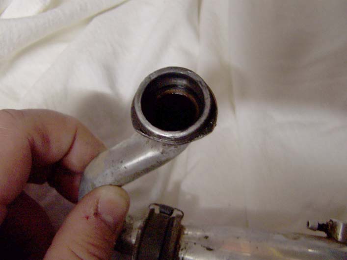

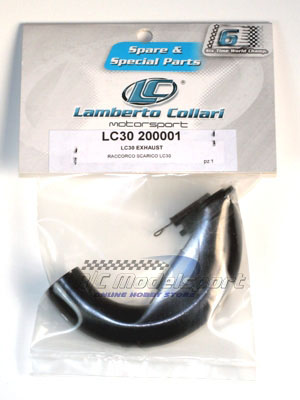

Guys got one the other day (collari 30) that has the new rotor start. Problem is I cant get a header to go on it cause it wont clear the rotor start . Any suggestions..............

You need this. But you could also grind away your existing header.
