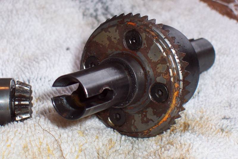

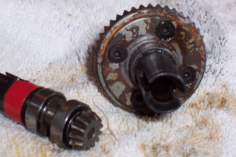

Has anyone ever experienced this? Somehow water got into the diff case, and i only discovered it today when i noticed the diff wasn't rotating smoothly. I've not checked the front diff yet... []
The diff was in PERFECT condition before i took the truck to the track on Sunday - the track was wet, but it wasn't like i was driving through a river! Didn't spend more than 10 minutes driving the thing! The bearings feel like sandpaper but the teeth look ok.
Is there anything i can use which will get rid of the rust? I don't really want to buy a whole new diff...

use a 0000 steel wool to dust off the rusty areas.... then blow clean with an air compressor, spray liberally with WD40. rub the whole gearset as to polish with the wd useing your thumb/finger.... dry off with cloth and blow dry.. by rubbing the wd40 around, you help it seep into the pores of the metal... Old trick i got from Gramps..
get a Sealed Bearing Set for your diffs, they Typically have a Blue color to the bearing, though not always. a sealed bearing will stop water seepage and protect and extend bearing life...

Removing rust...soak in PB blaster or Liquid Wrench. Then clean with fine Steel Wool.

...the rusty parts are now sitting in some Pepsi Max! Apparently carbonate (fizzy) drinks remove rust, so i though i'd give it a go. I'll leave them in till tomorrow and see if it makes any difference. I already took the bearings apart and blasted them with nitro cleaner, they're spinning much more freely now. I also chucked them in the Pepsi to keep the ring gear company.
If it works i'll just replace the worn plastic diff case, and make sure the thing is watertight. Oh, and i'll try and make some money selling "iron rich" Pepsi, because *it's good for you*

yeah, the citric acid in soft drinks will eat rust. If you leave it in too long it will start to eat steel, but this will take a week or more to even start. WD-40 or any of the common rust removers/lubes will remove rust as long as they are not silicone or graphite.
Sealed bearings will help and use some silicone between your outer diff case halves. Plus, make sure you have some grease on your gears as grease will repel water.

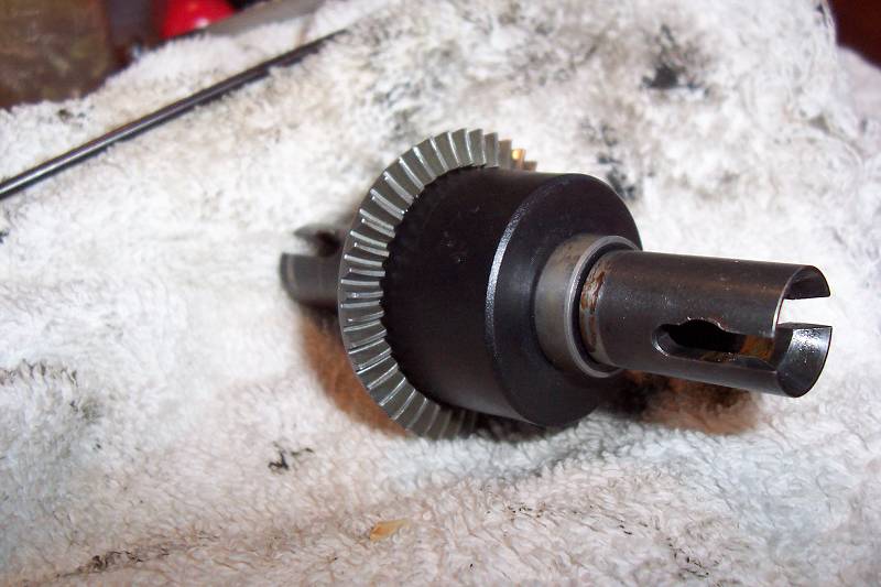

The Pepsi seemed to do a good job.
Took the parts out, blasted them with WD-40 and nitro cleaner. Polished up the diff with a dremel and a wire brush attachment. Cleaned out the bearings, filled them with grease and reinstalled. Put everything back together and made sure to cover all the internals with lots of grease!
Happy diff.

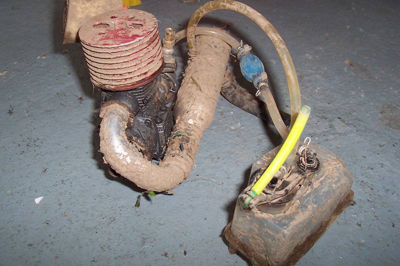

So how do you guys clean out the bearings? Last weekend I was playing in some mud and I need to do the same as you[]

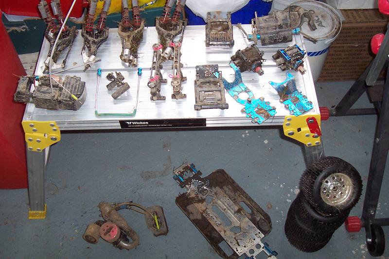

Blimey looks like mind did, only minus the grass!
To clean the bearings i first removed them and wiped with a rag. Then remove the shields on either side and give a good blast of nitro cleaner or something like that. Then a good spray of WD-40 and wipe then off. Then i just packed them with grease (just a drop of light oil will probably do) and replaced the shields. They felt as good as new.
Right now i'm trying to save some other bearings, but they've siezed and i think they've had it. []

it seems that the tires of all things are the cleanest parts on that truck!

ORIGINAL: Wide Open
ORIGINAL: skyodyssey
LOL, yeah, we were racing under the lights and the whites of the tires was the only thing I could see down the back sections of the track, the body was totally covered in mud as well. The insides of the rims were filled with mudd as well. This truck had to wieght at least 3 lbs heavier at the end of the day, I think more like 5lbs. BUT IT WAS FUNNN
