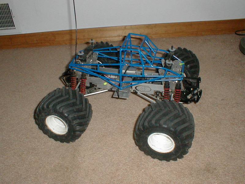

Make sure you scuff the area to be soldered, use flux, and use silver solder. It's not going to hold like welding, but actually holds up ok. I made a roll cage for an electric MT I have that I can stand on using brass tubing and using silver solder for the joints.
Edit: Here is a picture

Any pics bria1? I made a crawler chassis from 1/4" brass and solder that I can stand on too.

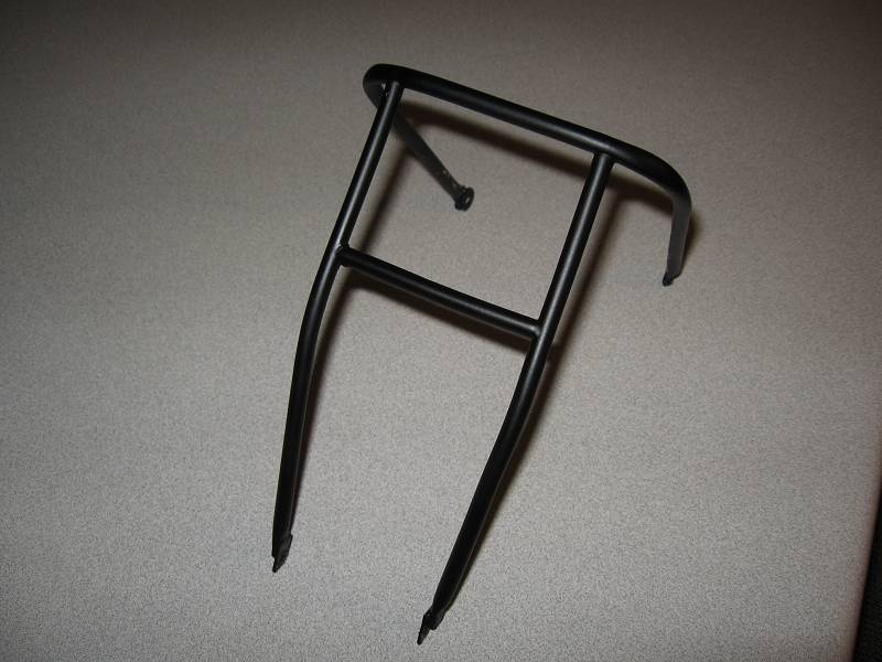

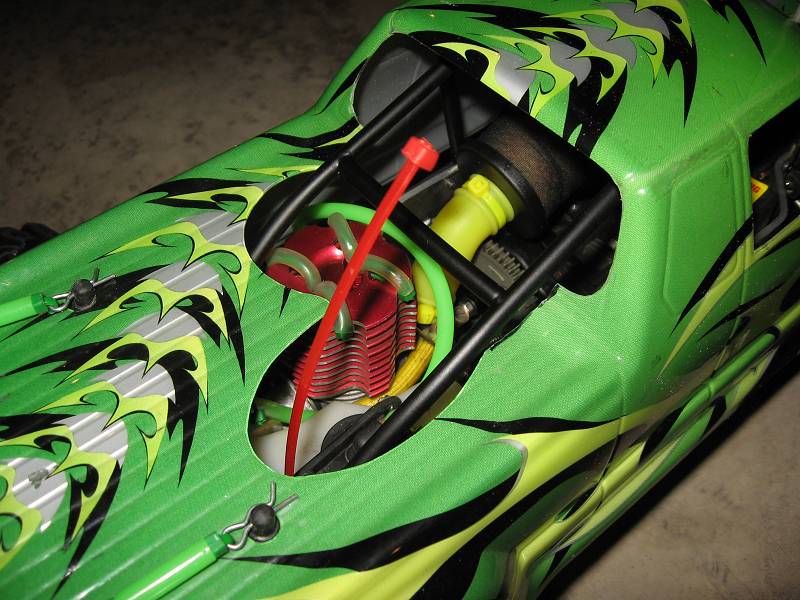

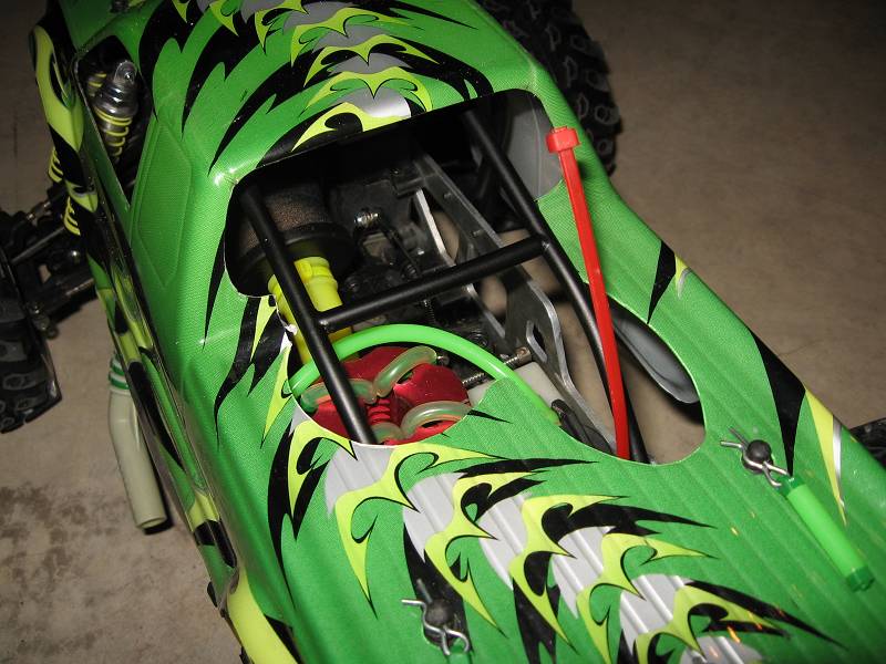

Old 03-04-2007 | 07:05 PM
mike54937's Avatar
Joined: Dec 2006
Posts: 94
From: GREEN BAY, WI
Default RE: Help Soldering
Heres those pics, just got done painting and putting it on. I don't think I would be able to stand on this on but, it is a lot better than the cheap stock one they put on!

Old 03-04-2007 | 07:15 PM
Joined: Jan 2006
Posts: 2,682
From: Portland, OR
Nice.. that looks good man [sm=thumbup.gif] keep us posted on how well it holds up..
Old 03-04-2007 | 09:43 PM
Joined: Nov 2005
Posts: 3,331
From: Orange Park, FL
Looks good. Some triangular bracing will strengthen it up quite a bit.

Old 03-05-2007 | 05:35 PM
CustomTamiyas4Life's Avatar
My Feedback: (34)
Joined: May 2005
Posts: 7,074
From: CT
What!? That's soldered!? Looks brazed it came out so good! Nice job.
