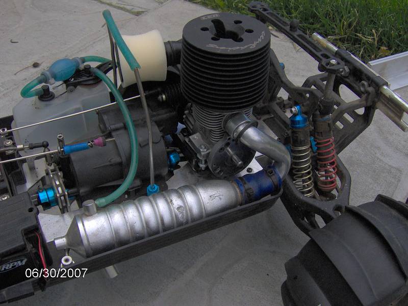

man i bought this engine brand new off ebay and checked the engine over when i got it made sure it was all good. then ndropped it in my truck and fired it up for break in, first it seamed fine but then it started idleing up and reving but when i looked the servos wernt doing anything so i thought it was to lean so i richened it up but still it did it. so i turned the high speed needle so far out it was showing threds but it didnt make a difference so i adujsted the low speed and idle to but still same thing. so then i though there was an air leak so i sealed the back plate carb and found a small leak in the head then fixed it but it still after firing it up did the same thing.
so my question is what is wrong with this piece?

Hey Steven, What truck/tank are you running this engine?? pics would very helpful.. I guarantee you we will resolve this for you!! Take some pics and post them it will help

in a monster gt so im using all the stuff of the mgt and just droping the engine in right were the original was here ill get some pics

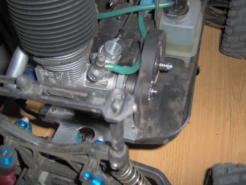

YEHA YEHAAAA !!!! just put in one of my 3 needle carbs off a cheapy engine filed it and sealed it to make it fit on this engine richened the crap out of the needles and tryed it and the fricken engine ran!!!!!! it was smokin good like it should during break in and acted normal after 2 months of this engine lingering in the back of my head and it finally works!!!! but what i dont get is why this cheap carb from a .27 motor flows more than the carb of the nx 76 which is twice the size??? the needles are even bigger ?? but w.e is workin nand thats what counts thanks for the help guys i know that when ever something comes up theres people to help me out!! and im definitaly gona post vids of it tearin it up this gravel pit. thanks again

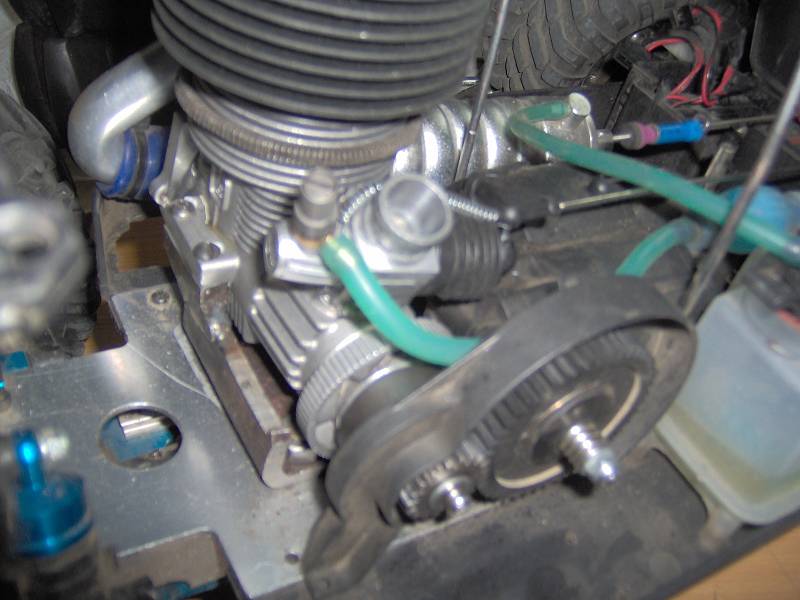

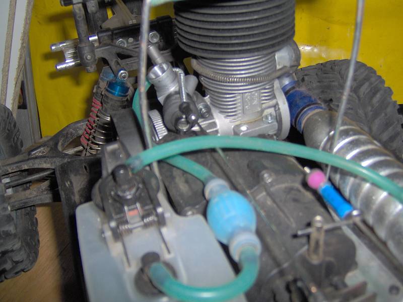

no problem! i bought this engine a while back its a power racing .27 im pretty sure its just a infinity .27 or something like that heres some pics the black engine sitting by its self it was the engine it came with and the rest are of it on the cen engine
