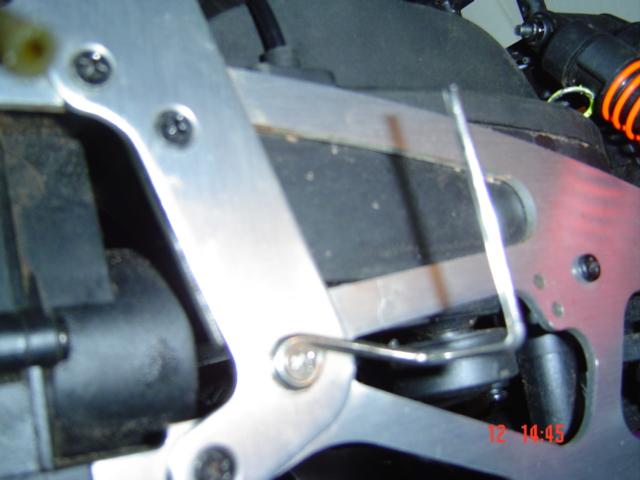

I purchased a one piece rd logic tuned pipe for my savage from hpisavageforum.com
It came with no instructions and i can't figure out the install. and i know a couple of you have this exact one.
This is what i got:
Header, Pipe, 1 lg spring, 3 small, 1 rubber gasket, 1 hex nut, 1 long straight mounting arm with a loop at top.
I know the 3 springs hold the pipe to the header. and the lg spring goes around crank case. header will not fit over stock rubber exhaust gasket, but the new one fits. So i put the new one on the case, and the stock one inbetween the header and pipe.
Not sure if that is right but i can work with that.
My real questoin is the mounting the end to stabilize. I know the rod slips thru the hole and the hex nut tightens but where does the rod mount to the truck. I tried using stock exhaust bracket but to far of a reach.
Sorry for so long thread, but need to get this installed. if any have a picture with the pipe installed that would help.

See i have a rod like that but it has a loop at the end. The silver cap is attached to my pipe and the hex nut i have.
It is just that the rod is straight and it doesn't reach to anything on the chasis. I guess i may have to custom bend the rod.

here is how i did it..i did not buy another part but it works great and had a couple of turns and landed on the pipe side and no problem

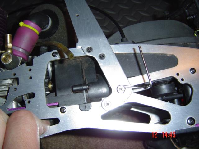

one more

hope it helps you..the twisting of that wire its not that hard..but before u bend it put the pipe first..then bend it towards the hole ...goodluck dude..
