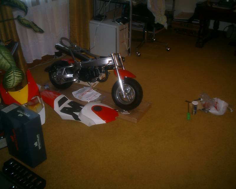

Well as promised the purchase for my next R/C project has been made, keep in mind this is posted on the other site aswell. In case you don't know what it is...its a 49cc gasoline pocket bike awaiting R/C conversion.
Enjoy.
Chris

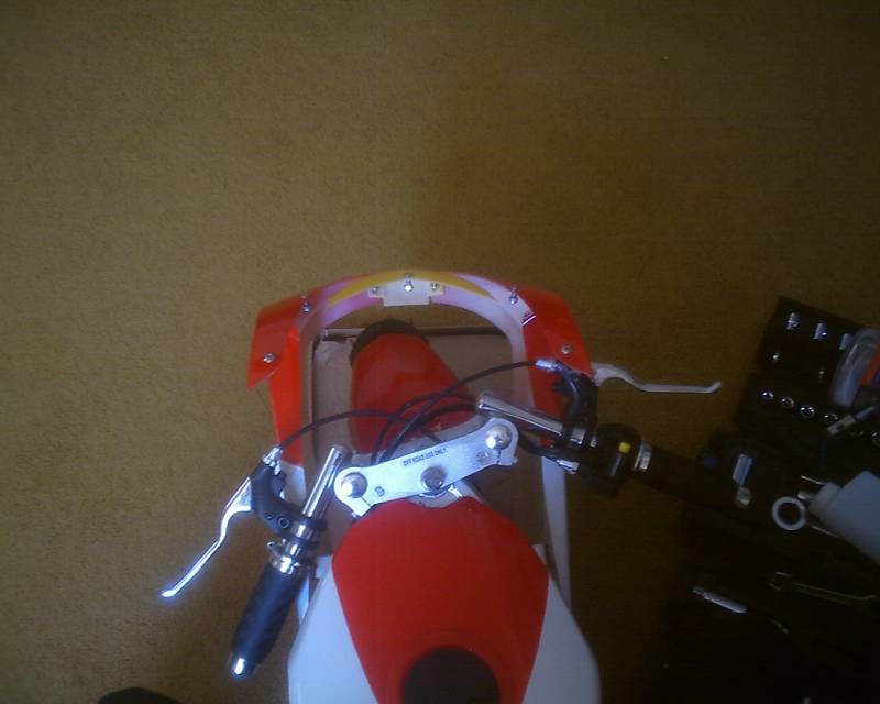

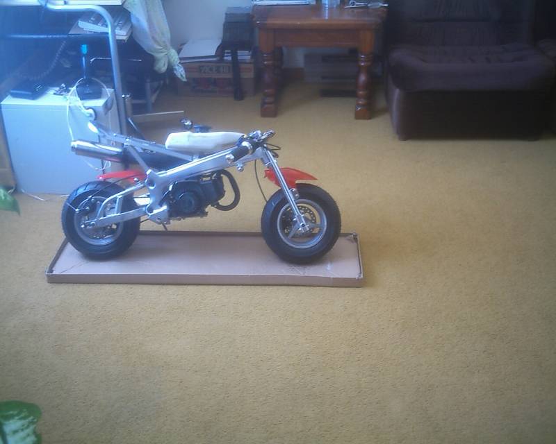

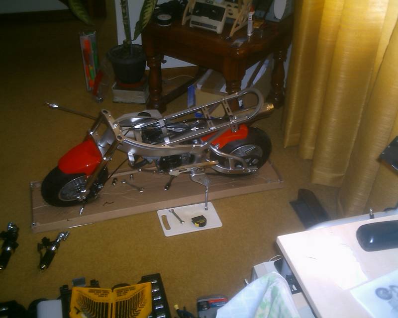

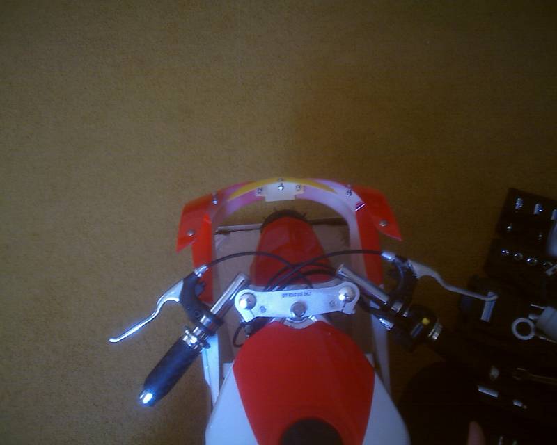

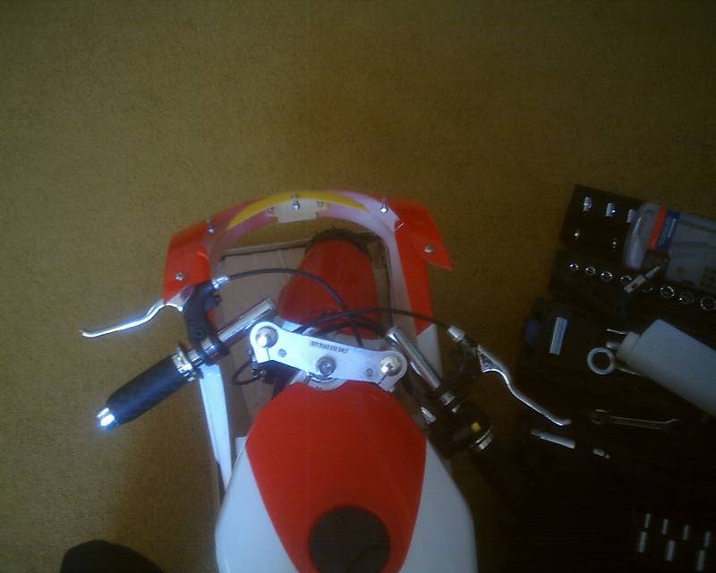

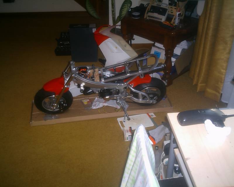

Ok here is the pics of the bikes tree and actual travel lock to lock.

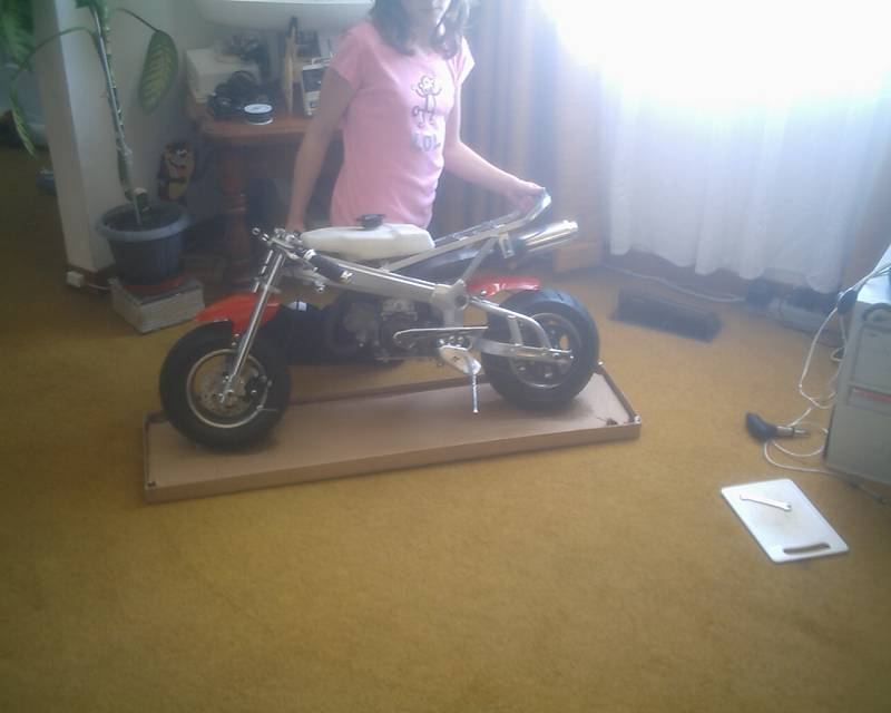

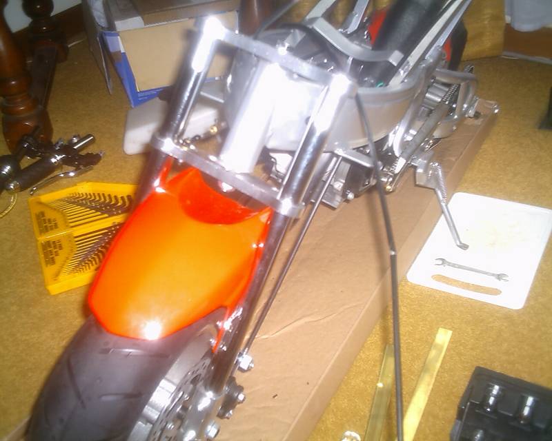

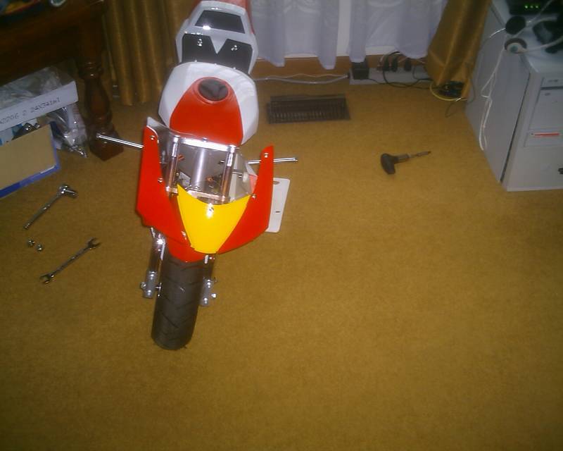

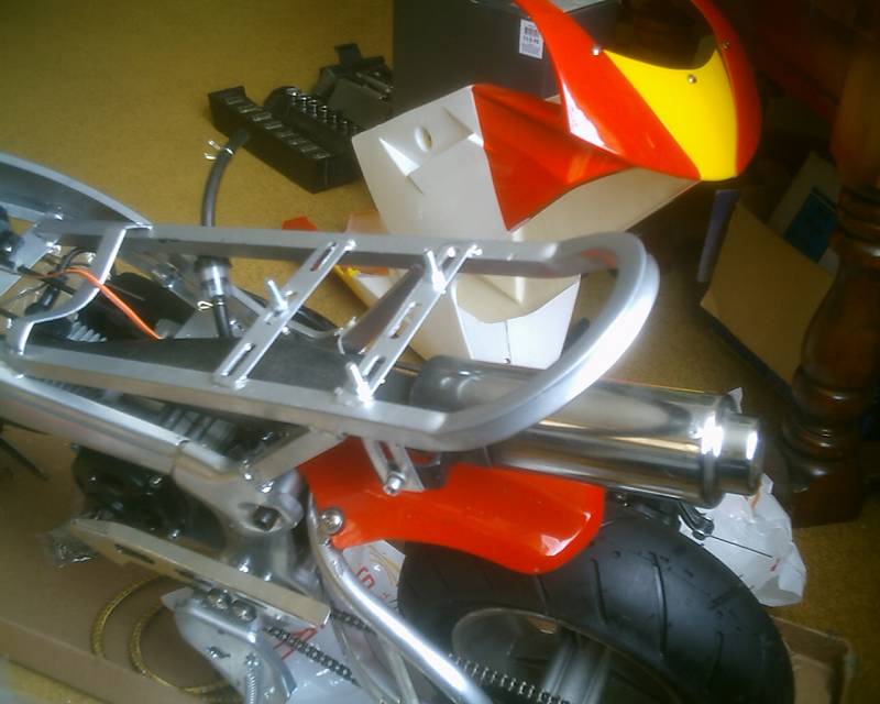

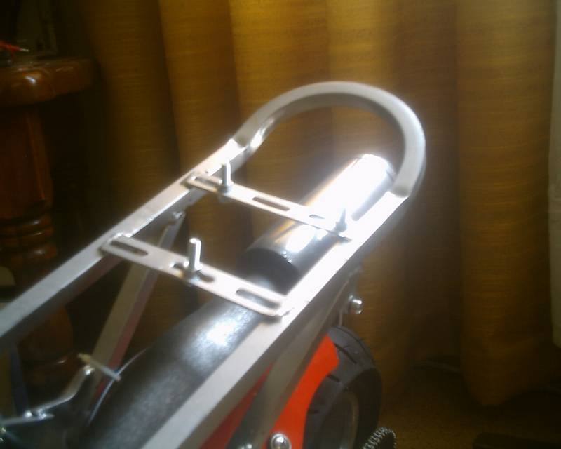

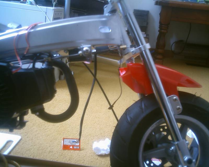

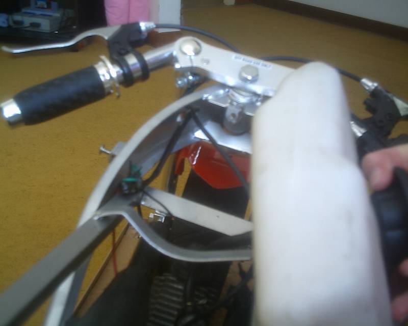

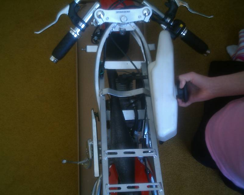

Here we go..removal of the fairing...seat and tank cover assemblies...This is what I have to work with
Enjoy the pics and a big thanks to my oldest daughter for holding the bike when needed.
slow connection beware.
much more to come.
Also a big thanks to everyone in the giantscale forum for putting up with my questions its so appreciated.
Chris.
Oh and comments and or suggestions are always welcome.

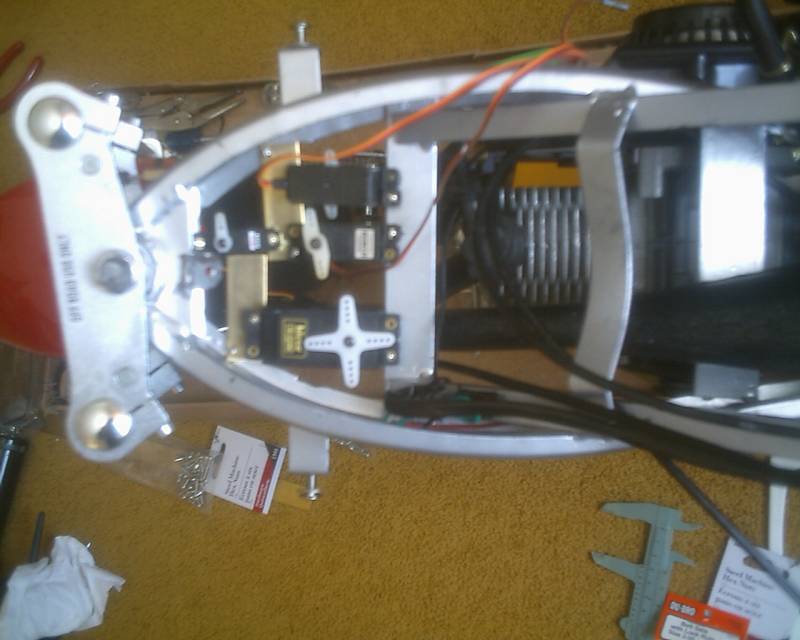

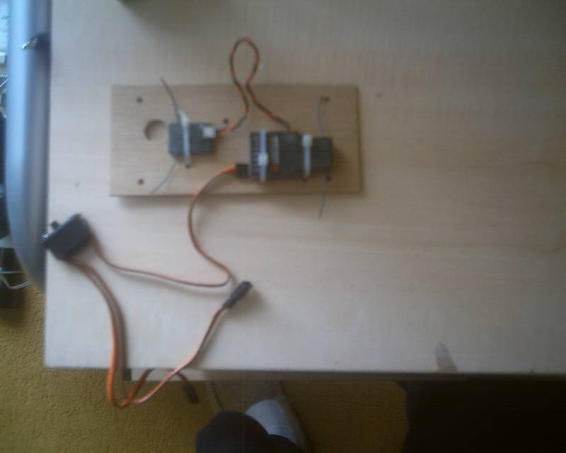

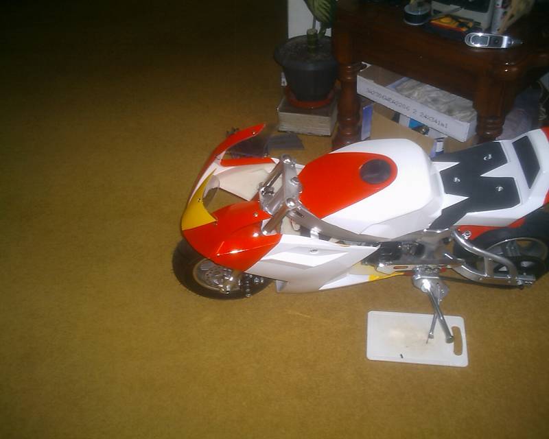

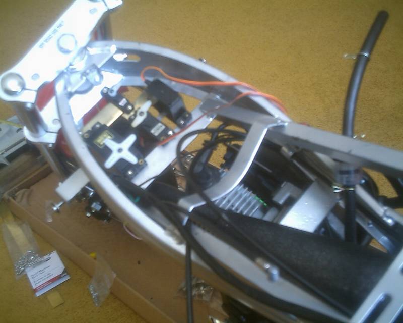

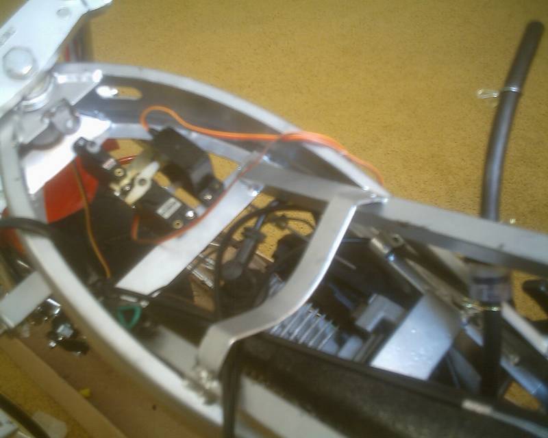

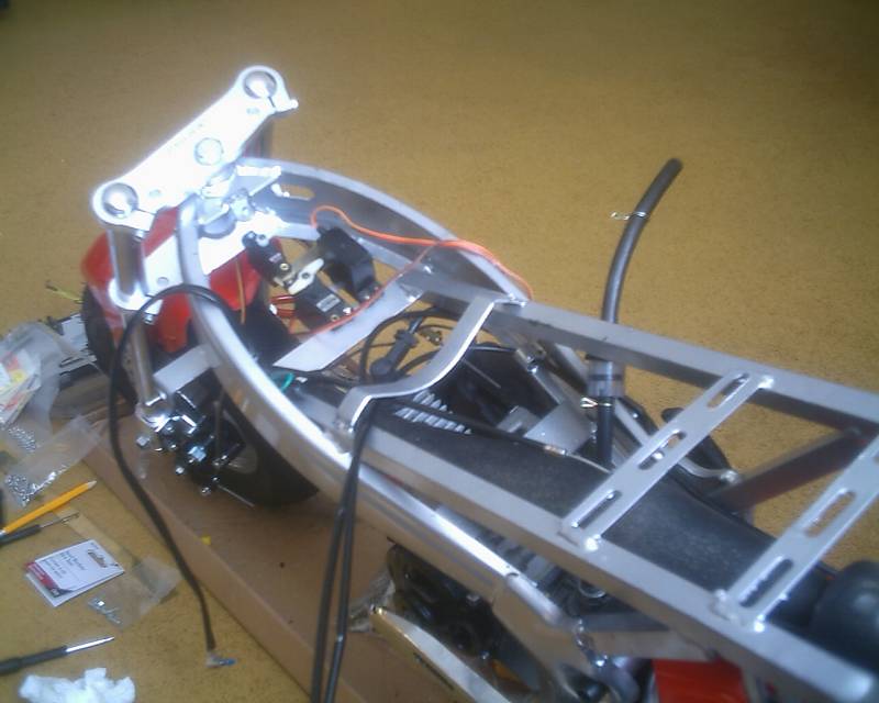

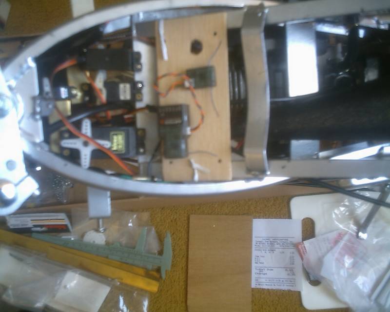

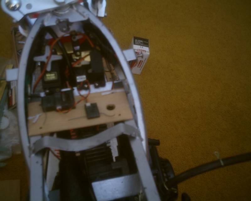

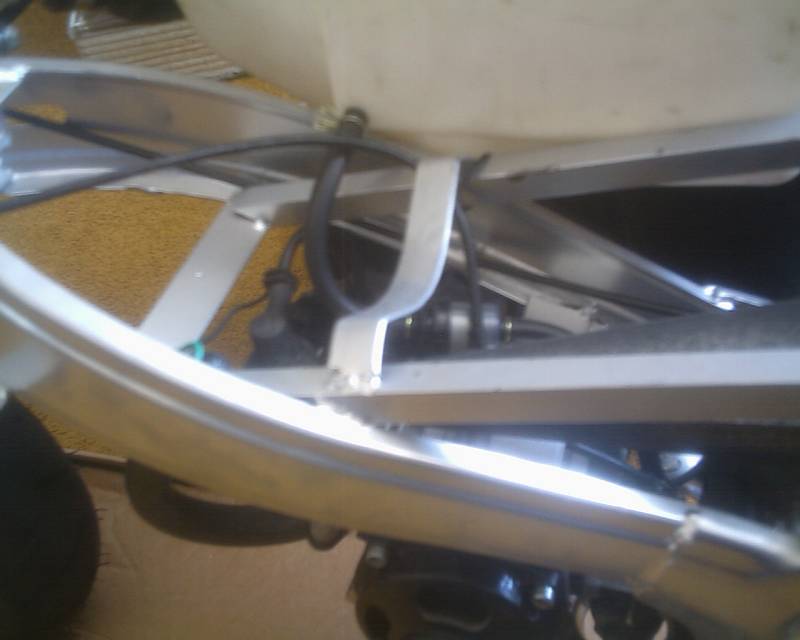

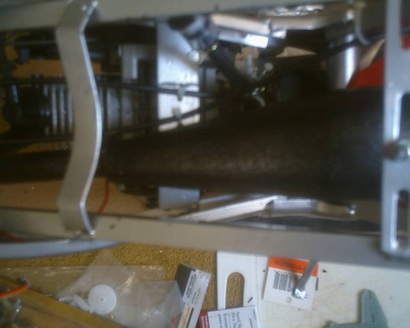

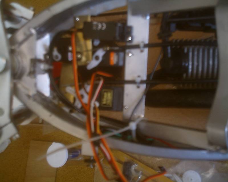

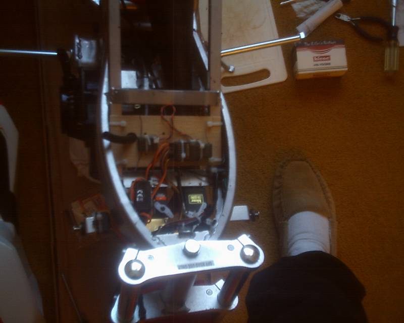

and more pics............. yes I have been very busy as you can see...I did not post a final pic of the conversion because with the fairings on, It looks the same as a normal pocket bike, only thing that gives it away as something different is the seat bolts protrude through the seat now (you don't want to sit on this bike!!), also there are no handlebars and there are now 8inch drag bars on the sides.
A bit of info....
Bike is a chinese air cooled model
I am using a Spektrum DX7 system for the radio
4 channels are utilized on this conversion.
At this time only using 4.8volt rx pack(hope to try 6vlts soon.)
hs 81 micro servo for ignition cuttoff via a micro switch attached to the servo.
Standard digital servos for steering and throttle.
Using a Hs 700b 1/4scale servo for the rear brake....at this time the front is disconnected due to the servo does not have enough torque to pull both brakes at the same time. will be upgraded in the future.
Any comments and or questions on the conversion?
Hope you everyone enjoyed the pics.
Chris.

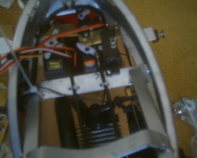

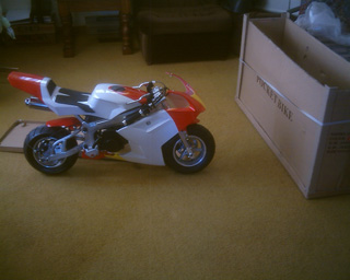

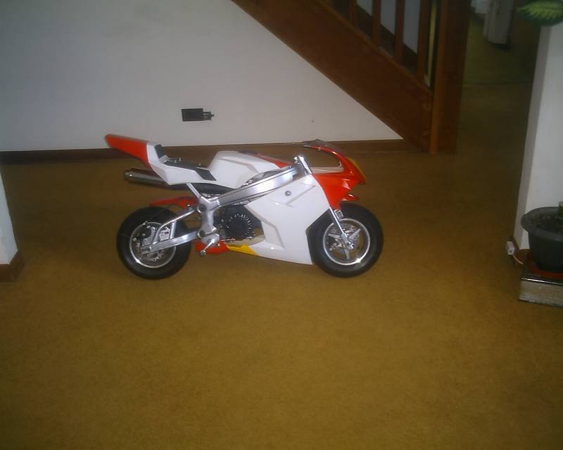

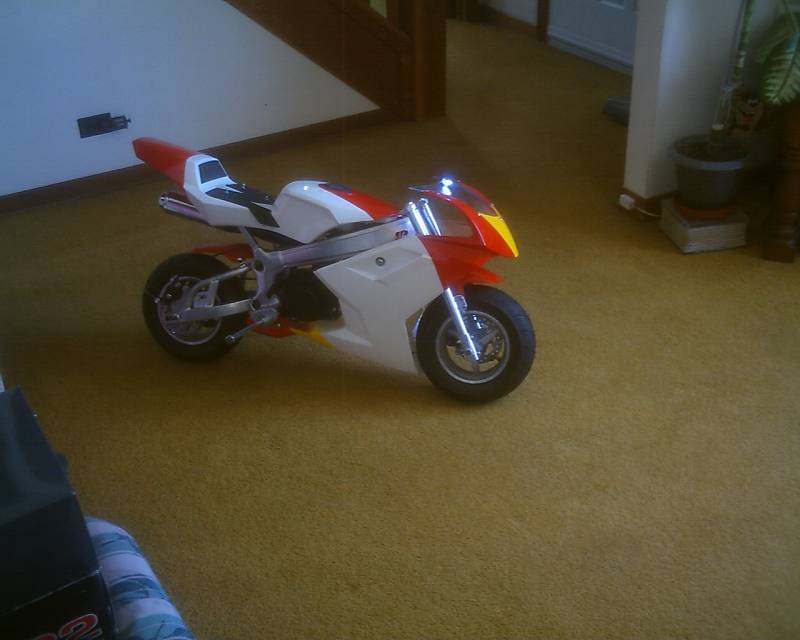

Well I got to thinking what good is it to not show the finished product so here you go
Chris

Thanks for the kind words guys.. Yes I cant wait to have a video made of it either, hopefully soon.
hmmmm r/c pocket bike class sounds interesting.
I hope my work and my friend's work from Au. has inspired some of you to tackle a conversion of your own. Just a bit of time and thought is all that is required.
The observant people will notice a bit of different mounting of the servos in the finished project compared to the beginning.
Chris

[link=http://www.rcuvideos.com/item/YLGRN0PN8SFPD9SV]chris'pocket_bike_again[/link]
Please remember you may find these videos on another site where I have posted them as well.
hope you like them and see its really possible for a conversion to work.
comments? questions? welcome.
Chris

thas hot.. now get a dummy doll. but how is the bike balance??
Old 05-17-2007 | 12:14 AM
Joined: Jul 2005
Posts: 128
From: cornwall, ON, CANADA
Default RE: The purchase has been made!! Conversion begins
ORIGINAL: krayziedxc
dummy doll in due time, namely when I can drive this thing better. The balance is good no problem with that at all. These vids don't show it but the bike keeps itself balanced just by forward movement. Its an ongoing project that I just had to try, and I am enjoying every minute of it.
Chris.
