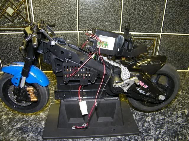

The strip down has started - quite a lot of little screws in this thing and working out what to undo first... lots of fun.
Ok, pictures time.
Stage 1: Got the rider off and the front fairing.
Stage 2: removed one of the side panels
Stage 3: have access to the rider movement mechanism
Stage 4: have access to the servo
Stage 5: separated frame from swing arm
Stage 6: reusable parts 1
Stage 7: the frame definitely has potential
Stage 8: the body is nice - similar to the Yamaha R1 or R6 from 2007
Stage 9: all the reusable parts
Stage 10: all the parts destined for the bin...
Looks like a decent sized motor should fit the drive mechanism
The standard motor is 4cm x 3 cm diameter.
Sure I have seen a brushless one that is very close to this size, will have to dig through my many parts boxes.
I bought a BL for flying thing and never go around to using it, so may be able to give it a new home.
There is plenty of space for a decent receiver and esc.
Also could probably open up the bottom of the frame to house a 7.2v 6cell battery. Or a small 11.1 lipo....
We shall have to see.....
Does look promising....

Still waiting for some parts to arrive - got a Kyosho HOR motor today, but its too small, 20mm diam.
May need to get a 370 size motor?
It needs to be 40mm x 30mm - diam, if I can get one. The 540 motors are 40mm diam, so am hoping the 370 is the size I need.
Otherwise may have to mod the mounting.

Update:
Got some of the parts today.
The motor arrived from www.Cornwallmodelboats.co.uk - thanks to Yaleforscale
Have to the Gaupner 400 7.2v
And its a perfect size match for the original motor.
This will partnered with the Ansmann VR18T from www.goldstarstockists.net.
Plent of room for this, just need to decide where its going to live.
And if I can squeeze in a 6cell 7.2v battery.
Hope to get some work done installing and testing soon.

HI Lito,
You are correct - this is almost identical to the Nikko bikes, but with a road based body shell and lights.
The drive train is all plastic gears, so can see what you are saying.
I am initially going to gear with the 9T pinion, as that is the same as the standard one.
And was thinking more around having a drag brake, if I can disable the reverse on the esc.
Once its working (if it does), I may look for some metal gears to replace the nylon ones in the drive train, so that would be better.
Inside the drive housing, it could be possible to change to belt drive, but might be beyond my ability. And may struggle to get parts that fit.

But do have 3 of the 9.6v standard ones that came with the model (the Gaupner motor is rated at 7.2v).
Just waiting for the motor pinions to arrive, then can get some soldering done and start to test things.
I am also going to weight the rider with wheel weights, should help with direction changes.
What power servo do the riders usually have?
I have a couple of 9g aircraft ones, wondered if these would be Strong enough, or should I use car steering servo's?
ORIGINAL: yaleforscale
looking good drew , these motors can be overvolted with no problems . that speedo looks the same as the mtronicks , if so they can take a 9.6 input voltage . that should speed things up a little , these toy grade normally have plastic bushings if you can replace them with steel roller bearings the drive train will withstand a lot more abuse . . i know this from experience, ...i have done the same thing to toy grade newbright trucks , .you might want to try this guy for bearings very good service , if you dont see what you want email him . and he will do his best to help . cheers bro ....[link]http://www.rcbearings.co.uk/[/link]....
You are spot on - it is the mtronicks speed controller. Was going to try using 7.2v first, so I can use other batteries that I already have.

i dont think you need a powerfull servo for this drew a standerd should do the job , i see no reaso why you carn,t use the aircraft servo good work bro .
Still waiting for some last bits to arrive - got the pinions now.
Almost ready to start rebuilding.

The project has been on the back burner, a death in the family and sorting out a crawler took precedent.
I do have all the parts I need to move this on and hope to be able to do some work on it very soon.
Will provide a better update soon.

So should be able to take a normal sized servo.
I have a few small aircraft servos and 10th scale car steering servos. But have not tried any of them yet.
Will be starting the rebuild very soon, got my solder and new bullet connectors arrived today, so should have everything to get started.
I am going to try the standard motor first, with the new electronics.
Hope you get yours working better.

I am going to use a HPI 2 channel controller, at least initially.
Should get better than 20ft...

Did not even attempt to drive my bike outside, just tested in house and decided it was not good enough.
Dont like the 'on/off' of the controls, steering and throttle.
Will start assembly tomorrow night and post pictures as we go.
My Mrs is away visiting family, so should have time to get some build done. - and no one to laugh...
