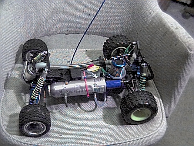

Default RE: ANYONE!
ORIGINAL: ericheller
quote:
ORIGINAL: Frost_
shorter=more torque in the middle, longer = more top end HP., It is like a real car in this aspect, to make torque you want some back pressure, but at hi-rpm's you need much less to ensure full exhausting of gasses because remember your engine is a pump, more RPM's need more air in and more out.
ok then...so why does my mousse can muffler work so well....it has monsterous torque AND power....therres nothing in the pipe just the extra long stinger and the tube i used to put the blue coupler on...i also extended the fuel line from the tank and modified a fuel filter so its now a one way valve..
