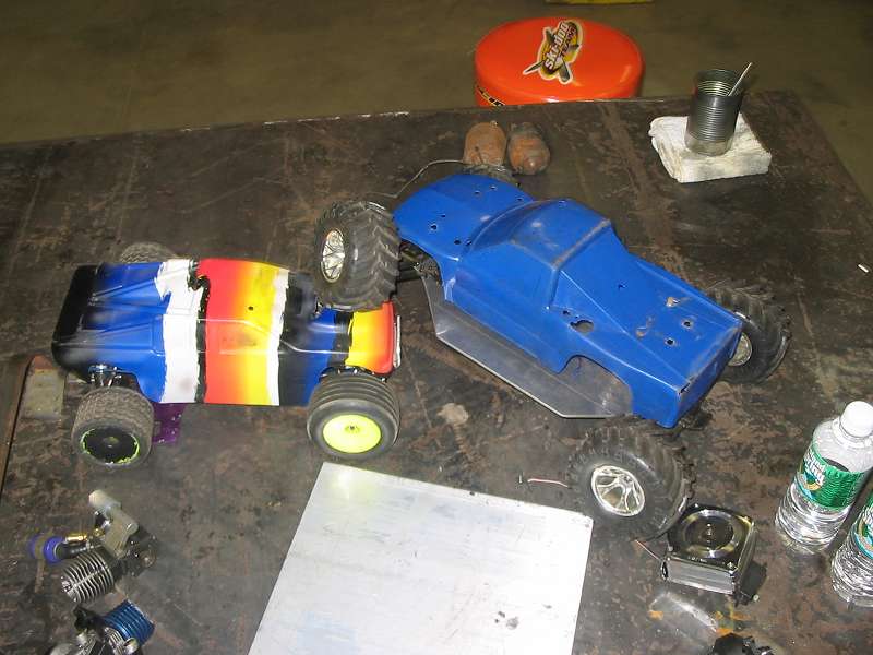

UPDATES: I took this truck out form under the bench today. Dusted it off and ordered some parts form tower for it. I started on a longer and wider chassis for it. I plan to now use 2 separate servos for the two engines throttle. the other set up was just not working correctly. The new chassis is thicker aluminum and roughly 2 in longer and 2 in wider. Pics tommarow. And I agree my english is a little bad.

Here are some pics with a rough layout of how things are going to be. I had the hardest time finding a dogbone that was the proper lenth for my longer chassis.

Well I think your intentions are good and you have the right idea, however, you might consider upgrading your differential. And as for your spur gear, definitely needs to be upgraded to either aluminum or titanium. I have titanium tranny parts on my max ST that has a .21. (made them myself in my Mill/Lathe) I would suggest making your own parts but I doubt you have the right equipment for it. Not many people do.

I actually do have the right machinery to make the parts, mill, lathe, surface grinder. However I dont have the knowlege to go with it. I am however learing. Here is some pics of the chassis with some components bolted to it. I drilled with the holes with a brigeport mill. I need to find a body that will fit right also.

ORIGINAL: mittimj
i think what he meant by rigth equipment was different tool bits and endmills and whatnot also because u need a variaty of things to do that and gears are a little complicated...
truck looks better and seems to be less corwded with teh longer and wider chassis...for a body try looking at a 1/8 mt body...migth get u what u need but u might have trouble finding one to fit cuz it looks a lot longer
but try getting any gears u can in aluminum/ti...if u cant get them than buy tons of replacements...i'm glad gts have every gear u want in some kind of metal....
