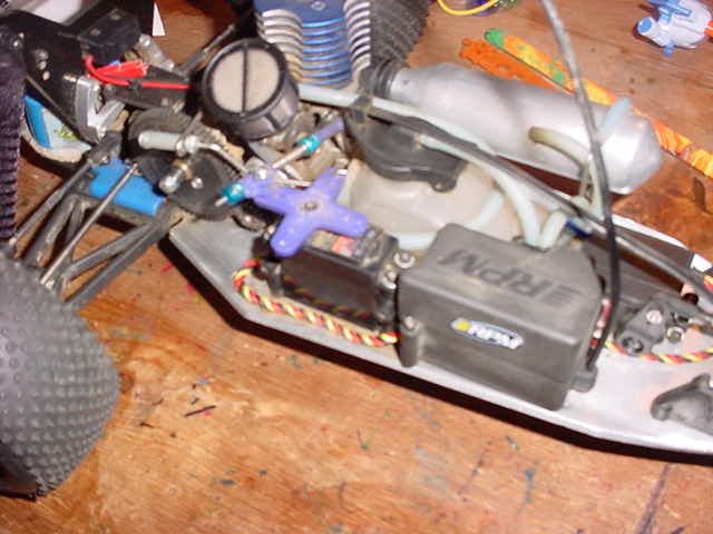

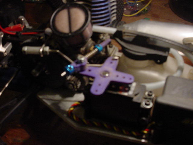

I have a RC10GT and just bought the OFNA throttle/brake linkage kit(the whole deal).....and it doesn't come with instructions and i can't seem to find anything online.....can someone tell me how to put it together, and if you have pics to show with it that'd help alot...thanks alot

I got the Duratrax linkage kit but I think they are the same. I hope these help you:

with the ofna kit there is one long thin metal bar and it's straight....am i supposed to use that for the throttle part and use the old brake peices with the kit?.......the duratrax one does look quite similar maybe exactly the same, but am i supposed to cut that bar shorter or what?

Thats exactly what I did:
1 Re-used the old brake linkage and
2 Cut the straight linkage provided with the kit to fit for the throttle.
The only tricky part was that I had to loosen the nut that holds the throttle linkage to the servo horn a little bit to keep it from binding.
