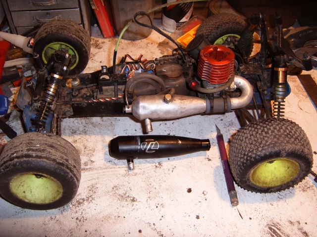

there has to be some good exhaust upgrades for the RC10GT. Right now its stock. I heard the stinger has a design flaw bc the unburnt fuel hangs in the header and constricts flow or some junk like that do you know anything about that?
I have heard that too, and it makes sense, as it points upwards.
Why not just use an extender for a typical pipe. I would cut it as short as possible and still get out past the tire, since it will change the 'tune' of any tuned pipe.
I run the Dynamite short dual chambered pipe on my Dynamite 12SPD. The pipe enables wicked RPMs
. I have the identical engine in my buddy's XXX-NT with a stock RC10GT pipe on it, and it doesn't get nearly the revs. It does have more grunt though, I think. Kinda hard to tell cuz the gt is geared lower.
I have heard say that the rippled pipe produces really good torque, but I don't have firsthand experience.
I am with T-Bird...I just deal with an oily tire.

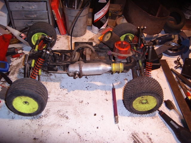

I stuck the stock losi pipe in to compare length. It is quite a bit shorter.
. I have the identical engine in my buddy's XXX-NT with a stock RC10GT pipe on it, and it doesn't get nearly the revs. It does have more grunt though, I think. Kinda hard to tell cuz the gt is geared lower.I have heard say that the rippled pipe produces really good torque, but I don't have firsthand experience.
Or, turn your pipe down a bit and not so straight out so as to have the exhaust gases (and oil) go down more to the pavement and not flying in the air where it will land more on your rear tire.
I've used a couple of excellent pipes, it all depends on what you are looking for. Torque? Top end?
Torque, one of the best pipes for torque is the stock single chamber GT pipes.
More top end, still tons of bottom end, try the RD Logics Turbo II pipe.
For even more top end and still have better than good bottom end. This is extreme and only if you go with the 18CVRX. Try the RB Concept TM-01 pipe (it's a big block pipe). I run this in my GT and a 18CVRX, killer top end and the damn car still wheelies at all the wrong moments! (time to loosen my slipper a little)
